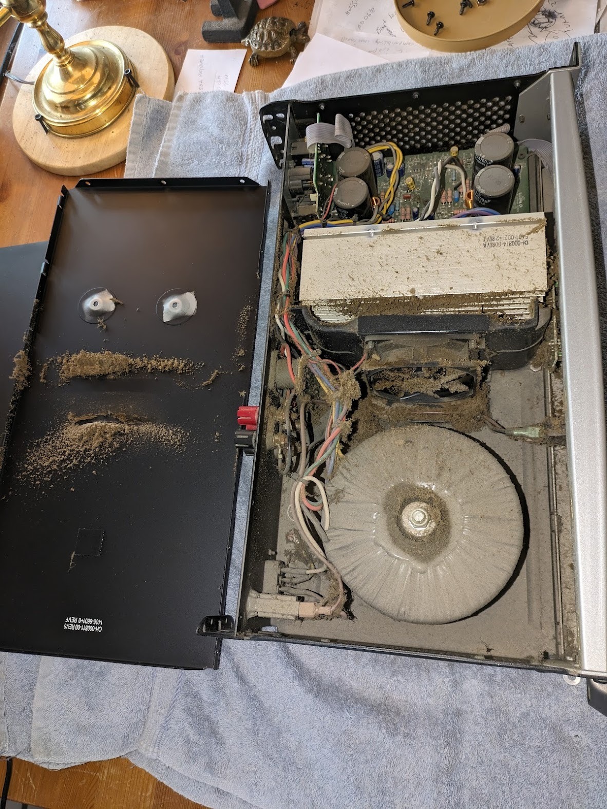

After cleaning the fan heat sink and pcb, I put a fliter over the fan inlet. Tacky fiber filter material I buy in rolls. https://www.mcmaster.com/products/hvac-air-filters/air-filter-rolls/
I punch ty-wraps through the filter material and loop them through the inlet grill. If fan is too close to the inlet, holes can be drilled around the grill for screws and elastic stop nuts. I use #6-32 x 1" for this service.
I buy 24" or 30" wide rolls and use the same material for my window A/C and furnace unit. Also get tied over the back of room fans. It cuts with scissors.
To avoid overheating the appliance the filter should be changed every 2000 hours operation or so, or when you notice a layer of dust accumlating.

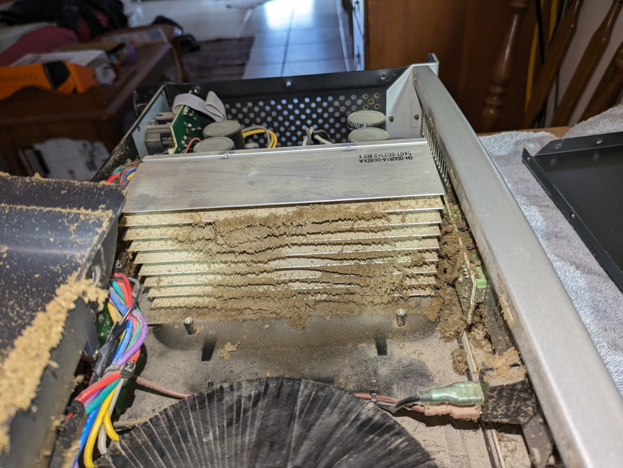

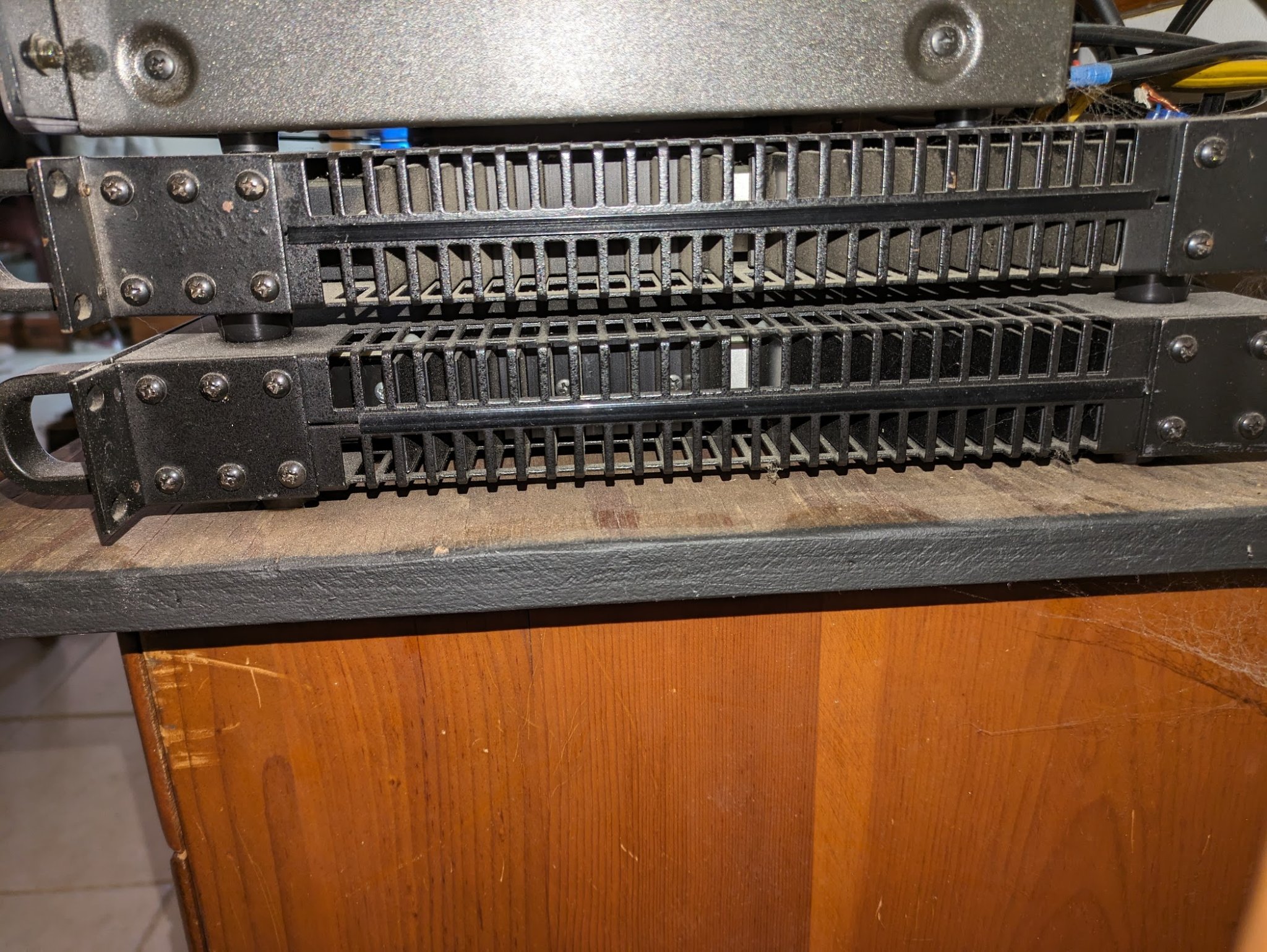

I cleaned the fan with a small paint brush and vacuum cleaner. The QSC GX3 has holes/vents on all four sides, with no specific inlet or outlet path. I will clean it on a yearly basis from now on.After cleaning the fan heat sink and pcb, I put a fliter over the fan inlet.
My QSC CX302 has one air inlet, several outlets.

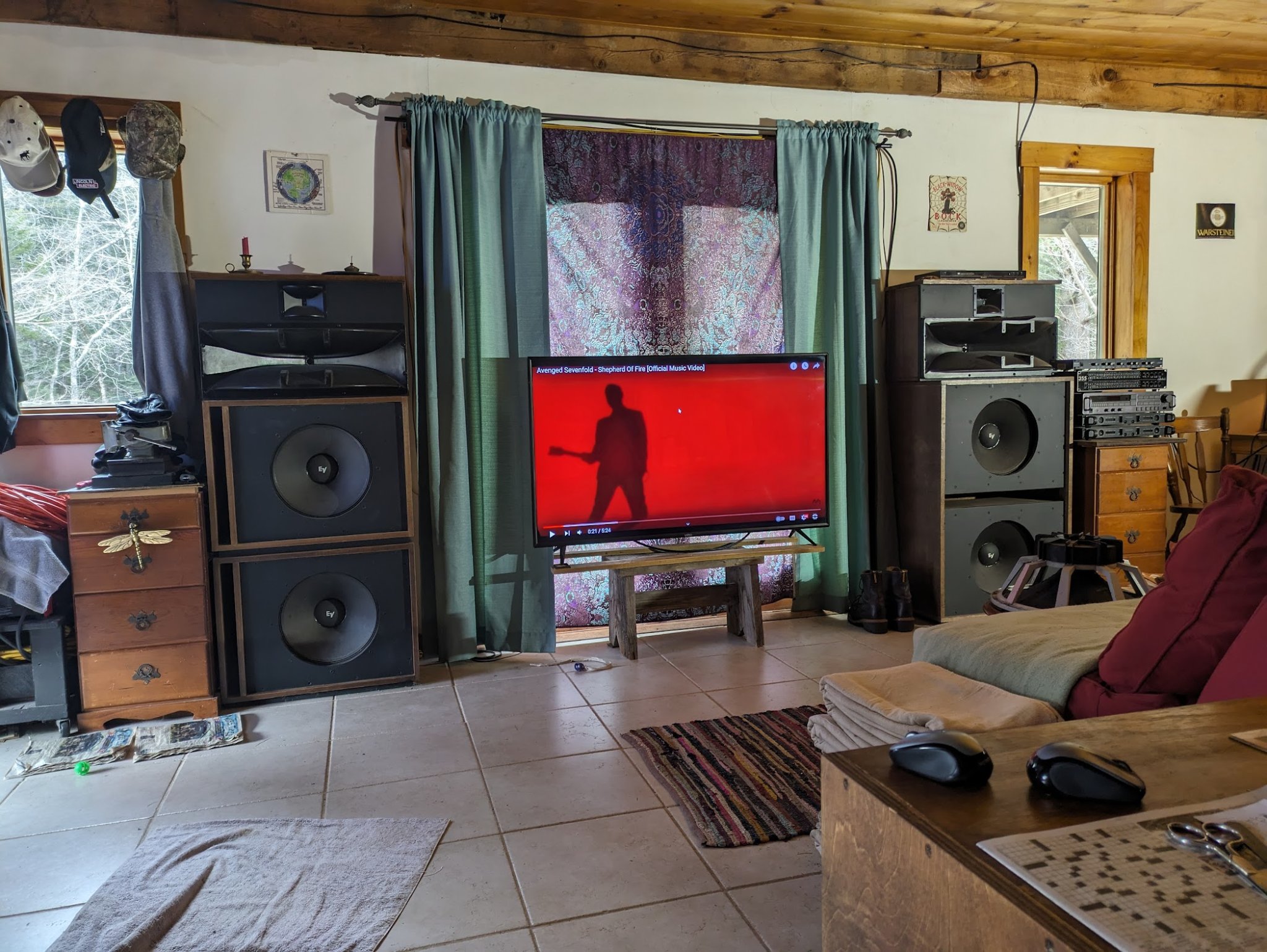

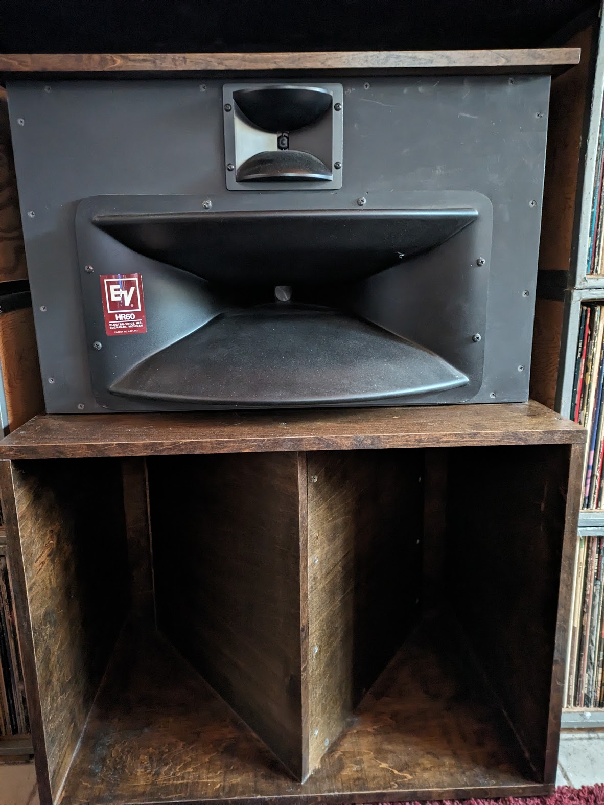

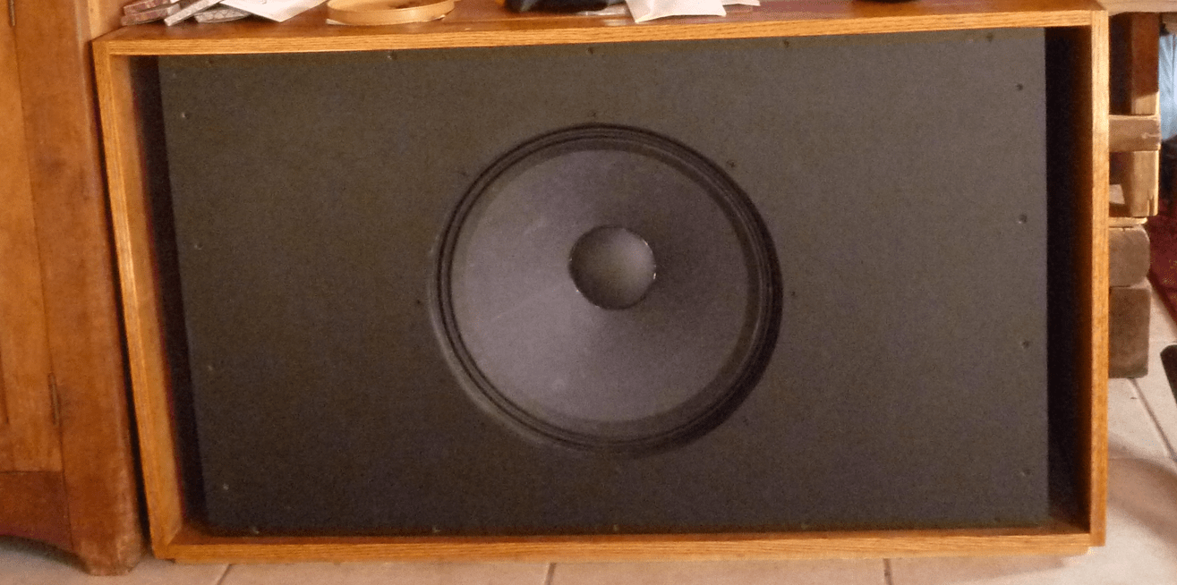

Hello Hugo - As for the QSC GX3. This amp has 2 channel stereo or subwoofer/satellite mode with a built in crossover. I use is as a center channel amplifier, using the crossover. My subwoofer below 100Hz is a cinema F-20 diy from Lilmike on the AVS forum. I use the McCauley 6174 as the motor. The center channel above 100Hz is a diy modified design of the Peavey FH-1, using all vintage Electro-Voice drivers. EVM 15B, HR60/DH1012A, ST350A.

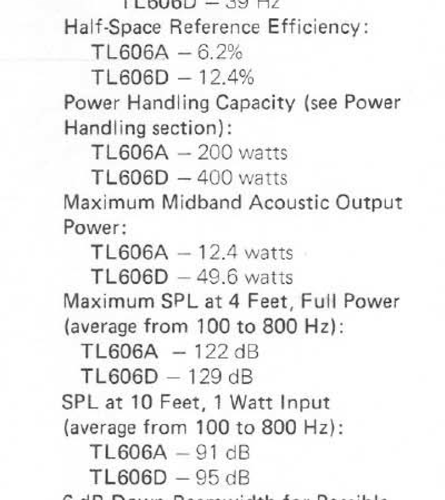

Hello again Hugo, you did ask. The QSC 3200 amps are used in another 2 channel system. Left channel is 2 x TL606 diy style cabs using EVM 15B, SM120A/DH1506, ST350B drivers. The right channel is a diy style TL606D for the bottom, easier build than 2 separate cabs, but harder to move. Using the same drivers. One QSC 3200 drives them stereo
. The other QSC 3200 is bridged to run my other subwoofer, a diy TL 405 style cab with the EV DL18MT.
