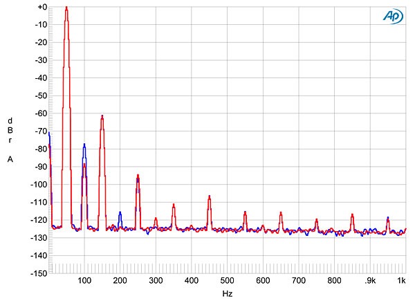

To set the stage, let me introduce the distortion measurements for the Ayre Codex. This is going to be central to the discussion later, so we might as well get it out of the way. Audiosciencereview measured the 3rd harmonic at about -68 dB at 1kHz. Stereophile measurements by John Atkinson recorded about -60 dB 3rd harmonic at 50 Hz (see Fig 7). Note that in both cases the output is essentially unloaded, the posted numbers characteristic of the Codex's amplifier circuitry rather than load-dependent.
Audioscience review - "Those THD+N numbers are almost two orders of magnitude worse than what I expected to see! SINAD of 67 to 68 dB is unbelievably low for a non-tube product."
John Atkinson - "As I have come to expect from the Ayre Acoustics design team, the Codex offers excellent measured performance."
Leaving aside the why, the "how" of it is understood when you find out how hot the Codex runs idle. The external chassis is cooking. (Side note: none of the components inside are heatsinked as far as I can tell from the photos.) This high operating temperature indicates to me the output stage is running very high bias currents. Doing so increases the rated maximum class A output power output but also increases distortion, regardless of whether any headphones are connected or not. This could be addressed by adding feedback of course, but Ayre chose not to. It could also be addressed by reducing the bias current. Again, Ayre chose not to.

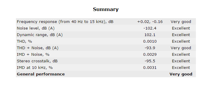

By comparison, my Sapphire4 as presently configured in closed loop mode posts 0.001% total harmonic distortion (mostly 2nd harmonic) and -93.9 dB THD+N.
Distortion measurements just provide a snapshot of the performance at a single signal amplitude and frequency, however. It's an excellent way to check for design flaws, but I wouldn't hold it as an absolute indicator of sound quality. An op-amp headphone IC will show lower distortion than the Sapphire4, for example (<0.0005% THD) but you'll never convince me it sounds as good. The Codex is in a grey area where the distortion numbers are high enough to flag as a potential flaw but not high enough to suggest an actual fault.

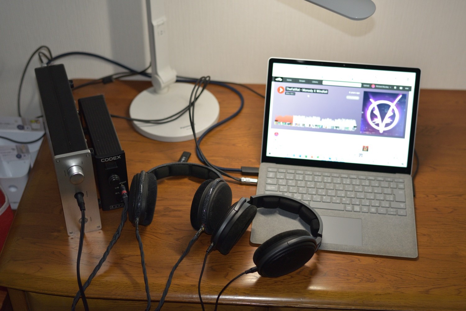

I evaluated the Codex using Sennheiser HD-600 headphones with balanced cables. The Codex was connected by USB to my Surface laptop running Windows 10 and using the Microsoft native audio drivers, all processing off. The Codex has no analog input to test the output stage separately from the built-in DAC, but I have no reason to think the DAC and digital volume control are anything other than top-notch.
The Codex is enjoyable to listen to. The overall timbre is neutral, detailed, and appealing. The soundstage is coherent and natural. Rhythmically it all sings nicely. It has two weak points: Lack of ambient clarity and lack of dynamic grip. The former can be described as muddiness/fuzziness. The latter, anemic, bloomy bass frequencies. With the Codex, my HD-600s (300 ohm load and admittedly a bit of a tough cookie to drive) sound distinctly soft. Neither weakness makes the Codex sound bad, not at all. What I'm hearing here is the output from a truly wonderful DAC/digital volume control being relayed through a highly competent but not outstanding headphone amplifier.
