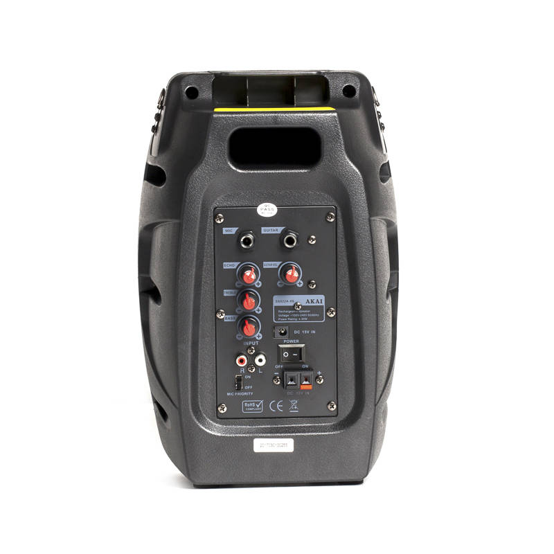

What is your portable PA?In essence, I want to use the wireless function of the cone mic (same frequency with my portable PA which also works on batteries)
Why don't you just connect the T10 reciever to your portble PA?
NONE. You could damage both mikes.They are not even the same technology. One is a DC powered condensor mike, the other with 2 pins is obviously not.My problem is I don't know which of the 4 pins to connect to the 2 of the "cone" mic.
The Shure reciever will run on 12v DC, if the speaker is battery powered as I suspect you just need a simple DC cable to power itThe portable PA is Akai SS022A-X6.
I just can't connect the T10 because the receiver needs mains power!
If you connect two mic capsules directly together and talk into one the other acts as a loudspeaker, and a live mic in a pocket will generate clothes rustling noises so this is a bad idea on several levels. The right way to do this would be to disconnect the capsule in the handheld and connect the wire from the headset mic, but then you have to secure the wire somehow and it becomes a point of failure and there is no guarantee the headset mic will be compatible with the reciever.. it may not generate enough signal. The wire between a lavalier or headset mic and it's transmitter is the most common point of failure with commercially produced products and they are designed with robust connectors and strain relief, so how long do you think your DIY solution will last?
Is this the speaker? If so is that a DC connection at the red/black push terminals at bottom right? If there is 12v there when the unit is on it would be dumb simple to power the mic reciever, you just need a DC cable pigtail with the correct connector on one end to plug into the reciever and bare wires at the other end.
