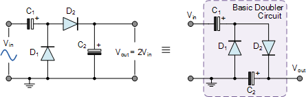

You could make a voltage doubler,

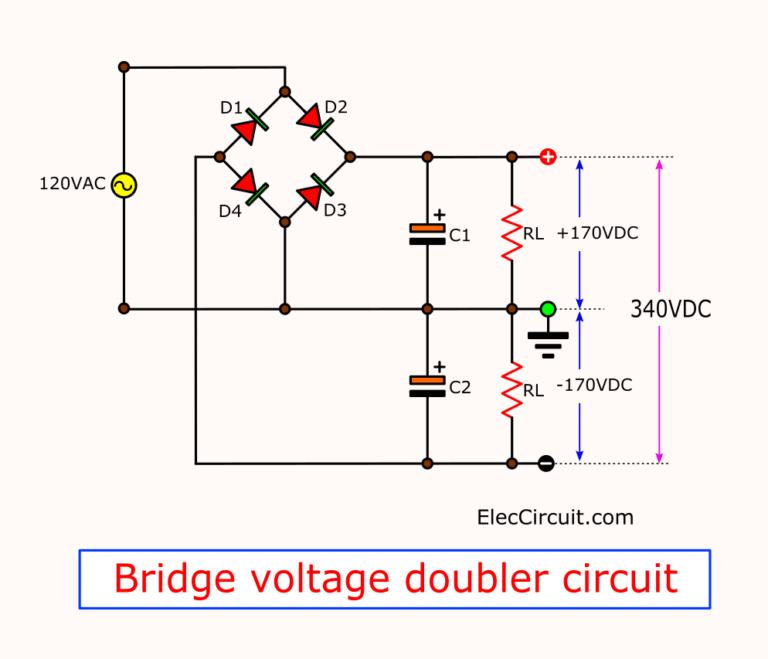

I dug out a couple of schematics a few weeks ago, so if they'll help:
Easy to test, and certainly enough voltage for the 7805 then!
  • Thank You
Reactions: 1 user

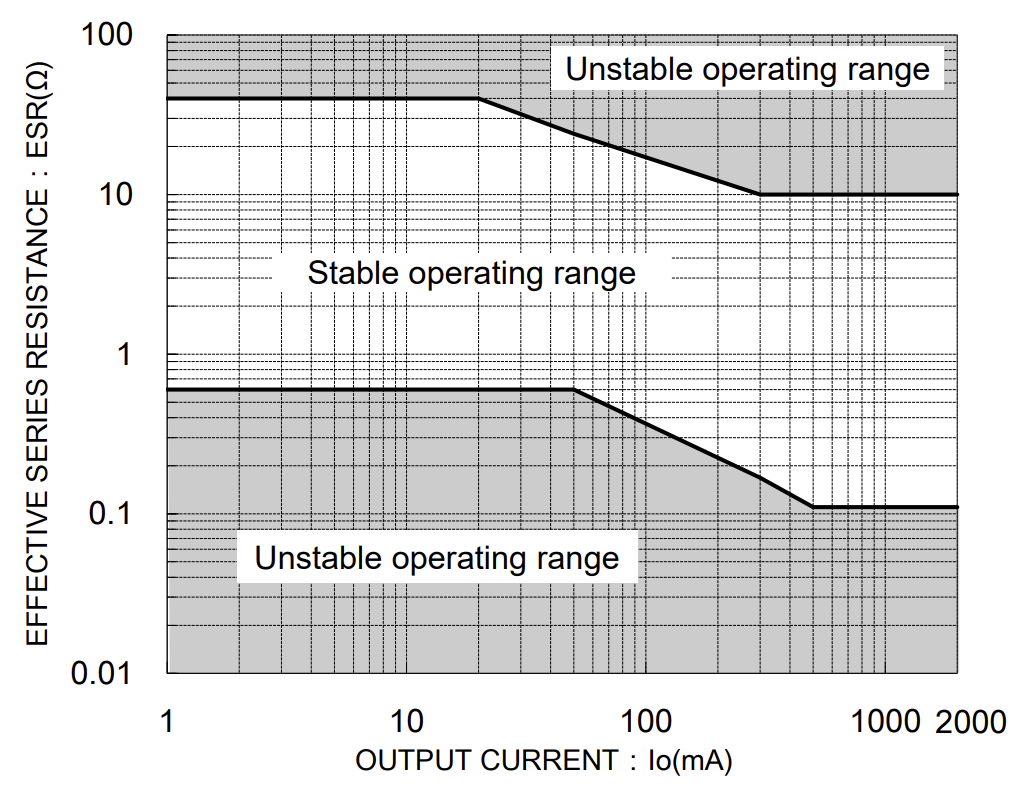

A low-ESR ceramic input cap (0.33) should be placed as close as possible to the IC (<1cm) regardless of the power supply smoothing caps.
The output cap needs to be between about 1-7 ohm ESR for stability.
Also make sure you have a bypass diode from the output to input, otherwise at power off the output cap will try to back drive the IC and damage it.
Reactions: 1 user

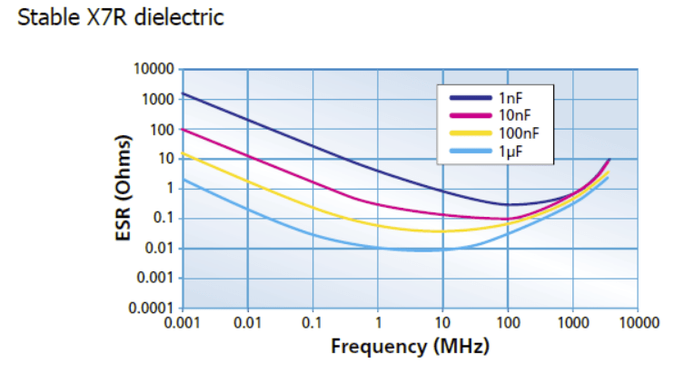

1 to 7 ohms would be extremely high for a capacitor's ESR. I'd deem such a capacitor defective. There are snubbers that have a cap and series resistor in the same package. The resistor dissipates the unwanted noise conducted to it by the capacitor as heat. The diode preventing backward current flow through a regulator upon turn-off is a good idea.
Those figures were directly from the BA50 datasheet for the selection of the input capacitor:
If you know the load is always going to be above 500mA, the ESR can be lower.
Also, bear in mind that the ESR is not a fixed value throughout the frequency domain:
