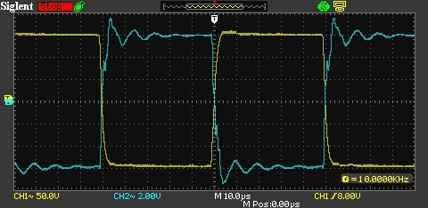

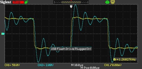

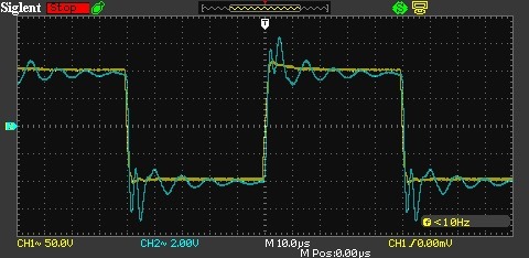

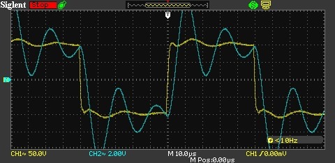

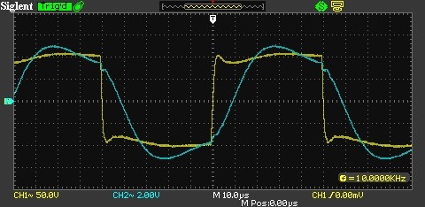

Ok, I think I have the compensation fairly optimized. I ended up with a 300pF cap and 34.2k resistor. Yellow trace is the plate of the output tube (where the feedback is sampled). Blue is the output transformer secondary. First picture is with 8 Ohms on the secondary. Second picture is with the secondary open. Stand by for tests with capacitors on the secondary...
Reactions: 1 users

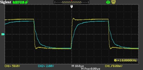

Next set of plots are with the secondary loaded with capacitors only. 1.5nF, 22nF, 100nF, and 330nF. 1.5nF looks pretty similar to an open secondary (slight change on the rising edge). As capacitance increases, you see increasing magnitude of ringing on the secondary with decreasing frequency. Makes sense. Since the transformer is outside the feedback loop, the feedback is only trying to control the yellow trace.
Reactions: 1 user

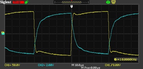

Next set of plots are with the secondary terminated with 8 Ohms and parallel capacitances. First is no cap, then 100nF, 470nF, and 2uF.
Things get pretty distorted, as expected, but no serious misbehaviors here.

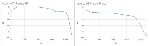

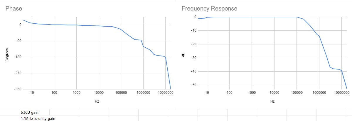

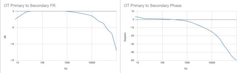

I figured out that my scope could measure phase between the two inputs, so I gave FR/Phase plots a shot. I just swept, recorded interesting points, and plotted from a spreadsheet. I probably need to buy a better signal generator that is flat to a higher frequency so that I can take these types of plots further up.
First plot is the amplifier input to output tube plate (everything in the feedback loop). Second plot is the output transformer primary to secondary.
I measured the output transformer primary inductance at 35.6H at 60Hz/1W.
Reactions: 2 users

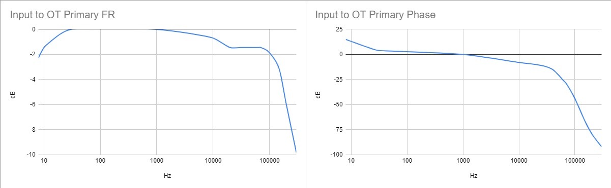

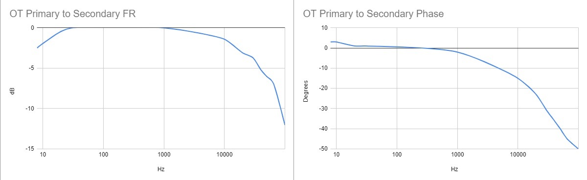

Well done for making a gain-phase plot - that's tough without automation. It was interesting to see the OT secondary plots, since they are decoupled from the feedback loop, so of no consequence for stability. What do you think is causing the -1.5dB droop and plateau? There must also be a main cause of roll off above 100kHz, apart from the 100kHz RC you recently introduced.
Reactions: 1 user
I think the -1.5dB droop and plateau is caused by the load that the OT presents, although the flat plateau area seems strange to me. The same feedback circuit with different compensation and the Electra-Print OTs had a much more ideal 10kHz square wave. All I changed was the OTs and I noticed the change in shape to the bump/dip/slow rise of the square wave above. After disconnecting the 8R load from this OT, I have a nearly ideal square wave on the output tube plate.
These are quite a bit bigger than the Electra-Print OTs. I also noted that the datasheet for the HQ-5090s shows all of the testing done on the 4 Ohm tap. I suspect that this OT is optimized for 5k:4 or 10k:8 operation, not the 5k:8 that I am testing. I noticed that my testing doesn't quite match the datasheet performance for FR/phase. Also the single small wire (compared to multiple wires for all the other taps) makes that tap look like an afterthought.

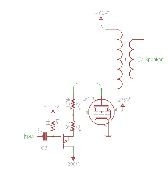

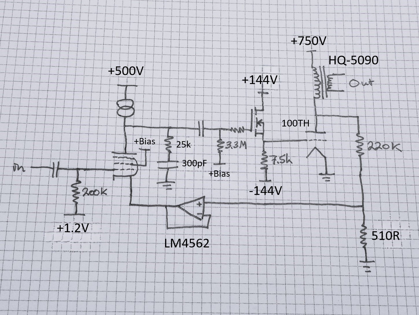

As I suspected this is a very interesting amplifier design.
I really like how the P mosfet is used to apply feedback to the input pentode's cathode. This is a innovation for me.
Slick how it separates the feedback voltage from the pentodes AC current and the cathodes impedance to ground.
I was working on a phono input stage where low noise and gain was a key goal and struggled to find a way to add negative feedback to the input device without adding any impedance in the cathode as that degrades the noise figure and gain. The P mosfet may well be a useful answer.
Going to try it out.

Getting 19 watts of very clean power from your relatively low rail of 525 volts is impressive.
The DF with 0.7 ohms output impedance is a workable low for many speakers and this is without feedback around the transformer.
Is the grid of a 826 piticullary rugged that allows the positive drive (and so grid current) without failure?
Wondering about trying other tube types that could deliver high current with positve grid drive in triode mode.

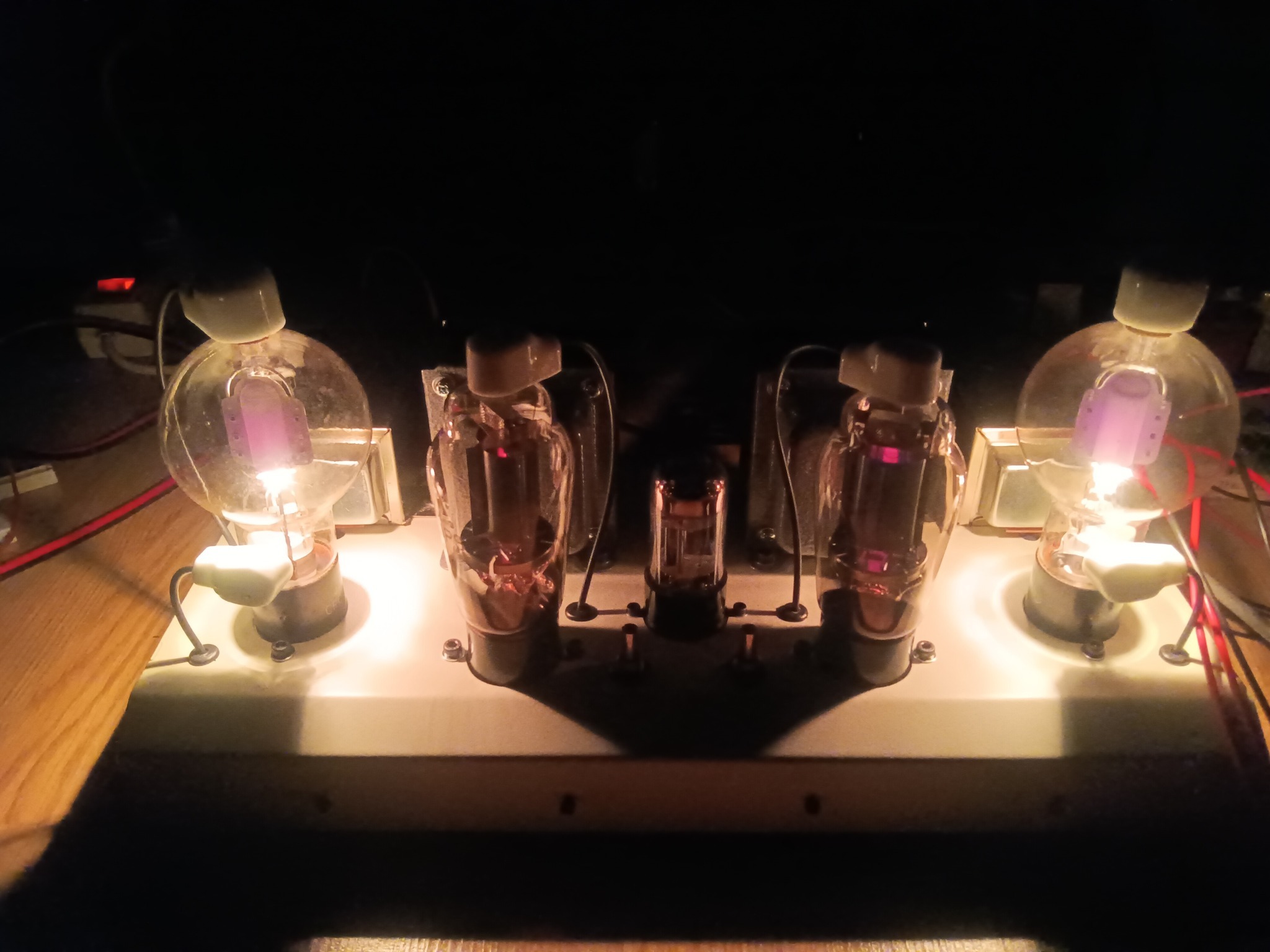

Ok, I know I said I was done messing with this circuit but I went and messed with it again. I went back to a 510R lower feedback resistor. This adds 8dB of feedback back in. This also forces me to put a positive voltage on the 6BN11 grid since that raises the cathode up so much more. I decided to just use a 1.2V reference.
I've looked at some square waves and tweaked the compensation a bit and am going to try to redo all of the measurements I just did. I just bought a much better function generator to make that easier and to expand the upper limit of frequency I can reach. This should be fun.
I've measured Zout. It went from 0.63 Ohms to 0.53 Ohms, so damping factor went from 12.7 to 15.1. That's a worthwhile improvement.
I'm compiling the results from some soundcard testing. I'll post those soon.
Reactions: 4 users

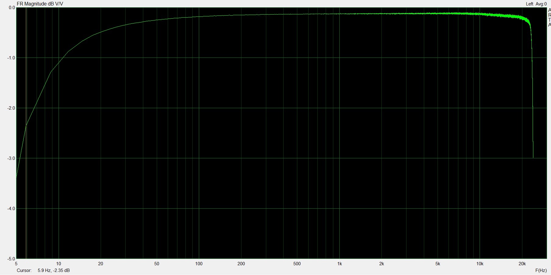

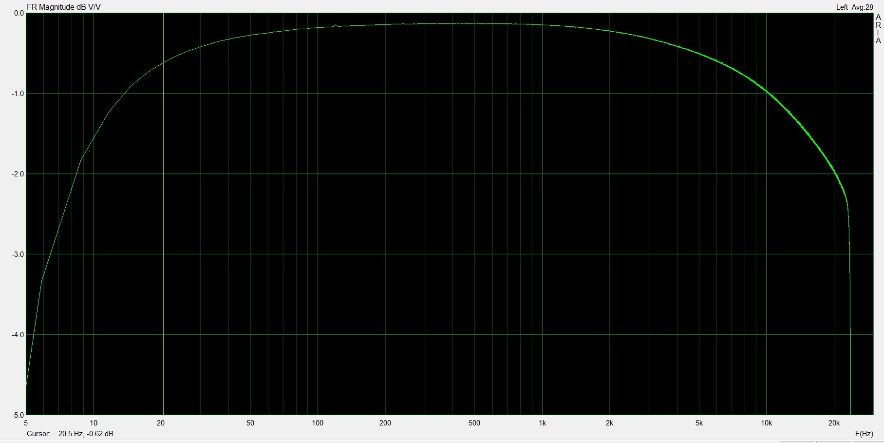

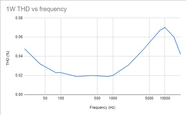

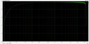

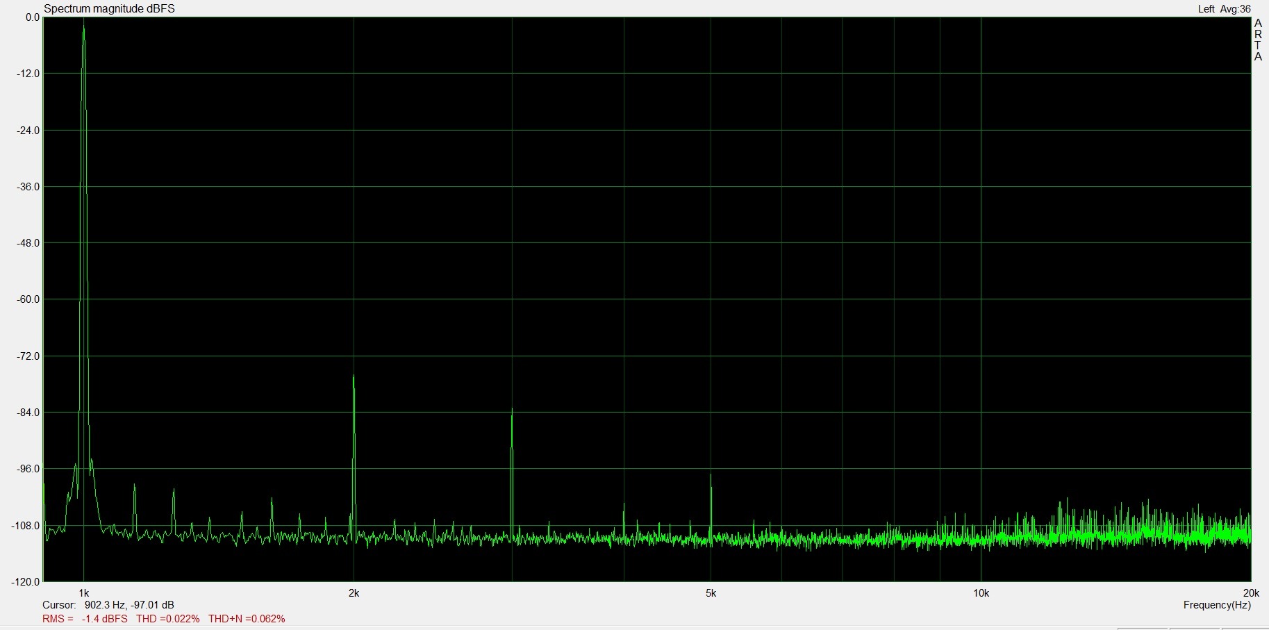

Ok, I did a series of distortion measurements at 1W across the audio band. Results are attached. Distortion falls above 10kHz but that's just because the distortion harmonics go above what the measurement setup can see.
I attached the distortion spectrum at 1kHz. The distortion harmonic character does not change as I sweep frequency so I didn't bother capturing pictures of all of the other frequencies.
I also attached a small signal frequency response measurement (and a measurement setup loopback test for reference). All of the distortion/FR measurements are measured across an 8-Ohm resistive load on the output transformer secondary.
I'll redo the gain/phase measurements/plots with my new signal generator next.
Reactions: 1 users

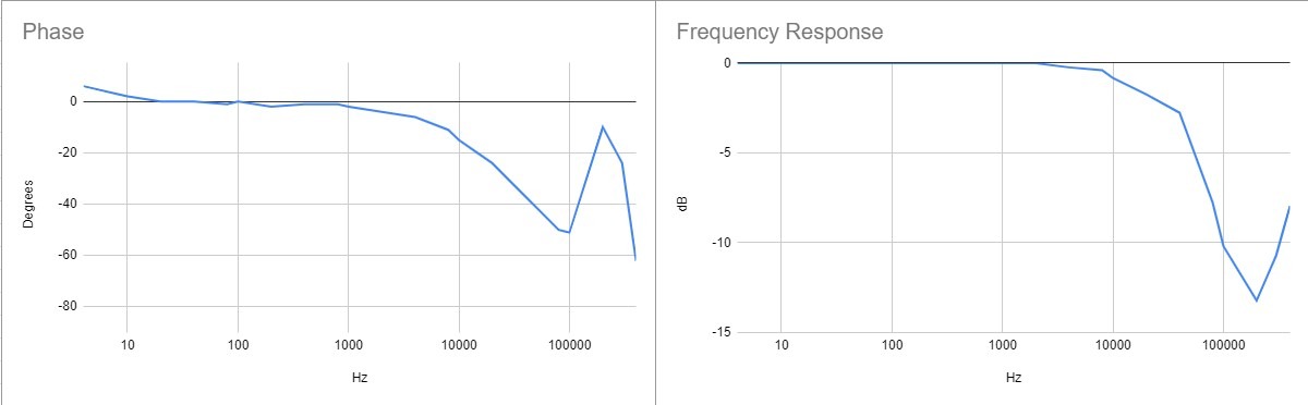

I redid my gain/phase plots. This time I was much more careful to adjust out output variations in my signal generator (or my amplifier when I was testing the output transformer). I question whether my measurement setup is really able to measure these phase angles at really high frequencies. I have to go all the way up to 17MHz to get the amp to unity-gain and the phase goes every which way before it gets there. I just don't know whether to trust it, especially with different probes on the two channels.
Reactions: 1 user

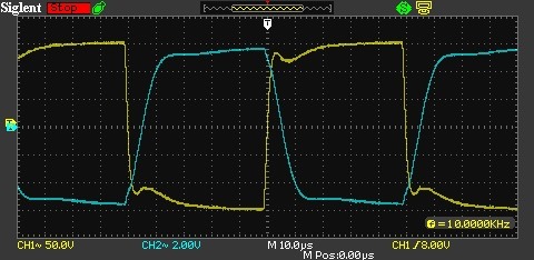

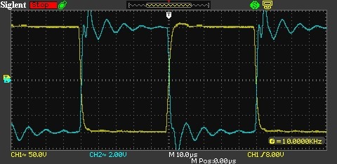

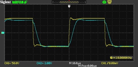

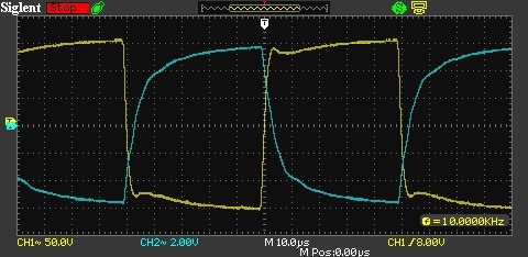

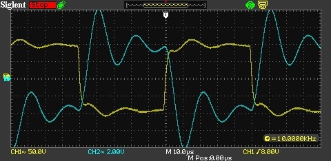

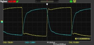

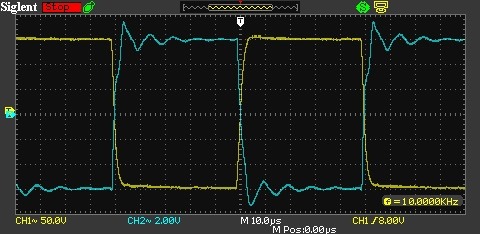

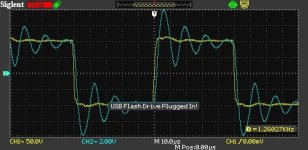

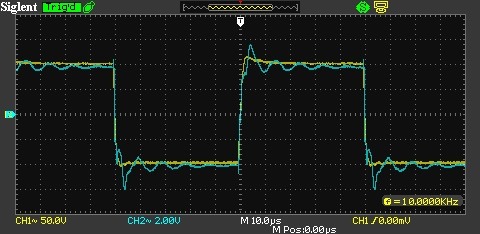

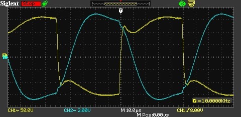

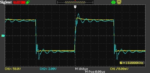

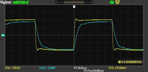

I have been testing my test setup and I hooked both inputs up to the same source and started seeing differences in phase on my scope at 1MHz. At 17MHz, there is like 25 degrees difference between the channels. I have to use a 100X HV probe for the output tube plate, so I'm not surprised that there are differences. It just casts doubt on everything in the above gain/phase charts above 1MHz. It was a fun exercise, though. Maybe I can work my test setup to improve that some day.

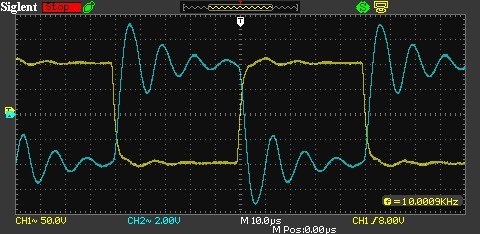

Attached are 10kHz square waves with various loads. Yellow trace is output transformer primary and blue is output transformer secondary.
To summarize, things look fairly similar to before adding more feedback, but primary waveforms look flatter on top. They have a little bit more overshoot peak, but the overshoot is still small.
Reactions: 3 users
On the topic of "taming" hi Z transmitter triodes:
The Corona topoloy in this thread seems to be an excellent way to hold pretty much any output tube in an iron grip and squeeze some very impressive distortion and dampig factor numbers out of it, far into solid state territory except for a little bit of Zout left due to the DC resistance in the OPT secondary winding.
What if the ambition is allowed to be a bit lower, like applying local feedback around an 811A or similar to make it behave roughly similar to a 300B running open loop? I saw this schematic in a blog that I guess belongs to the thread starter and thought it should be possible to add a direct-coupled Nfet follower between the feedback resistors and the grid:
Ale Moglia did something similar here but with a coupling cap between the feedback network and the buffer, something I'd like to avoid if possible:
https://www.bartola.co.uk/valves/2022/03/14/811a-se-amplifier-with-a-twist/
Yeah, that's my blog.
I would think your idea of putting a follower to drive the grid after the feedback divider would work well.
