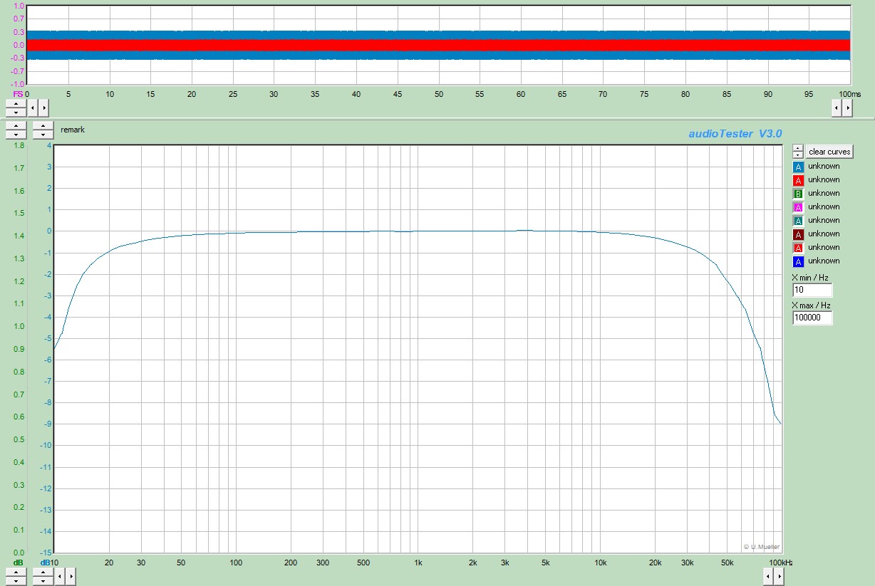

Very few 10-11k OPT goes further than 20-25kHz ... Lundahl is not among them.
The figure below shows similar amplifier's (CCS loaded 841, source follower, PSE 801a, 5k:8 custom wound OPT, 1W) freq. response.
As you can see, the medium ratio transformer easily reached 50-60kHz HF bandwidth (at 8W 50kHz).
Yes, the bandwidth is compromised by the high internal resistance of the 801A combined with the parasitic inductance / capacitance of the high impedance OPT. I had hoped to reach 20kHz, -1dB @ 20kHz would have been acceptable, but that was optimistic. Using a medium ratio OPT requires a PSE output stage, or else the output impedance is too high to damp my 8ohm speakers. You have answered many of my questions euro21 🙂 prototyping this amplifer has been very educational, I now understand the pitfalls of a high ratio OPT.

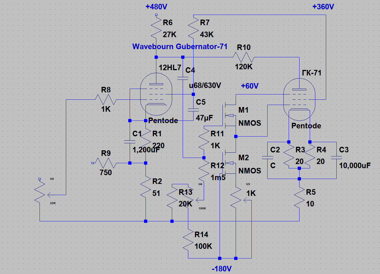

Nice design, I like it. 🙂
I still have driver boards fabricated for the Gubernator-71 that was very similar. But the first pentode was not CCS loaded, it had feedback divider in it's anode. The driver tube was 12LH7, the output tube was GK-71 with 850 V on anode, 450V G2, and 56V G3. The same 56V was used for the drain of the driving MOSFET loaded on a CCS. The amp produced 45W on onset of soft clipping.
Is the Gubernator-71 a commercial product you are keeping a lid on or do you have a schematic released to the public somewhere?
GK-71 looks like a fun tube! I've thought about buying a Chinese 211 to adapt to this amp and see how it goes. I think it would work really well. Of course, I'd have to buy some bigger output transformers first.
Well; it supposed to be a commercial product, but I don't think that I will manufacture it in the nearest future. I do not have a complete schematics, just a fragment. I hope it helps.

Hi Anatoliy,
Very clever design, hats off. I bet it sounds great! I like the way you feed the follower from the G3 supply. How did you derive the G3 voltage level needed (e.g. measured, listening)?
