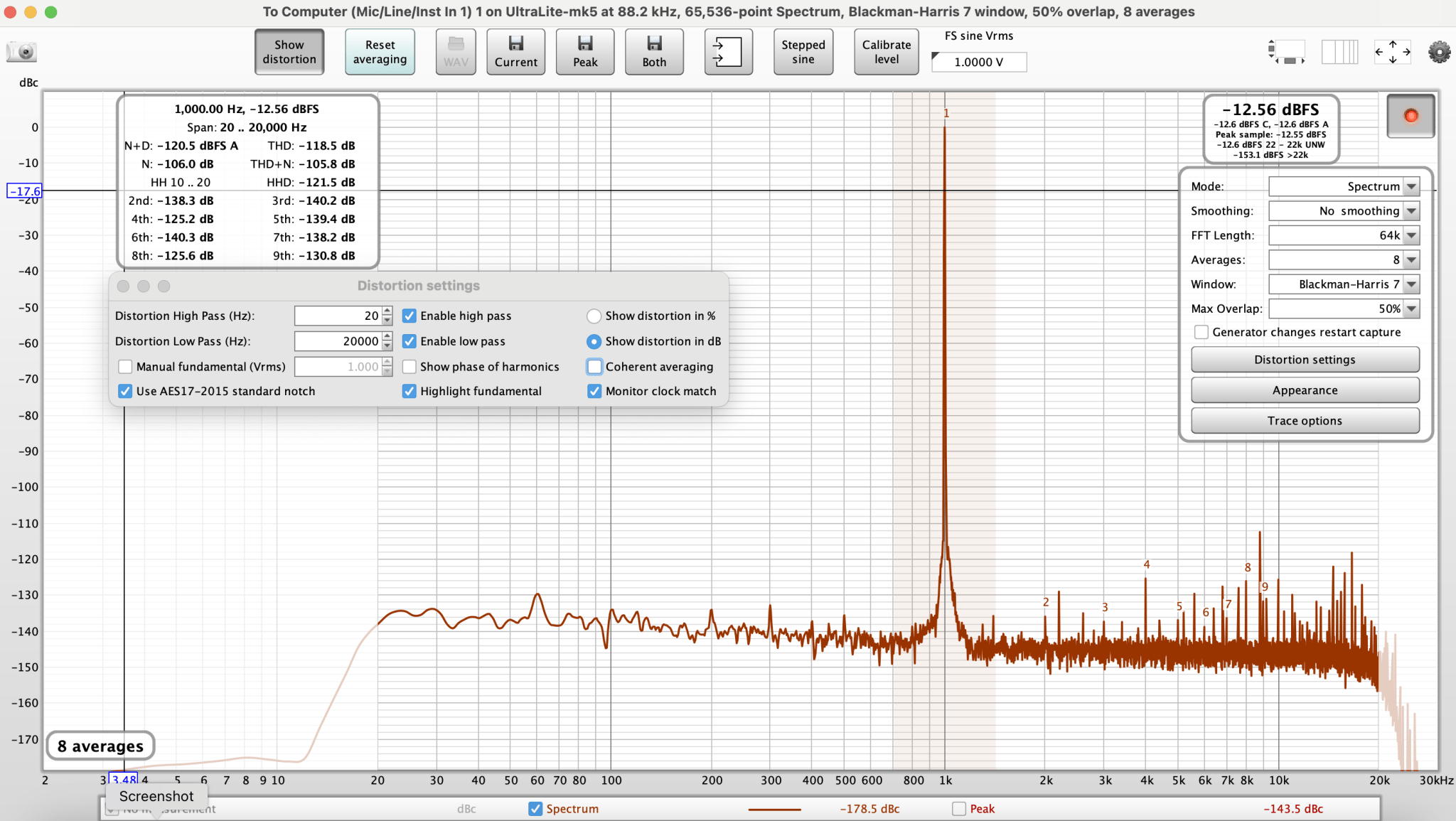

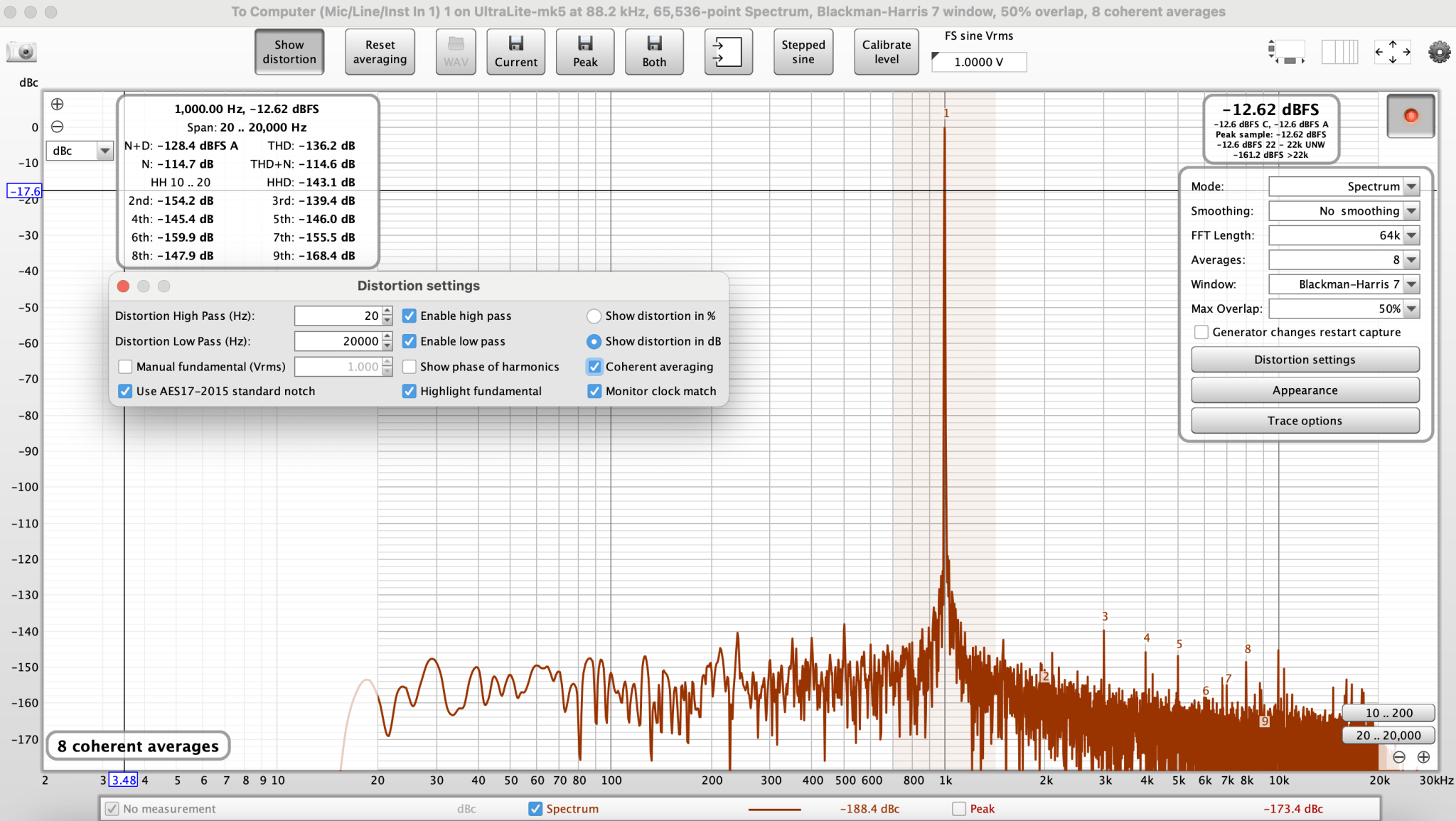

Victor's osc arrived. I just powered it with SMPS for a quick measurement. 2.2Vrms out
With coherent averaging, the harmonics jump all around so I have to choose a good capture.
So far, the Cosmos APU's H3 can resolve -140dB so the unit that I have looks operating normally.
Here's with Motu Ultralite MK5 DAC and ADC (with APU in the middle)
You must use „Show phase of harmonics“ option, with coherent averaging. Otherwise, distortion numbers are from 6 to 20 dB better than in reality. Or just install latest REW 5.30.With coherent averaging, the harmonics jump all around so I have to choose a good capture.
https://www.avnirvana.com/threads/“show-phase-of-harmonics”-changes-calculated-distortion-in-case-of-coherent-averaging.12631/
https://www.diyaudio.com/community/...ion-measurements-with-rew.338511/post-7475209
https://www.avnirvana.com/threads/v5-30-beta-release.12707/

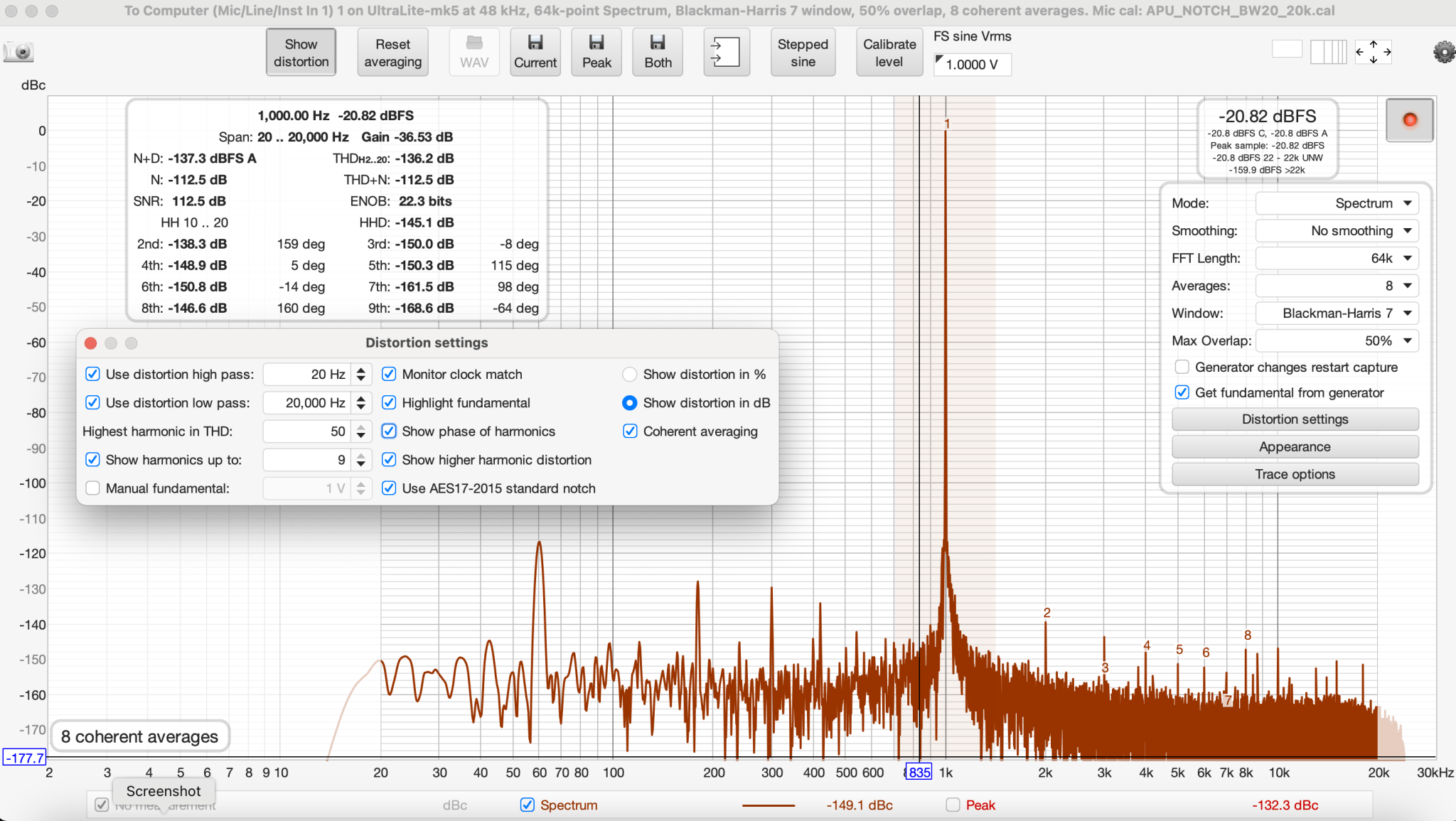

@tombo56 thanks for the headsup, I've installed the latest version.
@IVX APU is set to 0dB. Maybe some problem with Victor's power supply as it is directly connected to LRS-350-36, cabling is also shoddy.
Victor's osc
Victors osc with coherent avg

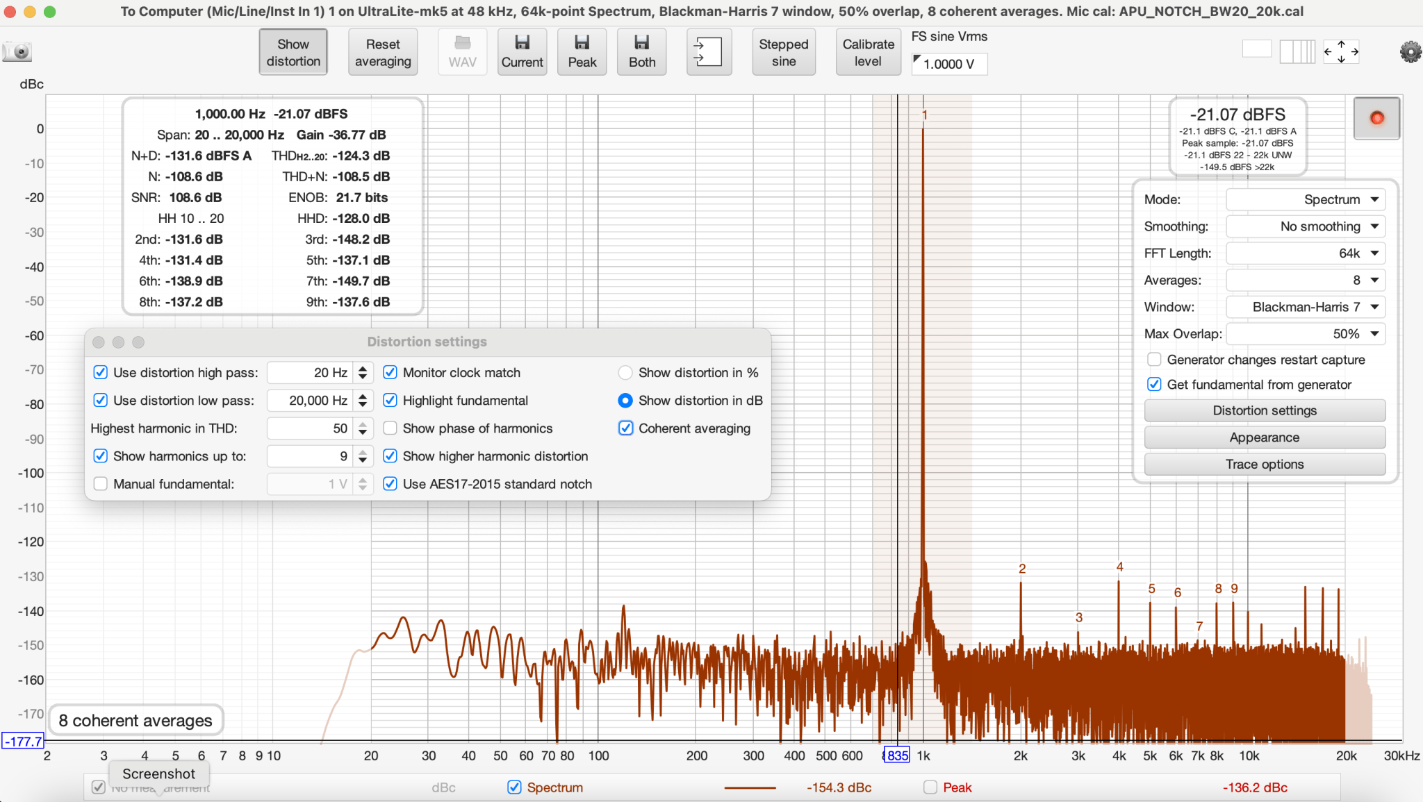

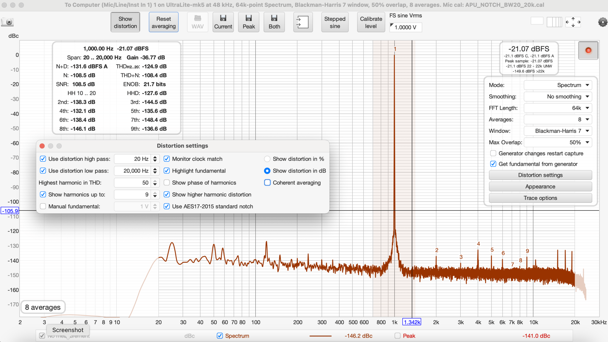

Here's with Motu UL MK5 DAC + ADC with 1.8Vrms output.

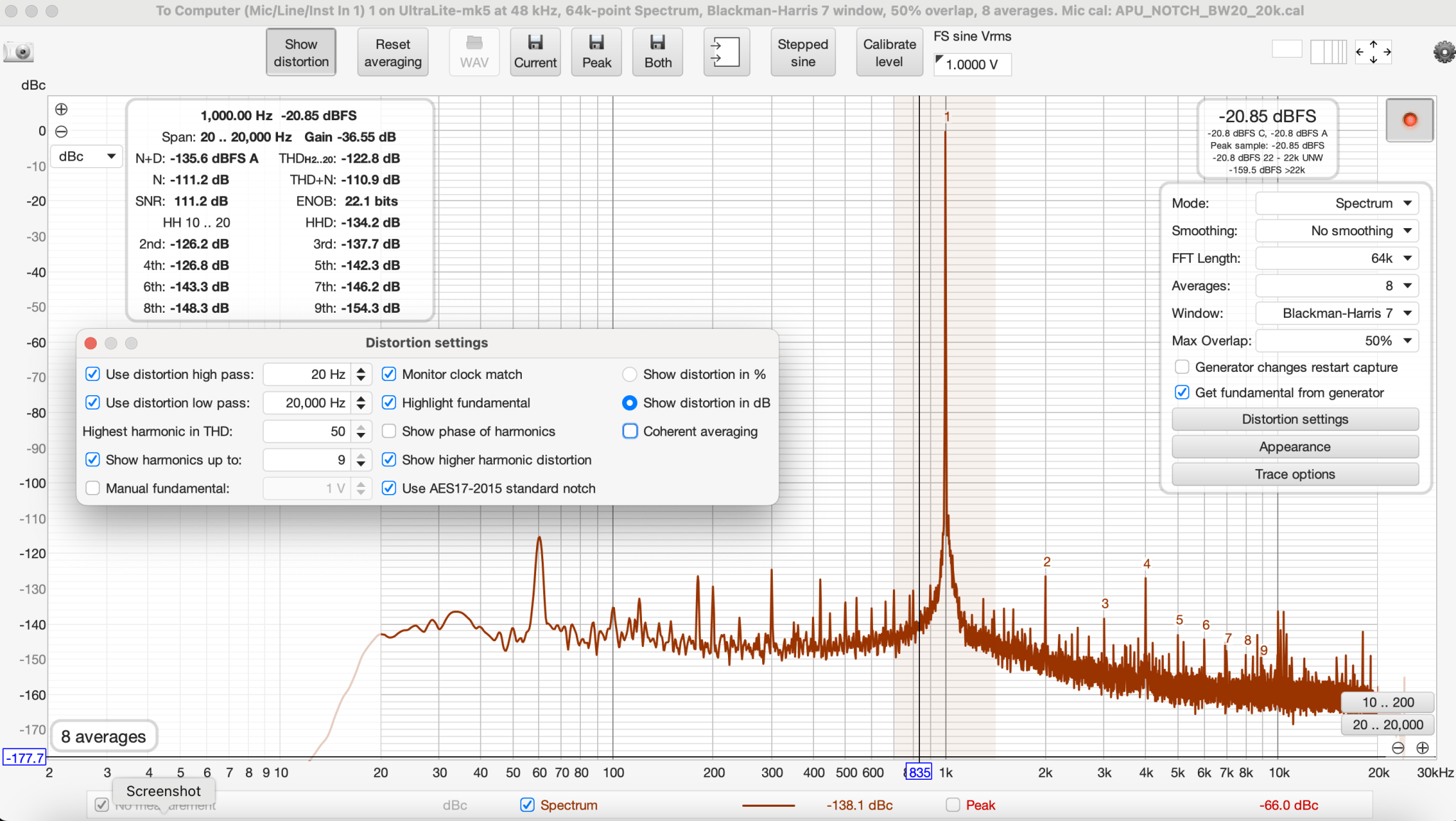

Without coherent avg
Victor's osc

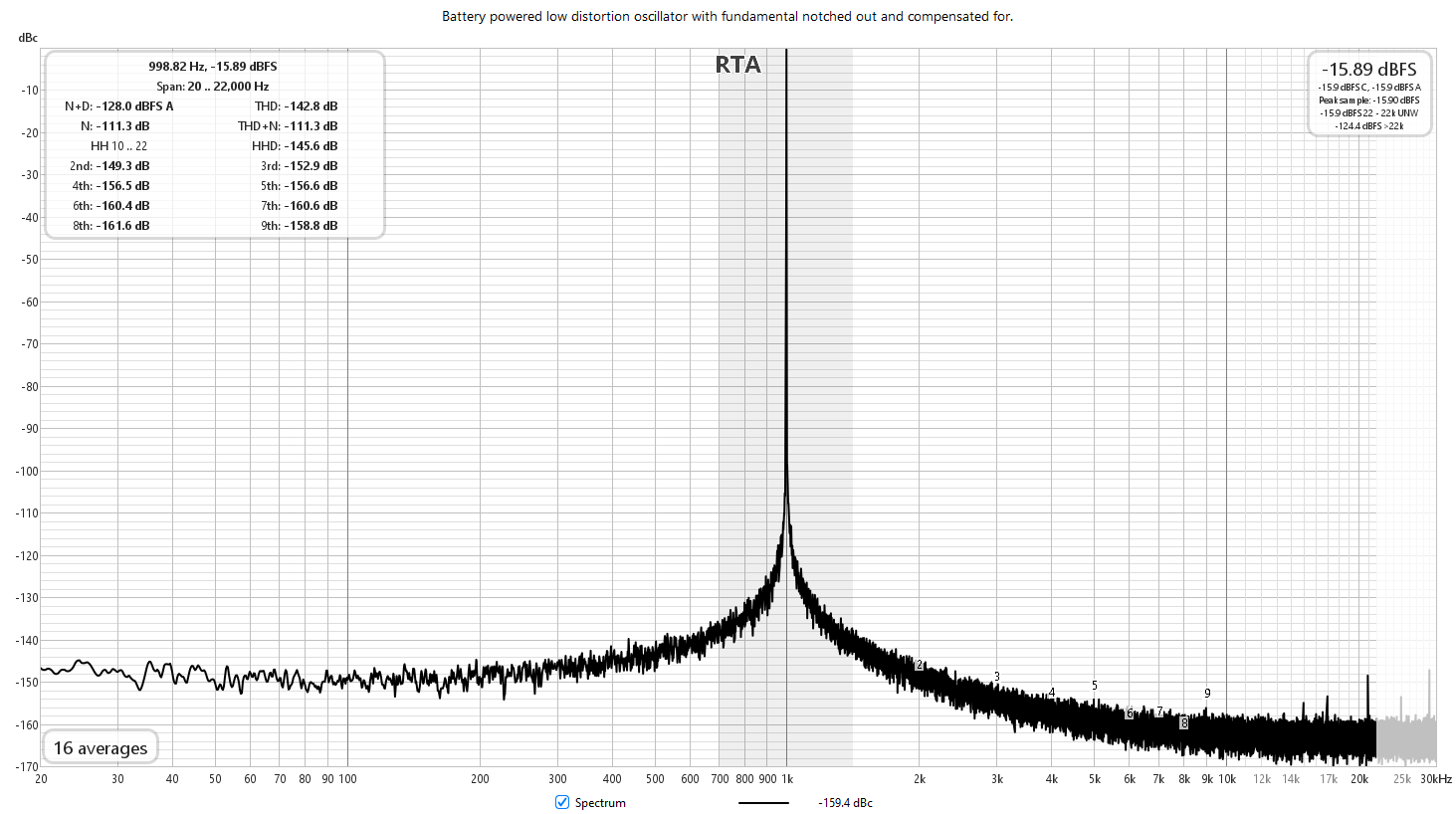

Something does seem amiss with your Victor oscillator set-up.
This is what I get. This is a much older - maybe 10 years old - oscillator from Victor into a Cosmos Scaler set for 0 dB of gain to a Cosmos APU to a Cosmos ADC. Battery power for the oscillator. The oscillator was set for -0.5 dB from 2Vrms output. 384 KHz sample rate. No coherent averaging. This was made with the previous version of REW, but since coherent averaging is turned off, I'm not sure that matters for this.
I see that newer oscillators from Victor have a much better "base spread" from oscillator phase noise than my earlier version does. Progress!
A couple other observations...
You can save a screen shot of the RTA window by clicking on the camera button in the upper left. No need to use Windows screen capture.
Since you're using the high pass filter at 20 Hz, there's no real need to start the spectrum display at 2 Hz. 20 Hz is fine.

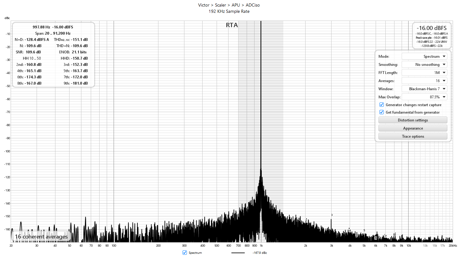

Actually, the 3rd harmonic gets almost 20 dB worse when working into the 10K load of the APU instead of the 100K of the Scaler. I just checked that now.
But, as I said, my oscillator is probably 10 years old. Victor has made a lot of improvements since then.

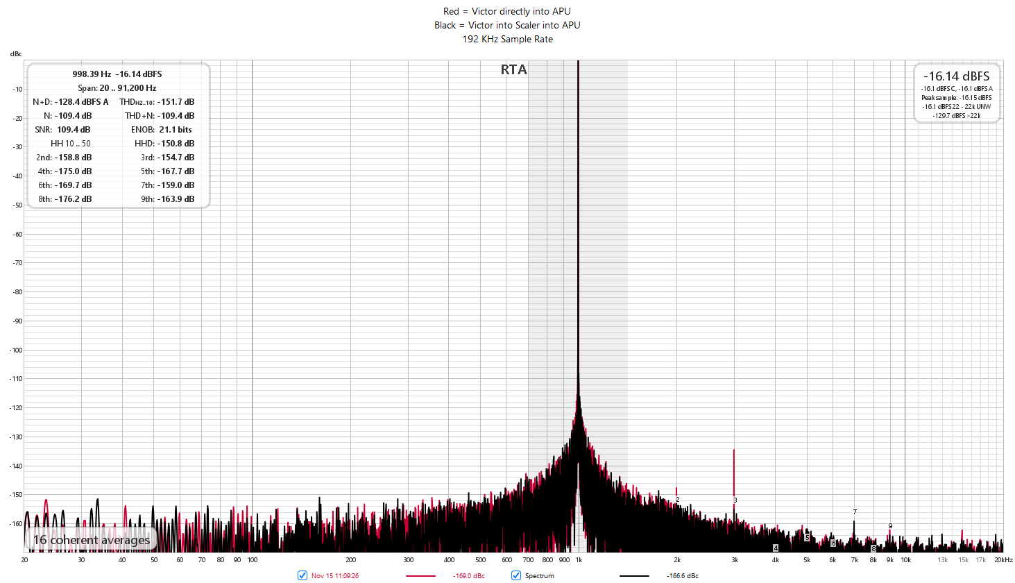

This is what I just measured.
Victor oscillator > Scaler > APU > ADCiso. Same levels as before, within a tenth of a dB.
This is the latest version of REW, with coherent averaging turned on.
