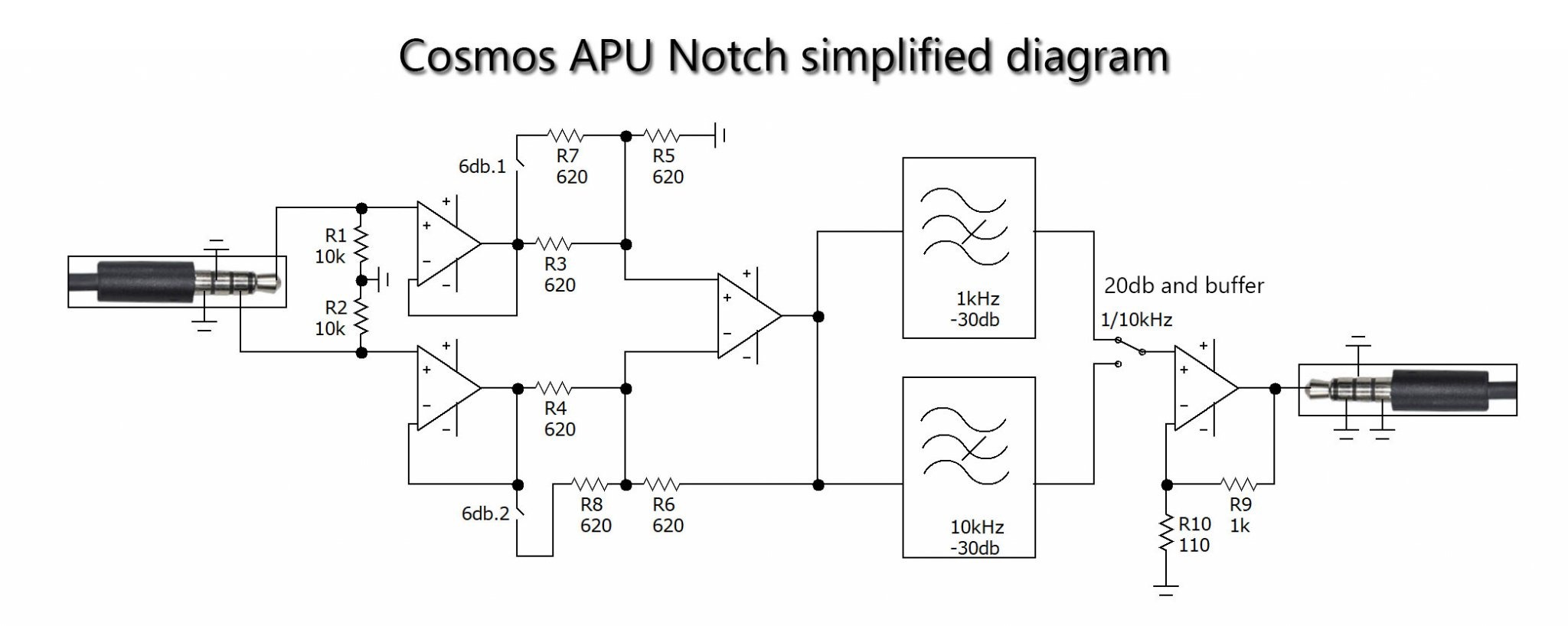

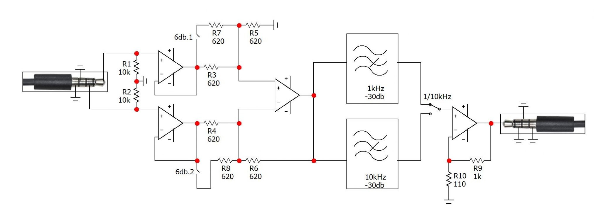

I receiving strange questions regarding APU's Notch, and really don't understand what to reply. Probably, not all users really understand how the device works and so on. After all, I decided to draw a simplified diagram of that, I hope it helps.

Another thing is, when looking at your'e nice simplified diagram (which is a very good thing to show IMO), i don't understand why the add of +20dB and buffer at the end of the chain, this does not sum up with 30dB in my head.
Please explain further, I (or proberly others) need more indeep explanation.

lykkedk, APU has an active Notch filter 1/10kHz switchable but the ratio of notching is -30db for both frequencies. You can simply subtract that number from your REW reading to get the actual THD+N. Of course, you can get better precision if build the calibration file as Archimago did but not necessary. For example, I made that file just by my hands.

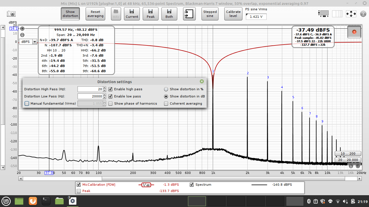

@IVX, good explanation about the active notch giving attenuation of 30dB, makes perfectly sense. Thank's!
But it's still not clear to me, that when using a calibration file - are you sure that REW will calculate the correct number's according to the 30dB attenuation?
If i'am not using the manuel fundamental box when using my 1KHz notch in REW, the THD numbers are way off.
Sry. for my ignorance, i know you are lightyears ahead of my knowledge IVX...
Would it be possible to show the use with REW and a calibration file here perhaps?

Why not sure, just simply subtracting 30db from the THD+N result is match AP measurement +/-.5db or so.@IVX, good explanation about the active notch giving attenuation of 30dB, makes perfectly sense. Thank's!

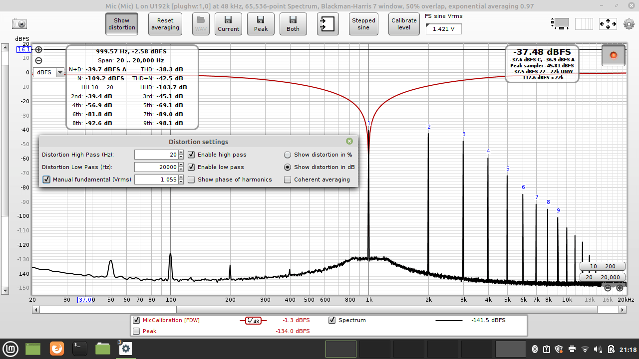

Yes i know that you are right here, when compared to AP it's also verified @IVXWhy not sure, just simply subtracting 30db from the THD+N result is match AP measurement +/-.5db or so.
Today i took some measurement's with my H2 generator (Nelson Pass's). Setting the H2 around 1.1% (~ -40dB)
I took the measurement's first directly into my Behringer soundcard, and afterwards with my 1KHz into the chain
The number's are more or less equal with and without notch, witch they should be when noisefloor and THD's are way above the soundcards own internal one's
Direct :
Notch in the chain (with mic. calibration file loaded & manuel fundamental set) :
And last; Notch in the chain (with mic. calibration file loaded & manuel fundamental NOT set) :
With calibration file loaded in REW, and manuel fundamental NOT set, i can subtract my approx. -37dB my notch gives me, this way i got the right numbers
This dosen't however not work if calibration file is not loaded, then the number's will be more than 10dB off.
I accept, that the Cosmic APU is just plain -30dB for getting the correct number's, but i don't get why it's possible without calibration file...
Well i see that REW is not used often here, and i guess that other program's due this differently. - Maybe it's just this which trick's me.
I'am just trying to learn here
Thank's...
Jesper.
