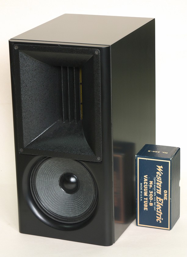

Crescendo: Eureka! 100db from a 30L Cabinet - 65hz to 25khz
One big horn ribbon
+ one 8" carbon composite hi eff driver
+ 30L mixed composite cabinet (baffle plate solid wood, sides and back laminar, top/bottom NZ mdf) to kill resonance
+ all film cap and oil paper copper foil inductors
+ physically time align the drivers
+ crossover 1st order at 600hz
= 100db/w in room or 98db/2.83v/1m with a very pretty response 65hz to 25khz, 8 ohm impedance
We will sell this as a kit hopefully with the front baffle plate as that is difficult part. Getting prices on that now.
Cabinet is 19.5" (50cm) tall x 10" (26cm) w x 14" (36cm) deep
Hoffman rusts?

Looks interesting!
There's no reflections or anything off the bottom of that horn (from the cone), or since the crossover is relatively low, I'm assuming they're insignificant at those wavelengths?
I know price is TBD, but are we talking 500/pair, 1000/pair, 1500/pair, in those sorts of ranges?
Reactions: 1 user

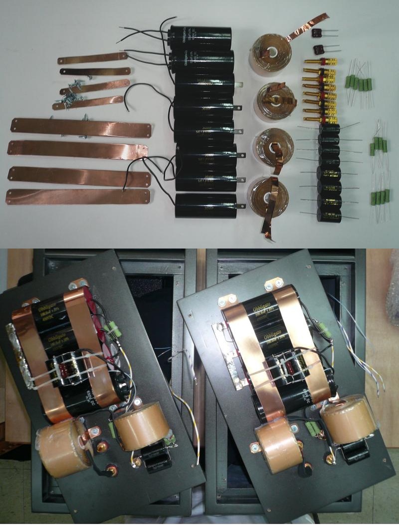

The Crescendo Crossover
Our horn ribbon crosses over in the 600hz region. Such a crossover requires big caps but we don't want to pollute the purity and transparency of this awesome ribbon by using electrolytics.
As shown, this is an all-film cap deal, retained with pure copper straps (non magnetic and good damping). Part of the recipe also calls for the tinfoil and silver mica caps shown to capture that elusive 'sheen' quality that is usually only heard in live performance of strings, cymbals and voices.
Add to this silver wire, pure copper binding posts and carbon film resistors.
The inductors are our own, made with imported oil paper and copper foil and of course air-cored.
Just wanted you to see. These kind of ingredients would be at home in a 50K$ system.
Crescendo -- bringing it home, alive.
Reactions: 1 user
Looks interesting!
Yes, you nailed it. The crossover is low so reflections aren't an issue. The advantage of that alignment is the woofer flange is mounted from the inside in a flared opening which allows for time alignment with the horn.
As soon as we installed the drivers in this configuration we heard more coherence and seamless blending of the drivers.
Price: I have to sit down with a calculator and see where we've landed with all this. We haven't held back in any way with quality parts so it will be in the upper range of your stated numbers.

Crescendo Crossover
The Crescendo crossover combines extreme simplicity with the highest quality possible. The crossover between the Crescendo HF Ribbon/Horn combo and the Crescendo LF section is at 600Hz with first order slopes.
The Crescendo HF Driver is fed though a Obbligato Oil Capacitor with a small amount of attenuation to match the SPL of the Crescendo LF Driver implemented using Kiwame carbon resistors in series with the capacitor. A set of Obbligato Tinfoil Capacitors with a Silver/Mica bypass capacitor act as "speedup" capacitors, connecting directly to the Crescendo HF Driver and binding posts, bypassing the Obbligato Oil Capacitor and the attenuation for very high frequencies.
The Crescendo LF Driver uses the RC low frequency tuning network described in the enclosure section. This is realised with three Obbligato Polypropylene Film Capacitors (100uF/400V) and Kiwame resistors.
The lowpass is realised using our own copper-foil & oiled paper inductors. A further copper foil choke is used for a antiresonance RLC circuit which corrects the drivers impedance and frequency response in the crossover region.
This is it. As minimal as possible with no attenuation and only minimal equalisation to avoid sucking the efficiency and life out of the speaker , yet at a level of parts quality only found in the most esotheric High End designs.

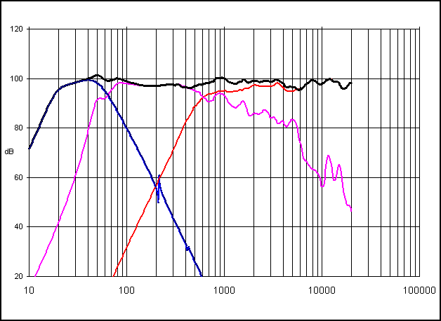

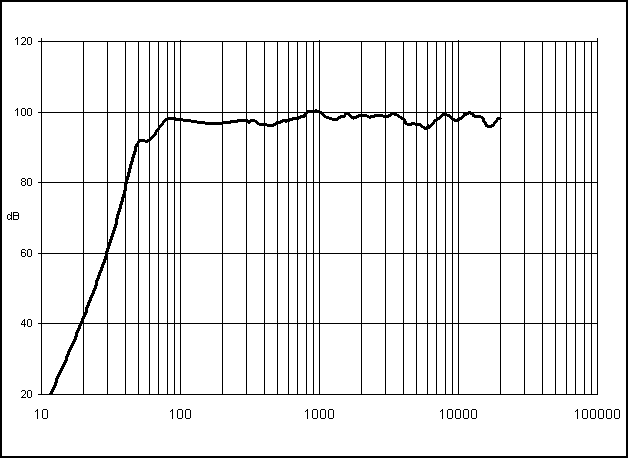

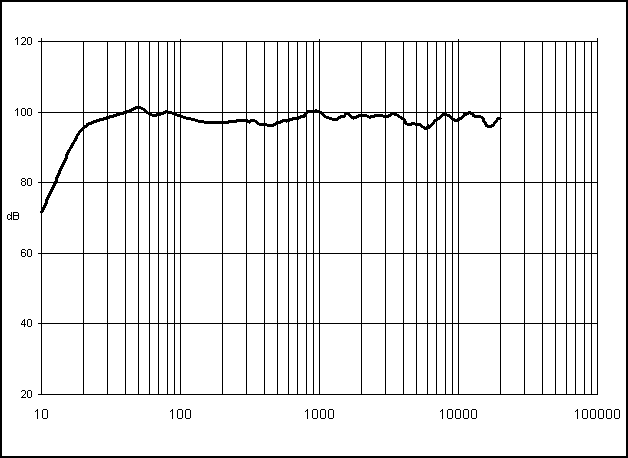

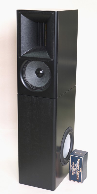

Crescendo Grande, Hoffman and Heresy
The rule, no The Law is: efficiency, small cabinet, bass - pick any TWO.
So we've picked efficiency (100db) + small cabinet (~30L). Of course the drivers used are very special so even with our small cabinet we get down to about 65hz.
What can we do for the rest of the bass, down to 20hz or so? The only way to cheat The Law is to make up for the small cabinet with POWER and clever design.
So we have our compact MLTL cabinet with its special loading. We have the Dynafone which can put out really loud clean bass, handle loads of power (500w program) and be comfortable playing in 30L due to its low VAS.
But what about the POWER? The horn ribbon/cone section has a 10+ db headstart over most any compact bass driver. So 1w of sound from the Crescendo scales to about 10w to get the same sound from the bass unit. A 400w amp would be huge, until now. The Reckhorn sub amp puts out that 400w. A pair of them driving the Dynafone bass module can achieve in room spl of about 125db!
In case the idea of letting a digital amp into your system gives you the jitters: digital amp's one true home is in the bass. Just think, huge bass waveforms sampled into thousands of bits - what could be wrong?
So, the world's first small footprint 100db 20-25khz speaker system.

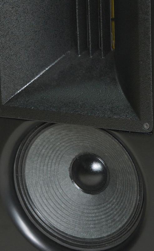

Crecendo: Customers Ask, "why the overbite"?
Why does the edge of the horn block part of the cone?
  • First, the cone remains unobstructed. Only the surround is covered. Second, as the crossover frequency is at 600Hz the wavelength of the sound is around 57cm. Any obstruction that is much smaller than 1/4 of this essentially has no impact. The key is the distance between the horn acoustic center and that of the woofer. Due to the large size of both items the distance becomes quite large and approaches around halve the wavelength, so it needs to be minimised as much as possible to ensure correct integration between the drivers.
Given the nice chamfering around the main driver assembly, how does this 'lip' affect the sound?
  • Not at all. The chamfering both around the driver cutout and on the edges has no sonic impact whatsoever. With only 18mm radius chamfering it only has any impact above around 5KHz, as has the overlap.
How critical is the distance between the drivers?
  • The crossover would require re-design if the distance is significantly altered.
can the drivers be successfully pushed a little further apart to overcome this interference?
  • They cannot be pushed further apart, but then again, there is no interference to overcome, so there is no need to.

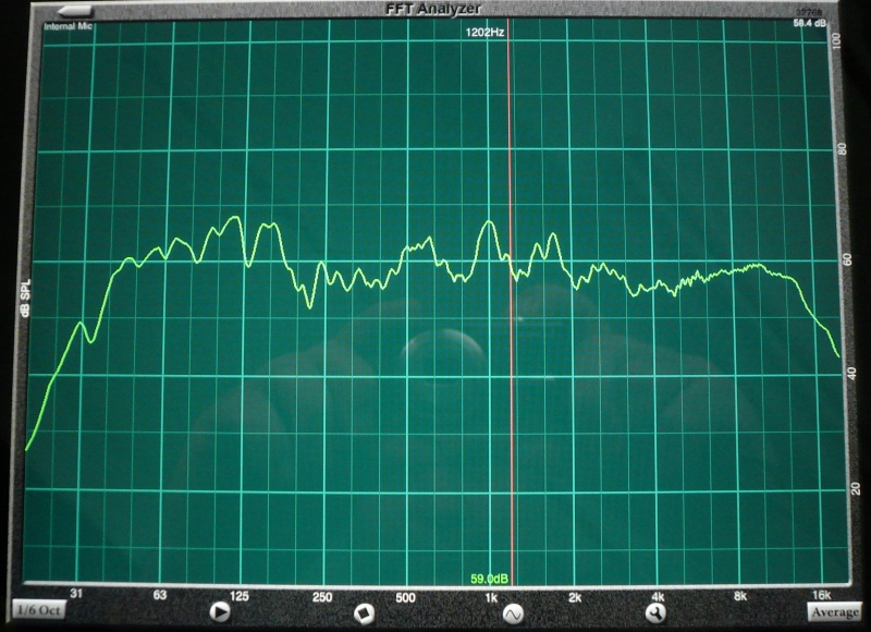

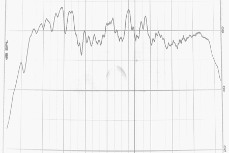

Folks,
I just found a in room, stereo pair measured response at 3m distance.
attachment.php
Measured via iPad, pink noise played on the system, 1/6th octave smoothing.
So ignore the highest and lowest frequencies (the iPad Mike is not very good for that), also be aware that measuring a stereo pair will create comb filtering...
The room is around 100sqm and full of shelves. This graph below is an attempt to scale the FR for an approximate comparison with the Stereophile Graphs referenced later.
attachment.php
The measured response compares poorly with the common 1m, single speaker, anechoic or pseudo anechoic measurements.
A good comparison would be the in room responses JA publishes for some speakers in Stereophile, however unlike my one these are spatially averaged and only one speaker, so look smoother...
The two below are respectively:
Wilson Audio MAXX (blue) and Magico Q5 (red)
Audio Note E Lexus (blue) and Voxativ Ampeggio (red)
Ciao T
