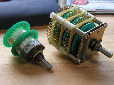

This is what I'm using. Elma on the left can be bought from Michael Percy for $57 (BV22568). With 24 positions and special contacts for audio it's not bad. I used it in my DAC and it works fine. All you need is 50 resistors. In my premp I would probably use Electro Switch on the right. But I don't know where to get it.

Peter: I assume the Elma (BV22568) is not 5K either but it is so called 2 gang and sells for $57? Where do you get information on how to wire up those 50 or something resistors and what values of the resistors? I hope it comes with instructions.
Anybody: As previously posted by Mark and I wanted to know too .... where can one get 5K pot? 2 gang, switched attenuator or whatever you call it. Thanks in advance.
