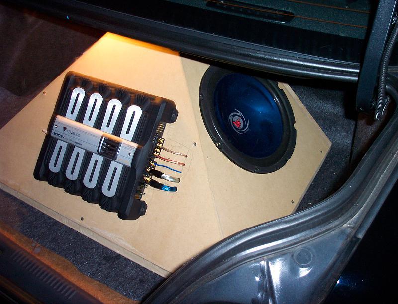

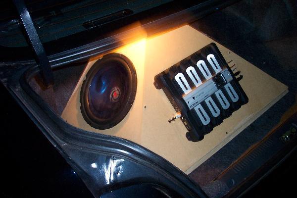

Got my subs in the car (in my old box), they are hittin so hard yo can see the drivers side rear quarter panel move in and out!!! and my right rear tailight is rattling. Hopefullly, all will be fixed when i put my permanent box in there.
Ran into some troubles...Planned the box dimensions out wrong so now i have to take out the entire back seat to slide the subs in!!! Runnin the wires was fairly simple, and we hid them well. I'll have pics up soon of the uncarpeted box, then later on, the final product.

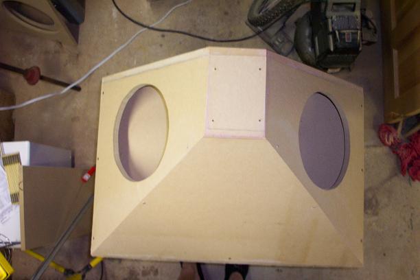

Since I didn't put a divider in the middle to separate the chambers for each of hte subs i am hearing some interference. I was wondering if anybody knew how to figure out the volume of my enclosure. I looked around, but couldn't find any formulas because of its unconventional shape. And I can't pull the bottom off and fill it w/ something then put that amount into a known volume because I have already sealed it shut. Trying to find out the volume because if want to put two ports on the back of the enclosure and I have to have the volume of the box to figure out the port size (altho if you guys don't think porting the box is the best option, let me know).

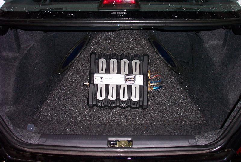

Re: Carpeted view
Take it out so that the Mrs can get the shopping in. I had to make a new install that laid flat so that the boot could still be used!
Well done - it looks fab. Don't forget that cars have a natural Bass boost at about 50-60Hz and this may well be the "interferance" that you are hearing!
