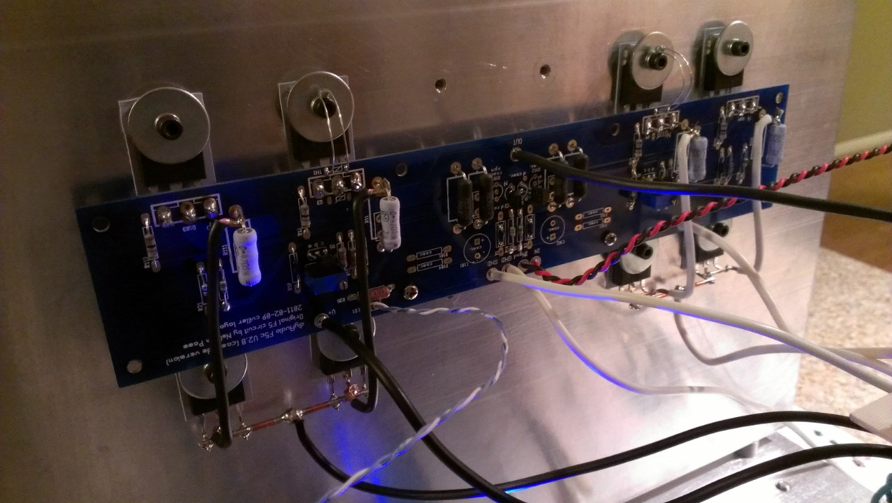

the F5c boards, will make the double output F5 Turbo, Ill end up with 50w F5 ? will it also make Version two ? can i make V2 work with this board ?
Yes, the F5c boards can make F5Tv2, and can easily achieve 50 watts class a into 8 ohms, if you have the rail voltage and enough sink to bias it. You will have to hard wire P3 and the parallel source diodes.
here is a pic of mine. It is not cascoded, and I did not install P3. Its not difficult to build it this way, or you can wait for turbo boards.

Old thread I know, but I am looking into building a Turbo V1 with this version of the cviller F5 pcb, which I just picked up in a bundled purchase. The main question I have is about the difference in the thermistor circuit. In the Turbo circuit, one leg of the thermistor/2.2kR combo goes through the source resistor before hitting the voltage rail, while in the original F5 circuit this leg connected directly to the rail. I suppose that there really isn't a huge difference at first glance considering the resistances involved (2.2kR and 0.47R). It will not be difficult to wire this board to follow the new design, but I'm just curious whether it's necessary or at least a good idea to do so. Any guidance on that would be appreciated, thanks!
Also, I knew that the V2 could be built on this board (and similarly the F5c board), but the previous post on this old thread makes it look even easier than I expected! Nicely done :)
