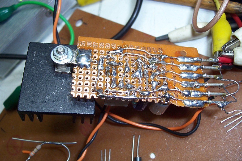

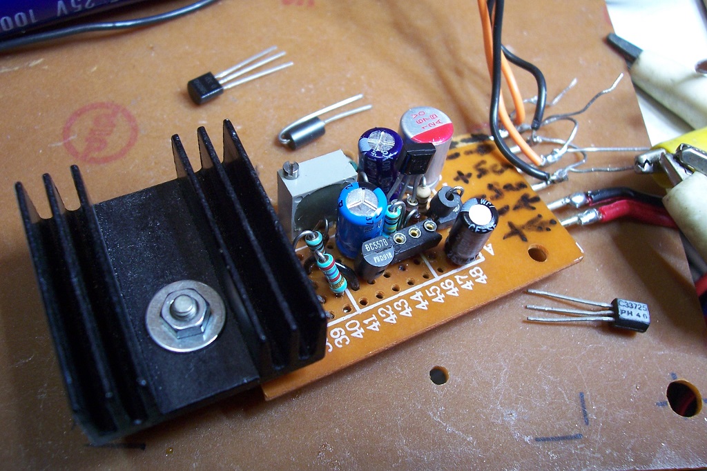

I haven't done photos (I forget my phone at home, but my lab is at work). It is about 7x20 mm, with three 30-40 mm wires.

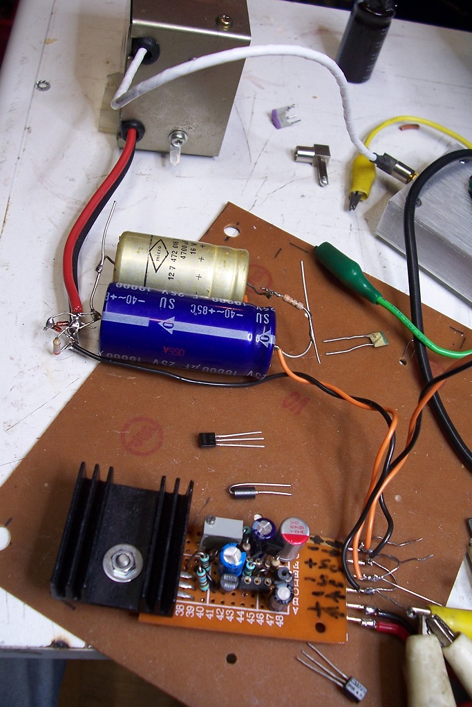

I have now remeasured the output noise in good conditions: it is <0.3µV in a 10Hz to 10kHz bandwidth;
nothing particularly exceptional, but it all depends on the auxiliary transistor, an ordinary BC337 in this case.
The figure could be improved by using a really high performance, low noise transistor
Indeed, and thanks again for that.
As I took care to keep them in a safe place, separate from my main stock, I had some difficulty locating them.
In the end I found most of them.
The KSC1845 was disappointing, at 0.6µV
The KSC3503 is already better than the BC337 (which itself isn't bad at all): 0.25µV
The 2SC6043 manages 0.2µV and the ZTX851 0.16µV, but for those two, the actual value is certainly better: most of the noise appears to be mains-related, fundamental and harmonics.
The hum was already present with the BC337, but since it was not really dominant, it didn't bother me too much.
With better transistors, it becomes the main contributor.
The test-jig is breadboard-based, and this makes it susceptible to stray fields present in the lab.
I have also tested other devices: the mythical 2N4401, but they are disappointing: the NS manages 0.25µV and the Motorola 0.3µV, short of audiophile expectations.
A generic S8050 purchased from China did a little better: 0.22µV

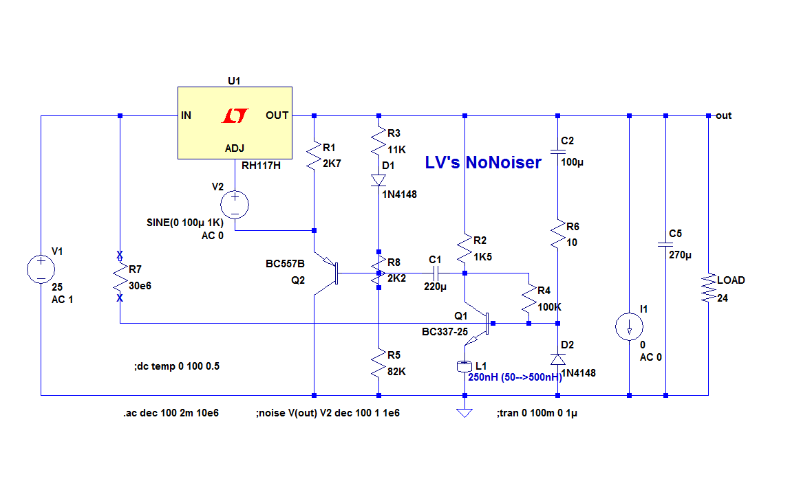

Here is the NoNoiser....
It is a standalone regulator derived from the Denoizator, and it is based on the same principles, but the performances are pushed to the maximum.
attachment.php
An additional transistor is used as a follower, to increase the loop gain and to ease the trade-offs regarding the coupling capacitors, amongst other things.
Its quiescent current consumption is ~the same as a native 317 regulator.
The performance improvement is purely AC, and the DC accuracy is even somewhat sacrificed to this end, but it remains acceptable, and for audio-oriented circuits AC performance is paramount.
The DC stability just needs to be sufficient, which it is for 99% of the cases.
The situation would be different for metrology-oriented applications, where both aspects are important.
The Nonoiser is a super regulator: compared to the archetypal Jung superreg, it brings improvement on all key aspects, but of course there is no great merit in that, as Jung's regulator was designed ~30years ago, when the technology was less advanced.
More interestingly, it also beats all modern alternatives: this page includes a survey of the main superegs available:
Super Regulator – diyAudio Store
How does it compare?

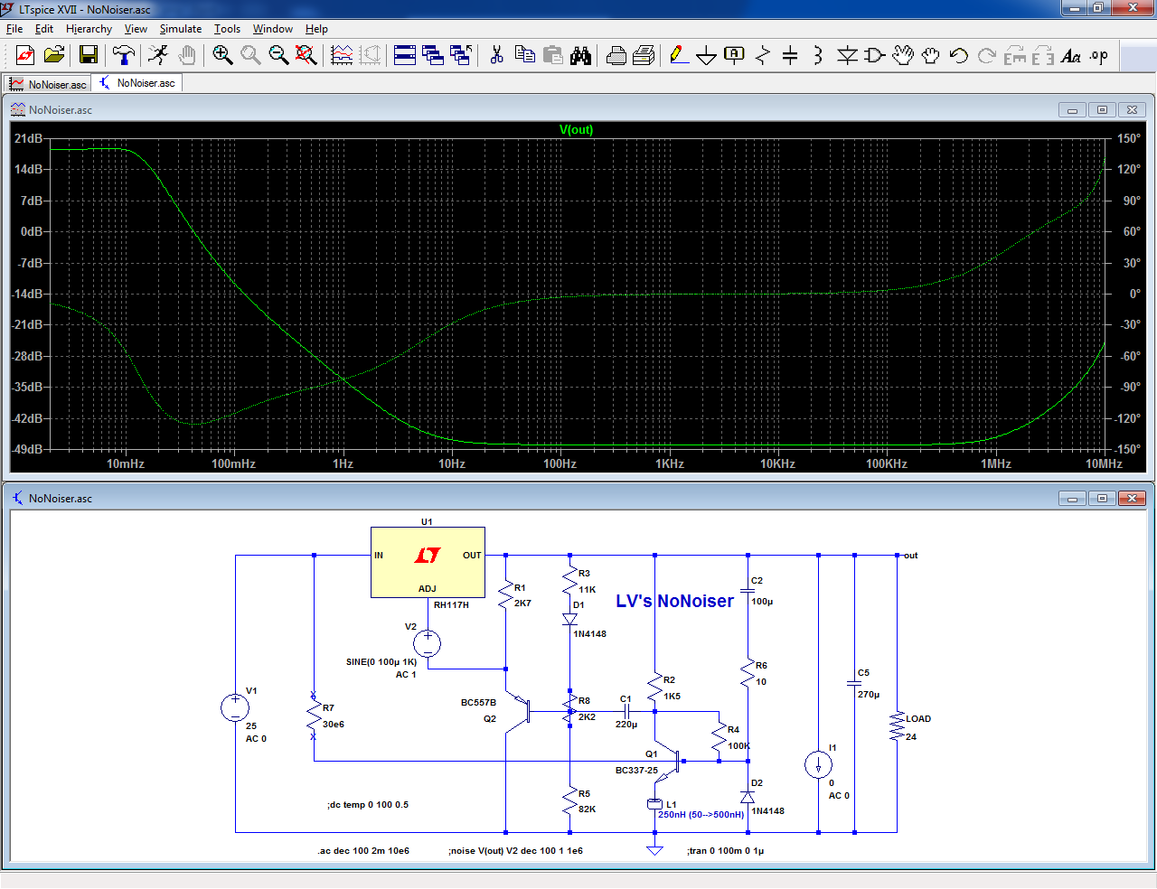

Let us begin with the PSRR, which is the weakest aspect of the NoNoiser: the measured value @100Hz is 125dB, 1 to 2dB better than the best regulator of the survey (Salas reg, fig. 5).
If a ripple compensation resistor is added (R7), it is possible to gain an additional 5dB.
I didn't attempt to refine it very much, but if both the phase and the magnitude of the error signal are tweaked, up to ~20dB should be attainable.
The sim predicts a much better PSRR: 140dB, probably because the 117 model does not include Early-type effects.
attachment.php
In the sim, any resistance value for R7 degrades this figure.

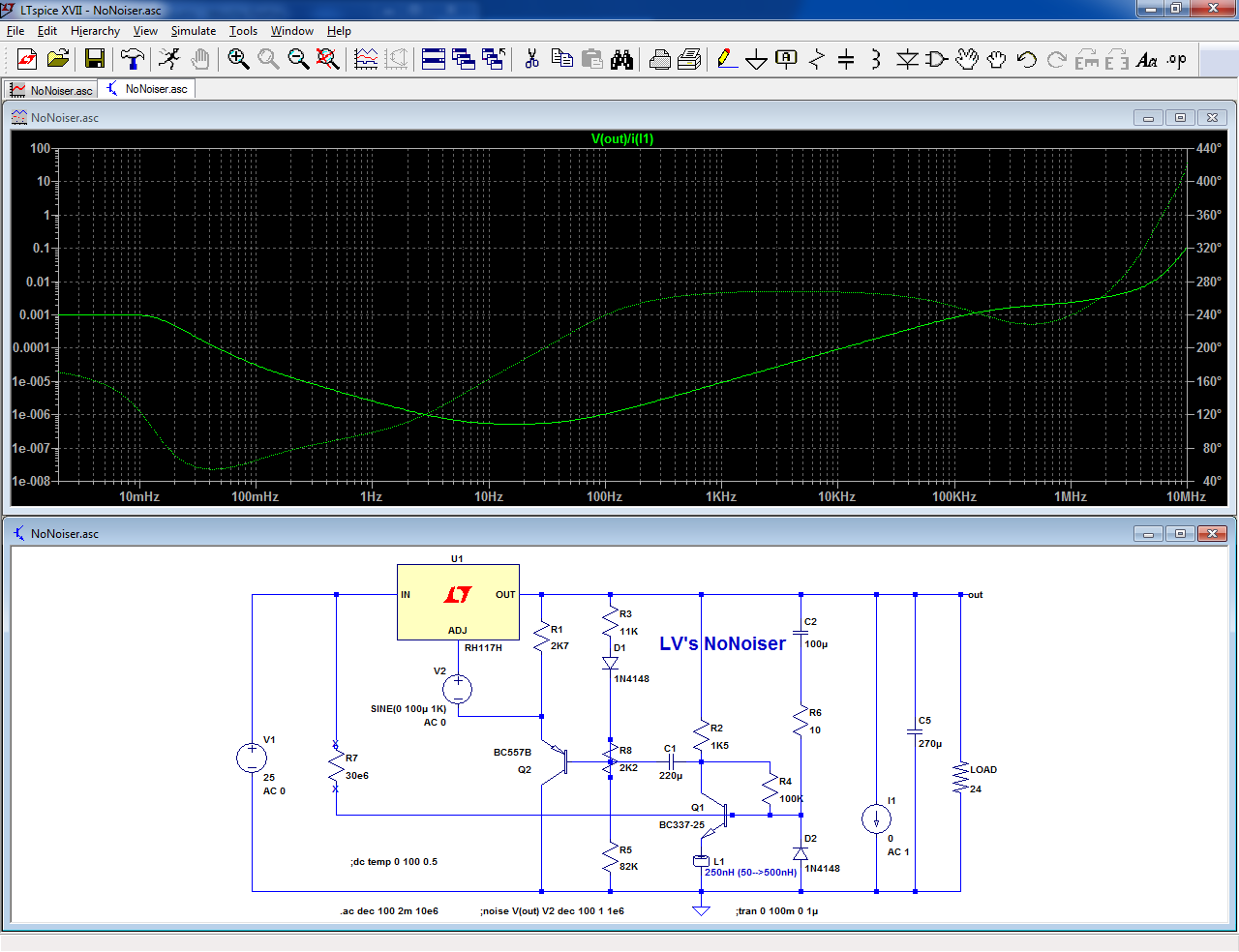

The output impedance @1kHz is 15µΩ, more than 5 times better than the best reg of the survey (Jung AD797, fig. 8).
The sim predicts a slightly better value, and it is probably possible to improve the reality too, because the Kelvin configuration I adopted is not optimal: I placed the drive and sense terminals side by side, but this results in a small mutual inductance between the two circuits, sufficient to degrade the impedance.

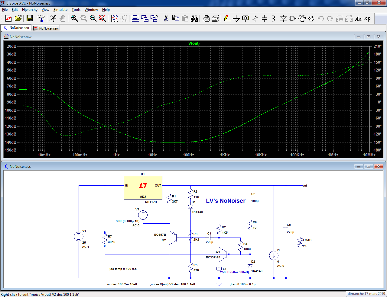

With a ZTX851 as Q1, the total noise in a 10Hz to 10kHz bandwidth is 0.09µV.
At 1kHz, the noise density is 0.8nV/√Hz, more than 3 times better than the best reg of the survey (SuperTeddy, fig. 7).
If Q1 is a BC337, the total noise becomes 0.16µV, and with a Chinese S8050 0.13µV.
Test conditions:
Vout=12V, Iout=500mA, Vdropout (average): 4.5V, voltage stimulus for PSRR: 5Vpp, current stimulus for Zout: 100mA pp.
The 317 of the prototype is made by ST.
The compensation scheme I adopted is different from the Denoizator: it involves an inductor in the emitter of the main transistor.
The advantage compared to a parallel capacitor is a greatly increased open-loop bandwidth for a comparable stability.
The required value can be as small as 50nH (with a ZTX851), but the S8050 needs more than 500nH.
These values could vary, according to the layout, the ESR of the caps, etc.
Unlike the Denoizator, this regulator is not suitable as a retrofit: even if you are ready to carry out the mods, it can only work properly and deliver its performances with Kelvin connections: the input, output and sense terminals need to be completed independent: any common ground will ruin it and bring it to the level of an ordinary regulator.
The performances vary with the output current, but the variation is modest: the PSRR remains almost unchanged, the output impedance is stable too, except at very low currents where it increases a bit, and the noise is proportional to the output current, but the proportionality is not 1:1, it is much weaker.
This means that in practice it is usable from ~0 to 1500mA, just like an ordinary 317 reg.
  • NoNoiser.asc

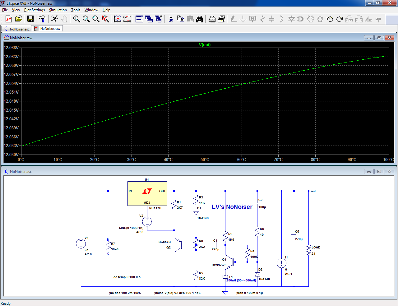

I said earlier that the DC stability of the NoNoiser had been somewhat sacrificed, to favor AC performances.
The main issue is temperature stability, namely the thermal tracking between D1 and Q2.
Other aspects of the stability are quite good, even though R1 is ~10x the recommended datasheet value: thanks to the emitter follower, the stability is in fact better than with just a 240 ohm resistor.
Here is a plot of the output voltage vs. temperature: it is not perfect obviously, but it remains within acceptable standards for an audio-oriented regulator.

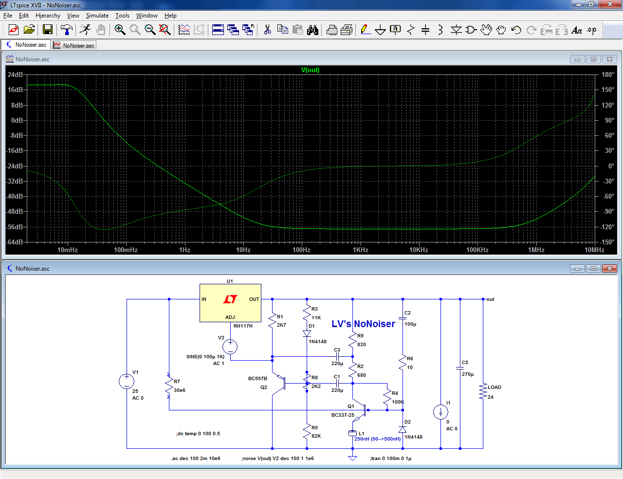

One more thing: by adding a bootstrap circuit to extract the maximum gain of the low-noise correction amplifier, it is possible to reach even lower noise levels.
This plot shows the noise reduction effect of the unmodified amplifier on the 317's internal noise: it is around 49dB for the audio range:
attachment.php
With the bootstrap circuit, it increases to 57dB:
attachment.php
This means that it should bring the noise density to ~0.4nV/√Hz, closer to the 0.25nV/√Hz intrinsic limit of the ZTX851 (the collector current might need to be increased too).
I didn't implement it, because IMHO 0.09µV of total noise is already good enough, and the added complication is not worth the trouble, but if others find it necessary, they can always use it.
If it is implemented, it would be good idea to reduce the 10 ohm base protection resistor to an even lower value, because at this level it will begin to have an impact
