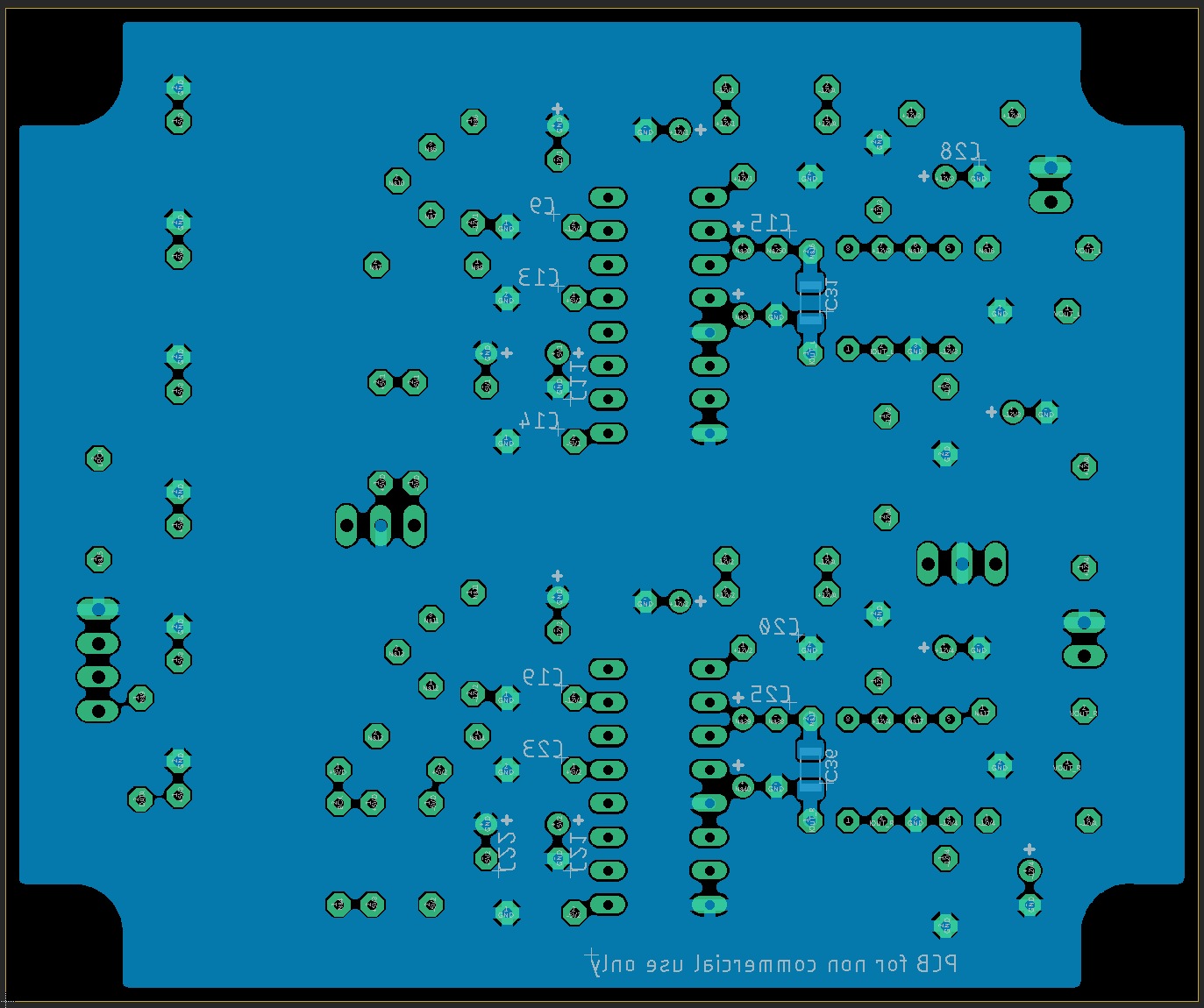

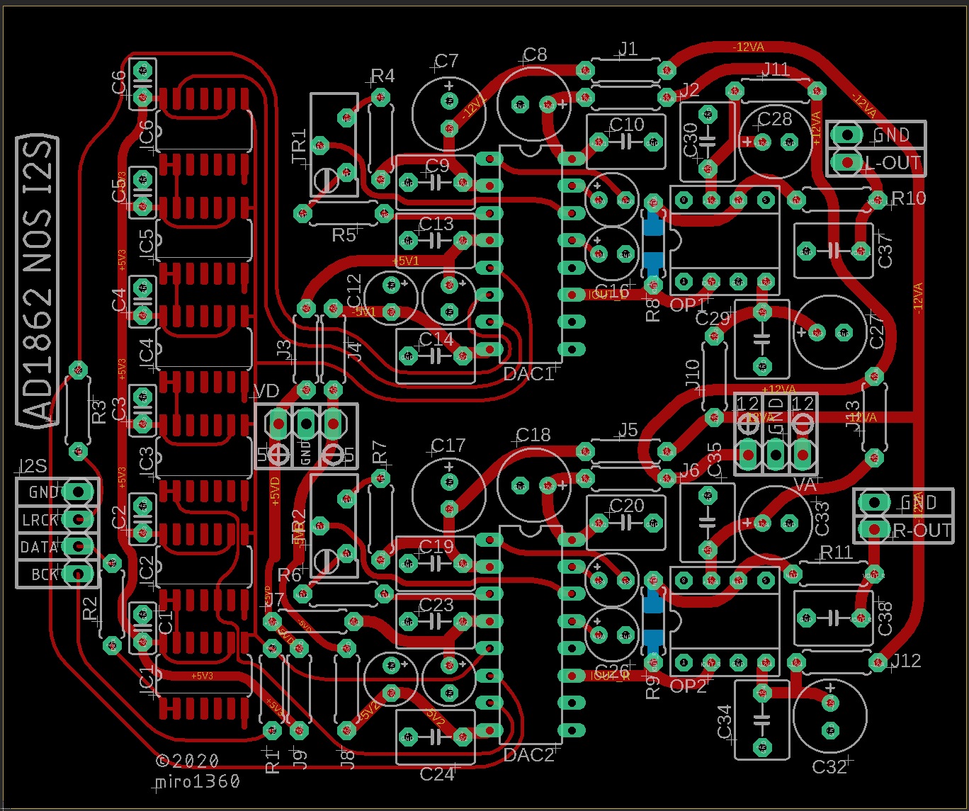

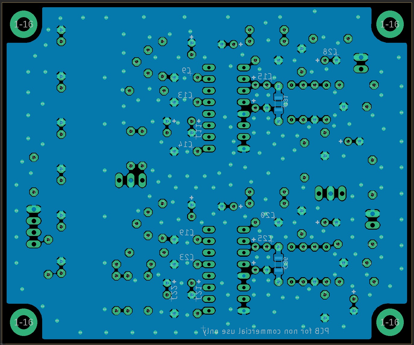

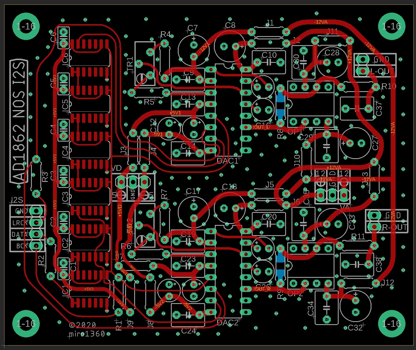

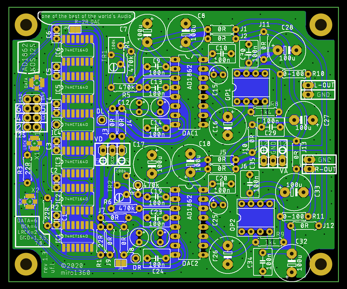

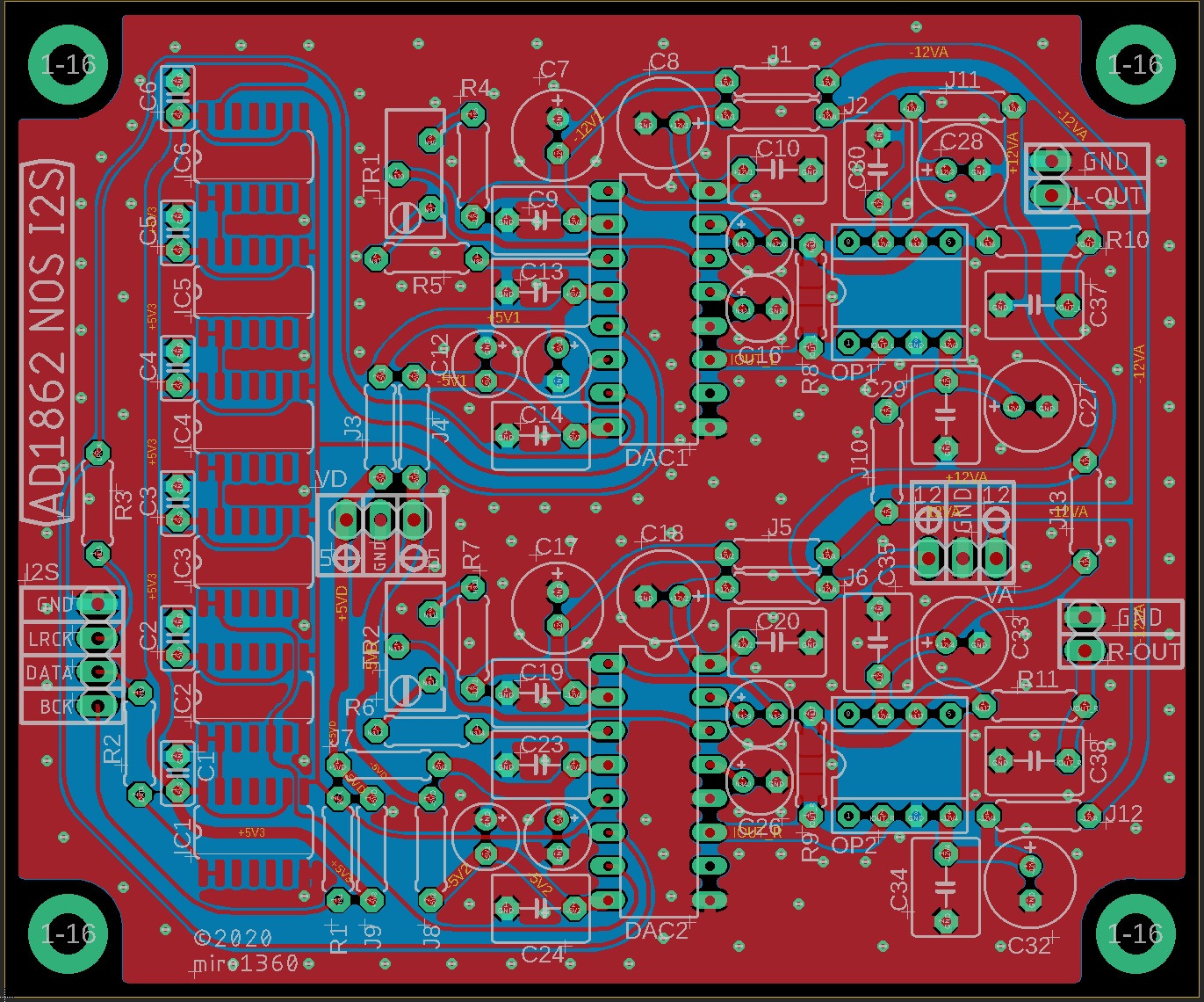

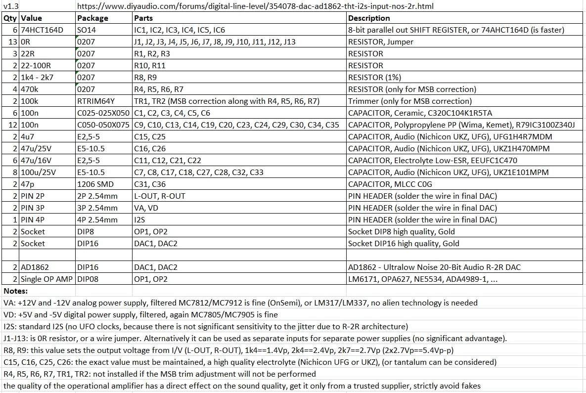

PCB details
C37, C38 can be omitted, it is just a simple RC filter on the output (about 330kHz cut-off frequency), my AD1862 is without RC filter
if such a filter is not here after DAC, it will be present at any amplifier input (if not manually removed)
the sound is affected by the capacitor type, it is least affected by the type of PP and C0G (SMD) (they have the lowest THD of all capacitor types)
I wasn't thinking about distortion caused by cap type (I assumed NP0). Rather loading on the opamp output at higher frequencies. Filters at the input of amps generally have higher valued Rs than 100ohm before shunt caps. And have lower values of caps (1n would be about the highest I've seen).
there are many different tupe output stages, that's why I left the basic opamp with the possibility of Iout for any tube stage ... likewise, power supplies are not on the PCB because everyone prefers something different ... it is only a purely basic solution of the DAC module with endless expansion possibilities
Fair enough! And thanks for the great work [emoji4]there are many different tupe output stages, that's why I left the basic opamp with the possibility of Iout for any tube stage ... likewise, power supplies are not on the PCB because everyone prefers something different ... it is only a purely basic solution of the DAC module with endless expansion possibilities

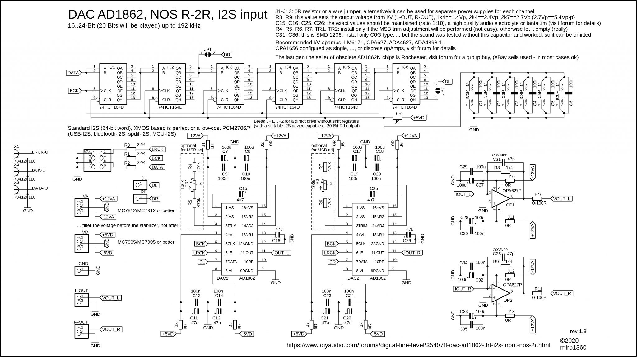

As i wrote above, people can try different I/V designs. I/V is another chapter.
My intention was not to modify the sound of the AD1862 in any special way (what can be done by I/V).
Iout is present and therefore everyone can connect any converter. Do you know how many good converters are there? including tubes ... life is short to test them all and find the best one
My intention is simplicity, not to limit it to a complex PCBs and then through complex adjustments find the right sound
Pavouk website is nice source of DAC designs. He tested many different R-2R DACs, but he did not tried AD1862 ... he could finally
The schematic of AD1862 is from datasheet, I/V is a simple opamp standard,
shift register part - I don't know who implemented it first .. it's no magic, it's just a bit shifting ...

Sorry i didn't see you chose the internal V outputt of the chip.
Pavouk tried the ad1865 Hardware
opa861
is simple, in fact way simplier as it can be seen like a single transistor !
In fact many the I/V can be the same than the internal voltage stage but with better part and it"s a proven fact it sounds best, in others words the voltage output is worse... or maybe it is the ad1865... you know memory and ears

opa861 output stage can be build separately.
AD1865 is current output too, but it has the possibility of Vout using internal opamp (it sounds not very good, as you already tested). AD1862 is higher lever, more complex architecture.
AD1862 has not Vout, it is current output.

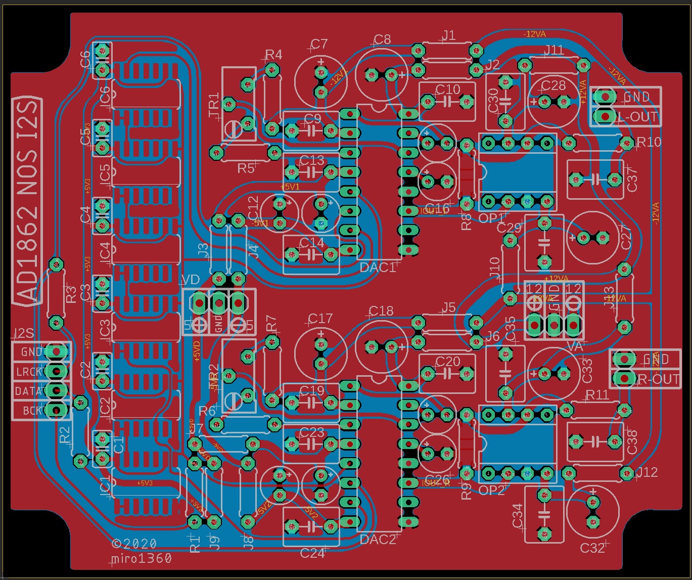

here is 4-layer PCB: easyDAC = NOS R-2R AD1862 DAC + Headphone Amp
you can omit some parts that you don't need
if there is more interest, I can create SMD version as well in the same way as this THT
But as diyiggi wrote, THT is trouble-free, the sound still be great
Yes it is 4 layers. Europe based company? They are overpriced for me and therefore, I have no experience with them. For me, the best option is jlcpcb, very high quality, best price for EU (even though manufactured outside the EU), shipping is fast and I am sure you will get it under 20€. This is not an advertisement because I'm not associated with them in any way - just best experience and quality I found yet, if the brands and names of any parts can be mentioned, then I think it doesn't matter. The calculator on their website gives a price for this 4 layer PCB of around 7€ for 5pcs, shipping is similiar.
