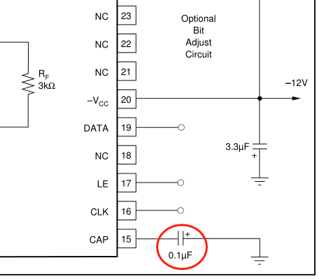

PCM58 update - yesterday after running for about a day without any issues, my balanced PCM58 DAC started generating clicks at random times. After a few more minutes, it started distorting. After power cycling these issues disappeared but came back again after a short while. I first suspected that maybe I'd overlooked some set-up or hold time in the design of the digital logic to interface them with I2S. That checked out OK after examination. The problem was only showing up on one of the four chips so I probed around the various pins on that and happened to notice the voltage level on pin15 wasn't stable, it was decreasing slowly over time. Checking against the other working chip on the same board, its voltage also wasn't stable.
What I eventually took note of was the pin15 voltage was positive wrt GND and the cap connected to it (a 4.7uF tantalum) had its negative terminal to pin15. This is how the DS shows the pin15 decoupling cap, but based on the voltmeter reading, the DS is in error. Now few people I suspect will encounter this error because the value shown on the DS for the cap is 100nF which means designers are unlikely to select a polarized cap. But then again - so are all the other caps doing decoupling duty on the DS and its clear from reading the text that 100nF isn't sufficiently large for LF noise reduction. So if anyone else is inclined to try a larger, polarized value for the pin15 decoupler, connect it the opposite way to the way the DS shows. With all my pin15 caps duly reversed, no more clicks or distortion and the pin15 voltages are stable over time.
