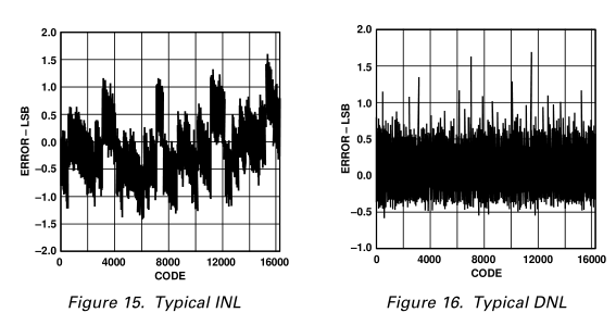

I have a short tube of AD9764 in my possession - this chip delivers 20mA balanced output swing for a supply current of under 30mA, depending on sample rate. Better than 1.5mA of supply per 1mA output current. Here are its lack-lustre characteristics - bear in mind this is a 14bit part :

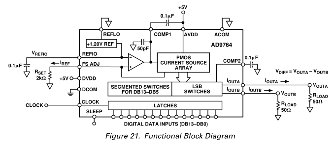

and here's its block diagram :
Its a multiplying DAC so its reference input can be varied (over a 10:1 range) to create a rudimentary volume control for the first 20dB.
The output noise spec is 50pA/rtHz which translates to 2.5nV/rtHz in a 50R resistor, giving a dynamic range of 120dB, assuming no intrusive 1/f noise. This is rather a lot better than even TDA1541 (110dB) and it has a high Zout (100k) and a wide compliance range of over 1V. So relatively tolerant of I/V stages. We just need to find ways to improve the resolution from 14bits and perhaps to smooth out the INL/DNL somehow.

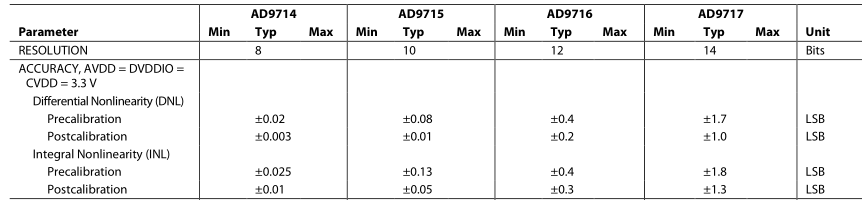

He's particularly interested in ultra-low THD for instrumentation purposes. I'm not so interested in chasing that as I'm not convinced its audible but I am open to persuasion. The DAC chip he's settled on is AD9717, this is a modern one (tricky package) that has internal calibration to improve its INL/DNL specs.
Here's the relevant line in the spec table, AD9717 is the highest resolution member of a family of devices :
Look at how good the DNL gets relative to the number of bits - at 8 bits, each bit width is within 0.3% of the others, very impressive. Going to 10bits, each LSB is a quarter the width so if the precision were relatively the same we'd expect 1.2% and to one decimal that's what we do get. However look at what happens when we add two further bits, to 12. I'd expect 4.8% but in fact we have 20%. So even though there are 4 times as many bits, they're even less precisely weighted than for the 10bit DAC. Things get worse still at 14bits. From the point of view of how precisely the bits are weighted, we seem to have a sweet-spot at 10bits, beyond which measured performance goes to pot.

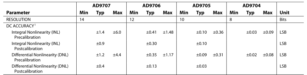

Its interesting to compare an earlier generation of chips, since these parts are subject to continuous refinement. AD9717 dates back to 2008, its predecessor AD9707 is from two years earlier. Here's how the older parts stack up on INL/DNL (I'm guessing by arranging them in opposite resolution order and swapping the order of DNL/INL they're discouraging direct comparisons) :
Interesting that the performance of the older 14bit part is superior both prior to and after calibration. And not by a small amount either - the AD9707 is very comfortably monotonic after calibration but AD9717 is marginal. Perhaps there are different contexts to explain this, I'll delve into the small print to explore further. The first thing to notice is the fullscale current is 2mA for both tables, but the older parts go up to 5mA and the newer, 4mA.

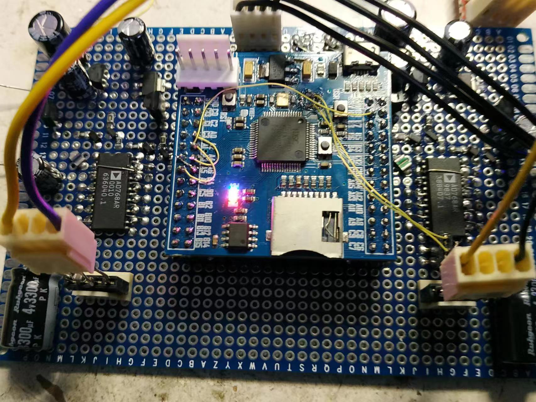

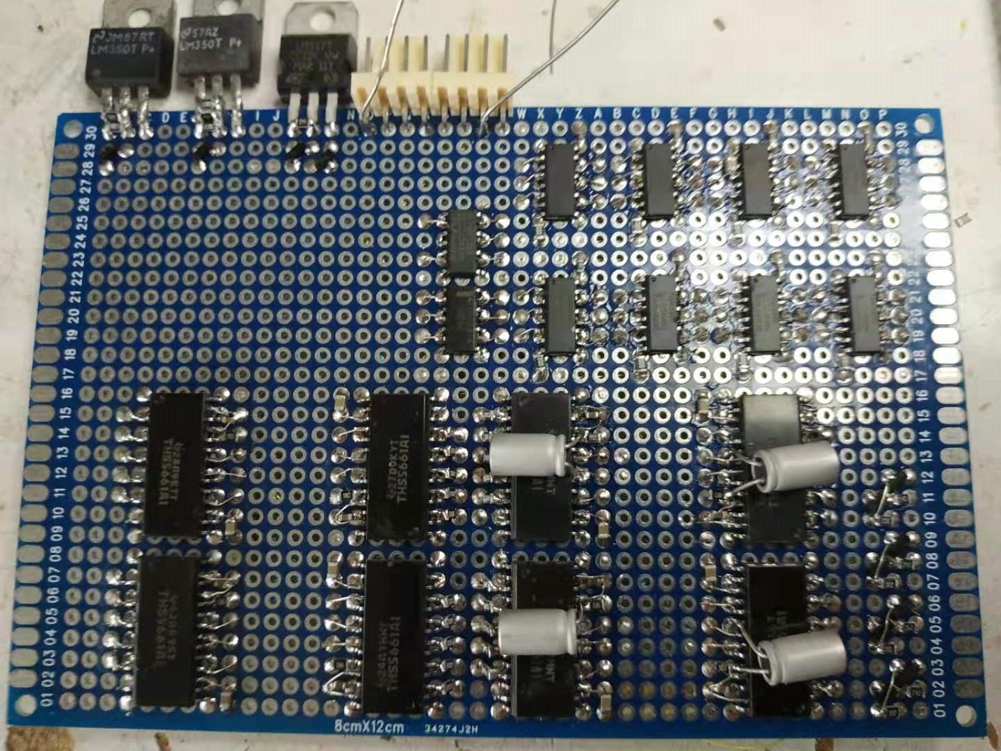

Here's my test-bed for THS5661A taking shape. The 8 chips top right are HC595s doing serial/parallel conversion. I am veering towards putting the cascode MOSFETs on a plug-in board as in the past when I've experimented with paralleled chips, the common-gate MOSFETs have a tendency to oscillate and hence self-destruct. There's really too much current for it all to be channeled through a single MOSFET unless its heatsunk so I greatly prefer paralleled smaller FETs to share the load but the oscillation issue is a serious one.
