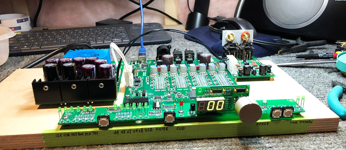

Mine is up and running since last night.
Joined 2009
Sören,
I have a few questions:
  1. If I do not use the display board in the kit, am I then correct that the VCC5D consumption remains 350 mA (can i ignore the 150 mA for the example display)?
  2. How much current does the included output buffer board use?
  3. Is the serial port on the DAM1941 (J8) isolated?
1) Yes, the dam1941 itself is 350 mA max, per manual.
2) The only active parts on the buffer board are the opamps, and you can use whatever you want there....
3) No isolation there, the serial port is designed to only be used for settings and firmware upgrades.
