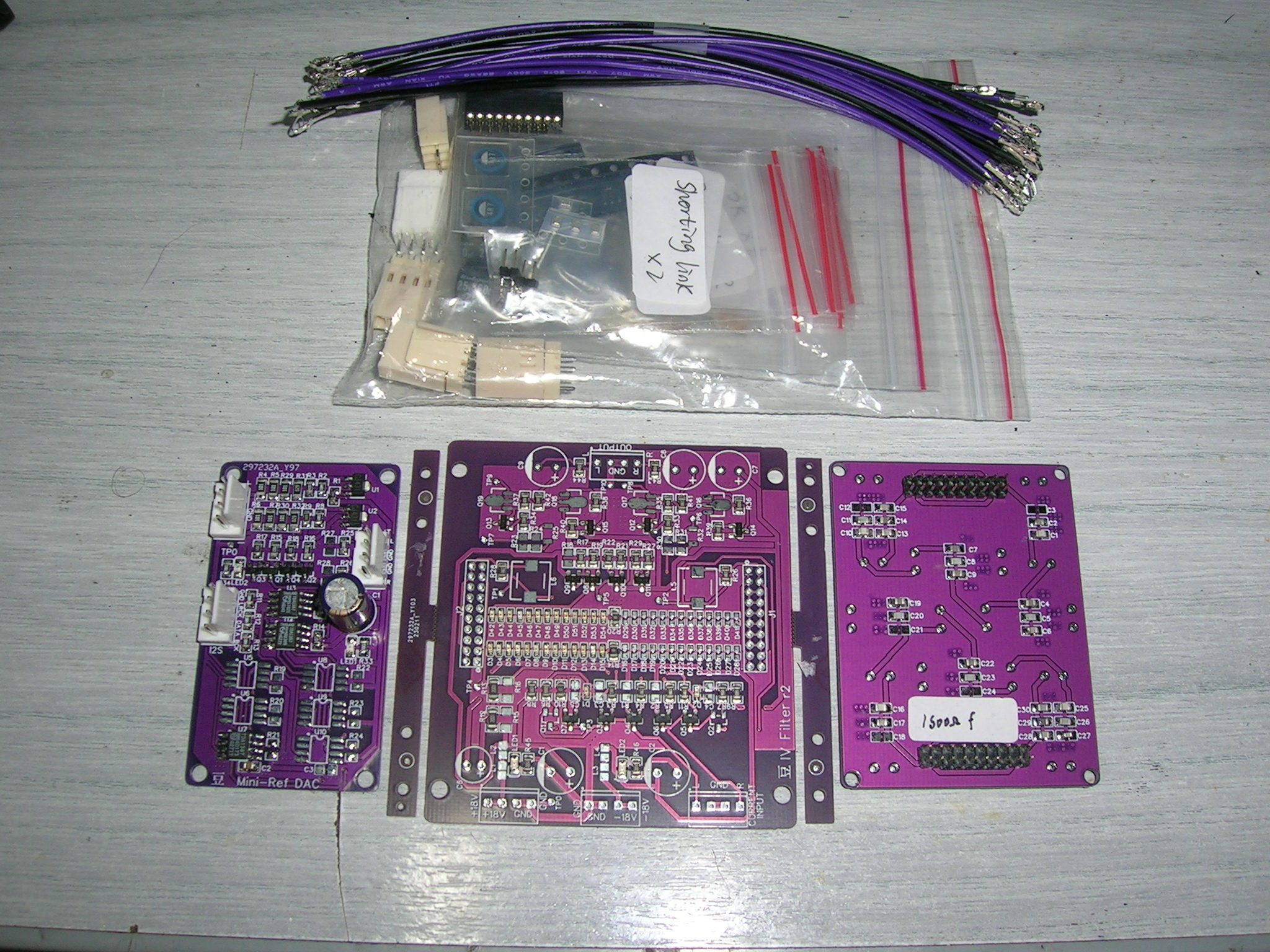

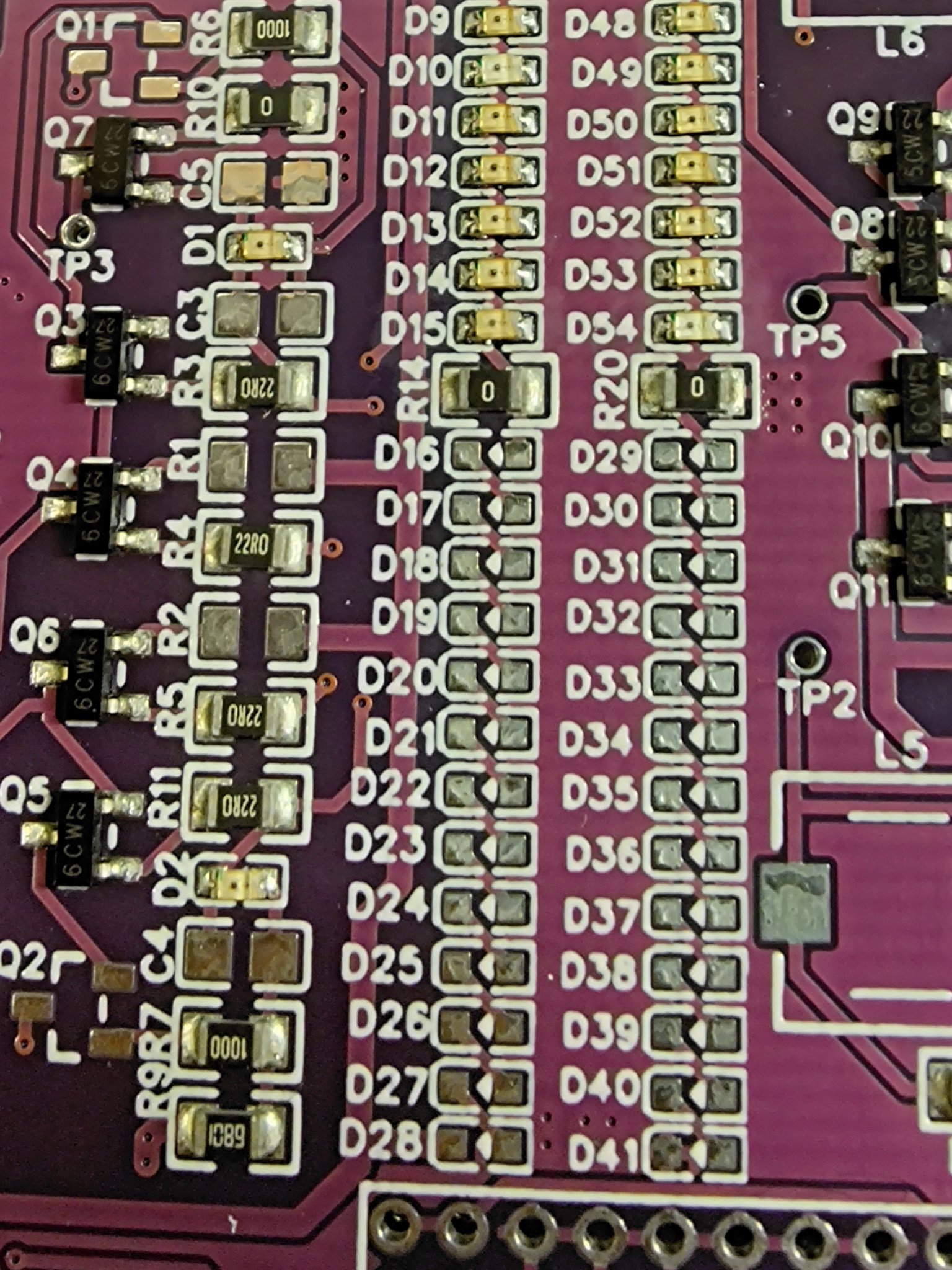

Hi Vunce - I must confess I didn't let my usual OCD soldering style get the better of me when I was putting those big resistors down. Incidentally while on the subject of resistors, did you notice any difference between the schematic and the board you received?😵
Just took a peek after your hint🔎
R10,11 - 240R
R16,17 - 24R
R2,3,4,5,8,9 - 20R
C17,18 - 220uF
I also found leg#2 of the Zeners is not soldered, but thats by choice as there is no electrical connection 😉
Is there a reason for the different values from schematic?
You paid attention to the values but not to the quantity.😵
The schematic is just a guide for me to stuff a board, I'll sometimes vary values a bit. For example to hit a target output voltage more closely the R10,R11 etc. adjust pin resistors I'll tweak as well as the resistors in series with the zeners (R16,17). The big resistors are higher value than the schematic because you requested a lower output voltage (from 8V down to 5V) which would normally mean more heat for those regs. The resistors are there to offload some of the heat. The cap values I reduced to a uniform 220uF as I think 560uF is unnecessarily high, I'll get the schematic updated.

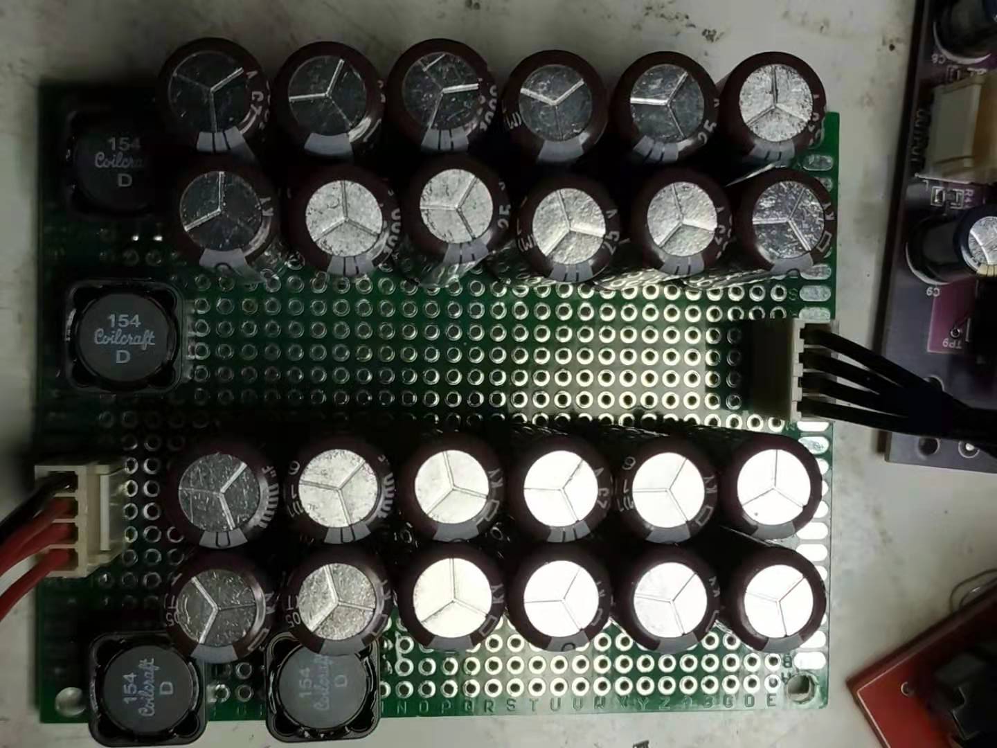

Last but certainly not least, and maybe actually the first thing to try is an upgrade to the PS. First with a filter to get it as clean as possible, and then I will try a new PS I just put together using some hard to find LDOs. If it is stable, I will also try both the filter and the LDO together.

There's already an ongoing project for DC power rail filters, I have gerbers for the first generation LC filter, if anyone wants them, just ask. (I know you already have them G!). Pic of the perfboard prototype below.

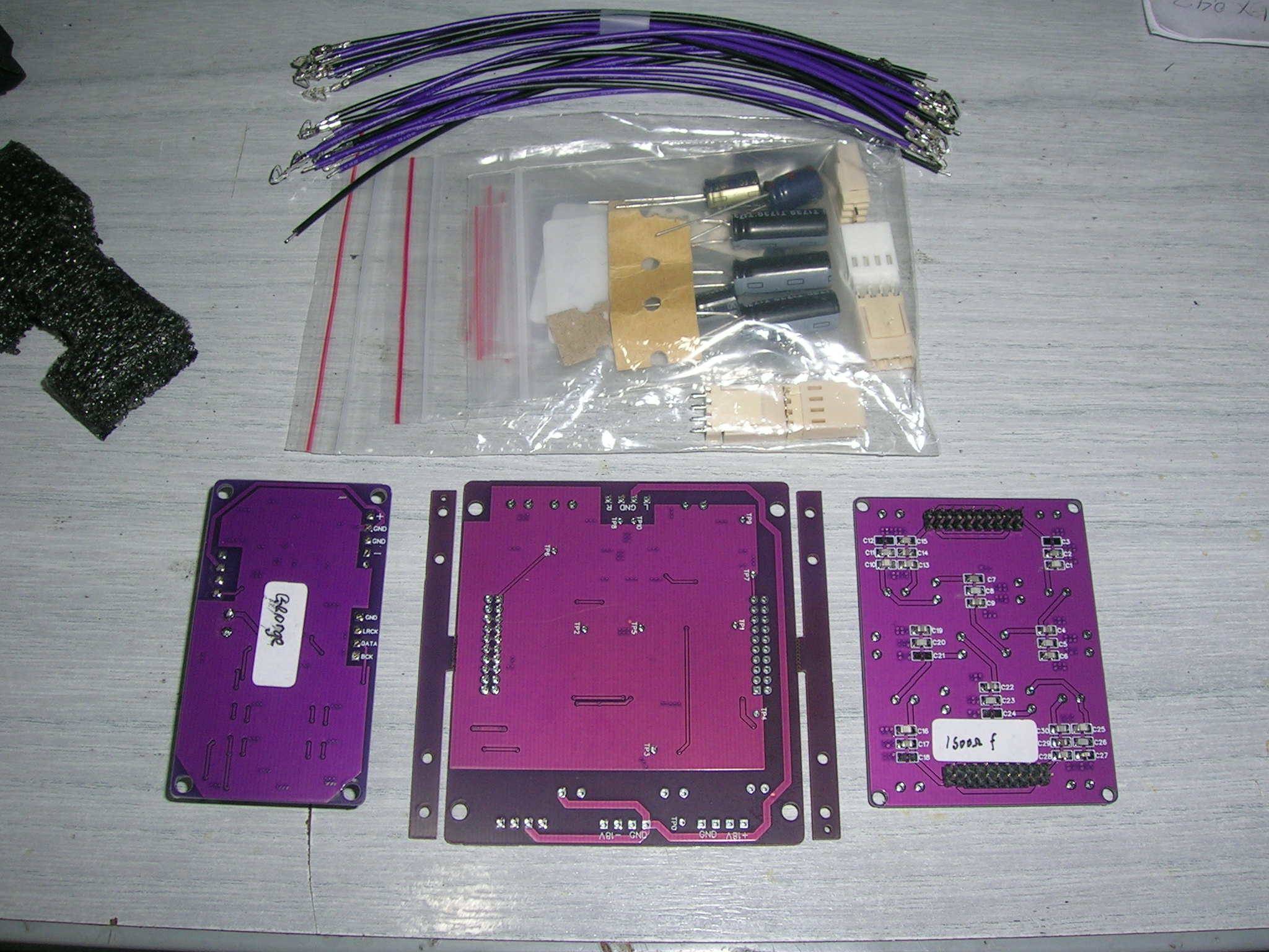

Mine arrived today.. Yay.! FedEx seemed to want to keep hold of it for another couple days for some reason. Better over zealous security than none I'd say.!
First thing when I opened I though oh hell. .they be some small SMD things and many of them!
Luckily not for us to populate ! I'd missed the updated post #1 with the soldering guide.
Look forward getting it in the system

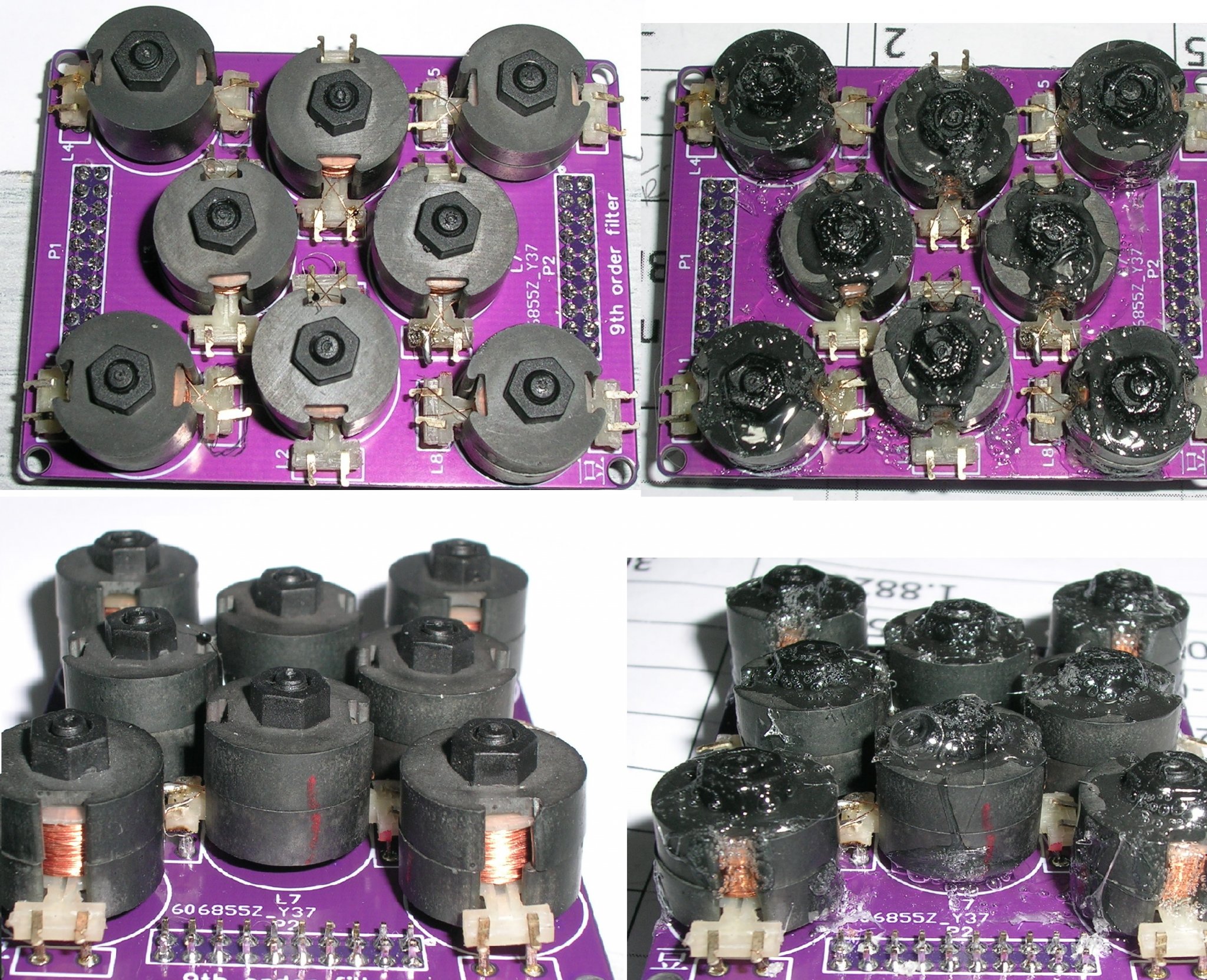

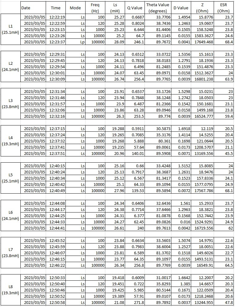

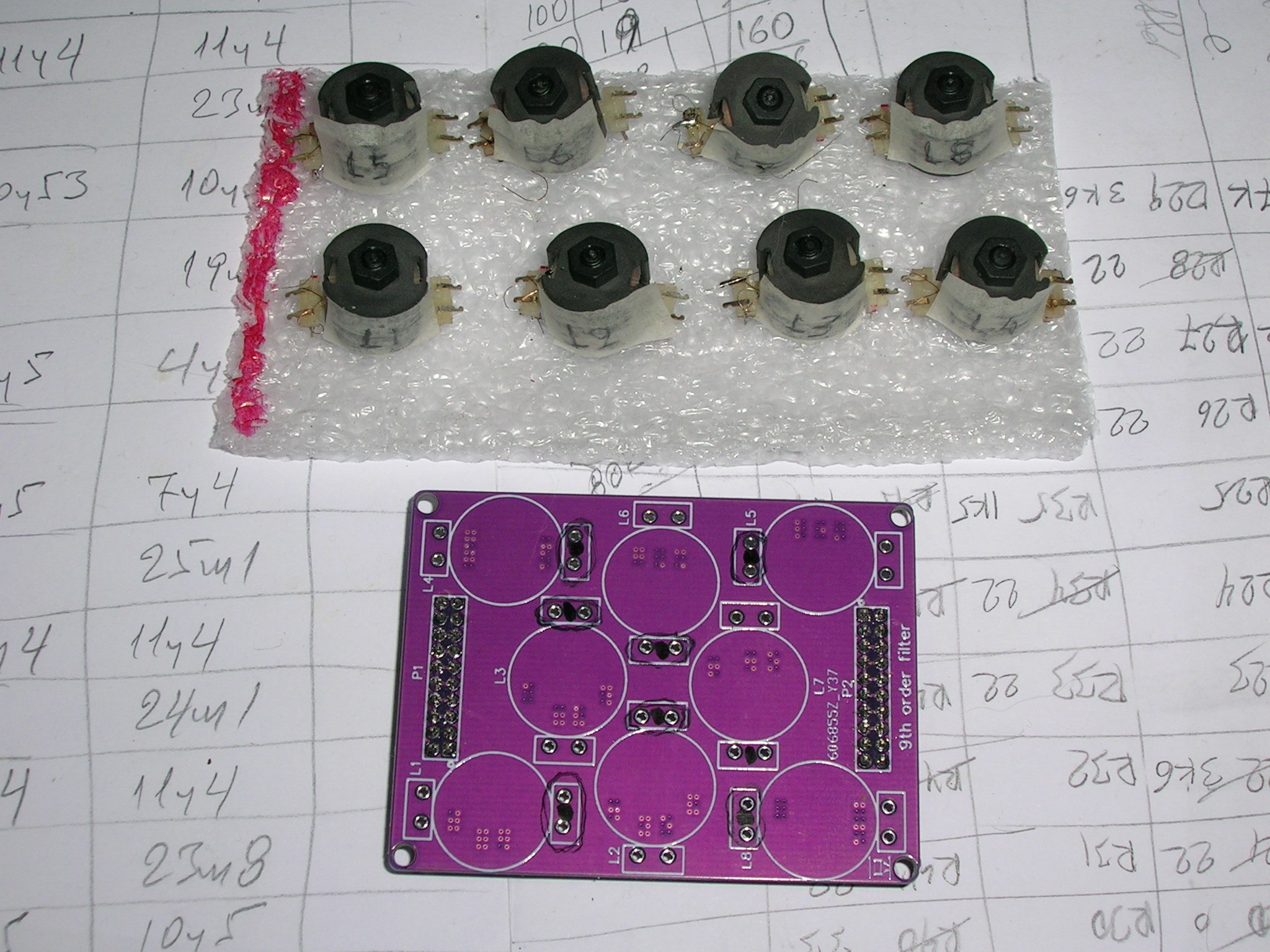

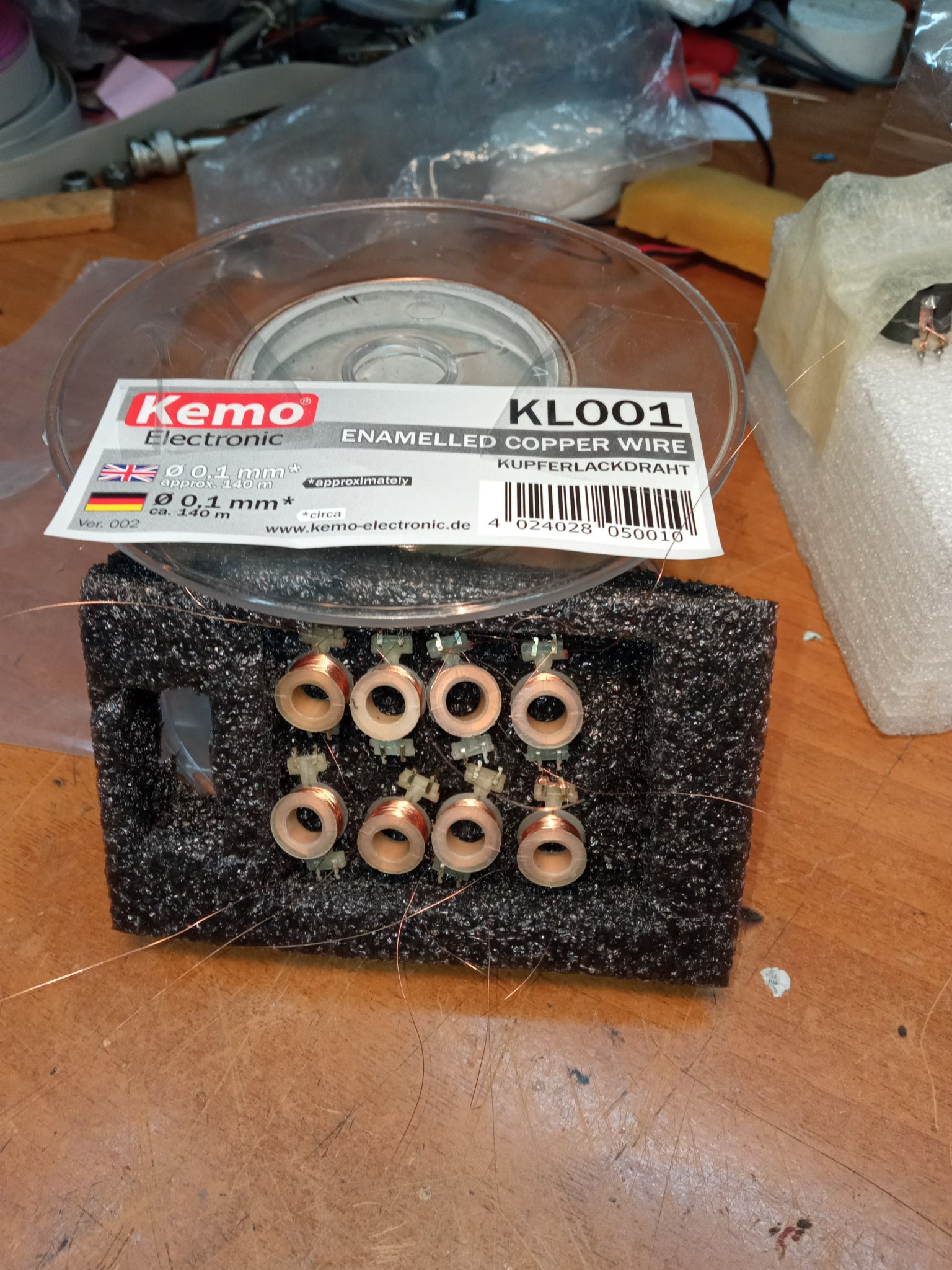

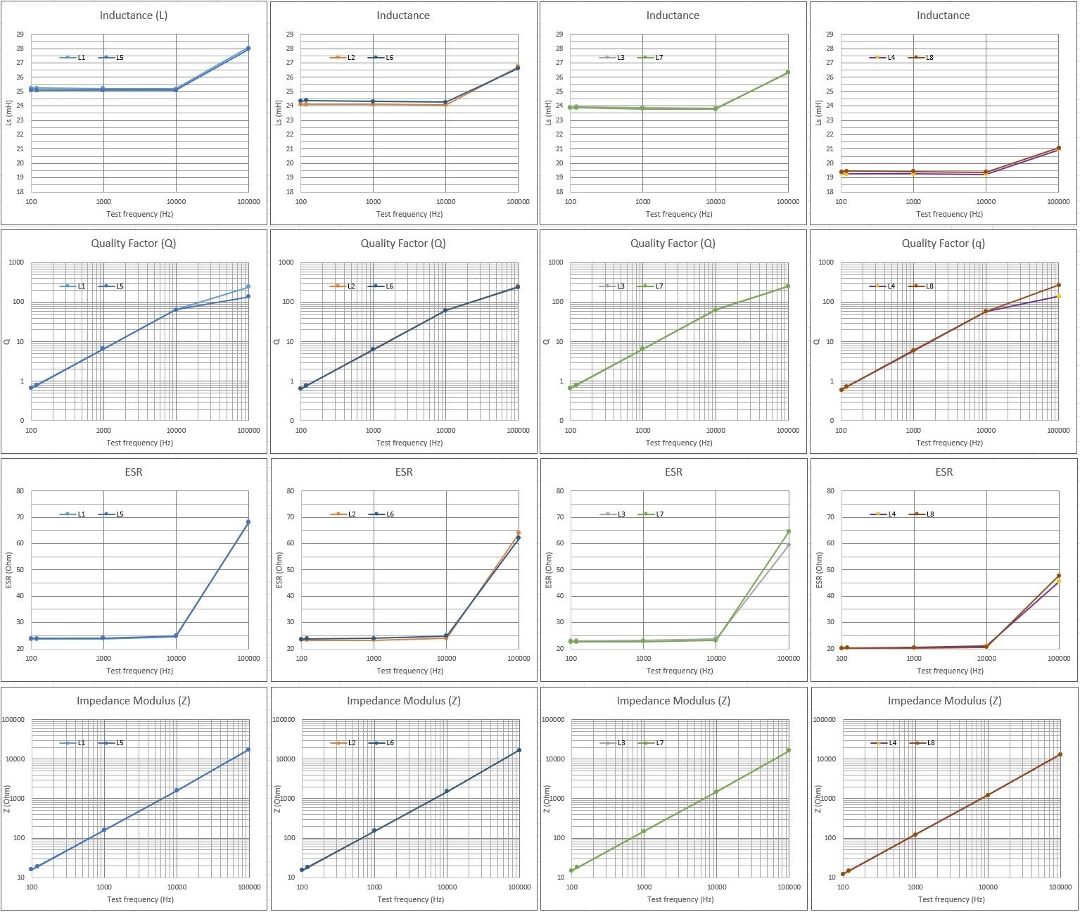

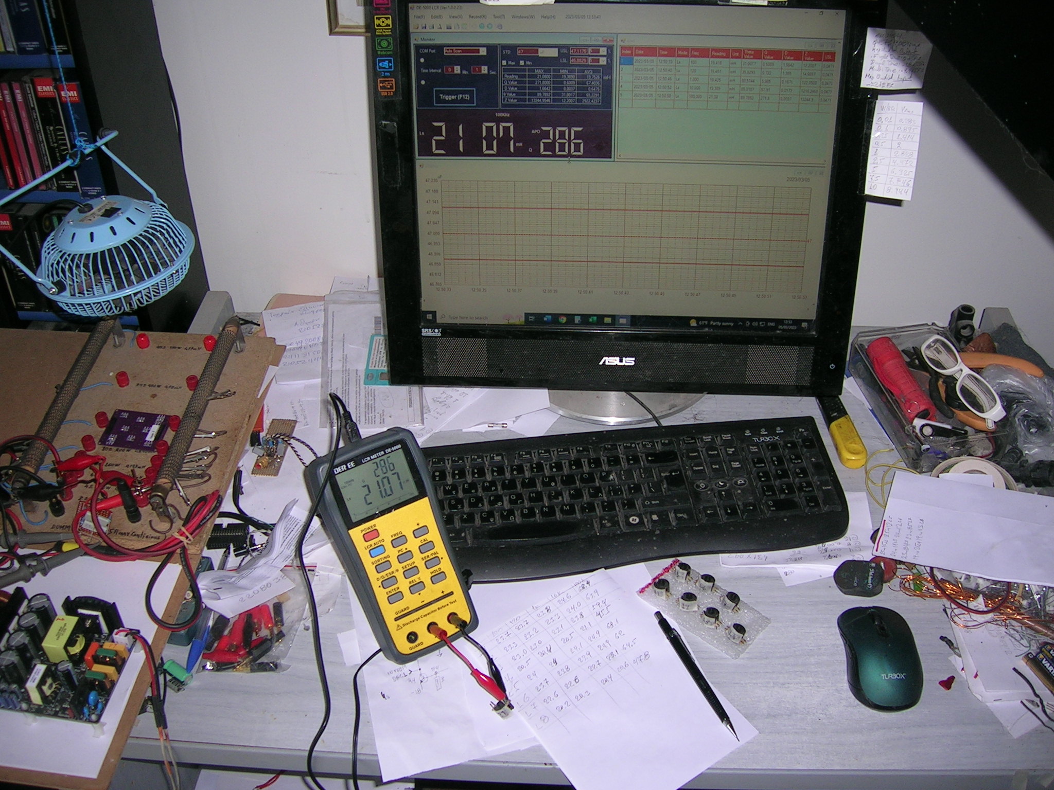

I finished the filter board (the difficult part).
George

George - I admire your determination and perseverance to characterize the coils you've made, producing a spreadsheet of all relevant parameters must have taken a very long time! I note the ESRs you got are about 50% higher than mine (for the first three, higher still for the 4th) which implies you used thinner wire. 0.1mm for all ? I shall be interested to see how that choice impacts the frequency response of the final filter.
By the way wifey said if my glueing of the cores looked even half as messy as yours, I'd be dead meat! We apply the adhesive around the gap between the two halves, hoping it will sink into the crevice.

Yes. Unfortunatelly I couldn't source a 0.11mm or o.12mm wire. Only 0.1mm. And yes, the ESR goes up with the square of the diameter. (I wound a bobbin with 0.07mm wire and ESR went at 60 Ohm@1kHz).
With 0.1mm wire on all coils, Rs is 91 Ohm@1kHz from input to output of filter board.
My soundcard has developed some problems at it's output. Impedance tests at high Z are questionable. I have to open the hood and poke into it. Most probably I have to get another one.
Wifey eeh? Active women are experts into keeping their partner on his toes.
Besides pouring glue internally through the two sides openings, I apply the glue also at the bottom and the top externally, thus the mess.
