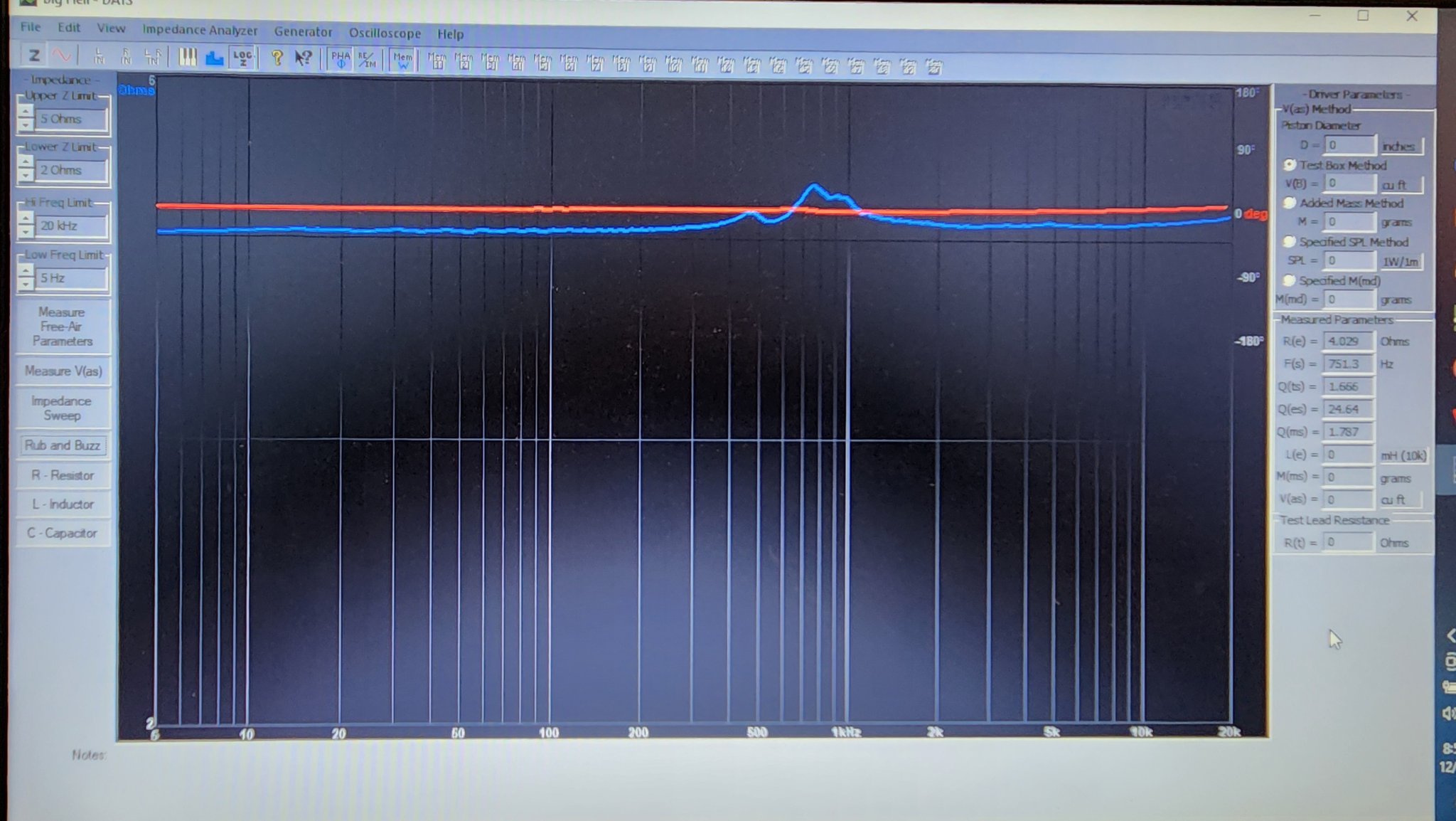

The DATS is a great tool, it is pretty much the only electronic gadget I rely on for building speakers. It is great for not only measuring raw drivers, but also the effects of an enclosure or crossover network.
As far as I am aware, the amplitude level in the generator mode does not affect the impedance analyzer mode. Your two graphs are scaled differently, but both appear to max out just over 50 ohms at 20KHz.
Also, the added mass is only used to determine the M(ms) and V(as) of the driver. The other T/S parameters can be found with a normal sweep.

Noone? Never mind. Here is big Heil amt. Its 4ohm, and has very flat phase and impedance, with just barely noticable fs bumps around ~750 Hz.

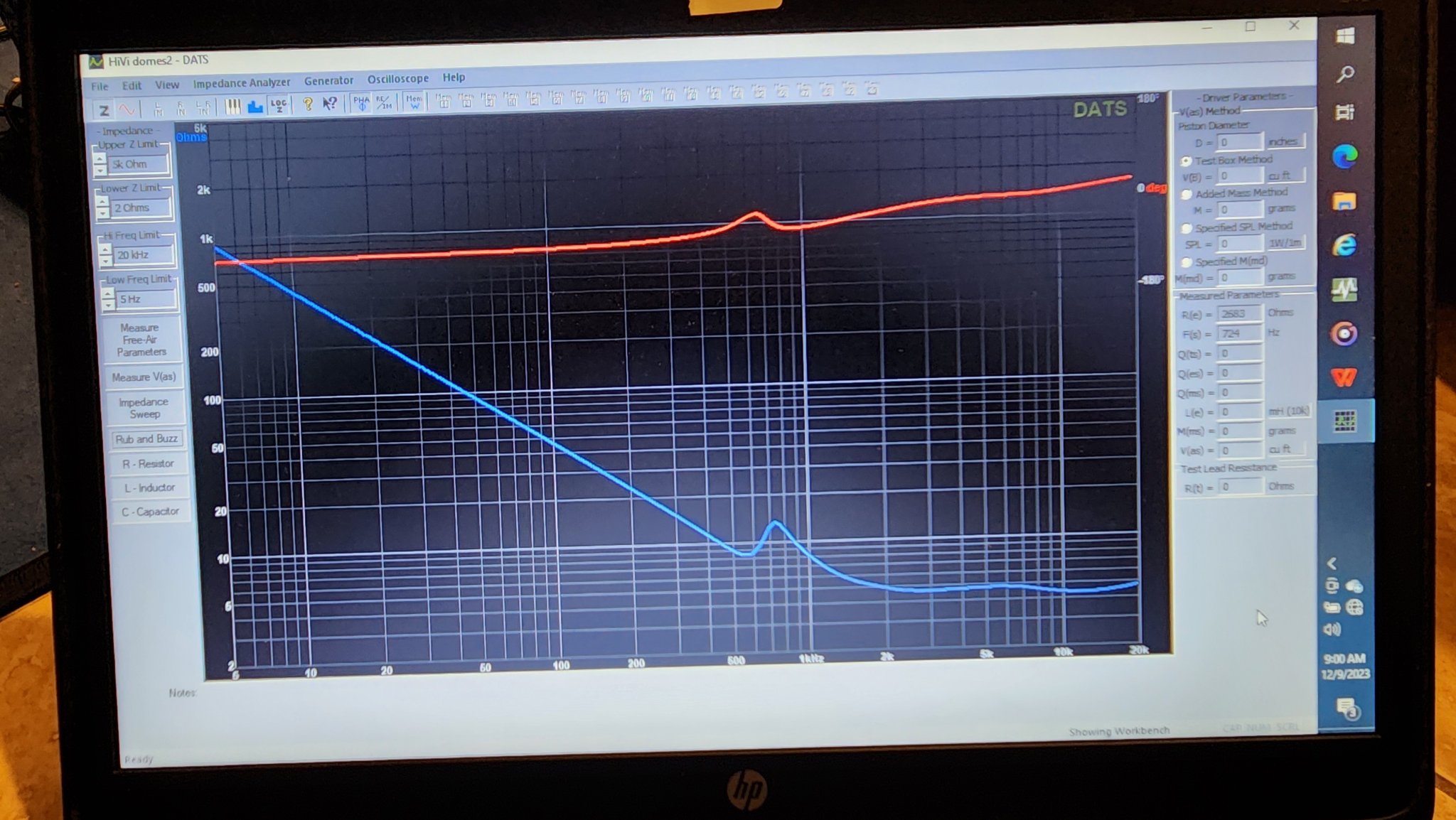

Next two measurements are a little wild and i am not sure i can interpret all.
This is Phillips two domes combo, mid dome and tweeter. For some reason it dips below 4ohm, and fs is rather weird. It comes with built in cossover, maybe thats the reason.
But they do measure well and sound fine.

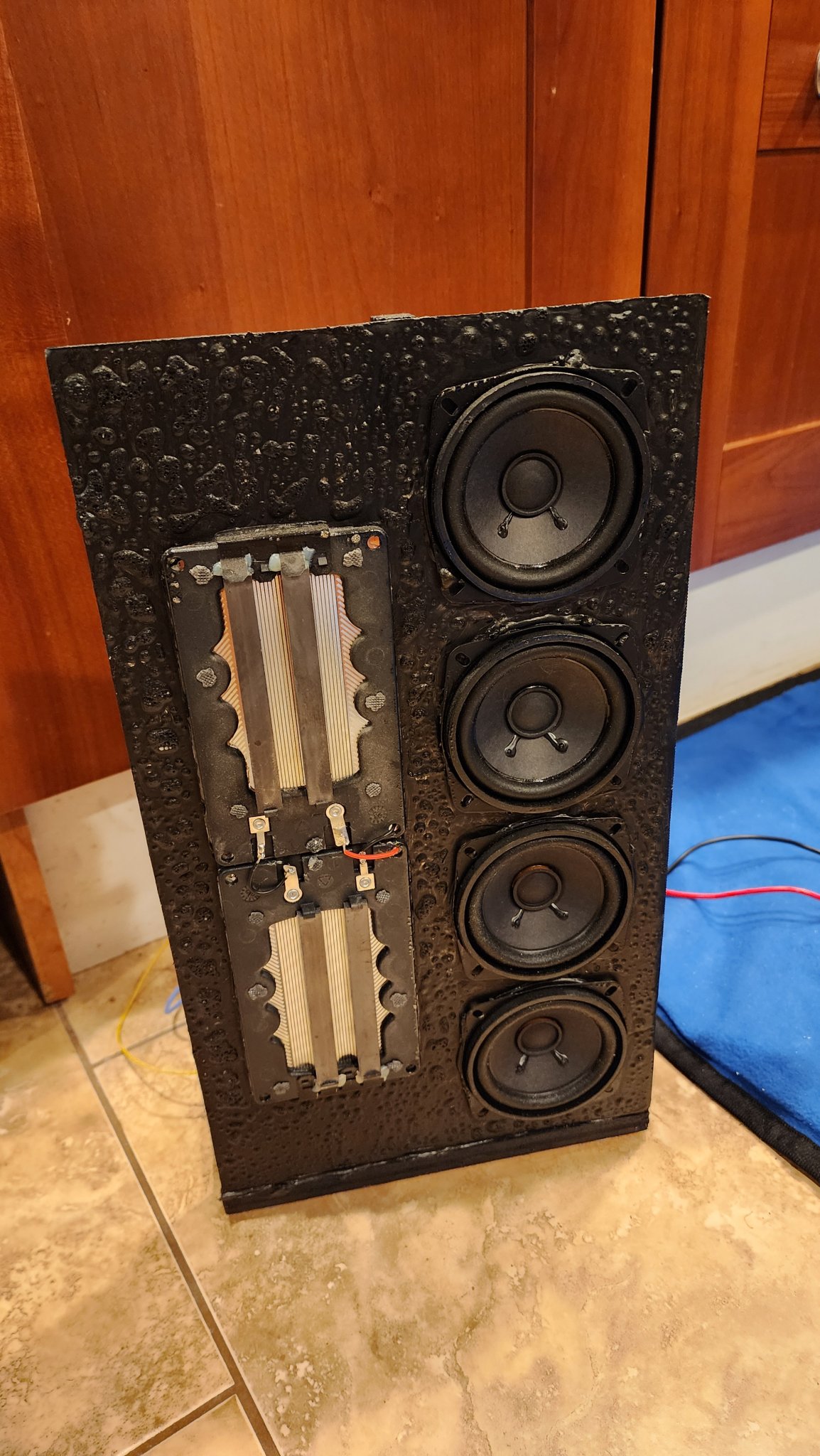

Last for today, its nice outside.
This is great sounding open baffle based on 4 paper cone aura midranges (they do not classify as fullrange). Fs is 170Hz as measured before.
Added are two Monsoon planar tweeters. Impedance is 4ohm.
With woofers below 100Hz this is great sounding combo.

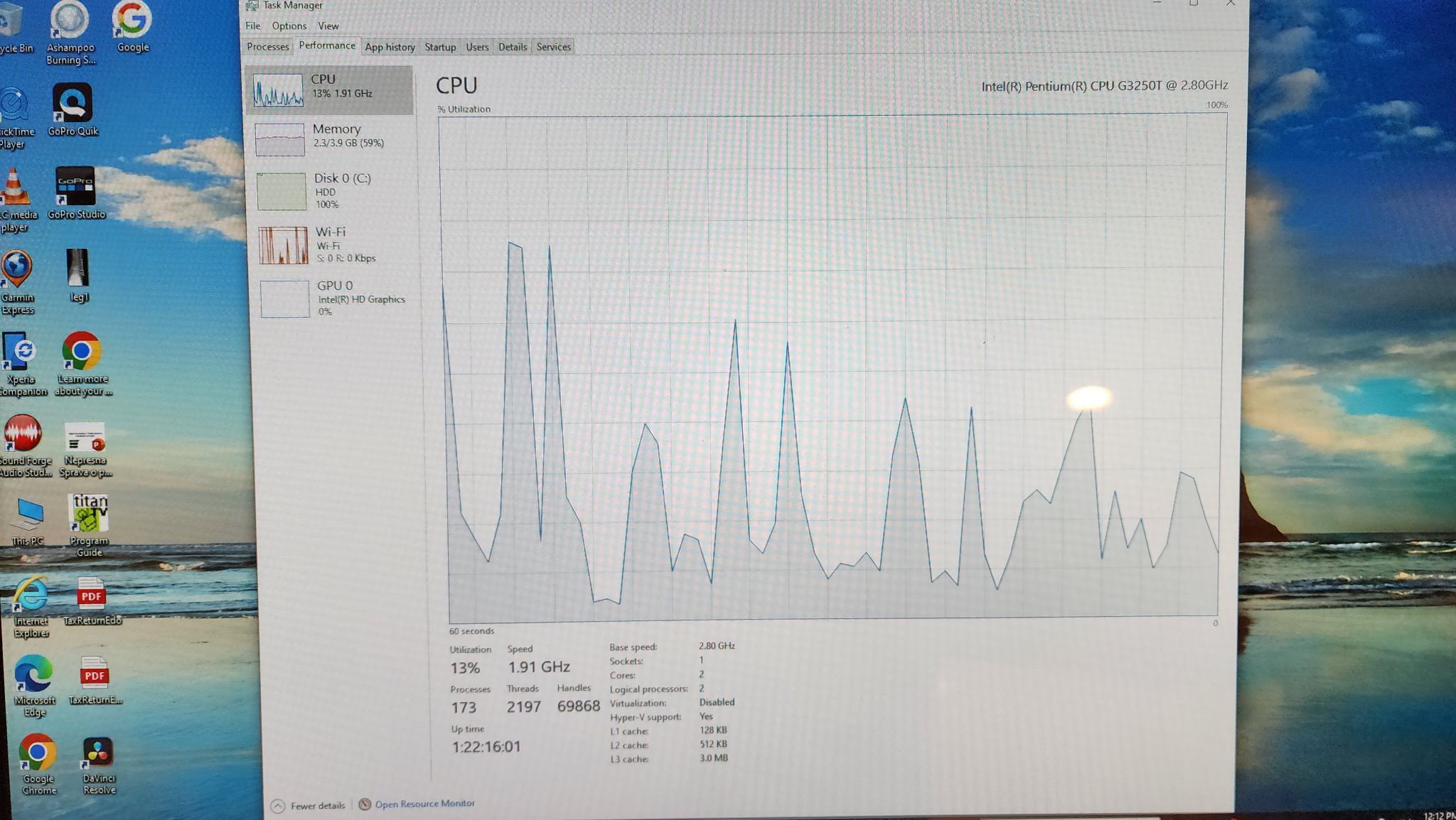

Don't even get me started how demanding the operational system is. When you turn it on, not even working on it, not even using it, it runs 50+ processes and 50% cpu and 50% hard drive. What the heck is bill gates doing?
User error. My desktop W10 install is 6 years old and has been through 3 CPU/motherboard upgrades. With my browser open and ~200 processes running, CPU toggles between 0-1% utilization, and disk utilization is 0%.
