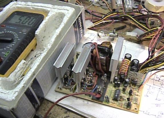

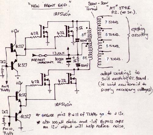

If you really want to stay with the form-factor of the AT- or ATX-box, I seem to remember a website where the guy kept the secondary (output) section intact, but changed the input side from the hi-voltage half-bridge configuration to a low-voltage (probably 12V) center-tap push-pull topology. He kept the driver transformer, but with a little re-working of the circuit layout. The 400V bi-polars were swapped out for some 55-60V N-Channel MOSFETs of low Rds(on) rating. If I find it, I will post the web address on this thread.
His article accompanying the photos seemed to indicate good success with the project. So now, he can use his desk-top CPU on 12VDC instead of the regular 120VAC. Probably a good thing in the event of a power outage.
Since you're probably wanting to make a (+/-) supply, you will need to do something different. For usable parts on a typical AT or ATX PSU, assuming it is a half-bridge and not a flyback, you can use the transformer (though some rewinding will be necessary), the BIG :eek: output inductor, some of the little individual output inductors, the output rectifiers (they're the high-speed types), and, of course, the TL494 itself. But you're in for some new transistors, and a driver ckt, as the 494 will not directly drive MOSFETs. The electrolytic caps might be used, although you might want to use some better caps, like Panasonic, or others.

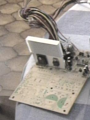

DC-DC ATX PSU Pics
Pentium-
I finally figured out how to shrink the file size under the 102kB size limit. Here is the first DC-DC ATX PSU pic.......

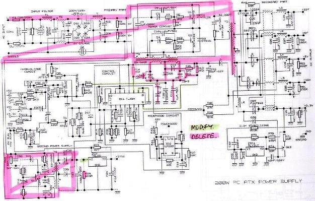

DC-DC ATX PSU Pics
....and the last one. tThe schematic os for a 200W unit, although it is adaptable for almost any ATX PSU. NOTE: These are NOT pics of my work- I pulled them off the web almost a year ago. Just wanted to post them here to answer your original question.
Hope these help, and I'm sorry it took soooooooooooo long!
