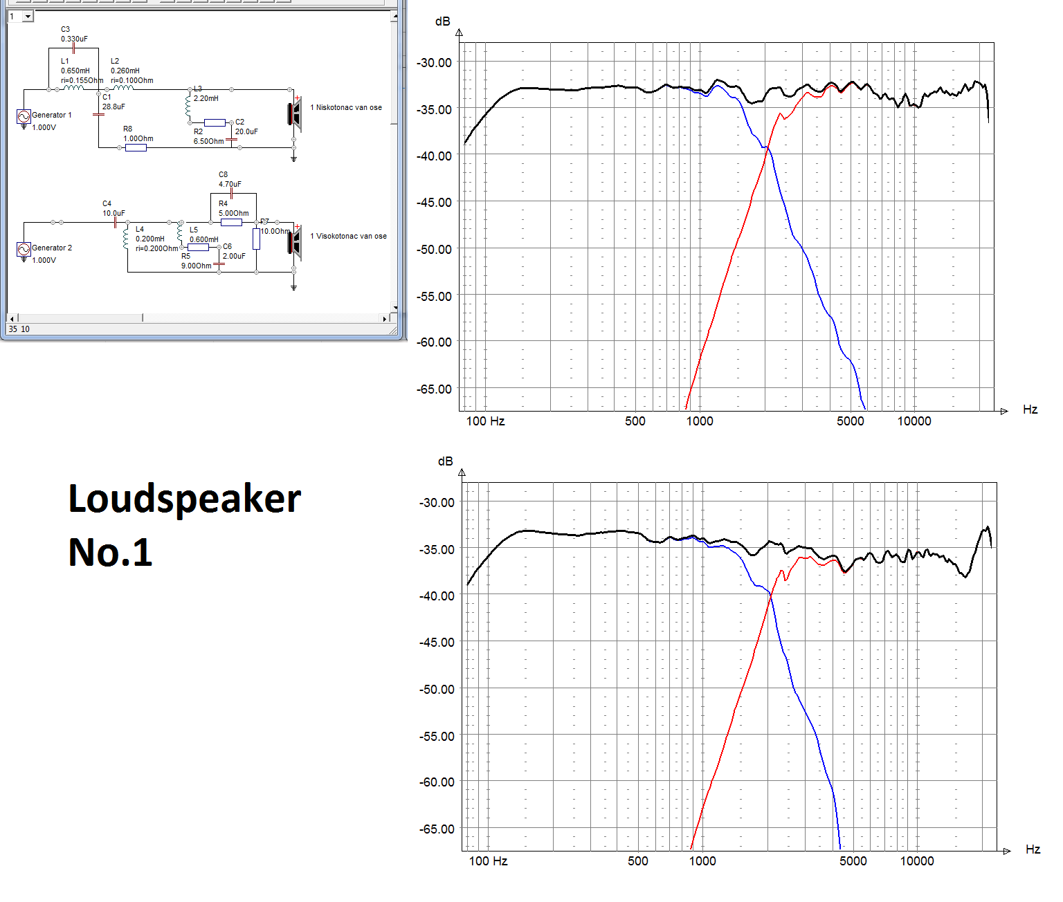

That is a high quality biamped system, the LEAST it deserves is a generic 12 dB/oct passive crossover, at 2500Hz .
Such as:
Dayton Audio XO2W-2.5K 2-Way Speaker Crossover 2,500 Hz
this one might be overkill, is more for a PRO, high power speaker, lamp protected, etc, but hey ....
Eminence PXB2:2K5CX 2-Way Speaker Crossover Board 2,500 Hz
Tweeter probably needs some attenuation to match woofer , most general purpose crossovers include that, and afterwards they can be tweaked for even better response, but even with an generic one, they should already sound VERY good.
You might even find a generic biamp backplate roughly matching original amps, for a reasonable price.
Or build your own if you dare.
Such as:
Only problem is that both cabinets will sound different, worst case both should be turned passive and fed from your current Stereo power amp.
