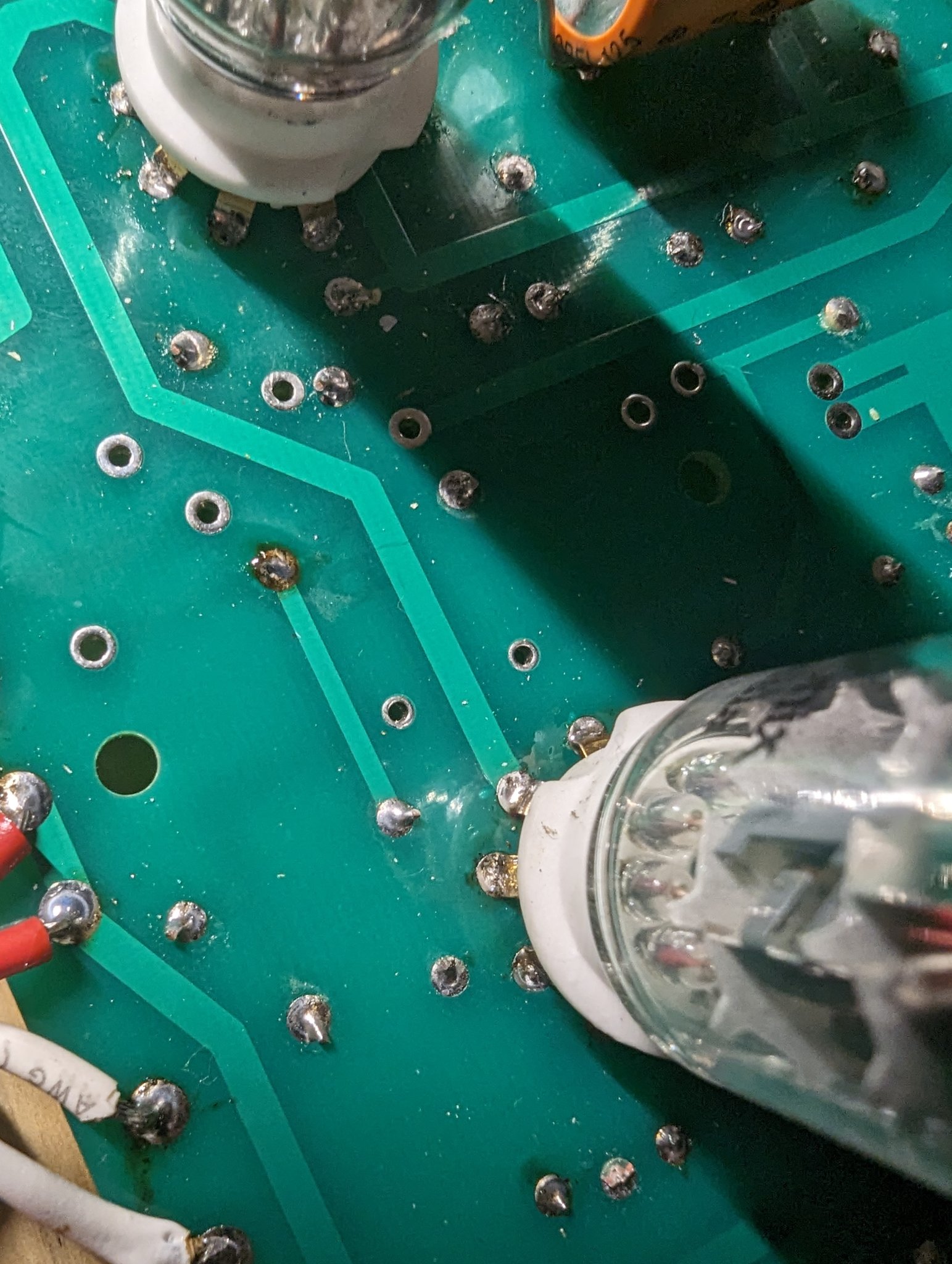

I corrected the violet and white wires, I must have missed that when flipping the PCB the other way. Thanks.
I swapped the output tubes with another set of the same type I had and re-measured.

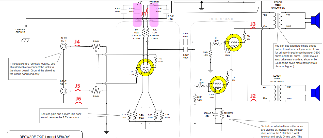

Is J1 connected?

If there are no steps to actually install the jumpers, the directions seem more like suggestions.
Unbelievable.
I read all the documentation a few times and didn't come across anything. There's no notes on the schematic and nothing jumped out at me unless others can see something I don't.
I build a pair of Bob Latino M125 monoblocks a couple years ago and had zero problems with those. I thought that this would be way easier to get up and running.

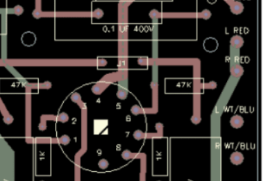

The jumpers are shown on the PCB layout drawing. J1, 2 & 3 are in between the output tubes. J2 & 3 connect the blue OPT leads to the circuit. J4, 5 & 6 are shown at the top and connect the signal inputs.
So without these jumpers, there will be no signal coming in, and the output transformers will not be connected either.
The fact that this isn't documented and shown on the main schem. is pretty much inexcusable.

Compare the pcb and the schematic to find out. Probably so, but you have to prove it to yourself.
Unfortunately, even though the jumpers are actually a component, just the same as a resistor,
and have individual reference designators like other components, they are not shown on the schematic.

As @vinylkid58 pointed out, the jumpers are shown on the PCB layout drawing. J1, 2 & 3 are in between the output tubes. J2 & 3 connect the blue OPT leads to the circuit. J4, 5 & 6 are shown at the top and connect the signal inputs.
Therefore, all jumpers must be installed and can be mounted on the top or bottom of the board.

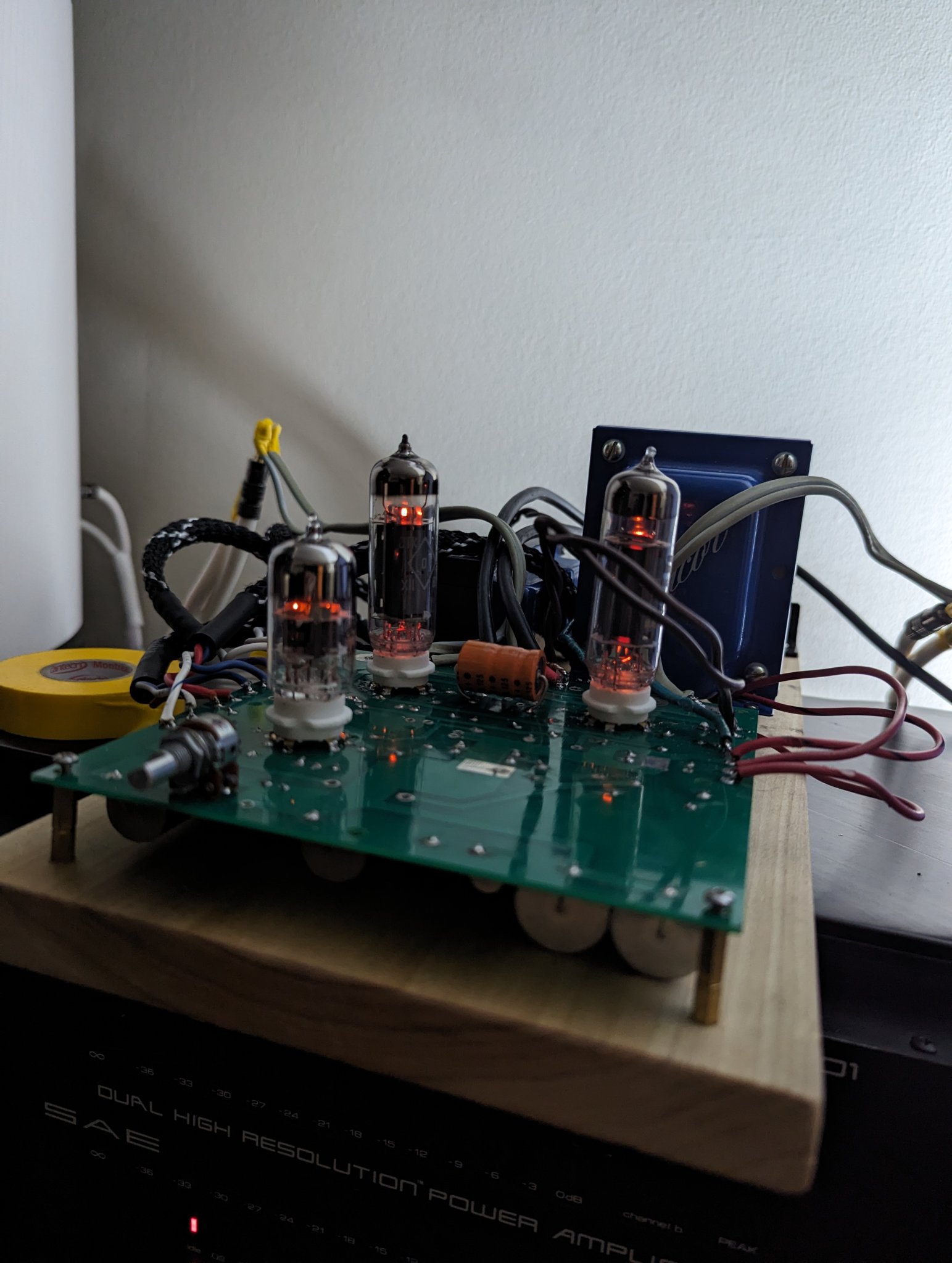

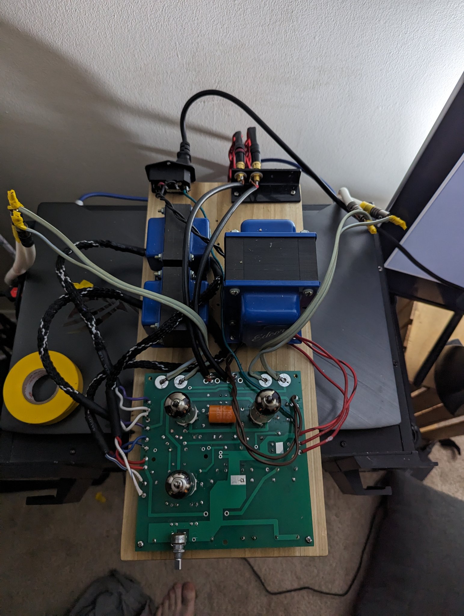

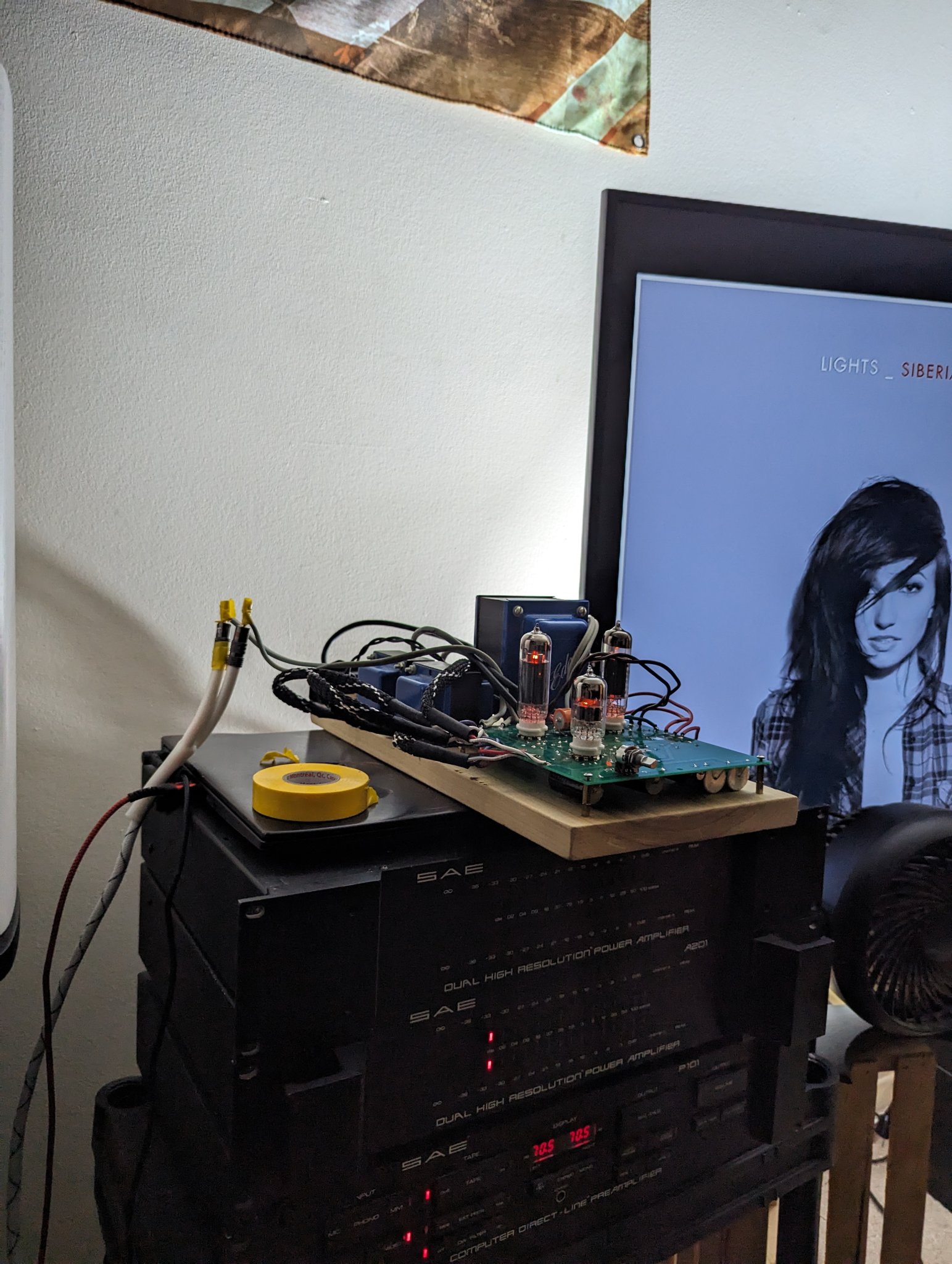

I just wanted to let everyone know I installed all the jumpers this morning and sure enough it works! It sounds great! Just running on a bedroom the imaging is fantastic.
I'd like to thank everyone here for there helpful advice and patience. It's time to finish the second one and make monoblocks and some chassis.
