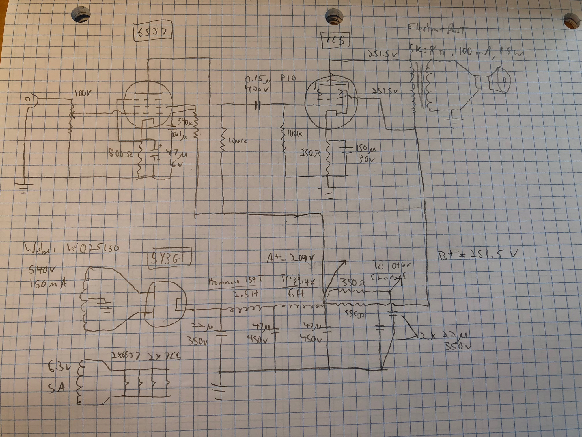

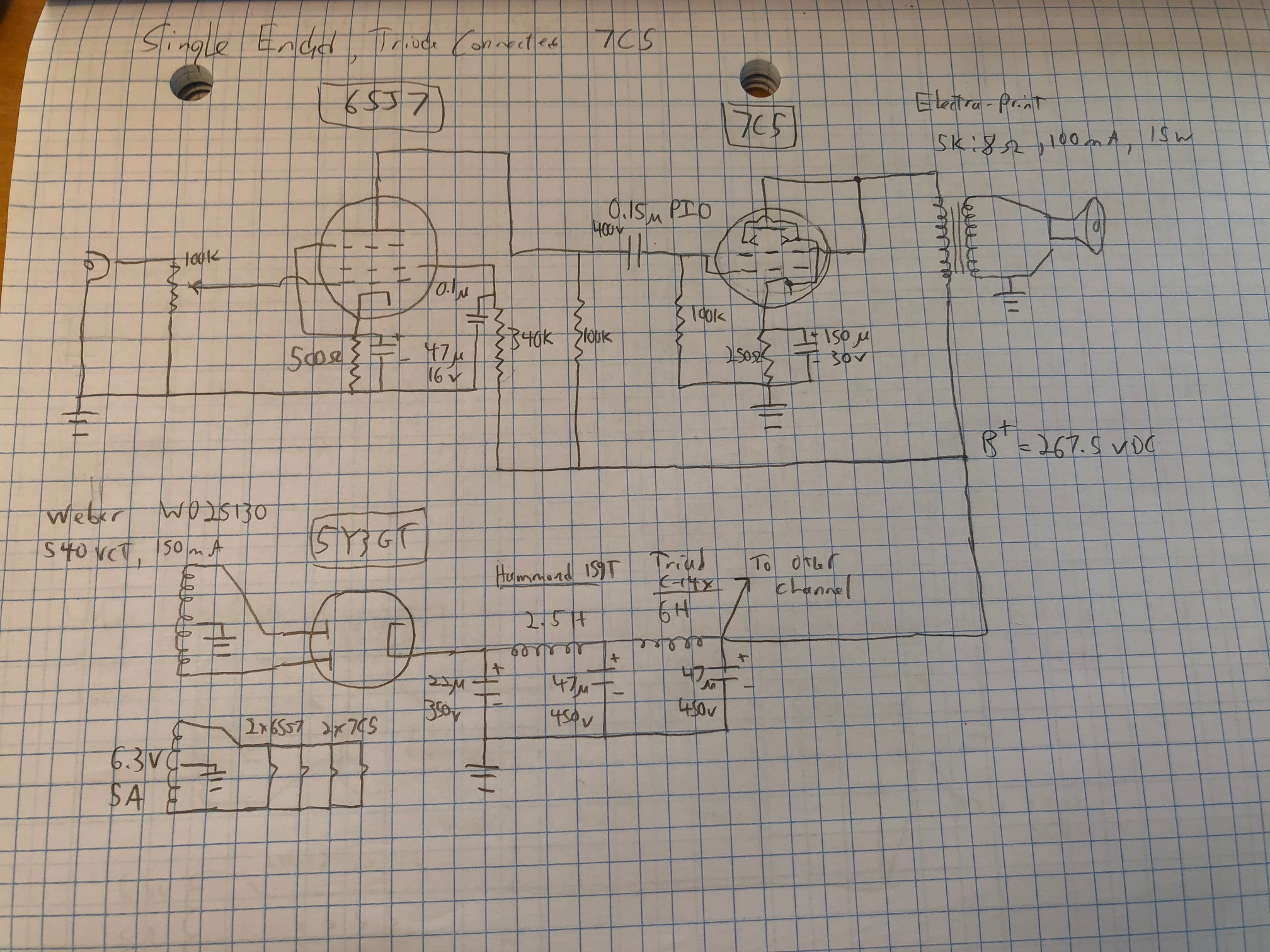

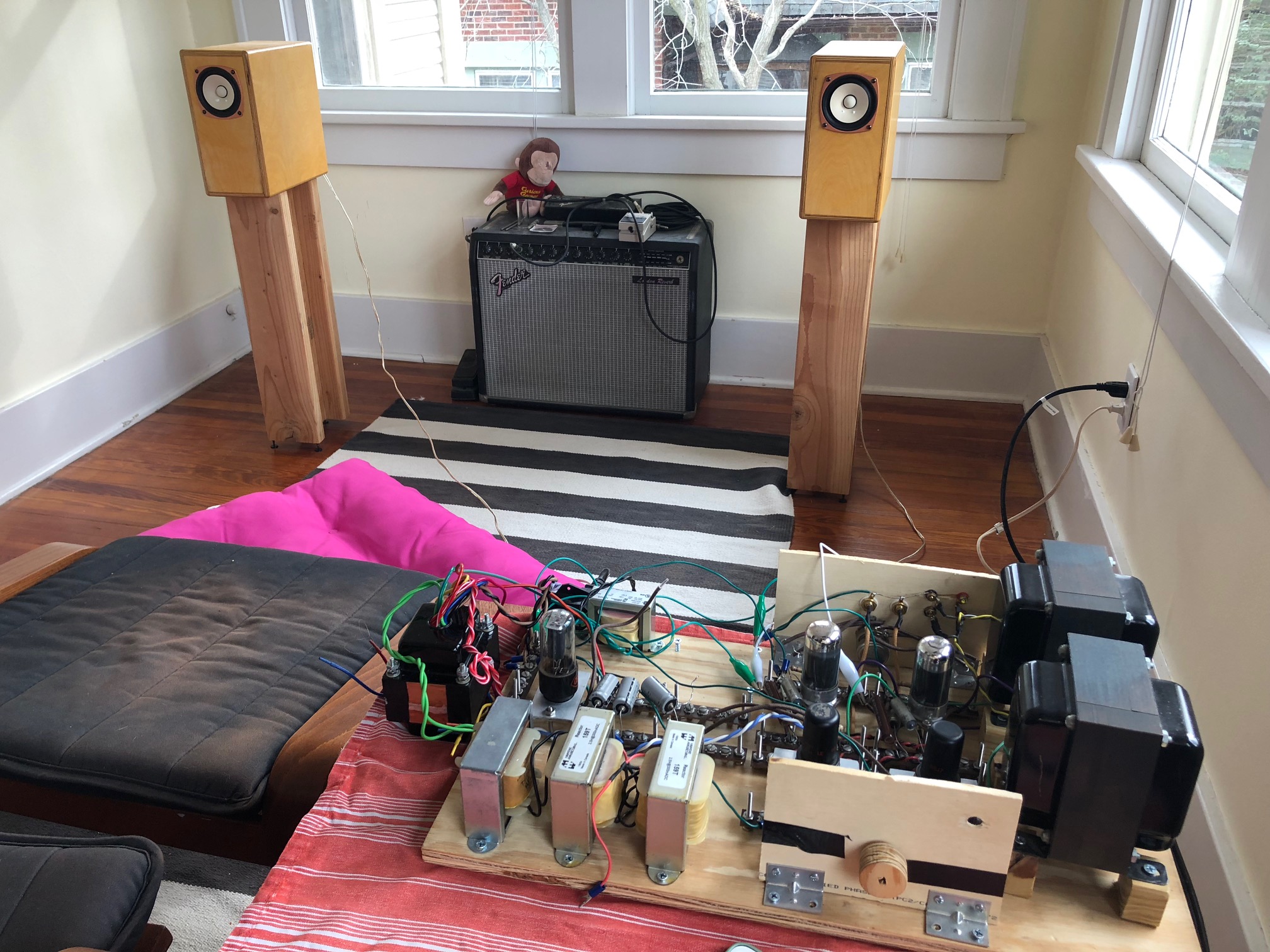

I've got a pair of 7C5 (loctal 6V6GT) and thought I would try designing an integrated SE amp that can directly play sources such as a CD player, computer, or phone. If any of the circuits end up sounding exceptional, I might do a final build of a speaker and headphone amp with a pair of Raphaelite 5.5K to 8R & 32R OPTs. At some point I might be interested in trying gas voltage regulator tubes, in traditional shunt configuration or in series like Decware does with the Mini Torii.
Input tube candidates in my stash are 6SJ7, 6SC7, 6SQ7, and 6AC7.
Right now I'm using a pair of 5K:8R, 100mA, 15W Electra-Print OPTs.
First, I built the Bates direct connected cathode follower amp just for the heck of it. It had a very nice, natural sound but at 1/2 a watt or so was too quiet for my 87db el cheapo test speakers. It's definitely a candidate for a headphone amp, though.

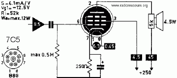

Then, since I've never worked with a pentode or beam tetrode before, I decided to start working with 7C5 in triode mode, using the GE 6V6-GT datasheet for reference.
Since I've used 6SJ7 to good effect in the Sound Practices WE91A as well as the Bates DC amp, I thought I'd try using it to drive a traditionally wired 7C5 that takes the output signal off the plate. For the input stage, I began with the RCA Resistor Coupled Chart for commonly used audio input tubes, picking a row in the 300V B+ section:
Rp 100K
Rg 100K
Rg2 350K (I could only find 340K at my electronics store, and am using that)
Voltage Gain 67

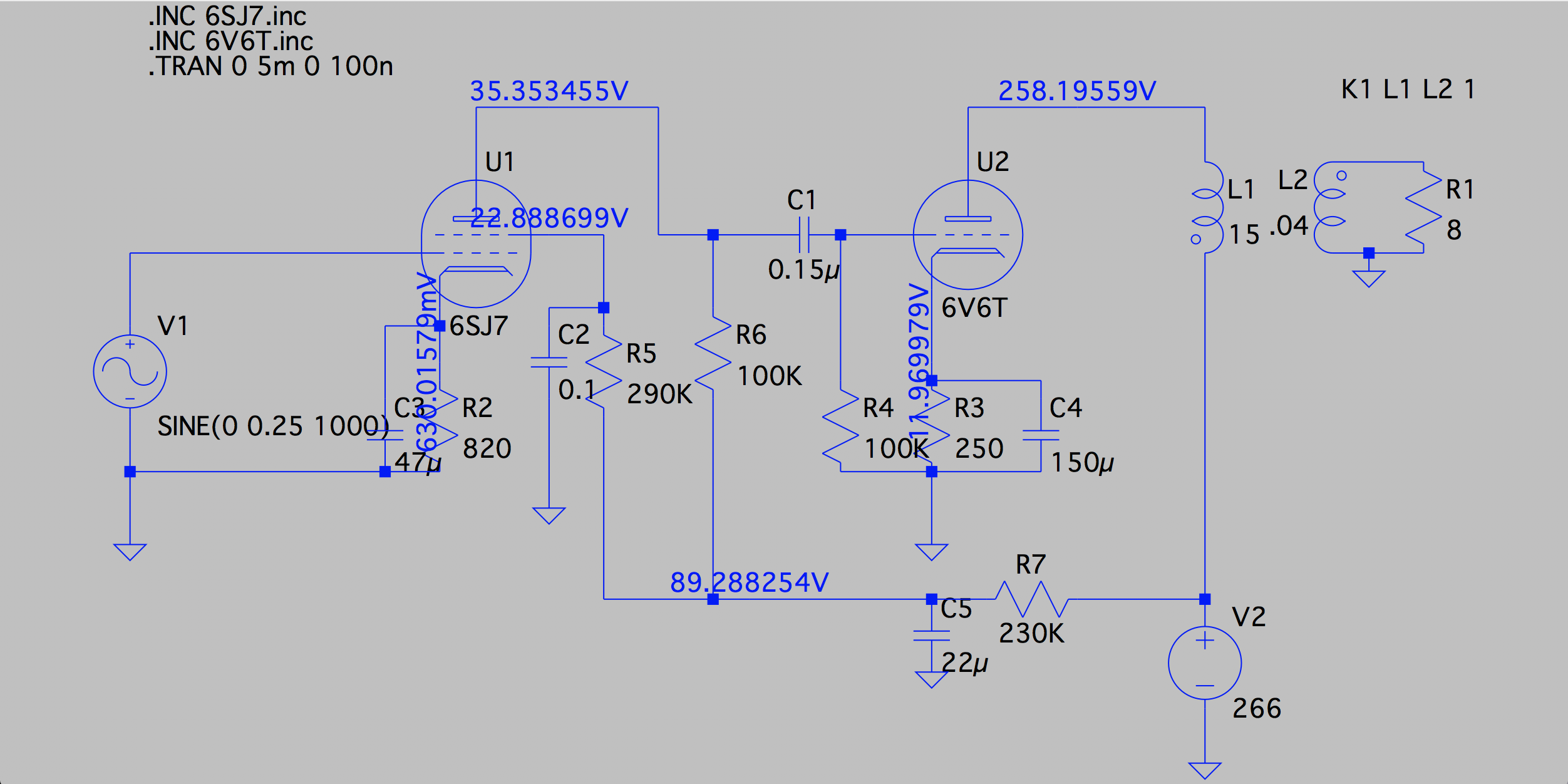

I breadboarded the circuit (schematic attached) and am listening to luxuriamusic.com as I type this. The attached LTSpice schemo accurately reflects the voltages I measured at those nodes. You'll see that my B+ is 266V, with 258V on the 7C5 plate and 12V on the cathode, for 246Vak. Slightly under the recommended triode operating points in the 6V6GT datasheet, but close enough for now, and it sounds good.
The power supply is:
PT 540VCT
1 x 5Y3GT
Single power supply rail: 22uF -- 6H (148R) -- 22uF -- 2.5H (39R) -- 22uF
Hum is quiet but audible when music is not playing, so higher capacitor values and/or larger value chokes would help. Also it's unenclosed and everything's a rat's nest.
I figure output power is roughly 1.5 watts. It can drive the sound on my 89db single full range driver speakers (Fostex FE103Sol) to earsplitting levels before it overdrives and distorts. I certainly don't need the 4.5 watts from pentode mode for this setup, but will try it later anyway just to hear what it sounds like.
For a next step, I might choose one of the lower gain operating points for the 6SJ7 (e.g. the row in the 90V Ebb range resulting in a Voltage Gain of 41) or putting it in triode mode for the amplification factor of 19.

I listened to the amp a little more today. The sound is opening up because the coupling caps -- a pair of NOS paper-in-oil, 0.15uF 400V, by PC -- and the screen grid caps -- NOS Cornell-Dubillier Black Cat 0.1uF 1000V -- are burning in.
Also switching from luxuriamusic.com to the Alfred Apaka channel on Pandora resulted in a *much* better signal quality. 🙂
Question about attenuation for headphone use. My headphones are 32 ohm Beyerdynamic DT-880, rated for a "power handling capacity" of 100mW.
I've got a pair of OPTs with dual secondaries that can be wired for 8 ohm (to speaker) or 32 ohm (to headphone), and I've figured out a way to use a 3PDT switch to toggle between the two.
With the 7C5 running in triode mode, at about 1.5 watts, would I fry the headphones if I don't attenuate the output from the 32 ohm secondary?
If I need to attenuate, what would be the best way to do that? Since the impedance is already matched, perhaps a simple resistor in series between OPT secondary and headphone jack would be sufficient? Or would I want to use something like an L-pad or T-pad (or something else)?

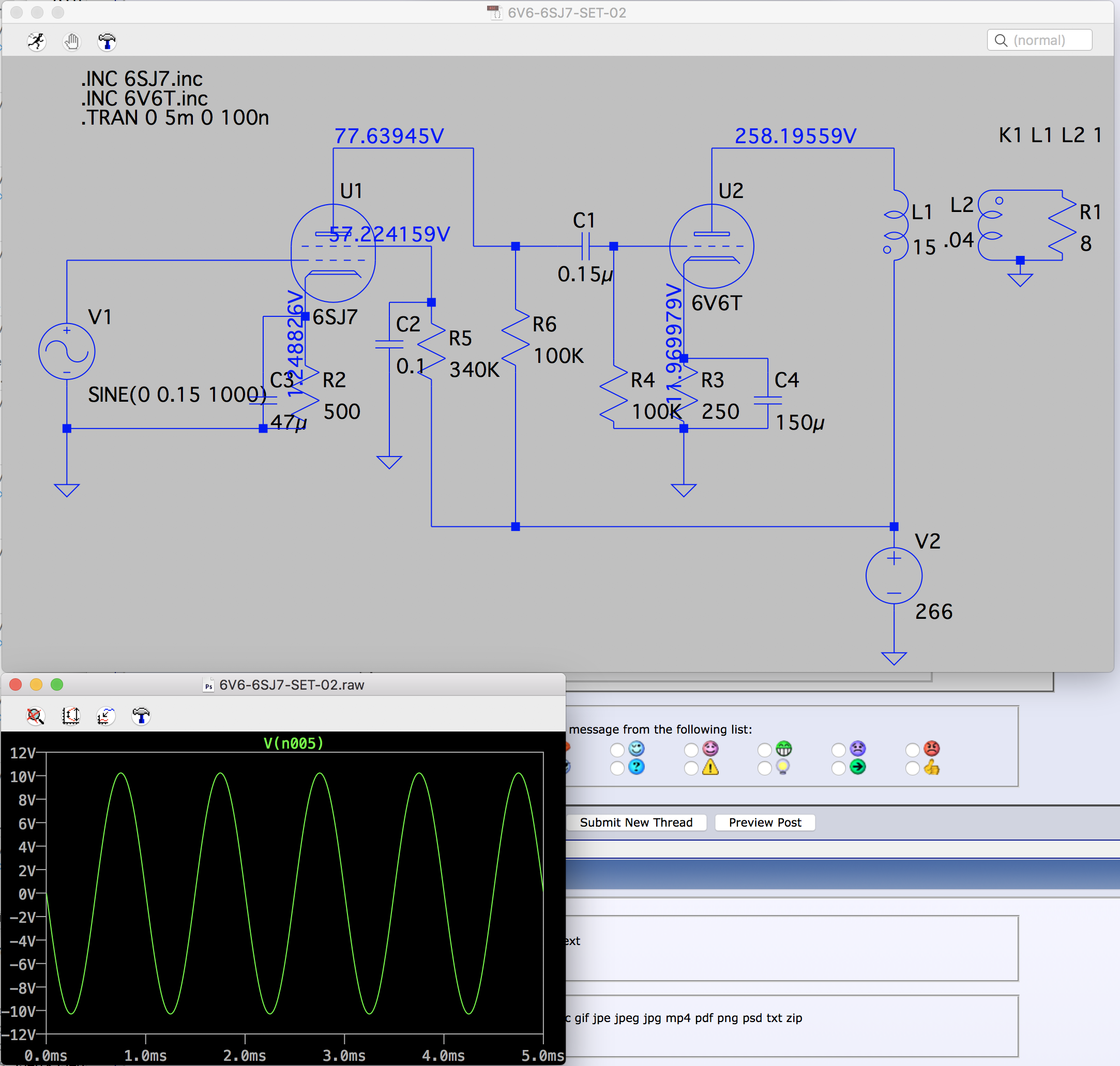

I tried two more operating points for the 6SJ7 today, using the RCA resistor chart for audio input tubes.
I'll refer to the version in post 1 as #1.
#2
Ebb -- 90V
Rp -- 100K
Rg -- 100K
Rg2 -- 290K
Rk -- 820R
Cg2 -- 0.1uF (the sheet calls for .09uF -- close enough)
Ck -- 47uF
C -- 0.15uF
Eo -- 18V
Voltage Gain -- 41

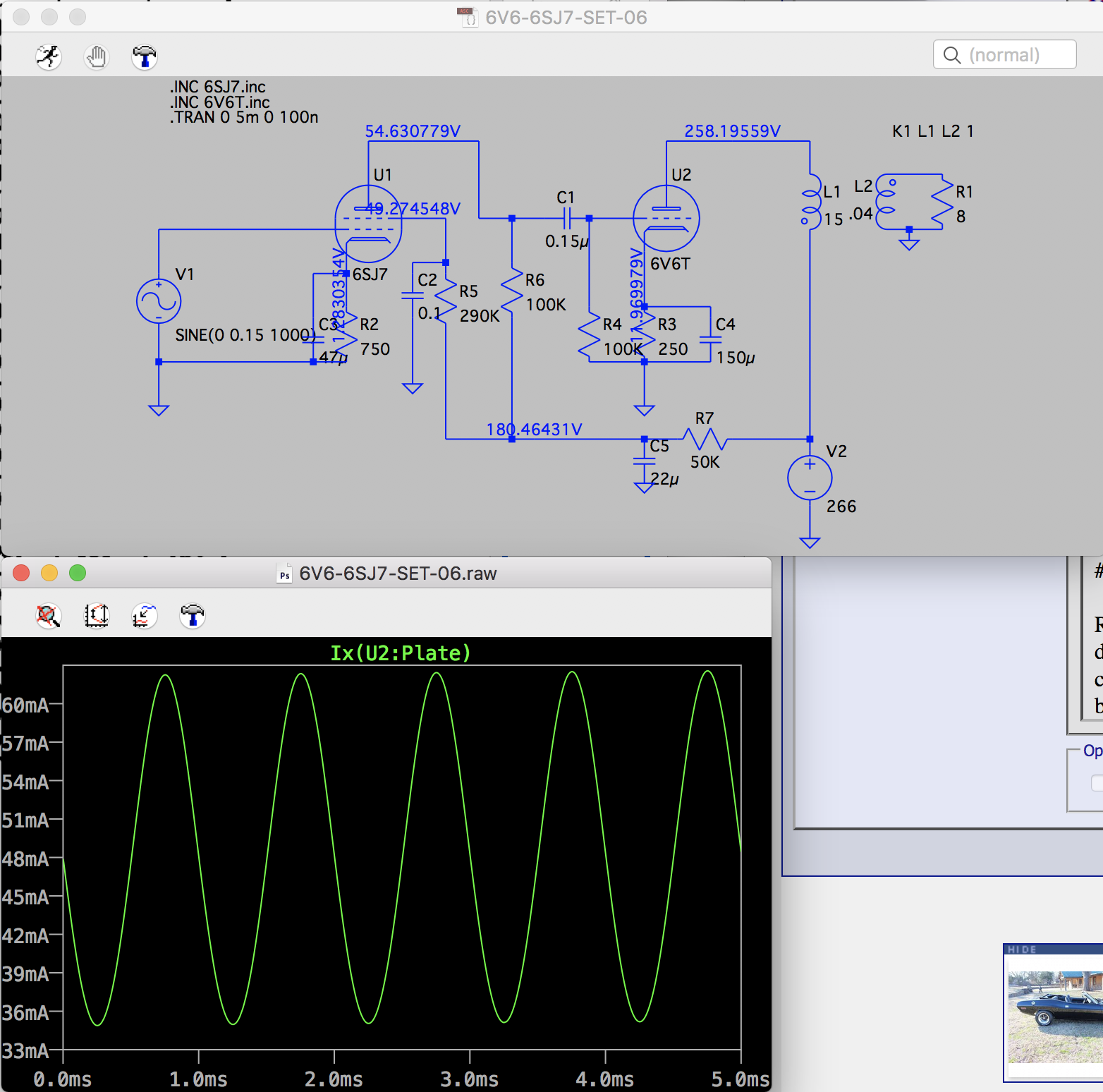

#3
Ebb -- 180V
Rp -- 100K
Rg -- 100K
Rg2 -- 290K
Rk -- 750R (didn't have enough room on the breadboard to add a 10R resistor in series -- close enough)
Cg2 -- 0.1uF
Ck -- 47uF
C -- 0.15uF
Eo -- 49
Voltage Gain -- 55
Attached screenshots of LTSpice show the voltages measured in the actual circuit (good models, designers. Thank you!).
#2 is noticeably less dynamic and lacked body (sounded a bit thin and hollow) compared to #1 and #3.
Right now I'm undecided whether #1 or #3 is better. #1 had wonderful harmonic development and was very dynamic and detailed. #3 is very similar, but possibly a little more controlled and might have an edge where detail is concerned. It also sounds a slightly better balanced overall than #1. But #1 is more exciting to listen to.
The gain in the input stage is certainly higher than it needs to be. I've been controlling the volume with the iPhone. Even clicking one step louder or softer results in a big change in volume. With the lowest gain setting (#2), the iPhone was at about half volume (it has 1V output at full volume), and it very loud.

I've done lots of listening to this circuit over the past several weeks with the 7C5 in triode mode, 6SJ7 with 340K Rg2, and think it worthy of a final build.
Today I wired the 7C5 in tetrode mode based on the resistor chart for that tube (attached). To get the 250V supply voltage, I added a 350R resistor and 22uF capacitor per channel to the power supply filter (it resulted in 251.5V). To my surprise, the amp was quieter. I had to turn up the volume nearly all the way to be able to hear it, and by that time it was overdriven and sounded like electric guitar distortion (acoustic slide guitar in Hawaiian music sounded like it was purposely [and even nicely] distorted -- kind of funny).
The 7C5 resistor chart and schematics for triode and pentode mode are attached here.
Not many of the existing single-ended 6V6 tetrode schematics run the tube in that way, yet I was surprised that going by the book resulted in poor sound quality. I should draw out load lines to start getting a sense of how to run the 7C5 in tetrode, but might not be able to get back to this for a few days, so thought I'd post the results here. At any rate, you can see the attached schematics for a sense of what I've been working with.
