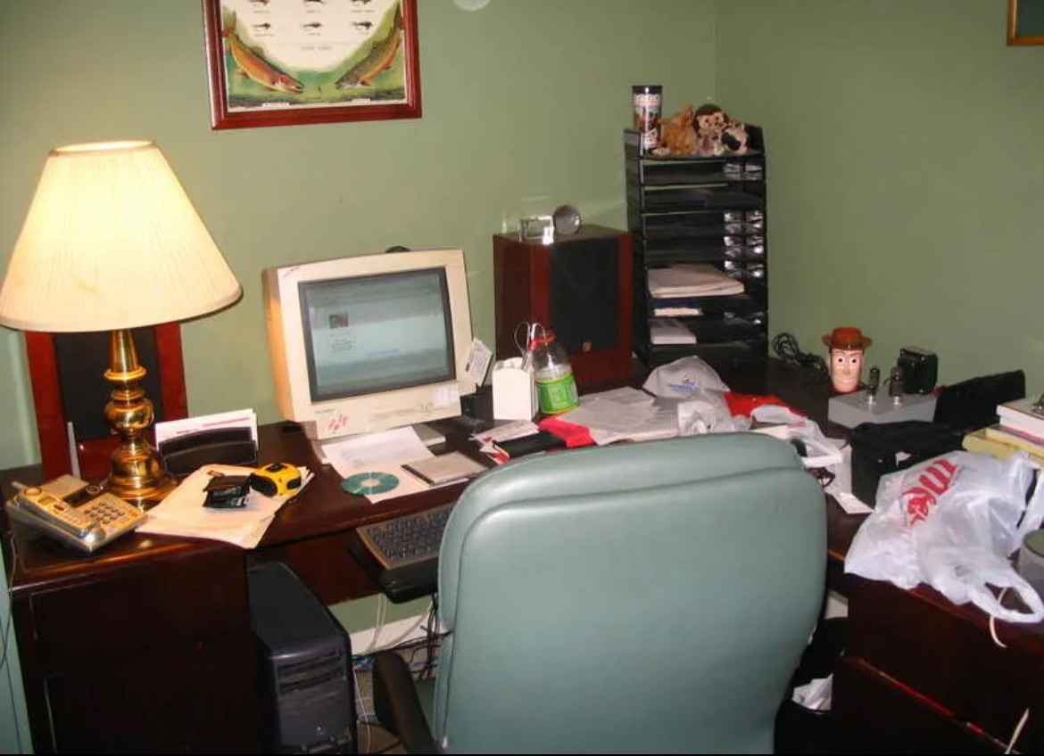

Here are the desktop speakers I built. Great sound but once in a while, a song will come in and I wish I had a smidge more low end.

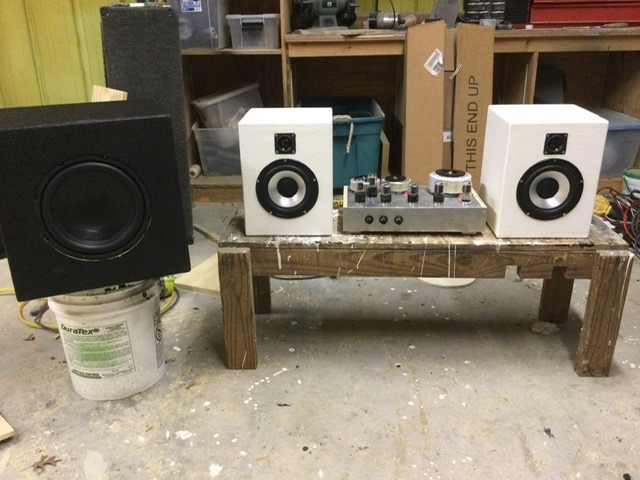

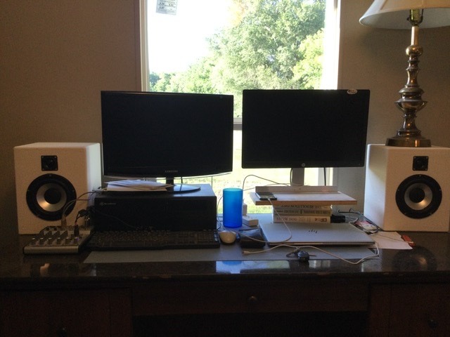

Here’s the cute little desktop system I built recently. Dayton 5 1/4 aluminum cone mid bass, and their 2” neo mid/tweet crossed at 400 Hz 3rd order. Difference in sensitivity handles the baffle step. Sub is the cheap 10” GRS high excursion unit, linkwitz transformed flat to 22. Crosses where the mains run out at 60. Home built plate amp on it. I’m using the system with a little tube amp 14WPC. Not much room in my temporary home while the new ones still under construction, so I had to stoop to building some “small” speakers for a change. The speakers themselves didn’t cost $200, and all the amplification from stuff on hand.

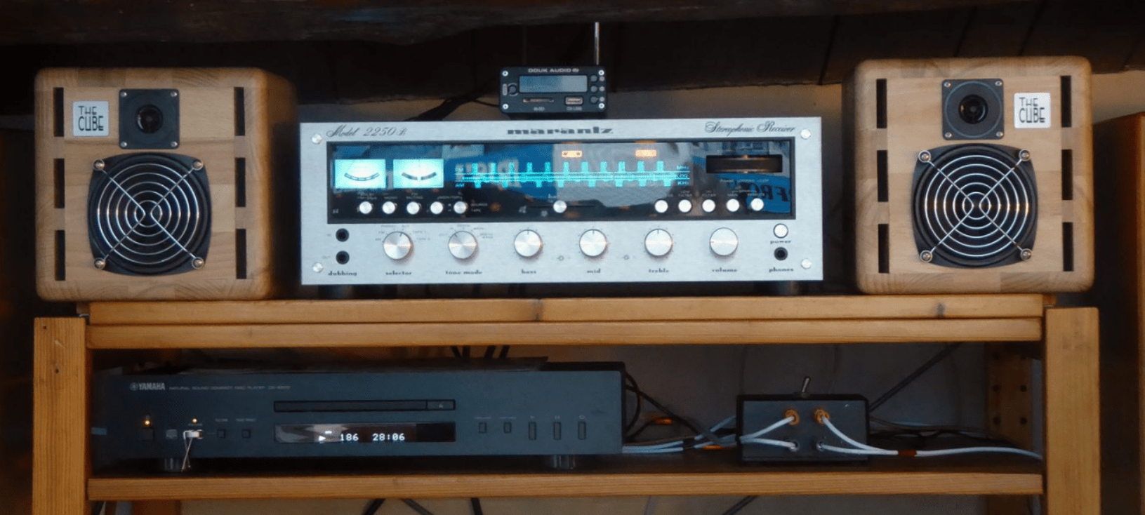

Here's my personal DIY take about desktop speakers : The Cube
Above with a Marantz 2025, below with a Marantz 2250B...
OK, these are not active loudspeakers, so you need an ampfifier, as you can see. They nor are put on a desktop here, but their cubic size of 200x200x200mm would nonetheless allow it... If your desktop is reasonably wide enough !
I made them from beechwood glulam, that I bought and have cut in a local DIY supermarket. The finish is natural oiling, after sanding and radiusing the edges :
Detail about Xover and speakers :
