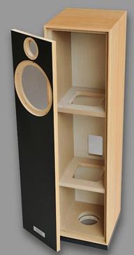

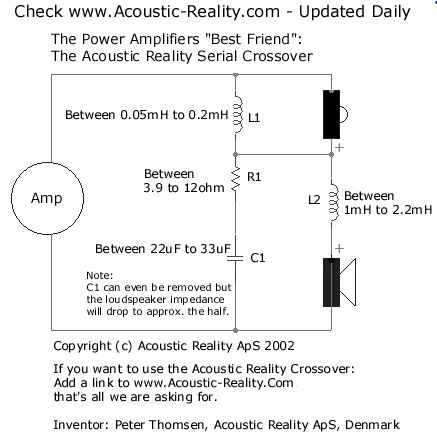

We had a guy unhappy with his similarly simple Epos M12i speakers a while back. Which used unfiltered bass. He wasn't interested in this idea and dumped them. Silly boy, IMO.
It's better to use a second order tweeter though, IMO. Which means adding a capacitor in series with the tweeter.

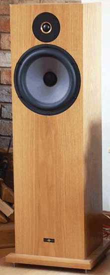

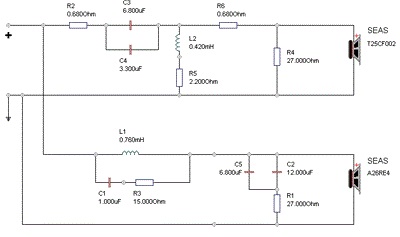

A fine article by Peter Comeau. He does something I like myself, and taken a free-running sort of smooth bass and given it just a LITTLE response shaping and 2kHz crossover.
The bass filter doesn't do an awful lot, but always sounds better than nothing at all IMO. It's quite an expensive SEAS Millenium tweeter, but I think you could use a DeVore Morel waveguide type too. The Monacor DT 300 with waveguide is more affordable. Not rocket-science, for sure. I'd take that on.

Yup. Half the 169L Vas for Closed box Qtc 0.707 I reckon. Qts 0.39. So 85L or 3 cu. feet. The above Tower WD25T EX is closed box from the impedance curve.
H1411-08 A26RE4

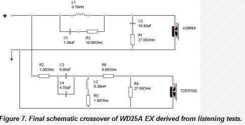

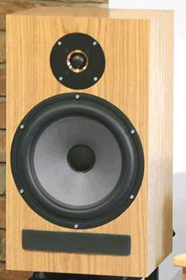

Here's the smaller WD25A EX, which looks like 45L with a damped aperiodic vent.
Designing Loudspeakers - WD25A The Final Crossover
Can't see the crossover is significantly different from the bigger stablemate. 🙂
