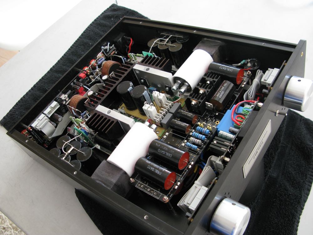

If you have a factory built unit it will have the DiyHiFiSupply DHT filament regulators fitted. They will either be the early ones, which were ok with 45 but prone to overheating and dying with 2A3 - they can be seen in Desmos post #84
or they will be the later versions which are more stable with 2A3, which can be seen here:
Neither of these original filament supplies is as quiet or as musically satisfying as Rob Coleman's supplies. They are strongly recommended by everybody on here who has fitted them, but they are some work to install....! :D
You need a pair of kits from Rod, which need to be mounted carefully to address heat dissipation - directly to the chassis, or using a heat spreader, or fitting additional internal heat sinks.
You will also need to build a pair of "raw dc supplies" to feed the Reg boards. These can use the two 7V filament windings on the Tram mains transformer, and Rods instructions gives a lot of guidance about designing the raw dc supply. I used Schottky diodes to make a bridge, and BHC ALS30 series caps.

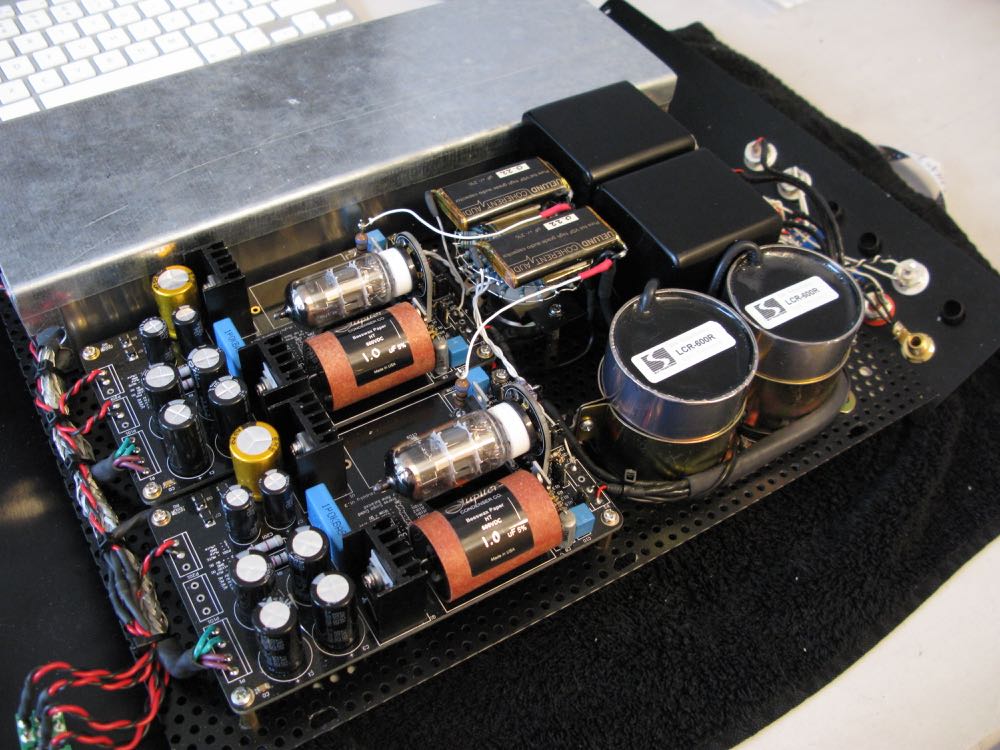

I think I have it sorted now. I think this preamp is quite lovely in most ways but I notice it is quite noisy while warming up (not the biggest deal breaker) and then settles down to only ever so slightly noisy/microphonic. I broke down and bought EML 45s (reg ones) and they aren't any less noisy than my OS 45s. I had read a couple of places that Coleman's regs cut down noisy but also microphonics, so I am going to order some of the kits.

Just on a side note, I am running my tram with Coleman regs and eml 45 globes into some very efficient horns and there was still some noise. After talking with some friends I decided to change the 10uf obbligato that grounds the b+ supply for some 20uf solen pb caps.
The effect was dramatic! Lower noise floor, wider, deeper and more liquid. I then did this for rab28 and Bryan's with a before and after comparison: same result :) very cheap so give it a try. One other tweak is to point to point wire the CCS and invert it and fix the trimmer to the the chassis with a small hole for for adjustment. This is great as you then don't have to turn it over and as the chassis acts as a heat sink it seems to keep the trimmer from drifting.

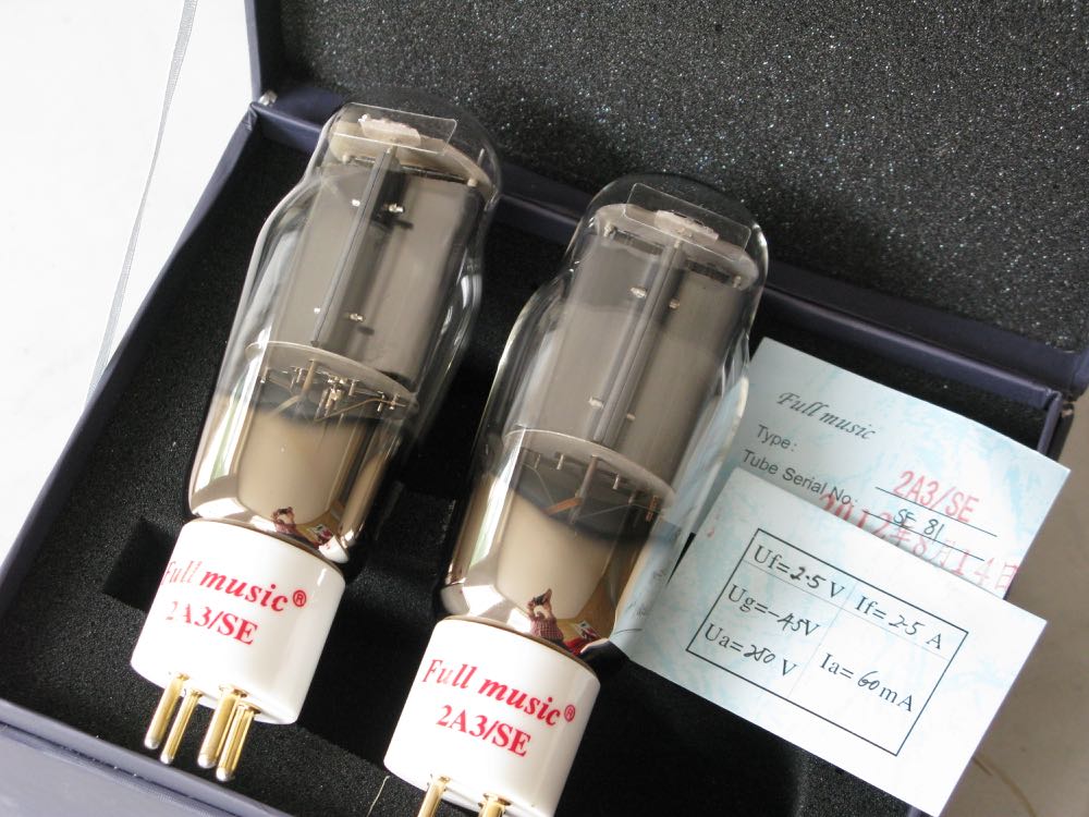

So if anyone is interested in my Tram II and my The Vinyl Song LCR phono stage - let me know - send me a pm. As you know from this thread I have spend endless hours (and money) to get the Tram II to the max, same goes for the phono stage with the amzing Hashimoto step-up's and more. I have a ton of tubes also, including the very expensive, and extremely good sounding Full Music 2A3/SE.

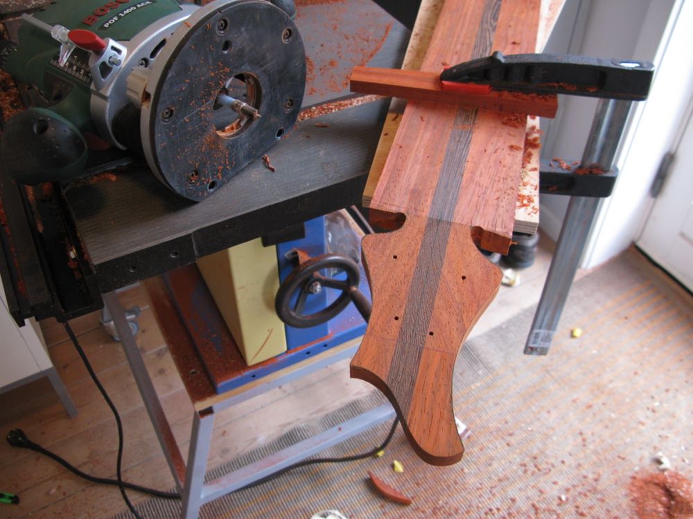

I have always loved learning something new and working with DIY. I find it very rewarding to learn about building instruments. There is so much more going on with this than just ''slapping pieces of wood together'' and there is so much craftsmanship involved. And so much creativity and design... I love it..!
Here are some pictures of a bass neck in progress that I'm working on right now, where I have managed to make my first so called ''scarf joint neck''. Not easy, but it worked out. And the last two pictures is of a chambered bass body I made for another bass. Very cool (I think), and sorry for the off topic :)
