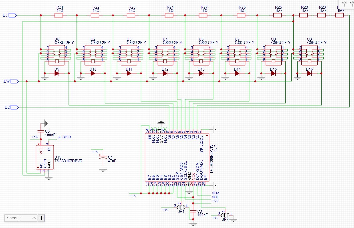

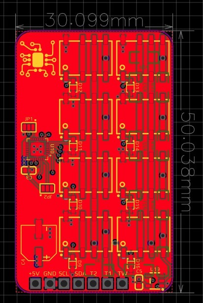

This one is linear analog pot digitaly controled, uses I2C & one gpio, have 8 steps but can be redesigned to 256 step log pot : )
u19 is to keep status of the pot until mcu is alive, and also to prevent clicks and pops, in our case I'm used u19 for that thing in lin pot project but can be removed in log pot configuration. Vertical mount pcb.

Pcb above is mono version, earlier I have not used any relay, used only MAX ic but I was not satisfied with sound 100%, later figured out in d.s. that MAX have 90db thd and decided to add relays. For 256 step (see link in earlier post) you need only 8 relays, speaking about mono configuration. Pcb is small 50x30, verticaly mounted use small area, that's my next project : ) Max ic can be replaced with an stm8 3x3mm programed in i2c slave mode with programed logic for 256 steps for example... I'm expecting good sound using this type of analog attenuator in my revised project! Concretly I have configured it as a lin pot for tone control, 8 steps is good enought for me for tone control. I am thinked to use ts5a or some even better but definitelly the good pot must be fully analog for best result so relays and resistors in my opinion is the best for this type of pot.

But would not allow for balance control. Like a dual-gang pot.
one relay group covers 2 phases or two channels
if bal, you need to double number of relays
how you're to control 2 groups and make balance control - if you're able to make code for simplest, adding function or two is trivial
anyhow- decide - is this MUSE thread, or whatever as long it works proper?
