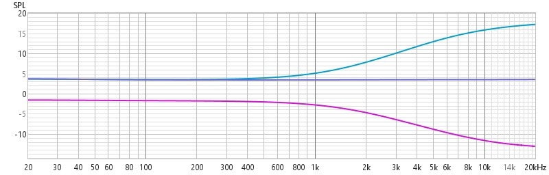

I'll attach a screenshot of an audio sweep (using Room EQ Wizard as a cheap audio analyzer).
For now I'll use a different circuit as I need to continue with the project. But it's still bugging me why a digipot that's specifically designed for higher analog voltages won't work in this circuit... 🤔

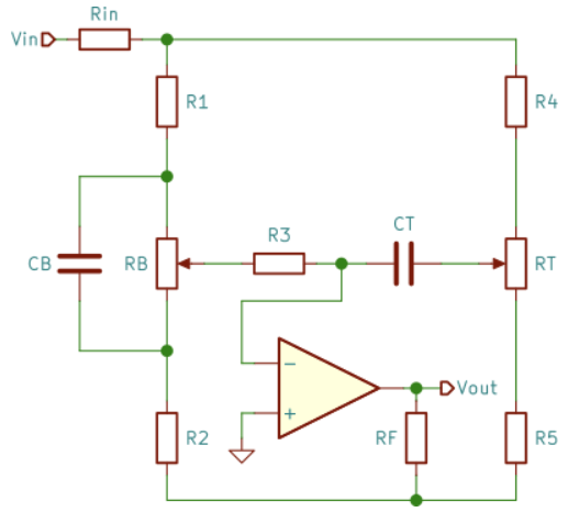

This sounds like an added feature not present in the guitar article. Would you provide a simple sketch of the inverting gain amp idea? Thanks.However, my new circuit is active, with the big difference that I'm using the digipot as an adjustable resistor (rheostat) to adjust the gain of an inverting amplifier rather than having all three terminals connected.
It's literally the standard Baxandall schematic with digipots instead of regular ones. My project's schematic is spread out across multiple sheets, so it makes no sense to post that.Are you able to post a schematic?
I included a link to it, but I'll also attach a screenshot.Shematic in the first post in the thread
The used op amps were TL071 and NE5534 (made no difference), the pot was the MCP41HV51 100k, power was +/-15V and for the SPI signals I used an Arduino Micro (powered via USB, common GND).

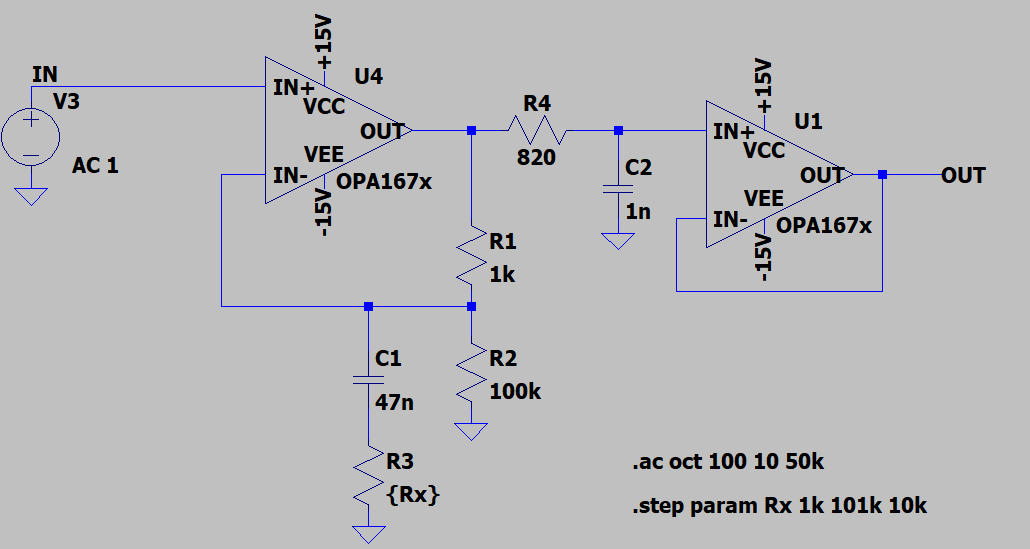

In theory, you can boost the highs by (partly) removing them from the feedback network of an amplifier. So basically another gain control just for high frequencies. I'll include a rough sketch with a non inverting op amp: R3 is the adjustable 100k digipot with 1k in series and the following high pass filter should prevent any high frequency oscillations. The only "issue" with this circuit is that it can only boost the highs (+6dB), but not cut them - which is fine for my application.This sounds like an added feature not present in the guitar article. Would you provide a simple sketch of the inverting gain amp idea? Thanks.
That's actually it! 👍My suspicion is that the opamp may be oscillating

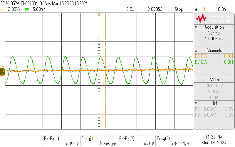

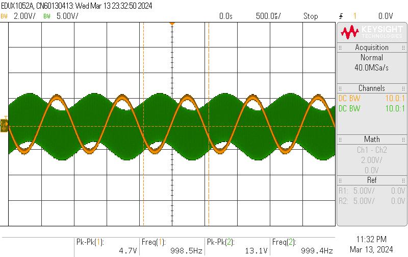

I set everything up on a breadboard once again and did some more testing:
The low frequency half of the circuit works just as well with the digipot as it does with a regular one. So that part is fine.
The high frequency part however, does indeed oscillate when the pot is set to cut. Boosting works as expected.
Interestingly, this even happens with a regular (trim) pot. So, the problem doesn't even seem to be connected to the digipot.
What else could be causing this effect? Baxandall tone controls are "tried and trusted". Could it be an issue with the breadboard or the used TL071? 🤔
It does reduce the oscillation's amplitude a bit, but even with 1nF the problem is far from gone.try tacking a 100pF cap from opamp output to inverting input
Could the phase shift caused by the treble capacitor be the culprit? After all it's in the feedback network and might turn the negative feedback into positive feedback that doesn't get attenuated enough depending on the pots position. Are high quality caps important for this circuit? 🤔
I'm offering some suggestions purely on instinct.
I would try making Rf=0 and see what effect that may have. (If the system needs a 600R output impedance, it should be in series with output, not included within feedback network.)
Next experiment would install a short from opamp out to - input. This should make the opamp a unity gain stage. It should be stable, bit if it isn't, my bet is that therein lies the problem.
P.S. Make sure you're using x10 scope probes.
