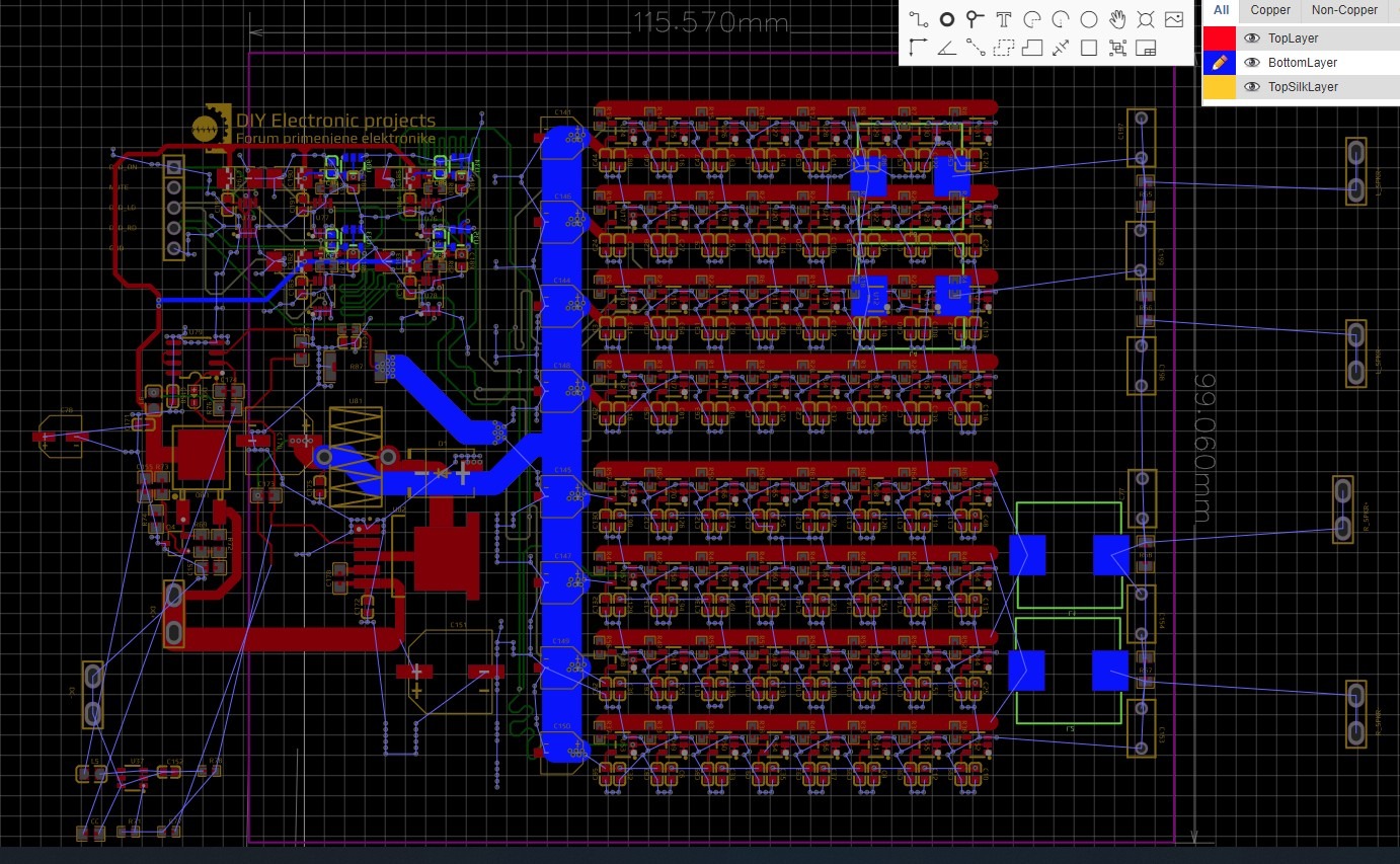

Pcb is FR4 standard with HASL and lead, the cheapest one option, 1oz on all 4 layers, around $48, ENIG with lead free + gold is much higher in cost, around double the price. Components around $68, my customs clearance + pdv for pcb and components around 30%, and my work = total 250eur for populated pcb. For enig pcb it cost higher than 250EUR, must recalculate proportionaly by cost of enig pcb+customs and pdv! Shipping don't know since never sent anything internationaly, I must check that. My country is not inside European Union and not iside that VAT system, I must pay around %20 for VAT and around +10% for customs, total 250EUR which I have calculated is around price!

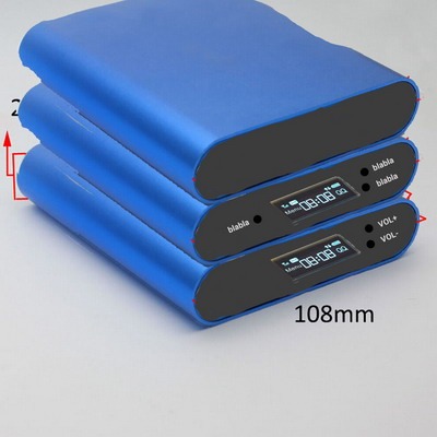

Ok, I will prepare my budget for few pcb's and components soon, month-two it will be ready! I'm started revising our mini concept, idea is placing 3 alu caces on top of each other, one case will contain DDPD, seccond one DDPD frontend, and 3rd one power supply digitaly controled, with oled display for volume control level display. DDPD frontend will contain USB input, two optic inputs, bluetooth, fm radio, oled too. Remote control & opt encoder, or maybe buttons insead of opt encoder. It will be not that soon but its in my plan at least I want to have something like that in my home : )

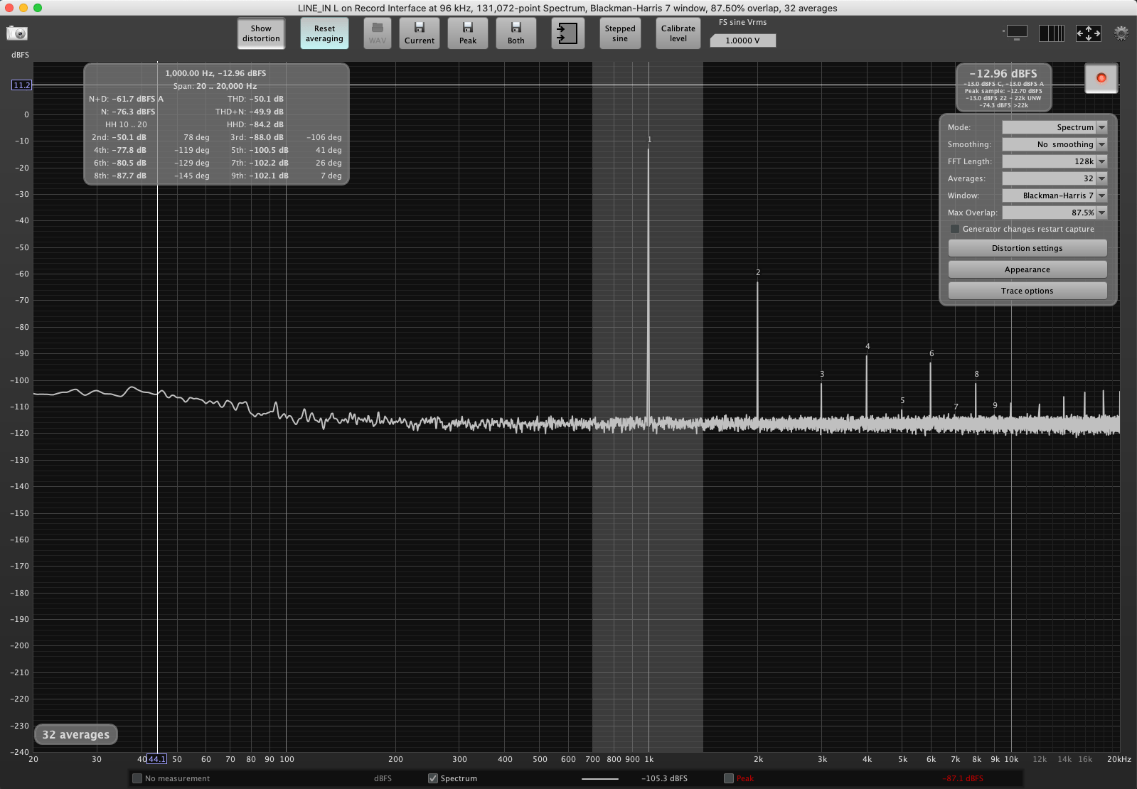

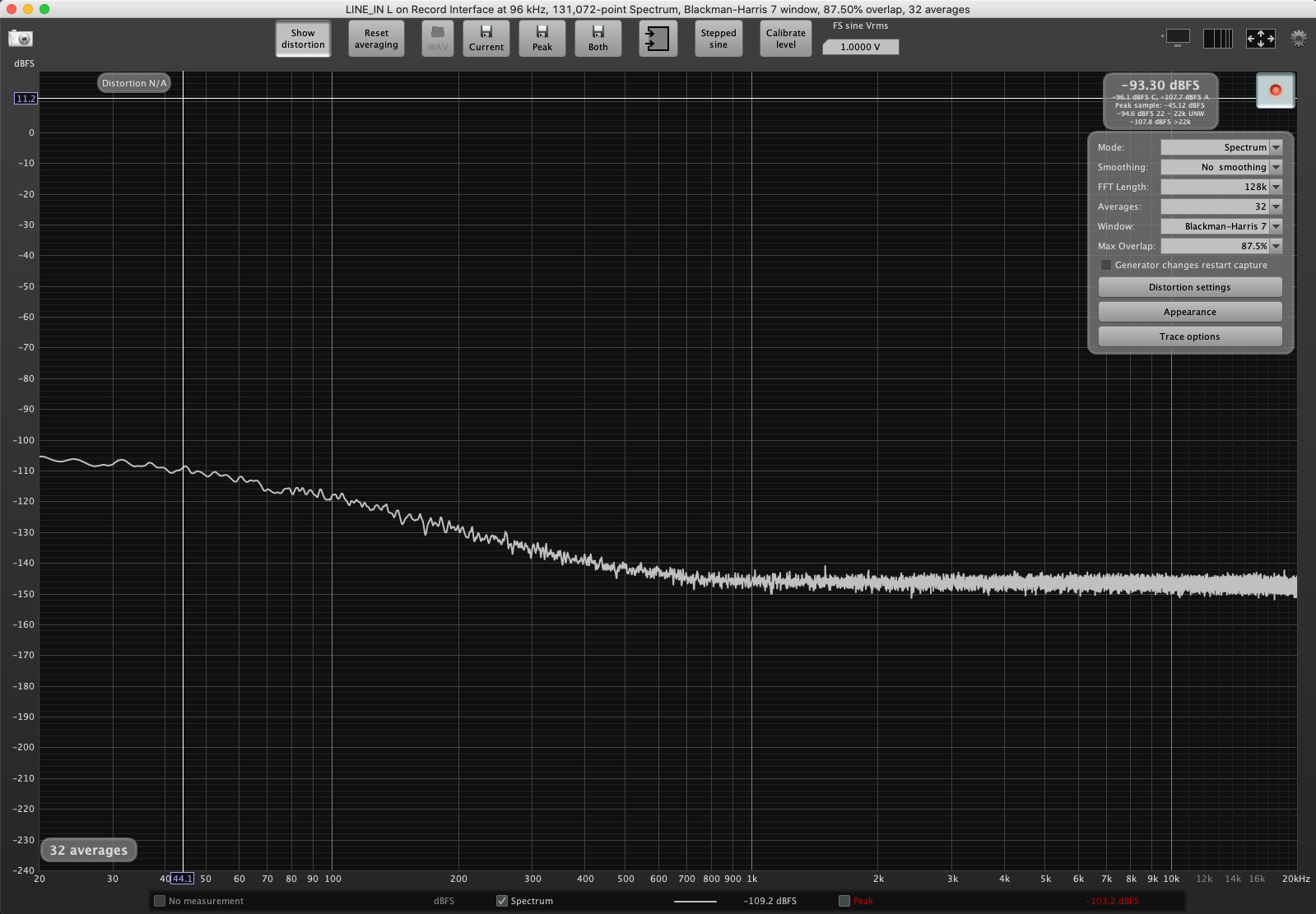

The first preliminary measurement result from my colegue, I will do further measurements when ddpd frontend get finished, I will put aux0025 filter with atenuator between ddpd and Cosmos ADC for better result, this preliminary measurements is not that bad at all! : ) The problem here is pin headers connection, next DDPD revision will contain u-fl connection between DDPD and frontend since pin headers is like antena and it definitelly is not good for high frequency things, connection must be coaxial for better result! Even this looks very good, it promising! Minimum volume voltage must be allso revided, minimum voltage must be not < 1.65V as 74 registers regure that minimum. Also 1000uF condensers (x8) I will remove as it cause voltage regulator CCV not to function since acumulated energy inside those 8 capacitors give 6A but we need CCV limit 1A, it will be replaced with 64uF, also tantal capacitors will get replaced with ceramic capacitors because I need DDPD pcb very small to be able to use enclosure from post 25. I'm started revising DDPD! It will probably get digital supply in preparation to things from post 26, I will let you know the progress!
The result from my colegue:
"Measurements with Cosmos ADC and suggested settings, sine reproduced from HQPlayer and with two levels from the player, with 0dBFS and -18dBFS, the third recording is with short inputs at the end of the measuring cable. Cosmos is set to 1.7V input level, DDPD output voltage to minimum 1.24V"
Hi Savan,
Thanks for posting your preliminary results.
As to distortion I sort of was expecting this distortion level: I have been trying out quite some logic ICs in the last couple of years and in my experience none of them "like" to deliver current if the distortion is also to be kept at a low level. E.g. the Potato Semi ICs reached a distortion level of ~- 70 dB when delivering appr. 1 mA. With only slight variation I have had similar results for all the other ICs I have tried (NC7SZ, 74AC, 74AUP) ...
Just FYI if you are interested.
Cheers, Jesper

Some progress on revided DDPD, idea is from post 26, so in this stage 1 (first blue alu) must be room for oled display, mcu, 3 buttons, infra red, back side must contain 4 sma_to_ufl conectors (dsd input), dc socket and four banana chasis connectors for speakers, my hope everything will fit in the box : ) Whole pcb is a lot smaller than initial one. Infra red is for remote control. Oled will display volume level. One button for power and two buttons for volume control. Volume control is digitaly controled buck regulator, from 1.25V to 5V. Next is designing stage 2, digital frontend. Stage 3 no need, so only two alu enclosures instead of 3 as per post 26 : )
