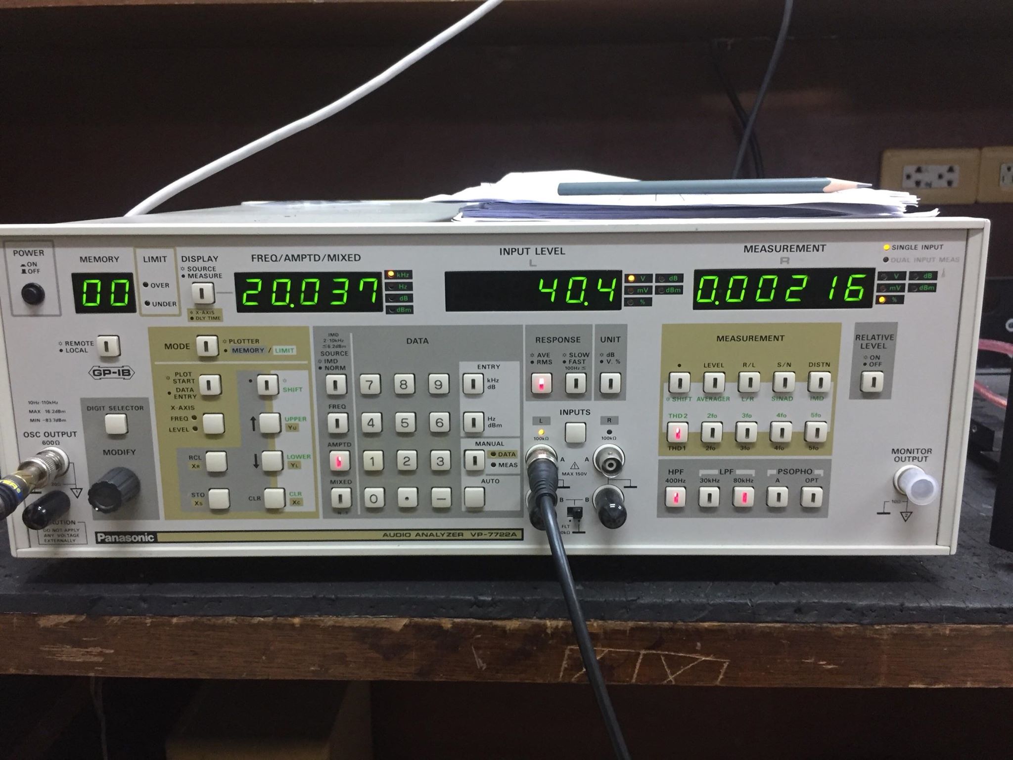

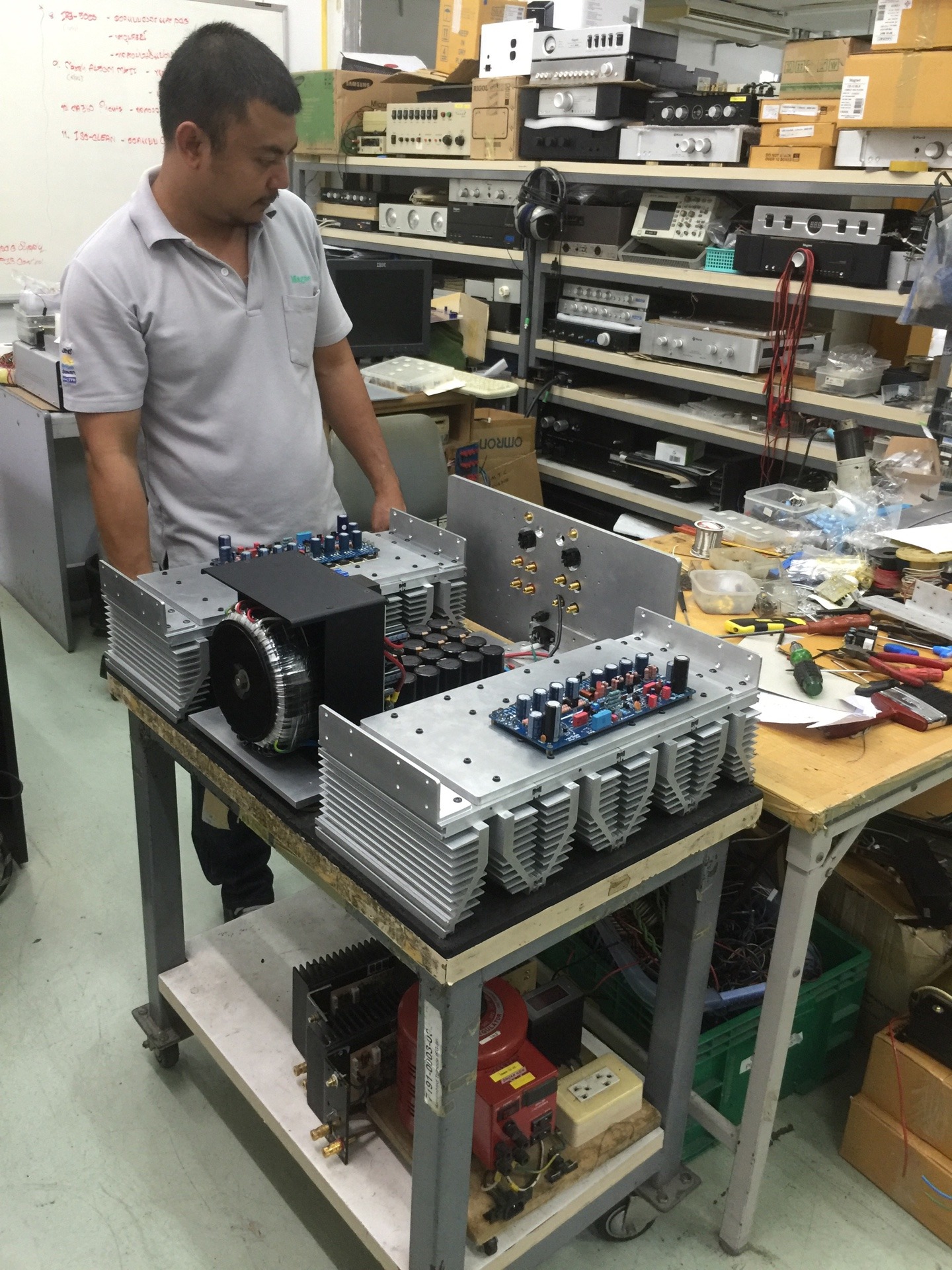

This is the measurement of my 200W CFA (it was built in Thailand).

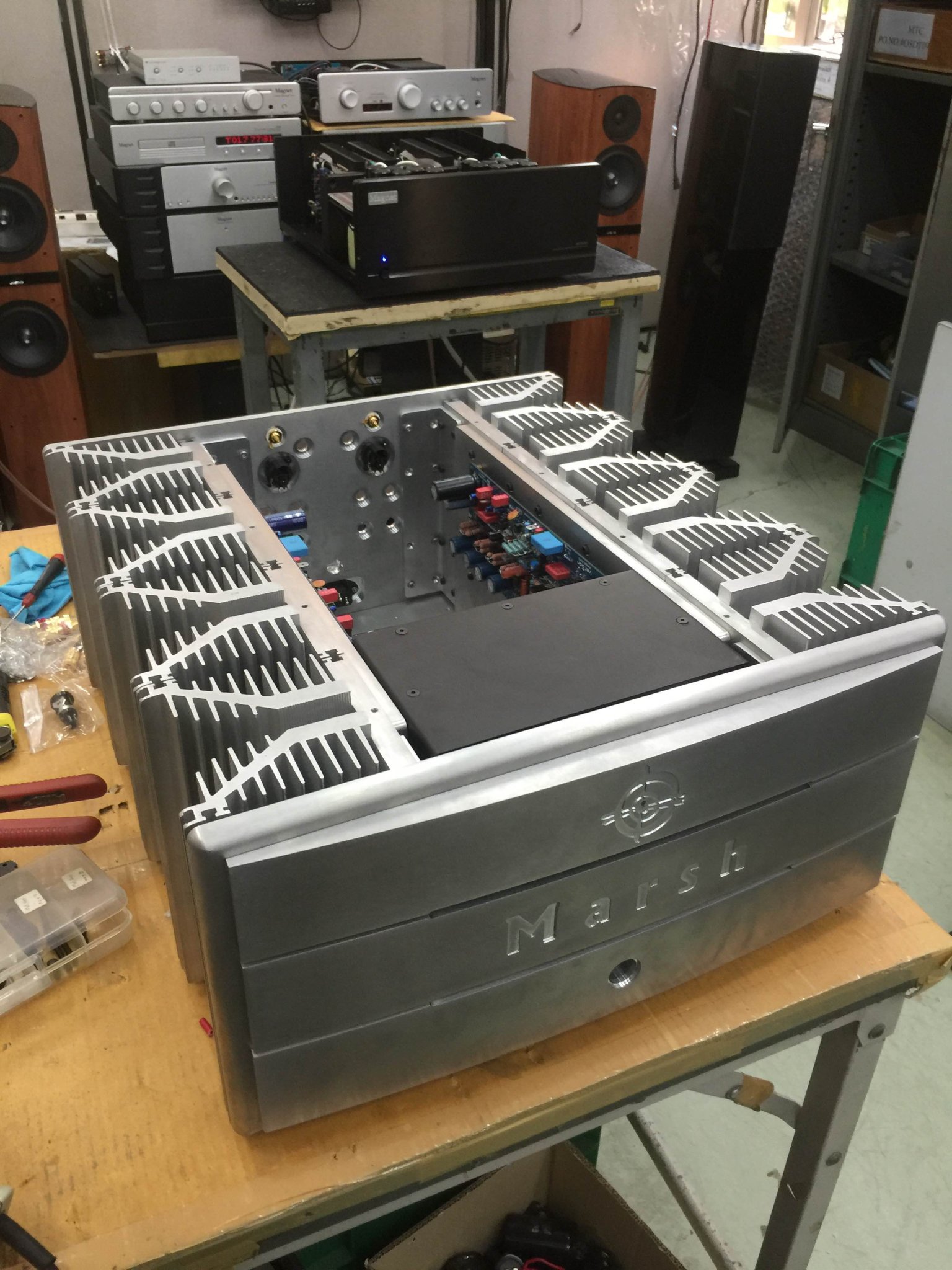

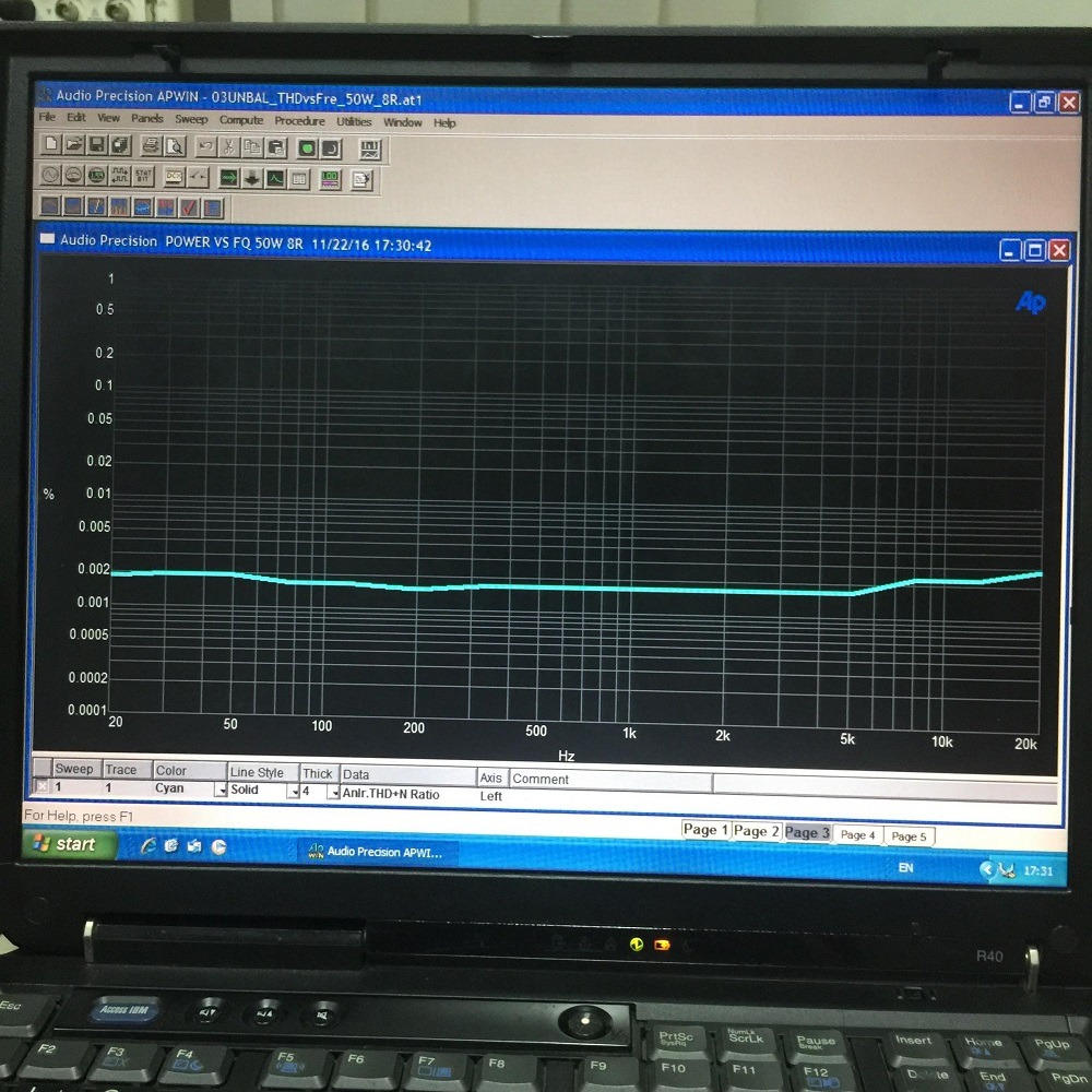

I'm primarily interested in the THD (+N) curve as a function of P and f - in other words, in the classic, old-school way.
In addition, the residual, the spectrum and the method of determination.

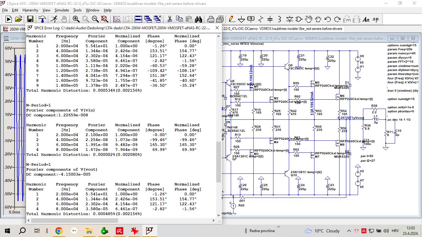

Here is simulated result at the same 20kHz and 40V as in the measured THD post #24, and it is only 4 to 5 times better. So I trast simulation very much when used good semicounductor models and good layout.

Your skepticism threshold is set way too high. Available free simulators and models are very good, or extremely good for the money. 🙂
I would set threshold at 0.000x% value. As bimo nailed it, difference between simulation and real circuit is mostly in the mistakes made during design and execution of the real thing. In example, a single wrong decision in PCB design can result with 20 dB worse distortion at 0.0000x% distortion levels.
I can offer comparison of latest amplifier that I’ve built and have extensively measured. Simulation predicted 0.00004% at 1W/8R. Measured result is 0.00007 – 0.00009 %, depending on channel sample and position of the moon and stars.
Harmonics distribution is similar to the simulation results as well. Simulated noise and power bandwidth are spot on.
My experience is that simulations are very useful if you learned how to put together good enough model.

Do you have the operating instructions /user manual for the fantastic Panasonic analyzer to hand?
I love this antique measuring technology and am curious to see what the manual contains.
You have both measured around 0.003% and simulated 0.0006% - is that correct in terms of magnitude?
