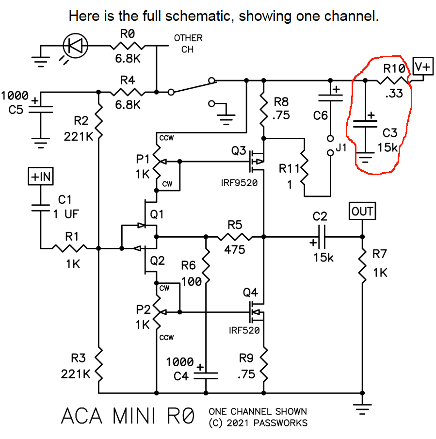

Ok, general question to you experienced guys... my brain is a bit tired today and can't work out between 2 models LOL (plus I might have a bias on one of them, habits habits...)
Say you have a decent big SMPS with sadly an unknown output impedance (and I presume these devices have some caps at the output).
Say you want to drive any power amp directly, that is without its PS section (no caps, no rectifier, no filter). Obviously you don't have its impedance either, let's go for common values / ball park?
Now inbetween the SMPS and the amp you want to put some filtering device, obviously including some caps.
The question is: doing this, are you better off going for a filtering device corresponding to LCR... or to RLC ?
In either case the values of L, R and C would be the same.
If you really need some values, let's take L = 330uH , R=0.3R, C= 15000uF and assume near perfect components.
Can anyone give me a hint on the differences / prefered option between LRC or RLC on a pure filtering basis?
My poor brain says "LRC = L doing some mild HF filtering (TBD!) - followed by a classical RC first order filter" vs " RLC = Useless R to reduce just voltage - followed by classical second order (steeper / better than 1st order) LC filtering", so the latter would possibly win re filtering unless the coil is doing a great job, which is possible. And as in both cases the amp sees the same C there is no fear re PS output impedance .... but there must for sure be more to it as placing the coil where I just did it with ACA Mini (and not where I wanted it initialy, thanks to MJ's great hint!) proved very effective...
Sorry for the stupid question, bit tired tonight, this is part of a bigger scheme for the ACA Mini, having an answer / confirmation of that simple question would reduce all the options currently flying in my head... for a bigger scheme!
Many thanks
Claude

I have a dumb question. I think I know the answer but will seek your op[inion to be sure. If the 330uH Murata is used between the SMPS and supply is any kind of diode needed across the coil as with a relay, to mitigate kickback? Or, unlike a relay, will no dode be needed because the coil will remain under load when the power has been shut off? I'm thinking the latter but would like to be sure. Thanks in advance for any insight.
Not sure I understand your post correctly, but just as a side note to make sure we get the same picture...
The coil is in series with the +, not in parallel between plus and neutral. Eg. no current flowing = no tension at the coil.
Obviously at shut off the coil will for a very limited time per nature fight against this change of status (24V vs 0V) and try to compensate (it won't but will try to) , but it is a ("very" in our case) transient matter. Same at power on...
I hope this helps - although you perhaps got it right first time anyway and if so sorry for the interference
Claude
Claude
As said normal operational transient, so I would say normal.
At least at ours it didn't cause any side effect, os we didn't bother at all. Sale as caps discharging really...
Just as a side note, one may think that shutting off the PS (not the switch on the ACA Mini obviously, but the SMPS power) would cause the coil to discharge and whatever distorted tone to "come out". Well, if so forget the coil, our (indeed uprated) SMPS despite being unplugged.... lasts for several dozen of seconds and the ACA Mini keeps playing undistorted for a while, and then distords womewhat shortly and funnily. Not that I would do that everytime, but at least we tried once without willing to LOL.
I would say the biggest time constant in our amp so far has been... from the SMPS side at switch off. Unsuspected by us until we found out.
BUT... back to topic, anyone to answer my question re LRC vs RLC? ;-)
