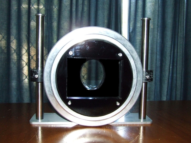

Here is the latest development of the MK5.

Hi Bill,
In that time there has been a few products developed.
After the MK3 came the MK4. This was the first of the true cylindrical lenses.
Because the MK4 offered such a HUGE improvement over the MK3, I revisited it by developing the CAVX Corrector which when added to the MK3 improved the focus. The MK3 was then renamed the MK3+C.
Then came the MK5 when I wanted to cut the production costs of the MK4. The MK5 uses the same optics of the MK4, but focuses on the stand and its adjustments rather than just the optics. They were designed by a professional lens maker and can not be DIY'd. Same goes for both the prisms and correction lens in the MK3+C.
The ONLY way the MK5 could be DIY'd is to buy the glass (and I am the only person able to supply this at this time) and make your own case. Given how precise the case needs to be, this in itself is outside the realms of most DIY'ers anyway, and why the MK5 is now a finish professional product.

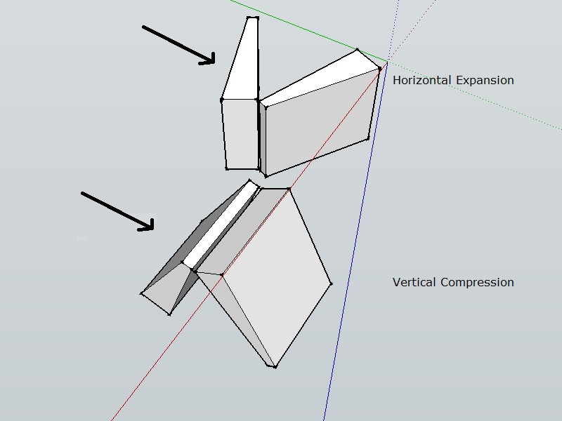

I have read I might be better going with a vertical compress setup if the throw is flexible. Are there any diagrams or details that show the lens orientation? I have searched a lot but can't find any. I'm sure I can work it out but just curious while I am waiting.
Here you go 🙂
attachment.php
I hope this helps. The arrows signify the beam direction from the projector. So if you are familiar with the HE (Horizontal Expansion) design, you then rotate the array 180 degrees which now forms a HC (Horizontal Compression) lens, then stand it upright to make it a VC (Vertical Compression) lens.
You will need a longer TR (Throw Ratio) to make this work and to allow the larger image but you should get significantly better results.
Good luck with that.

Thanks Mark. I'm limited in width for the picture so the VC approach works well for me. It just reduces the height which is fairly flexible with my black magic (Aussie version) painted wall.
I have already played with resolutions and made sure my project will accept the extra wide resolution and still display it full screen in a different aspect ratio rather than letter box on the DESKTOP. Not sure if that makes sense but to sum it up, I can use the full resolution of the projector and have it look stretched on the desktop (and this every program) then use the lenses to bring it back into the extra wide aspect ratio.
I got the trophies and had a quick play with them. Problem is my projector is mounted to the ceiling so its not that easy. I did pull it down and play around at roughly the same throw and got something. It was much easier to test for stretching horizontally due to the prisms being easily rotated on the table. But the VC approach is difficult to stand them up at angles so this was a bit more difficult.
I gave up because I preferred just loosing the resolution to the black bars because the HS approach had too much pin cushioning and chromatic aberration with my limited playing around.
But you have got me tempted again knowing that the VC will yield noticeably better results. The good news is my screen doesn't have borders so pin cushioning isn't as evident as there is no straight edge near by except for maybe the sides (approx 100mm away from edge). But at the same time it doesn't have the edging to hide the edges of the screen..
Thanks for your reply as you have got my temptation going again. It was sort of a waste buying the prisms and not using them until I get the bug to buy a better lens. I feel I might be happier using the VC approach over loosing 1/3rd of my resolution. But the HS approach wasn't so tempting on the rough play around I had.
