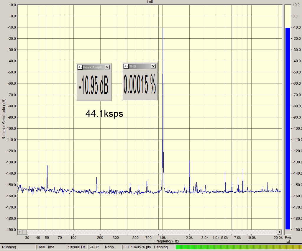

@Demian,
Was that at a particular output level (and frequency)?
I measured the distortion at -10dBFS/1kHz a couple of days ago. I did this for 44.1, 48, 88.2, 96, and 192kHz sample rates using the VP-7722A. The results I saw were almost the same. But the read-out was not totally stable. Most results were at -122dB. 44.1 was -123 on one channel and -121 on the other channel. The best result was seen at 192kHz with -122 and -125dB.

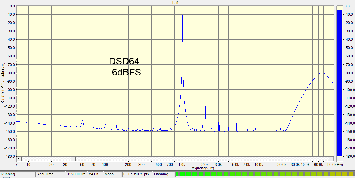

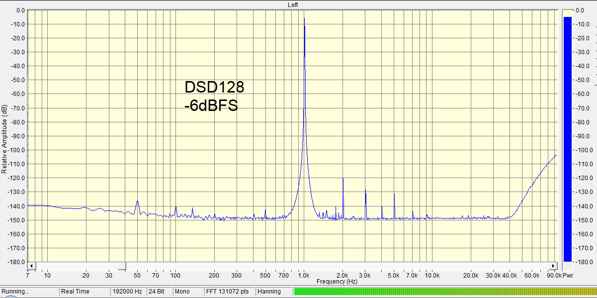

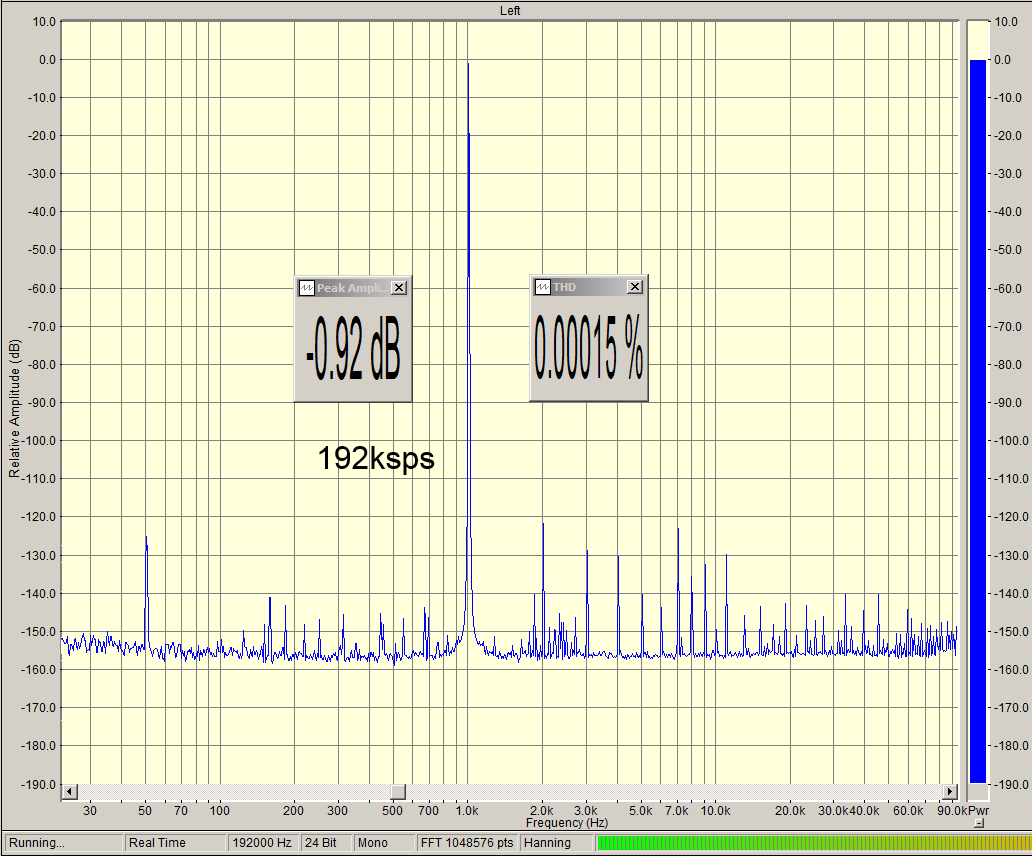

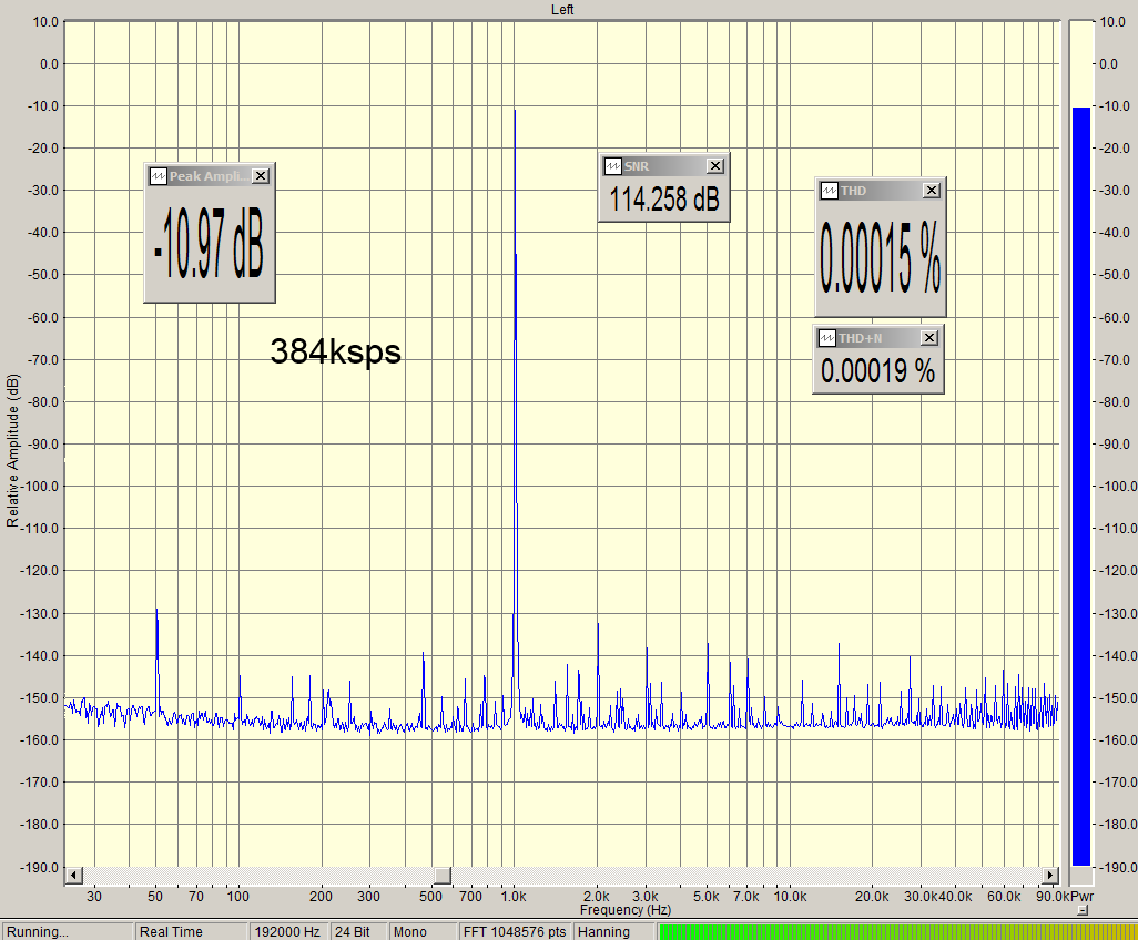

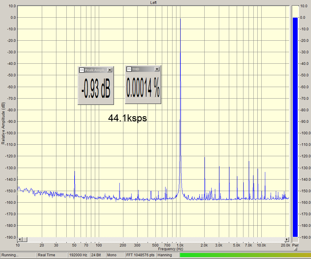

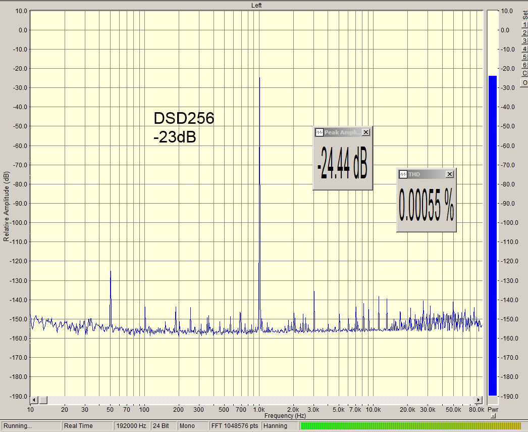

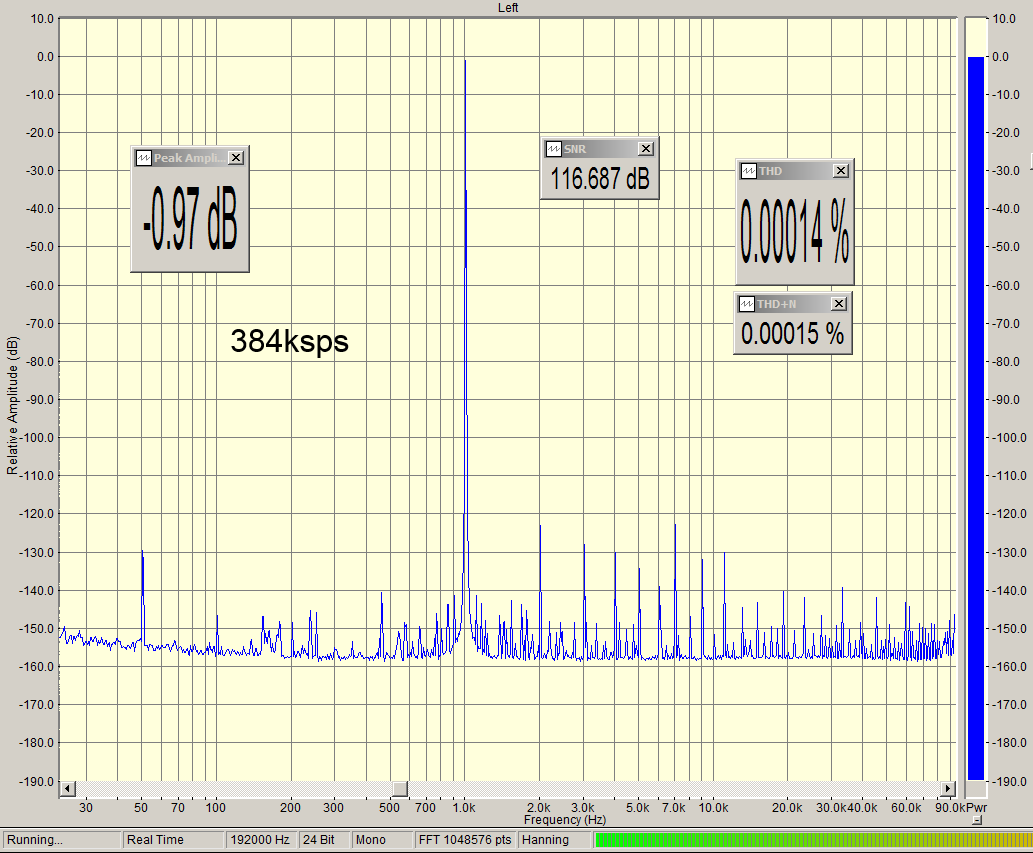

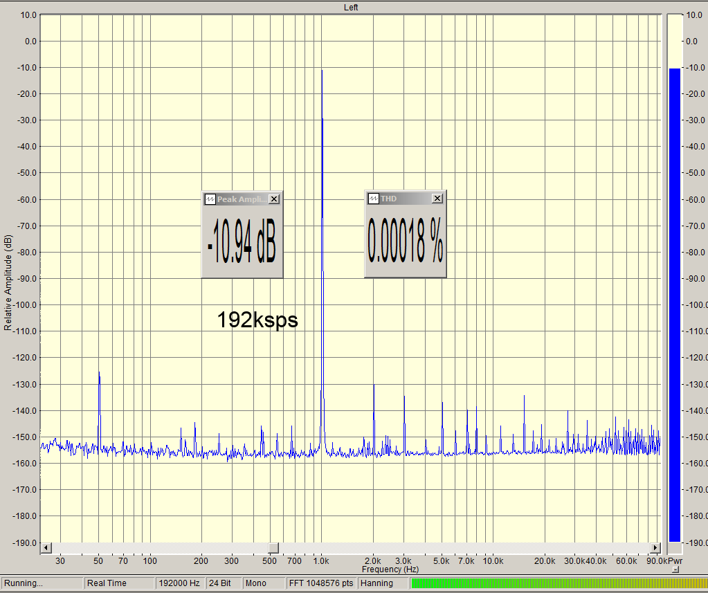

Yes! Exactly!
I have the same experience - the results are not stable, differ from left to right channel and from one pcb to another.
I'm still don't know the reason clearly, but I have seen that THD more depend of a signal level (also duie to ADC) then of the samplerate.
These are the best results I got from my ATDAC-10B (AK4440 based, by the way - the same model 10A, which based on AK4414 in double mono, shows very close results):

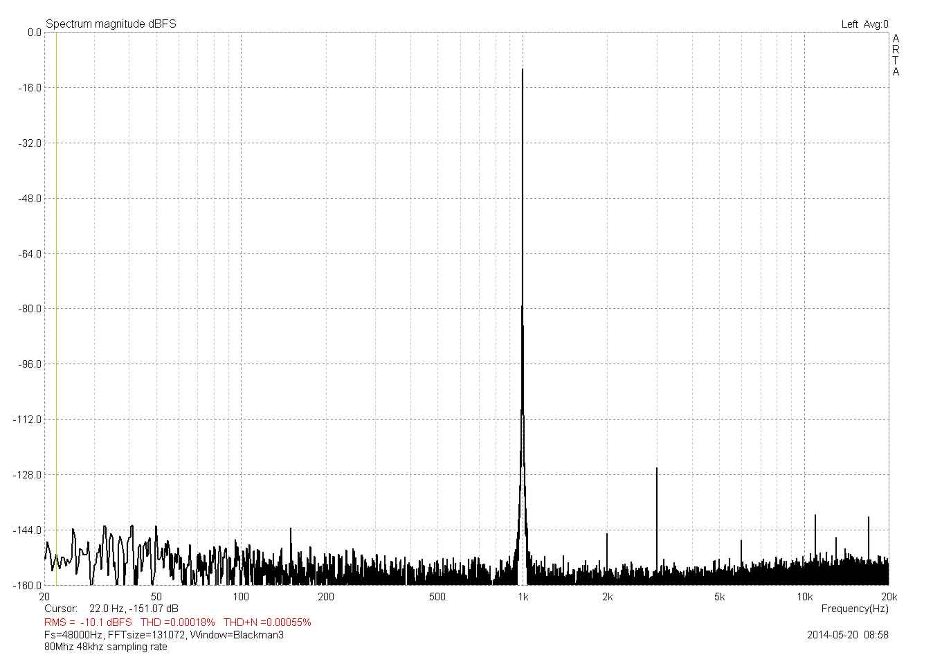

The ESS9112 ADC is not as bad as described here.
The ES9112ADC with OPA1632 input stage and a OPA1641 buffer is direct driven by a ES9018 with a OPA1632 I/V stage without DC blocking capacitors.
If the ADC is synchronized externally over the I2S Clock, then I use a master clock from 60 to 80 Mhz.
The upper limit of the MCLK frequency is about 60MHz. It appears that the digital circuitry can run much faster but the analog portion may have a limitation.
best Thomas
best Thomas
