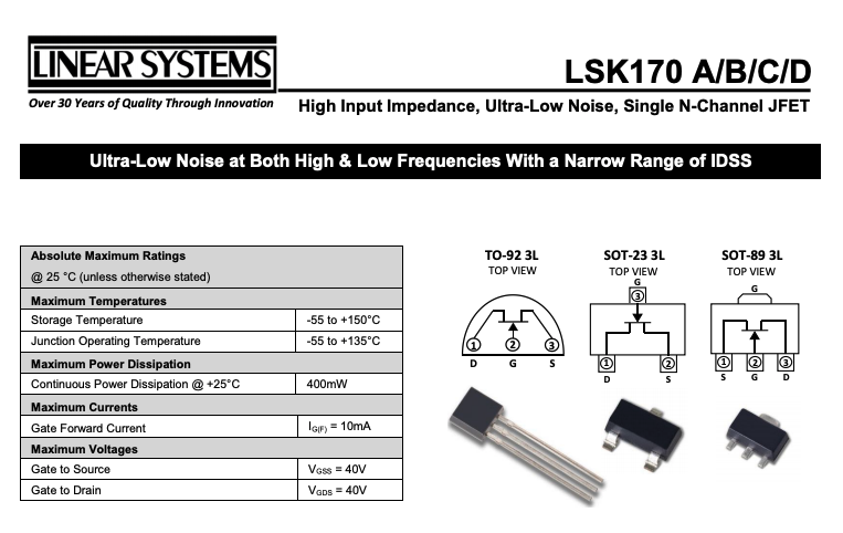

Re: substituting 2SK170 for J113
Please share your wisdom,guys~:D
You could end up with lower distortion and noise by replacing the J113 with 2SK170 (at least on the buffer transistors). Leaving the J113 in for the current sources probably makes sense (per Nelson's article), and would leave some more LSK170s in stock for everyone else in the process! :nod:
Be advised that the pinout will absolutely require some tweaking, as the J113 and 2SK170/LSK170 definitely do have different pin ordering, and you'll need to replace the biasing resistors when you make the swap.
My plan is to build it with the J113 first, and then experiment with replacing the transistors later.
Similar to you, @soleboy, I have a B4 in play currently with a pair of JBL 4344 - fantastic combo! Looking forward to the added possibilities with another active crossover.
