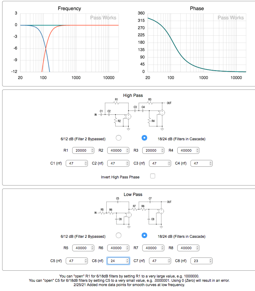

e.g. my slob results

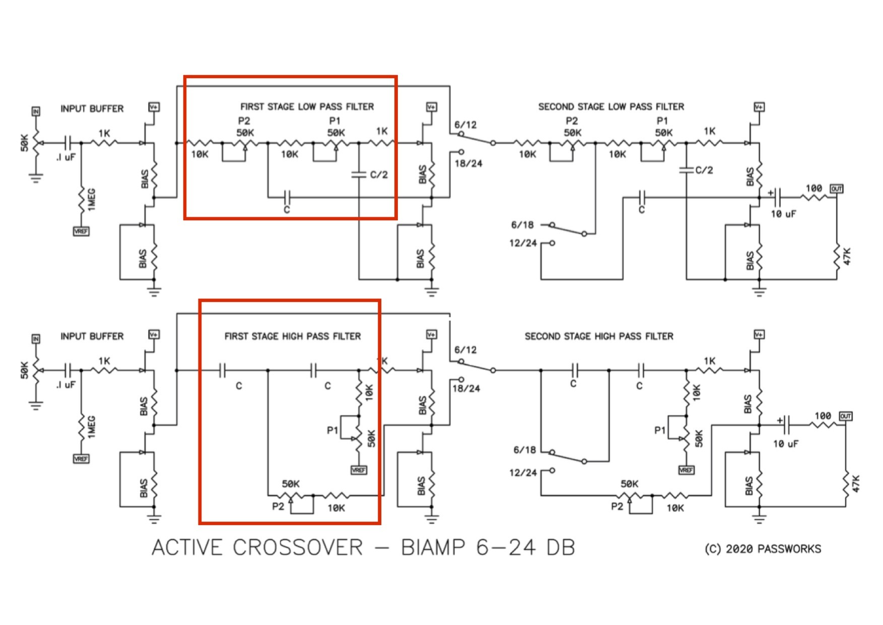

I apologize for my ignorance, but I have no idea what items on the parts list or on the PCB correspond to the values of R 1-8 and C 1-8. Even more so, what P1 & 2 relate to. I assume they are pots and possibly correspond to one or more of the R selections, but I'm really at a loss. Also, in the example you've shown of your results, yours displays schematics for high and low. When I access the app, I do not see that.
I'm trying to learn and appreciate all the help I can get. I just don't have the background to know these things.
R1-8 correspond to the trimmer pots(P1 & P2) in series with the 10k resistors. So 10K + 50k(when the trimpot is fully counter clockwise). C1-8 correspond to the C values in the article except for C6 & C8. Which are C/2.
I had never used that app before so I was confused by the discrepancy between the formulas in Nelson's article and Attila's findings. Playing with the app a little I see that the formulas in Nelson's article expect the trimpots to be at full resistance(and half). With the P1 trimpots fully counter clockwise and P2 trimpots at halfway, the cap values you previously chosen(10nF & 4.7nF) will sum flat at 650hz.

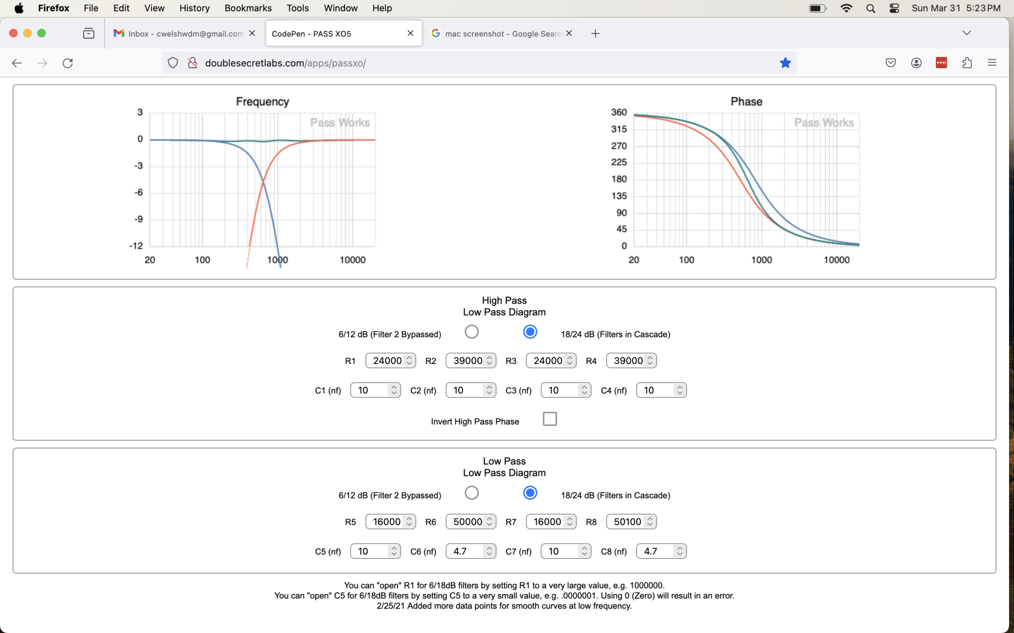

I've been playing with the XO app and have come up with the following. The summed value isn't perfectly flat, but darned close. The high and low values are down 4.5 dB at the crossover. Do I need to be concerned about the Phase traces, though?
I've played with some other settings that pull all of the Phase traces together, but then the crossover point drops to about 550 instead of 650 hz.

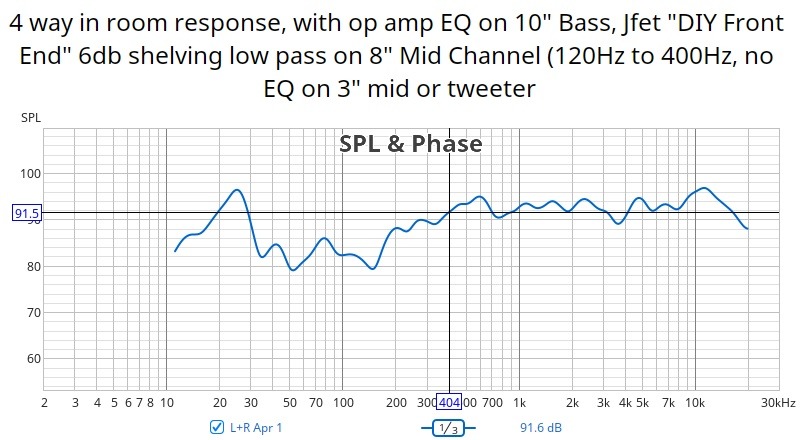

@Davey and anyone interested, following the previous lumpy in room measurements of my daisy chain 4 way system with three DIY biamp boards at 120Hz, 1kHz and 7kHz posted at; https://www.diyaudio.com/community/threads/diy-biamp-6-24-crossover.357657/post-7597572
I have now added a 120Hz to 400Hz 6dB Shelving Low Pass (SLP) EQ section to the 8" channel, using a pair of DIY Front End Jfet boards to the ASP to try to improve the mid bass open baffle frequency response. The non-inverting SLP lower gain is x3.3 (@120Hz) and upper gain is x1.0 (@400Hz) connected between the o/p of the DIY BIAMP 120Hz-1000Hz band pass channel and this channels amplifier input.
I've attached the measured overall in room response below which shows a more well behaved curve (compared to the previous response) and I'm able to play around with the relative levels on each channel to get a better listening balance. I prefer to reduce a bit the lower channel below 120Hz as my garage listening room is not very well behaved in this region. The SLP addition gives better mid bass crossover between 10" woofer and 8" mid bass while noticeably improving the perceived overall tonality (slightly warmer). I haven't yet done outside measurements and individual measurements of the 8" channel with SLP EQ which is next up when the weather allows.
I'm thinking of a future experiment to change the 3" seas for a 5" driver so I could rearrange crossover points to approx say; 90Hz, 400Hz & 3kHz in order to play around with Thorsten Loeschs' tips on Blauert band EQ target curves from a good few years back.
Any suggestions and comments welcome.

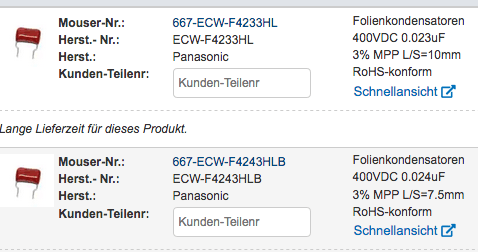

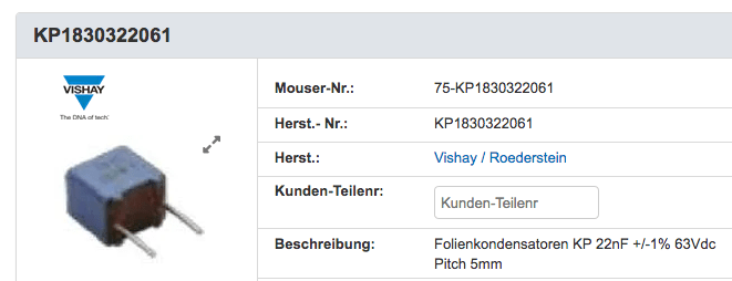

I like your values here. Question: Where did you source 24nf and 23nf film capacitors?
Thanks very much,
Jim
Hey Jim,
I used the Roederstein type, but there are also the slightly bigger types from Panasonic though you would have to bend the leads.

Pleased to report Attila's values from post #1504 above worked for me. Running Altec 420a high/mid, on top of the speaker camp SLOB bottom Eminence Beta 15. SissySit above ~100Hz, M2X below. I was careful to set the pots w/ DMM per the simulator. Having an early listen it's certainly no worse than the stock speaker camp MiniLx active analog crossover.
