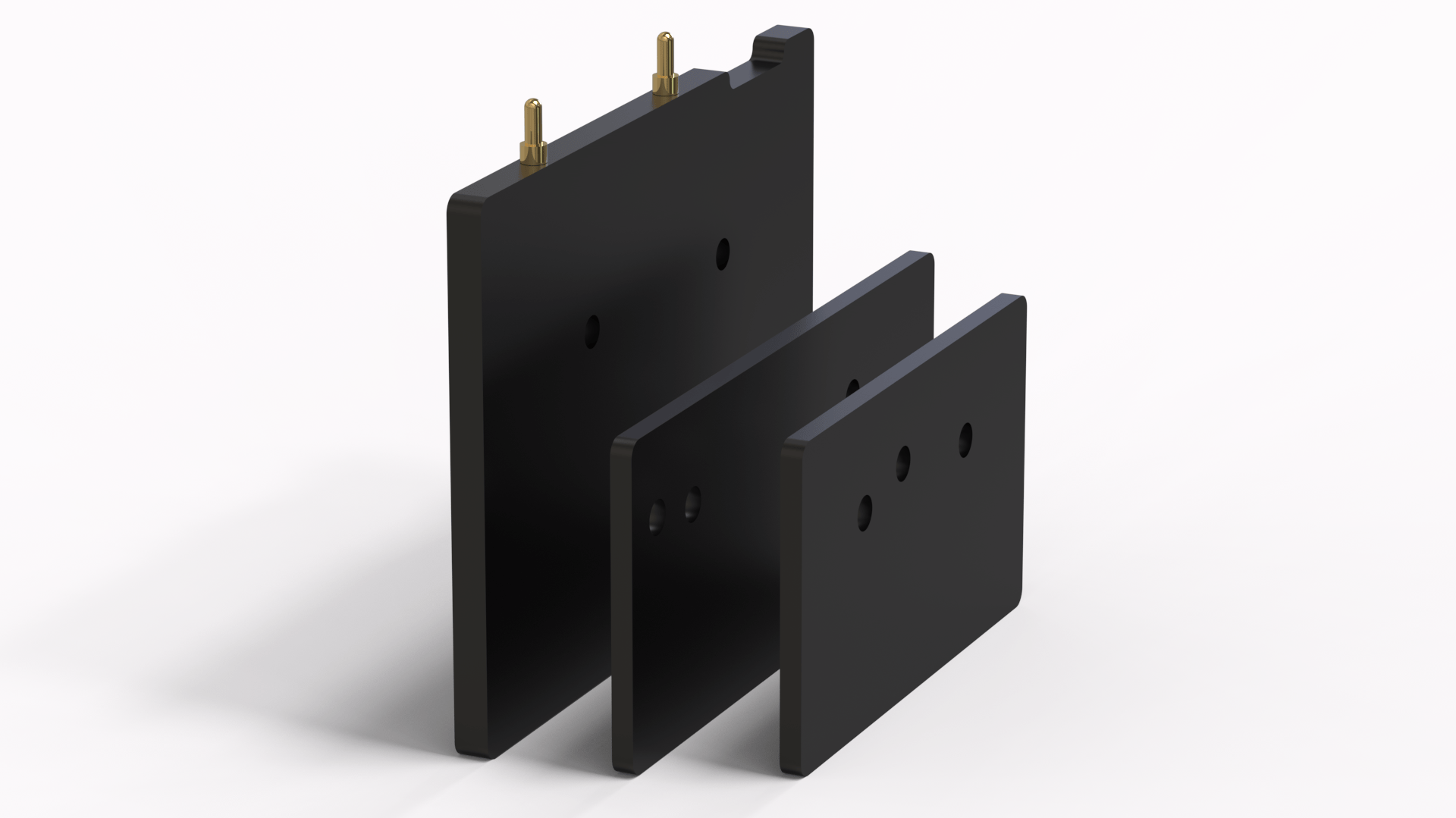

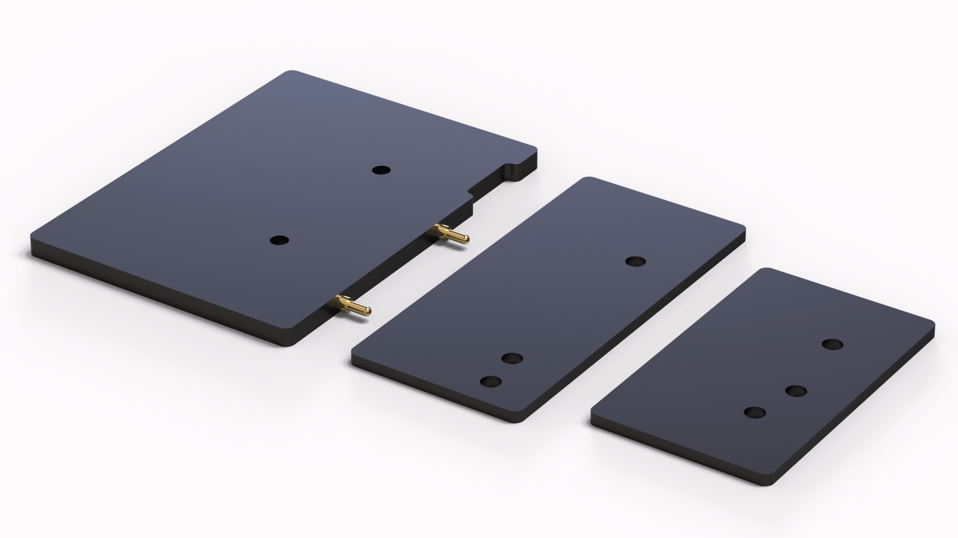

Just an update on the GB1/GB2 heatsink prices from my earlier post, I cannot edit it. Thanks!
EF3-3 - Includes Driver, Predriver, and CCS/VAS Heatsinks - $55 USD
EF3-4 - Includes Predriver and CCS/VAS Heatsinks - $40 USD

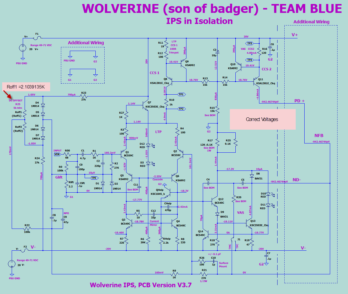

Wonder if anyone could offer a little help with an IPS board build. Seems like I have V+ on the test PD+ <> ND- <> NFB shunt. It is supposed to be zero.
Applied the parallel resistor at R17 and made the G1 <> G2 <> G power supply shunts. When I apply +/- 20V, all 4 LEDs light and no magic smoke appears There is, however ~+20 V on all three leads of Q11. I think the collector of V11 should have ~+2 volts.
Took out the PD+ <> ND- <> NFB test shunt and checked the outputs:
PD+ +20V
ND- -0.11V
NFB: +0.4
I removed Q11 and checked the empty traces for shorts to V+ but there did not seem to be any.
I replaced Q11 and again there was +20V on all three leads.
It seems like something is dumping V+ onto the PD+ line. Q11 is suspicious but it seems to be working and there were no direct shorts between V+ and PD+.
If anyone has any ideas what might be causing this, I sure would appreciate your wisdom!!!
Jon

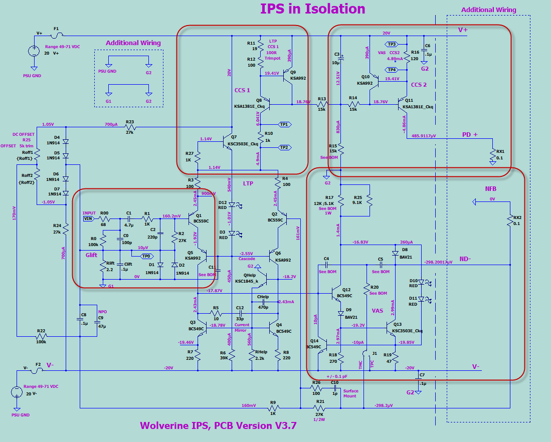

Hi Jon,
Based on your numbers and your brief description I don't think Q11 is the issue.
I am going to post an image below of what the voltages should be with 20v rails.
Please do not try to run the IPS or amplifier without the NFB trace connected. Bad things could happen.
Are you trying to adjust R25 to achieve 0v at the NFB Node?
The trimpot R25 (DC offset) should be around 2.1K from pin 3 - 2.
The trimpot R11 (LTP Bias) should be around 19R from pin 2 - 1. Are you getting 5V from TP1 to TP2 ?
Just to clarify something you said "The collector of Q11 should have ~0 volts." not +~2 volts.
The next image is something you can try if you get really stuck to try and help and determine which section of the circuit is at fault.
Add RX1 & RX2. Make the connections as shown in the additional wiring box.
Use a low value resistor for RX1 ~0.1 ohms & RX2 ~0.1 ohms. Make sure you have your current limit set as per the build guide.
Turn on and record the Voltages at Q11c and Q13c and report back.
If Q11c is close to 0V then you know Q11 is not the problem and the problem could be somewhere in the rectangle surrounding Q13
If Q13c is close to 0V then you know Q13 is not the problem and the problem could be somewhere in the rectangle surrounding Q11
If Q13c and Q11c are close to 0V then you should not have a problem.
At the end of the day the voltage at the base of Q1 should be extremely close to the voltage at the base of Q2.
Good luck.
  • Thank You
Reactions: lotharx
Another thing to check and report is your rail voltage. With your power supply current limit set to 50mA. If your power supply rails drop below there initial value then your power supply is probably going into current limiting mode. This would indicate that you have either a short somewhere or you have a component installed incorrectly (wrong value or orientation).
