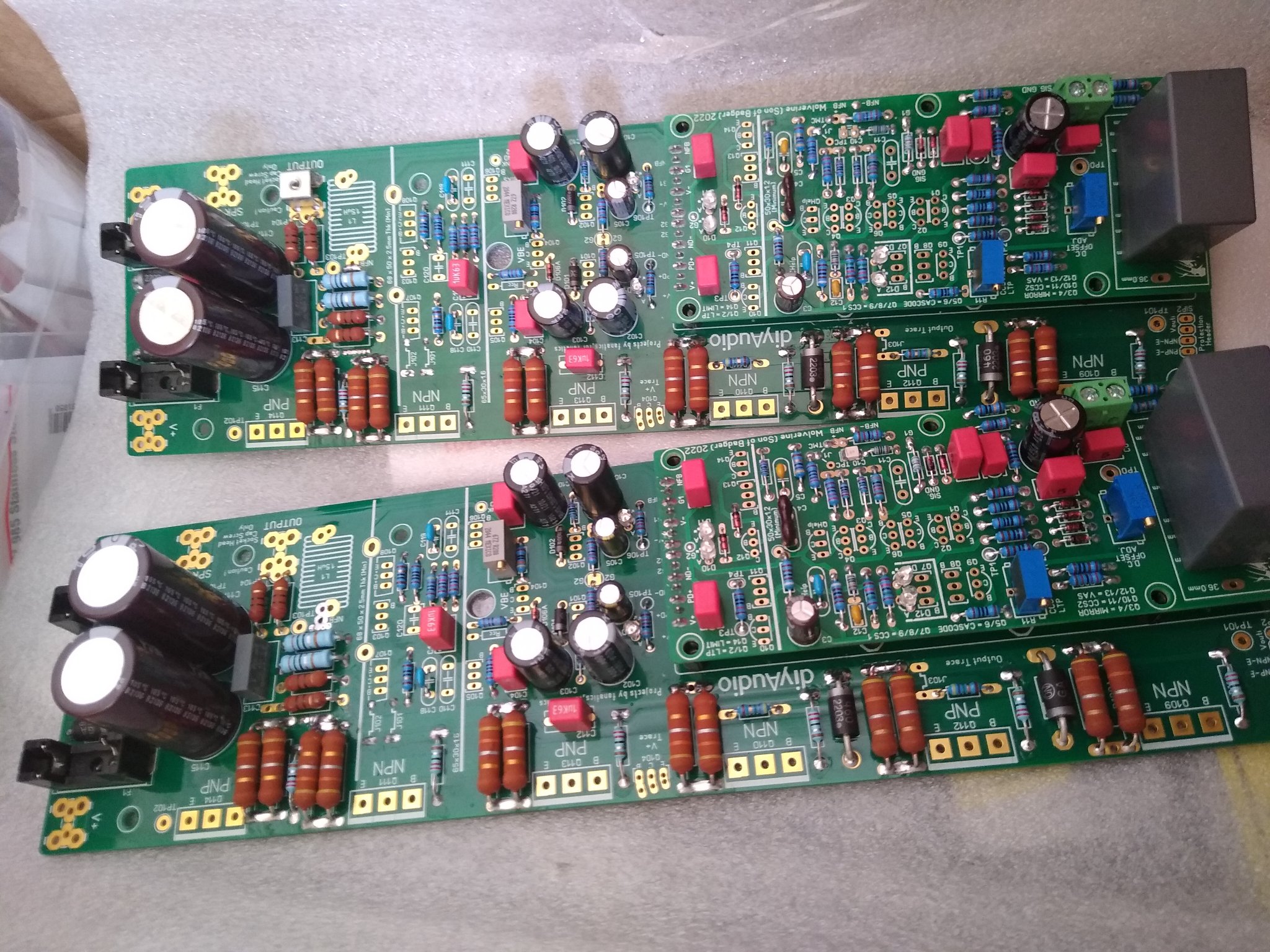

Nice work!Made some progress, again not done the transistors yet. Boards still need cleaning too. View attachment 1055032

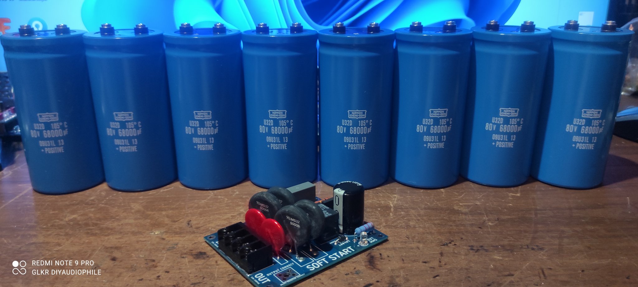

Hi Gareth & Other DIY Members building the Wolvering on the EF3-4 BoardsMy progress so far.
My caps have arrived for the build, and I've built my soft start unit.

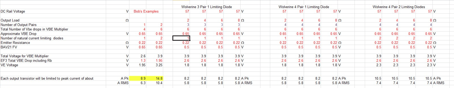

Just a quick note. I don't want to cause any confusion but it is highly unlikely that you will need D105B & D106B.
Please see the build guide or my image below for the requirements.
Basically if you not running a 2 ohm load or you only install 2 output transistors you won't need these.
For more information please refer to Bob Cordell's book Page 326 of the 1st edition or Page 432 of the 2nd edition.

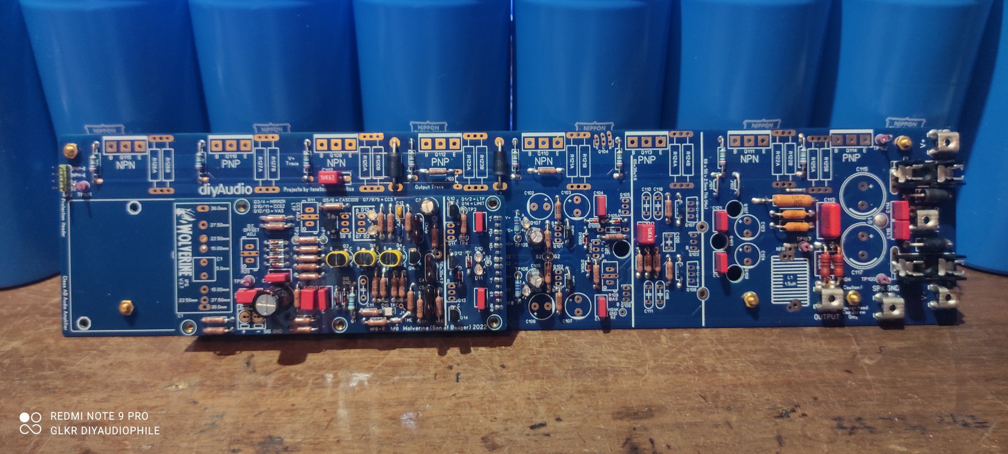

Just a small note. @danieljw did a great job on the video but to avoid any confusion between the BOM and the video I just need to make a small comment.New video is up:
Enjoy
- Dan
It is not necessary to match Q103 & Q104 for the selection of the RCC resistor.
RCC really only affects the current supplied to Q104 and how rapidly Q104 reacts to temperature change.
So the HFE of Q104 is the only thing that needs measuring when selection the RCC resistor.
Keep up the Awesome work on the Videos @danieljw they are just what we need.
