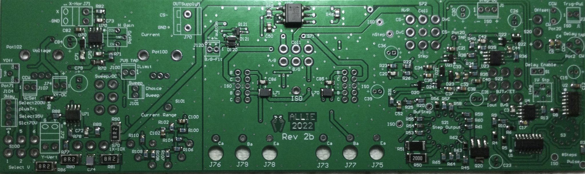

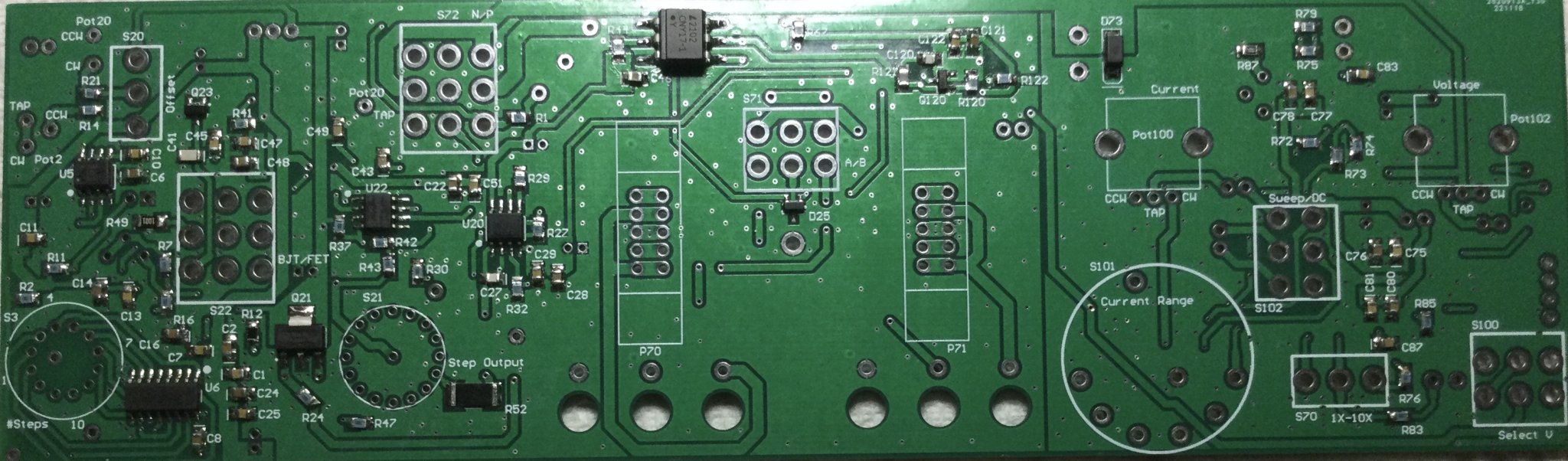

I have a set of 5 ordered from JLPCB (China). I managed to source all parts but one resistor, RMCP2512FT4R02, Stackpole, 4.02R 2W, 1%, 2512. I ordered 50x 8.2R 1W and will stack them…
I do not have equipment to automate smd soldering. Since there are parts on both side of the PCBs I will handsolder them. I guess it’s about 300 smd parts which will take me a month, lol

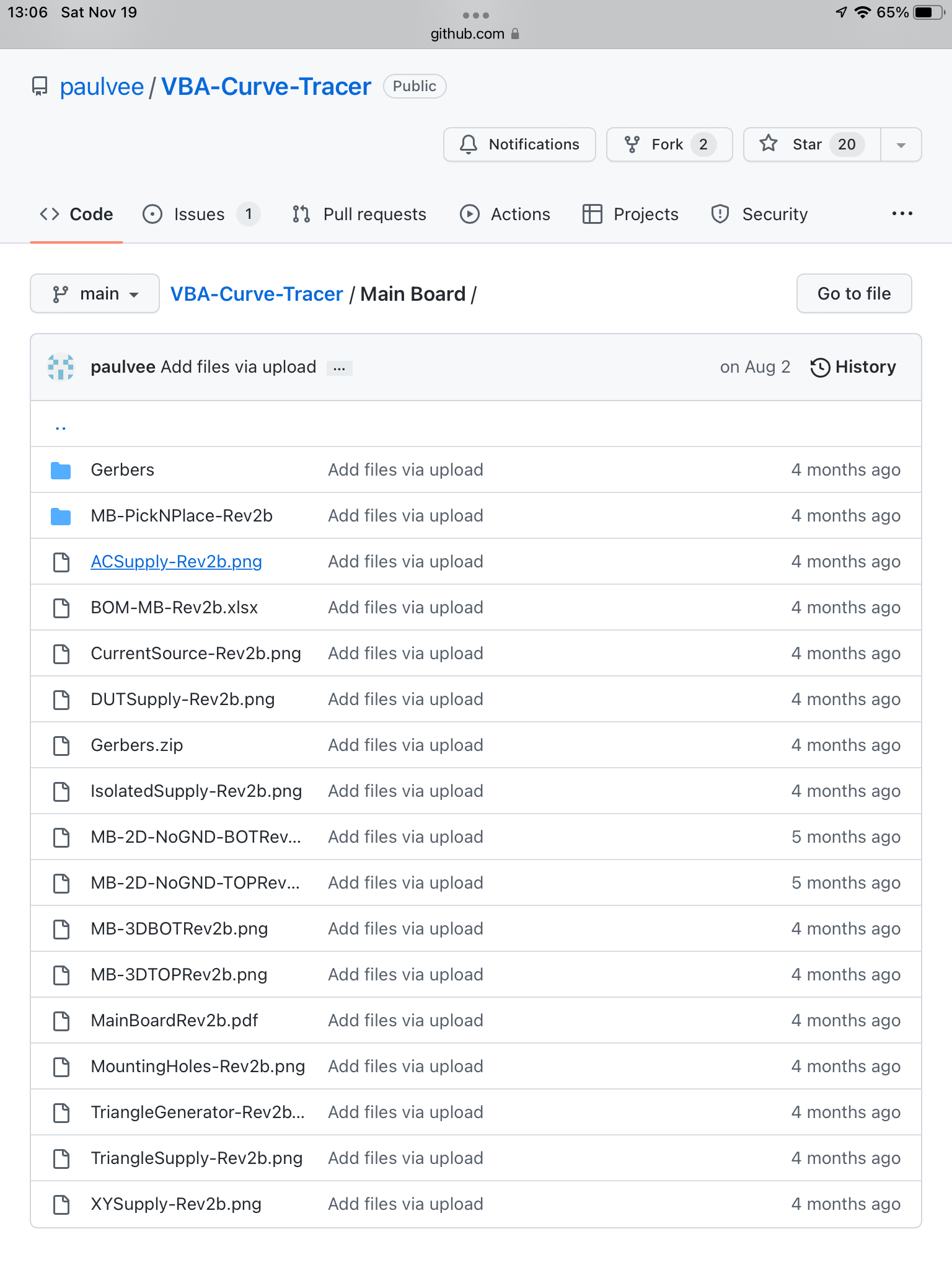

They have a pick-and-place file included in the GIT download, but who produces a 1X batch for a decent price?
From what I saw smallest is 0805 which is not to bad.

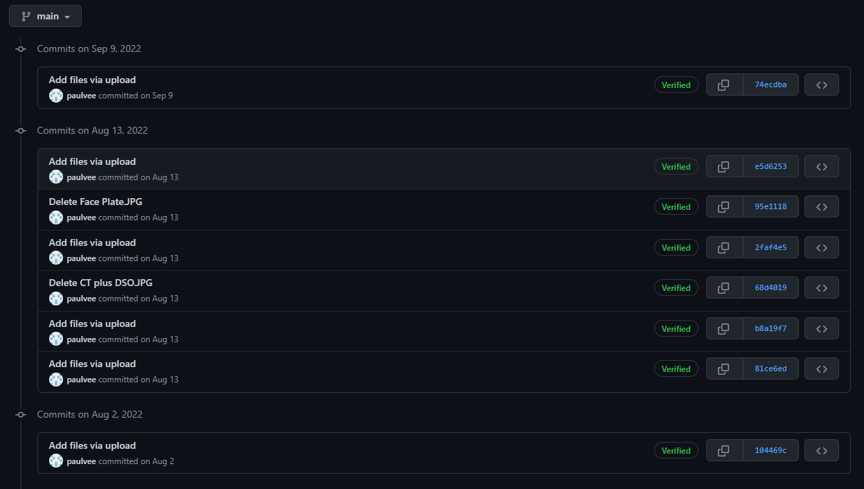

https://www.paulvdiyblogs.net/2022/06/the-vba-curve-tracer.html
Blogpost:
https://github.com/paulvee/VBA-Curve-Tracer
Just clone it and you have everything uptodate. Very good documentation, so far…

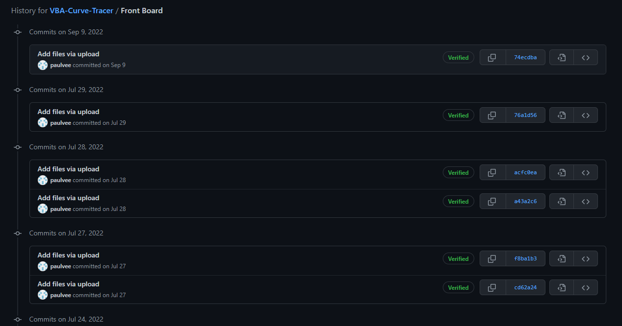

I posted the same comment two weeks ago and did not receive a reply.
The picture above from the post 11/4 shows the Special 10 boards BOM, but i can’t find them in the GIT repository. So I suspect they are not set public.
P.s. if you order PCBs from JLPCB you can add stencils to your order which would make it much easier to solder them with a hot air gun by hand. Actually not too bad but tedious.
You get 90% of the parts from Mouser, a few more from DigiKey and pretty much of the rest from Aliexpress. The one Part not obtainable anywhere is the 4.02R 2W resistor. You can make this one up by ordering 50x 8.2R 1W and stack two properly matched ones on top of each other. Easy with SMD.

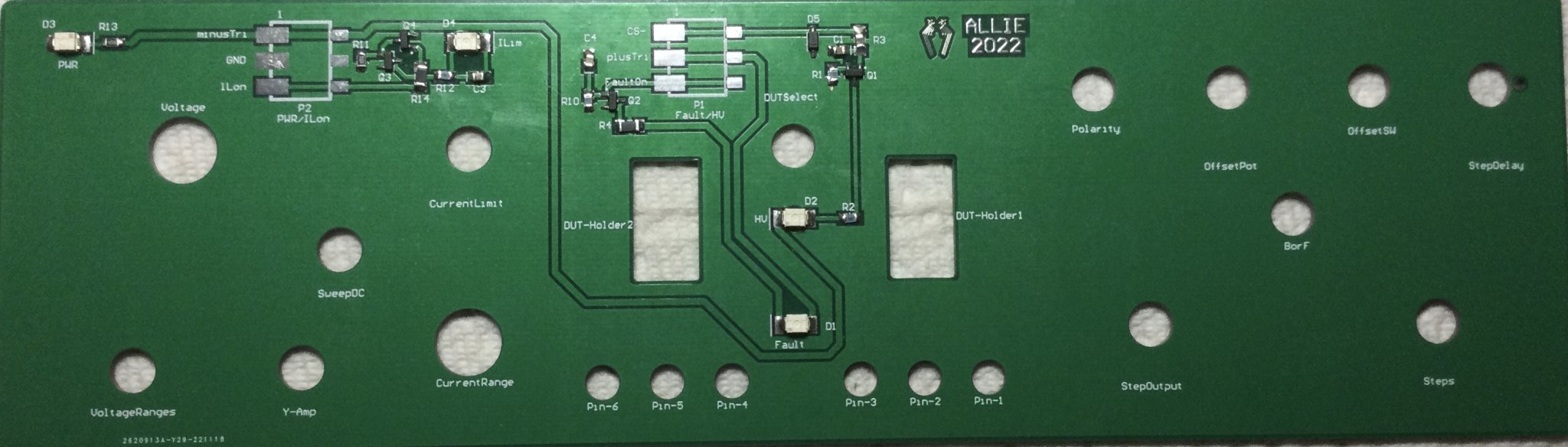

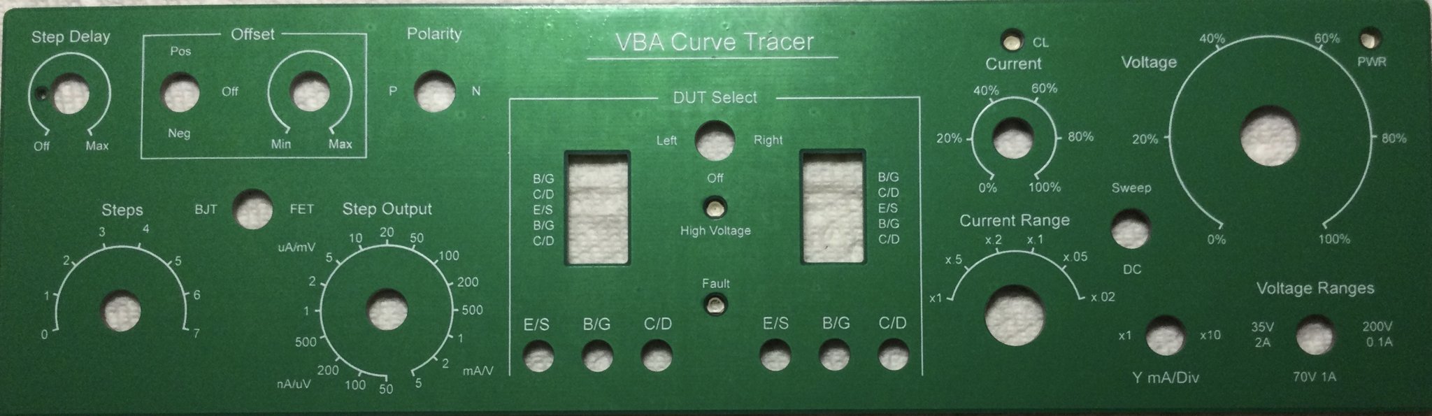

Frontpanel and Frontboard SMD parts soldered. All parts checked for values and/or shortages. All ok. Next step: Through Holes Parts and ‚sandwiching‘ them together. After that I’ll start with the Mainboard. I obtained all parts from Mouser, Digi-Key and some passive parts from Ali. Spent about $700 CAD on parts and $30 on the PCBs from JLCPCB. All soldered by hand, about two days (I have time, I am retired :). The 4R and 2R 2W resistors are unobtainable. So, for the 4R I stacked two 8R2 (5%, selected low value, ~8R) on top of each other. I arrived at perfect 1R (8x).
