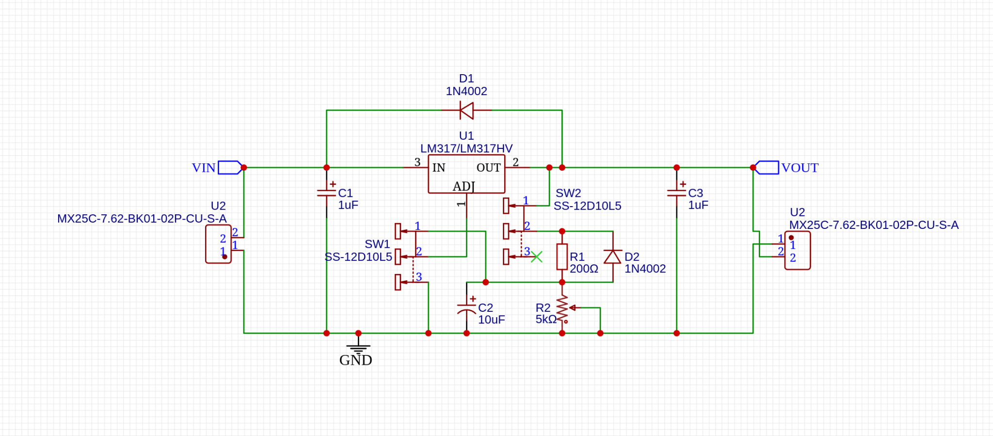

i made quick draft for a universal LM317 board...
the sparkos discrete voltage regulators need actually some modifcation to the LM317 circuit, thats what the 2 switches do, since the ADJ pin becomes GND on the sparkos, this might be also a better approach if i wanna do my own regulators
1uF kemet tantalum Cin and Cout caps, kind of universally, tho im still thinking about adding a spot for a larger electrolytic cap, but i read LM317 dont like to large output capacitance so im kinda unsure.. tho i would rather optimize towards better/newer design than LM317...
i could probably leave SW2 out but i rather disconnect it completely if i can..

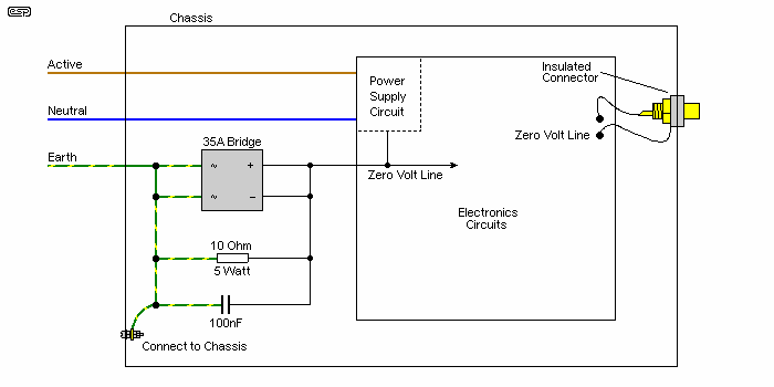

how do you execute the grounding scheme? for true isolation the pcbs need to have a floating ground and not connected to chassi, right?
AC line ground must be connected to the chassis. Circuit ground is connected to AC line ground through a hum-breaker circuit, more or less like this (resistor value may sometimes be up to 100R):
For any commercial chassis in your system not made that way, and or for additional minimization of AC power ground loop problems, a used "Monster HTPS 7000 MkII Signature Edition" power conditioner is very good. It was designed for Monster by our own Richard Marsh, and Demian Martin ( @1audio ). They typically go for around $500 on ebay when available. The earlier HTPS 7000 versions are also very effective, but the recommended one is best (and has three GFI duplex AC outlets on the back, for the three transformer balanced circuits).
