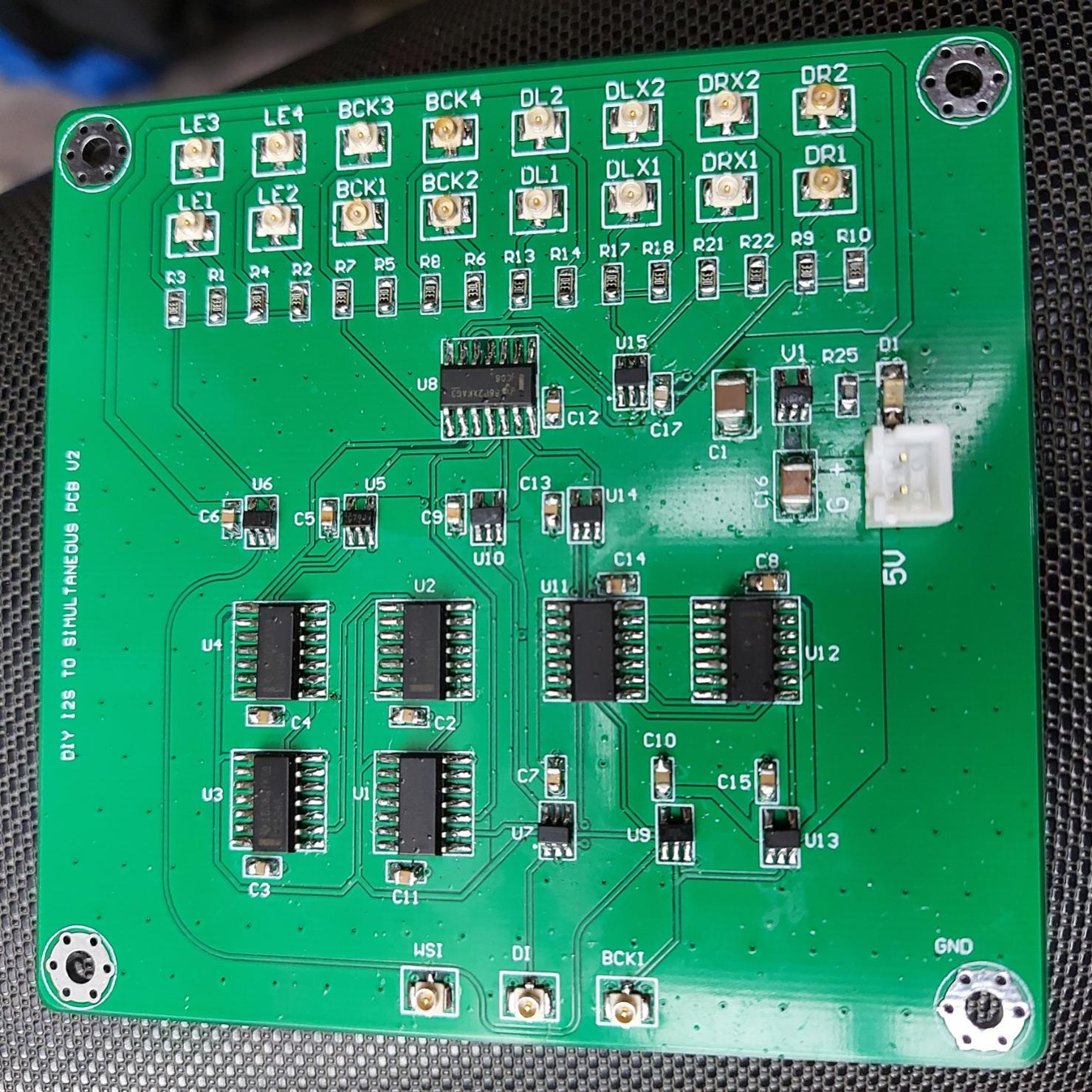

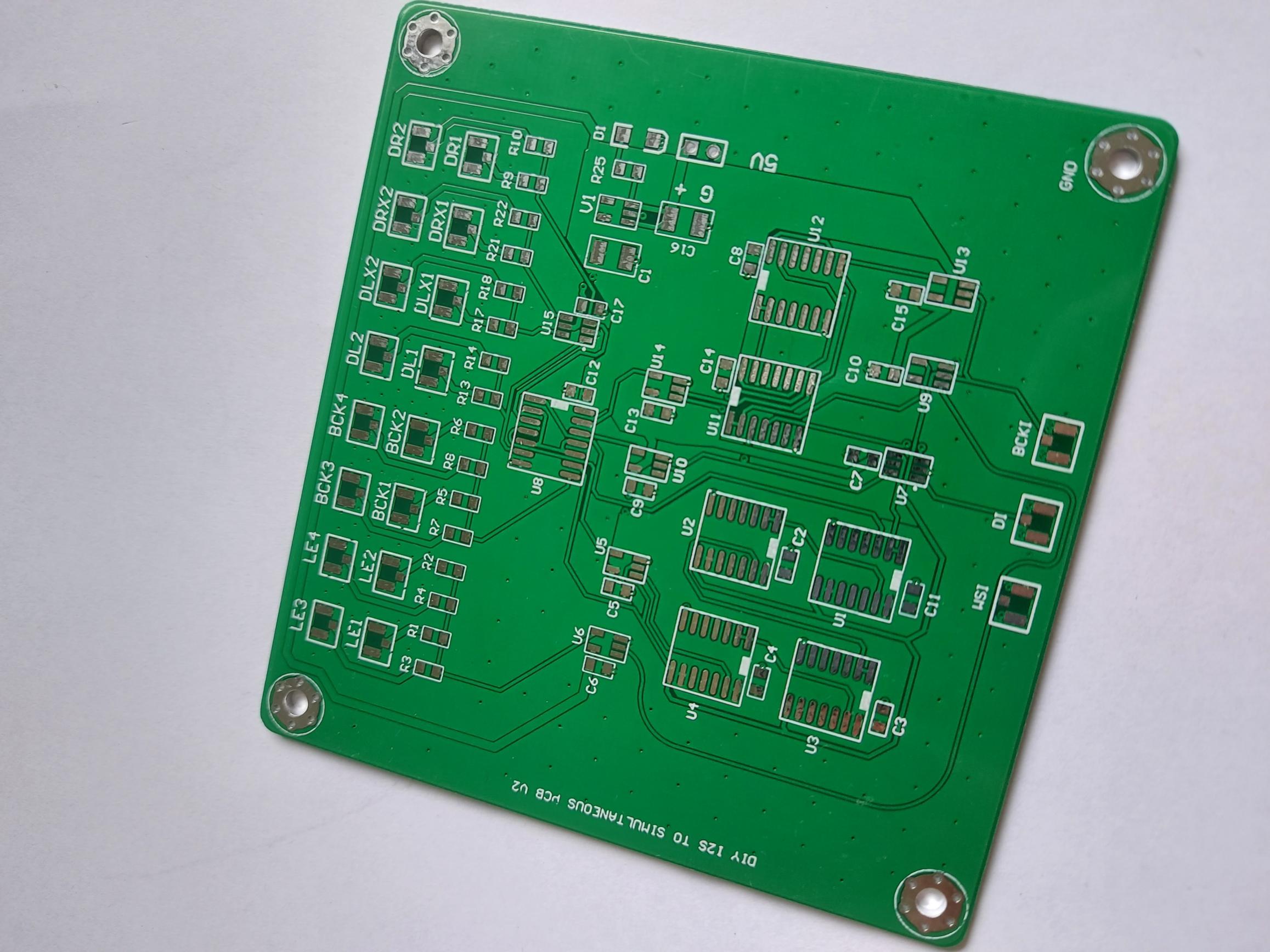

i2s2sim V2 pcb
The V2 PCB is now avaliable.
This version has inverted data outputs to enable balanced operation.
V2 order form
Schematics
BOM

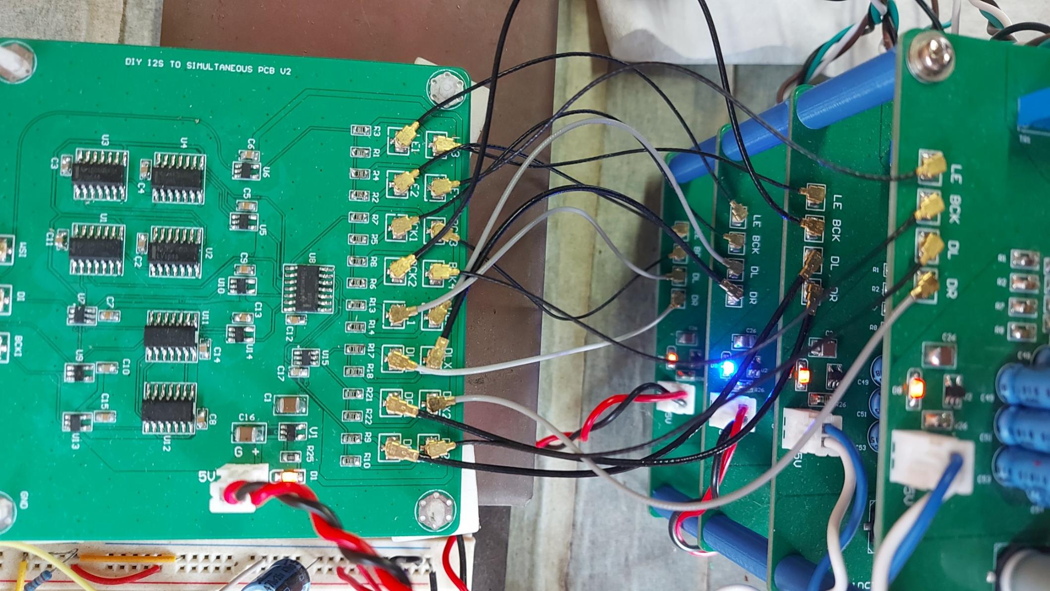

Sorry for my slow response, been busy playing with my transformer from Ivan (bisesik) - its a 1+1:37+37.
The power needed for the I2S 2 SIM PCB is 5V and 25mA - for pre-regulation im using an LM317 because that's what I had on hand, but you could use any 5V reg. Before the reg im using ECdesigns "charge transfer" circuit - which is still on a breadboard.
I attached a few pics, as you can see there are a lot of ufl cables of all different lengths - just ones I had on hand, but I did make sure that the cables I used for all the LE inputs were the same length to make sure the triggering of the sample happens at the same for all the 1541a chips.
All the best with your build Mark.

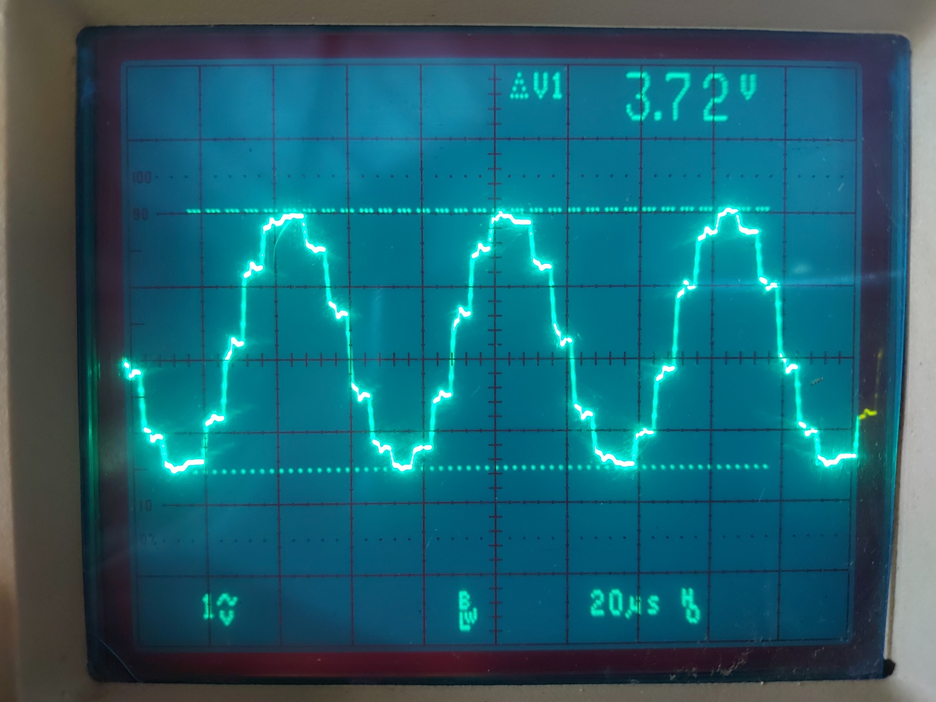

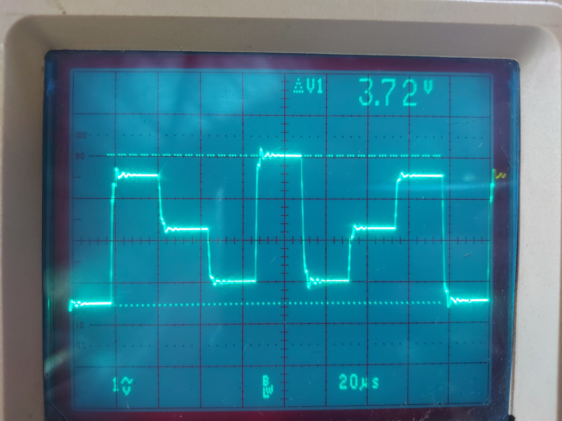

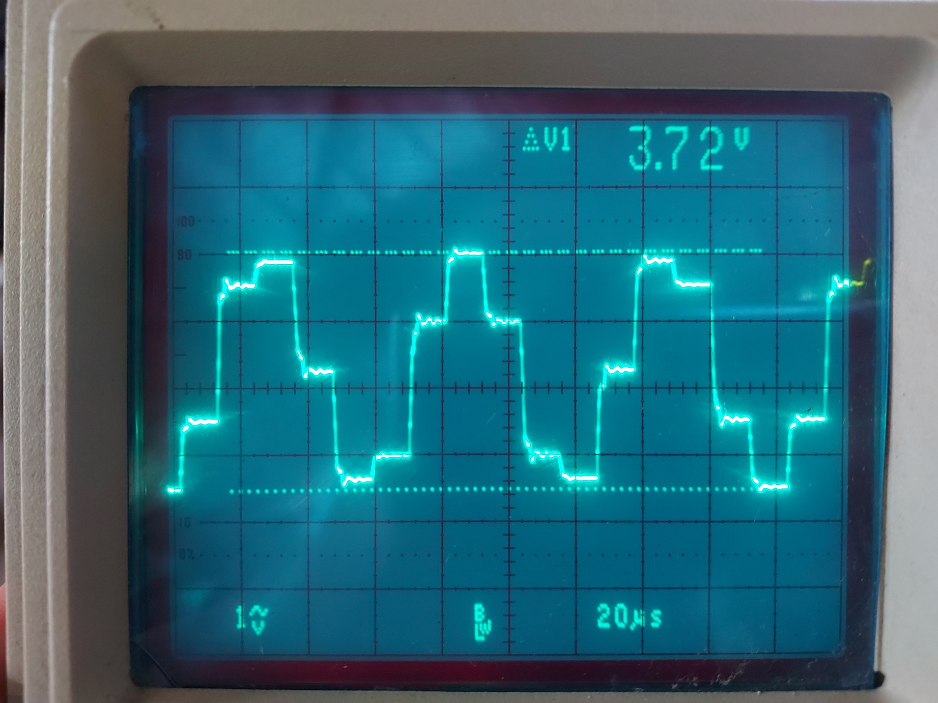

sampling rate test
Hi Guys,
A few of you asked what sampling rate I have tested up to... So I bypassed my FIFO with the 11meg clock, and directly connected a WaveIO to the I2StoSIM PCB with a 22meg clock to achieve 176k sampling rate, Im sure it would go higher but im limited to the clocks I have. If anyone can test higher rates please let us know.
1st pic: 16ksine@44k
2nd pic: 16ksine@88k
3rd pic: 16ksine@176k
