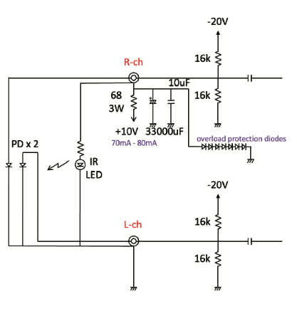

DS audio is actually +10V with the protection diodes to prevent overload damage to PD.
With cartridge connected, it drops to 4.6-4.8V.

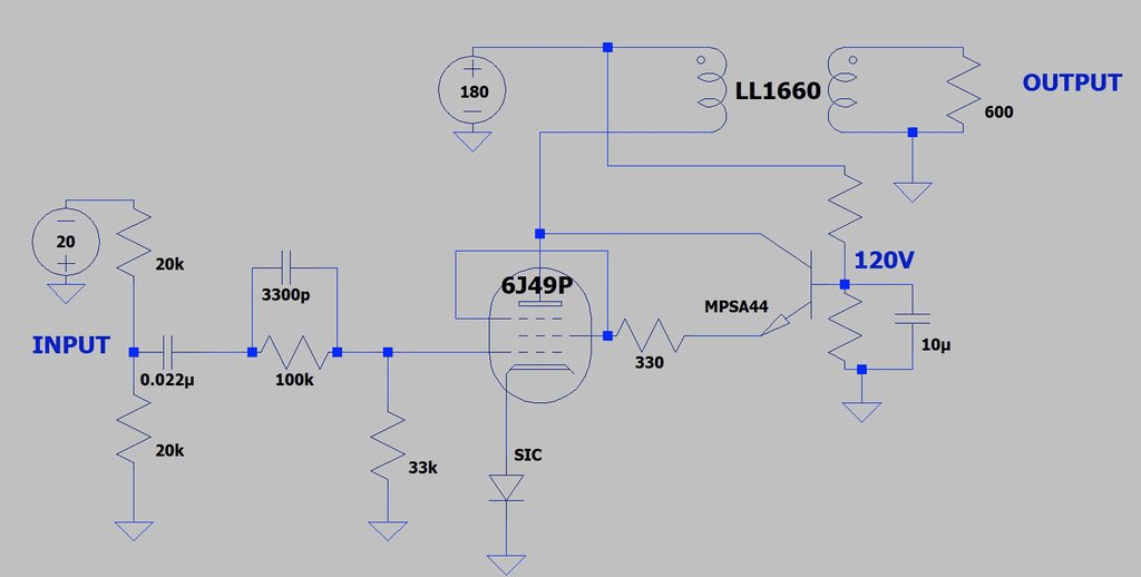

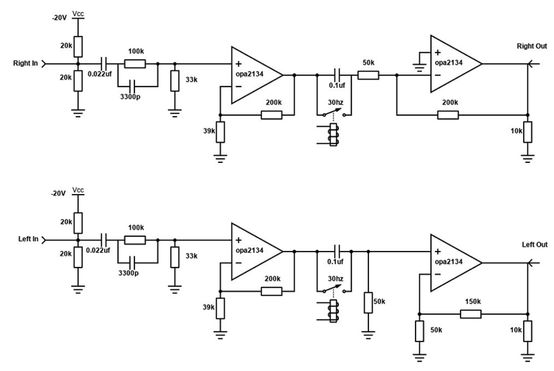

I've made an opamp version (gain 24) with 30+50hz filter, and a tube version with embedded 50hz filter.
Tube diagram is for right channel, left channel just to flip the transformer pin for non-inverted output.

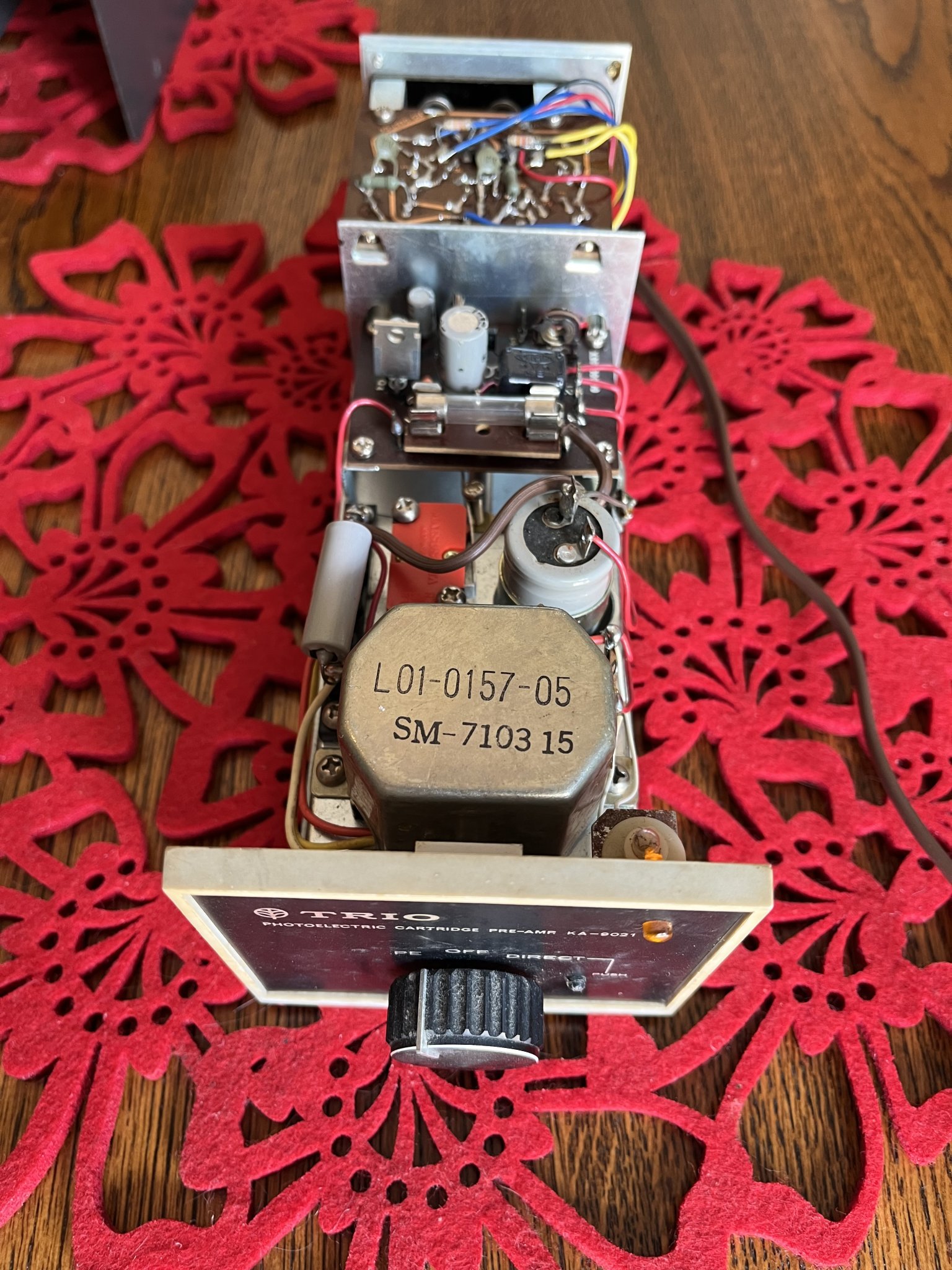

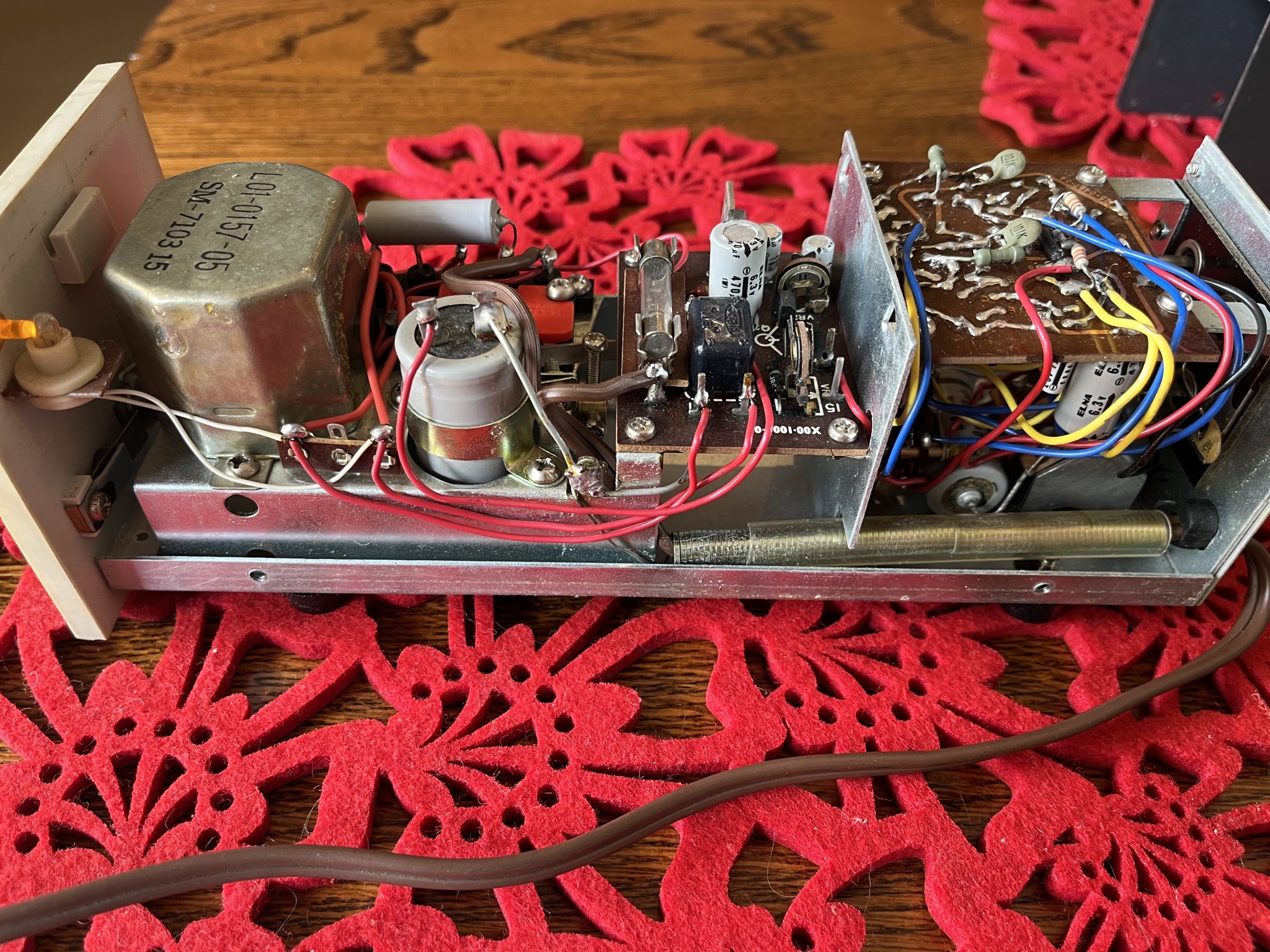

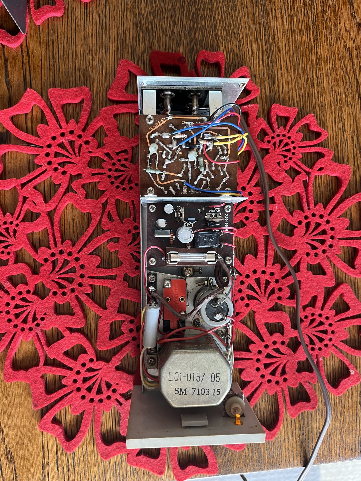

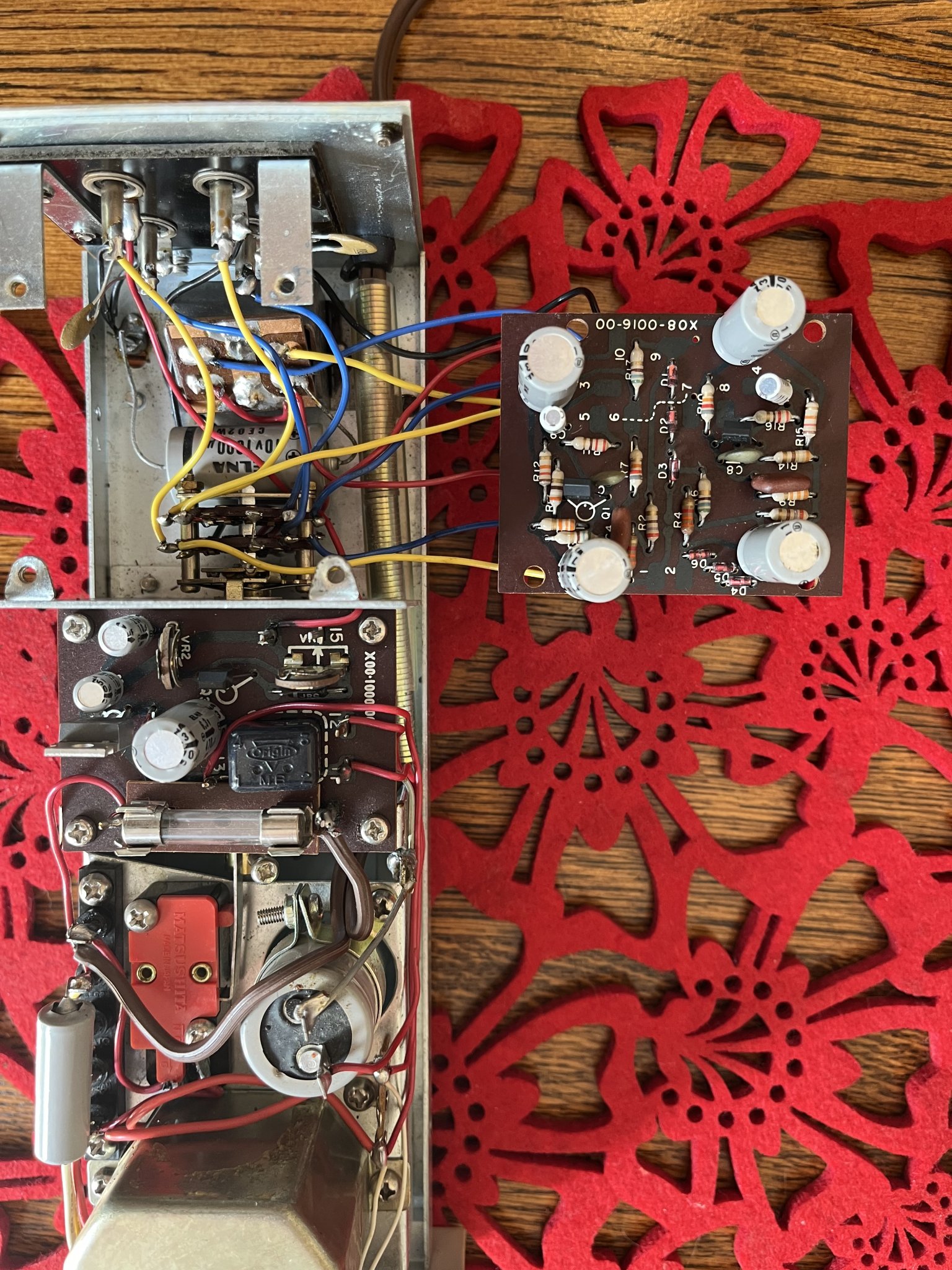

Initial measurements:
KA-9021 lamp voltage supply is 5.6VDC and the amplifier circuit is 4.3VDC.
Thank you very much for the pictures and the initial voltage measurements - much appreciated.
Is the lamp voltage supply meant as the voltage supply to the optoelectric KE-9021cartridge lamp - or lamp for the preamp pilot light ? Has been the cartridge connected to the preamp while making these voltage measurements ?
Reactions: 1 user
Yes the 5.6VDC lamp voltage supply is for the KE-9021 cartridge lamp in the cartridge. I haven't traced the circuit for the pilot light on the preamp, but it may be 100V AC. On my preamp the bulb appears to be open circuit.
I did not measure the pilot light voltage, it works without it...
The cartridge was connected when making voltage measurements. I will post further findings when I get time.
I found a cold solder joint which may be the cause of the hum in the left channel. Next I will power the circuit from a 6VDC battery with a dropper diode and measure current.

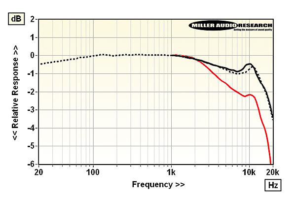

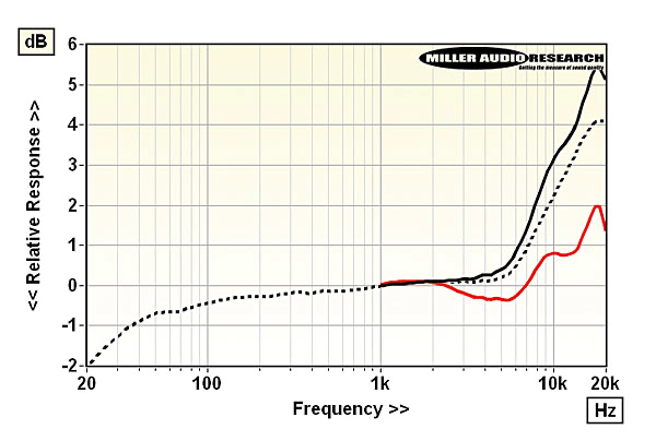

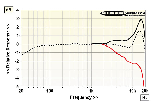

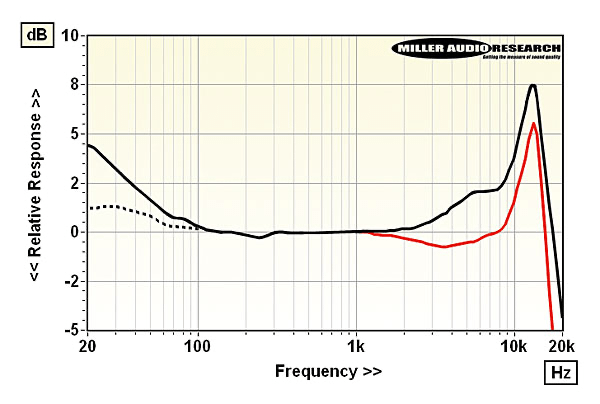

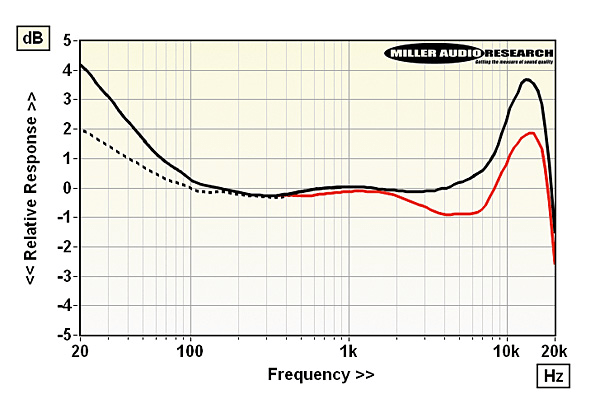

Has anyone achieved a flat frequency response with any combination of (DS Audio) cartridge and equalizer that you know of ?
There are test records with frequency sweeps you can use measure your setup. Measured FR may also depend on things like arm and head shell resonances. Its best to go after any resonances first since they can't fully be corrected by EQ. It takes time for a resonance to store up energy and time to release it.
