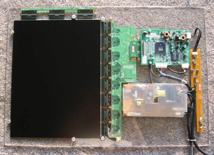

Hi, I have a question. A while ago I did a projector setup with a larger 15" panel and had issues with the circuit boards that were connected directly to the lcd panel. They were difficult to move out of the way. Do the newer smaller lcd panels that you use have this issue too? Are the boards attached the same way? Looking at your photos of the inside of your projectors it doesn't look like you have any trouble with the boards. I've been wanting to built a new projector for a while and I am almost to the point of ordering parts, but I'd hate to buy an lcd panel that had circuit boards I couldn't fold out of the way (hard to know without taking it apart.) Thanks in advance for your time and advice and the incredible resource of information you've provided on this site!
My last lcd had two boards attached to the panel like the panel in the picture. There was also a ribbon cable that connected them, which was also difficult to deal with.
