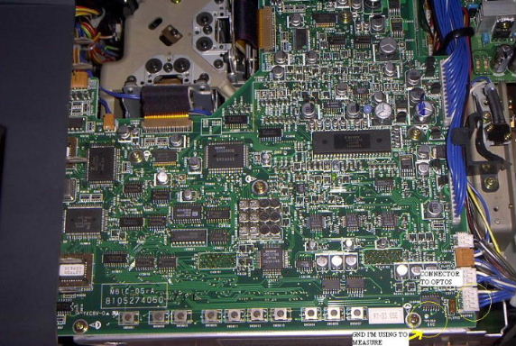

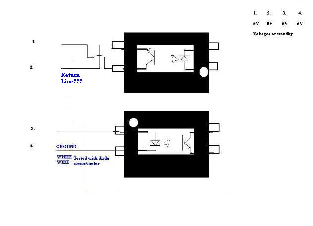

I've followed this thread to the extent of my posibilities. I could use some help now.

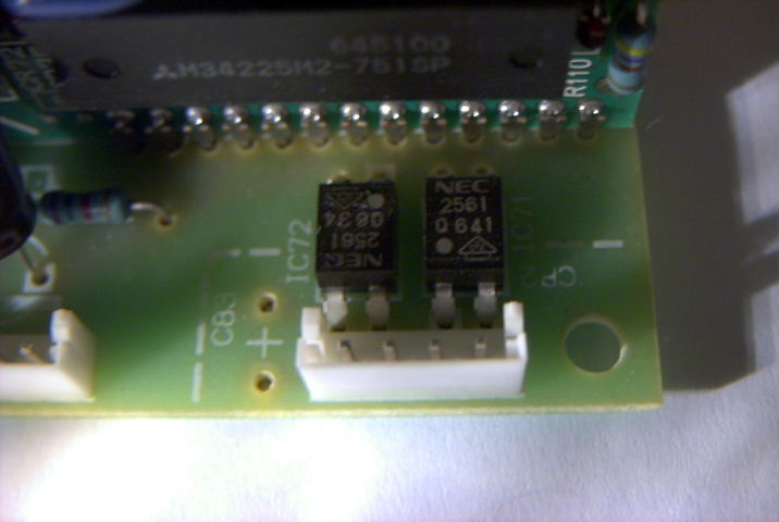

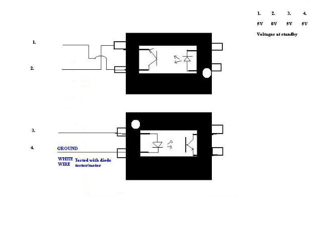

I've found the optos, and identified one cable as ground but, when measuring voltage between this "ground" and the ground marked at the mainboard (see pic. 4) I get 5V....I'm confused.
All voltages are the same at Standby, Startup (when I press the power button) and after the Lamp Led starts flashing (signaling it has detected no lamp).
HELP!!!!
Andres

I dont know if I got this right... could it be that I have to pull line 2 (in my diagram) to 5V? This seems to be the return line, right?
If anyone knows please reply, otherwise I'm gonna have to try anyways and I dont feel like blowing any parts of my projector up.
Thanks.

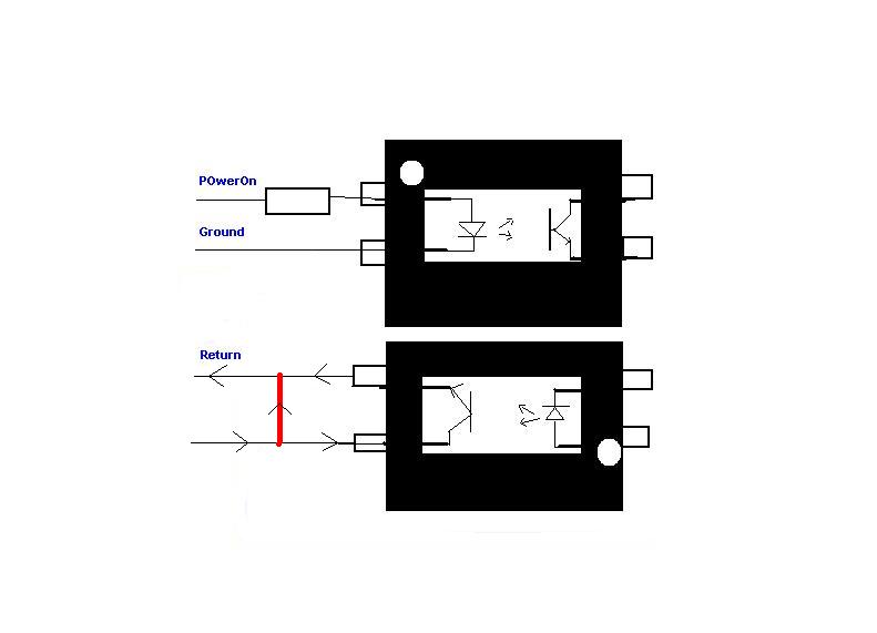

If you look at my pictures, they look very much like yours but the optocouplers are switched I think. The one you are looking for (the one that tells the mainboard when the lamp is on) is the bottom one, or the right one if you are looking from the connector.
You need to bypass that optocupler. Look at the drawing. If you do that, that circuit is ALWAYS going to be closed and so the mainboard will get the "OK" signal all the time.
I used a paper clip on the connector to do this. You have to be certain which wire from the connector goes to which of the four "ends" of the optocouplers to do this.
Ask again if its not clear enough.
