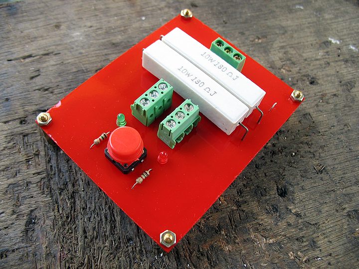

What about a guide for matching semiconductors? I know you can find out how with a search online but adding a "why to/how to" to this post would help people out.
I actually made a matching jig that can be used with an external power supply and a DMM to match the fets used in our prototypes but that should be for another thread. Thank you, maybe in the next revision.
