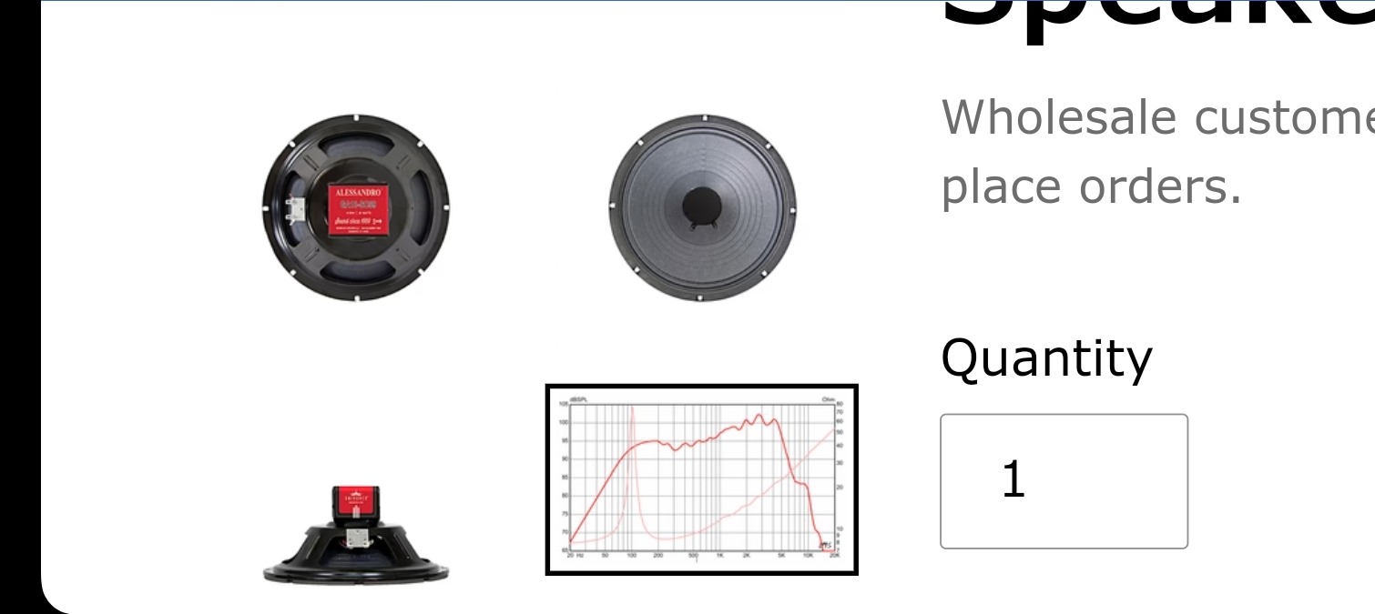

Eminence guitar speaker catalog gives detailed description of the sound each speaker is conceived for. It can be possible to design amplifiers that mate individually to these speakers. Or add a DSP and program the tone of the amp for each speaker. I don't see a universal guitar amp.

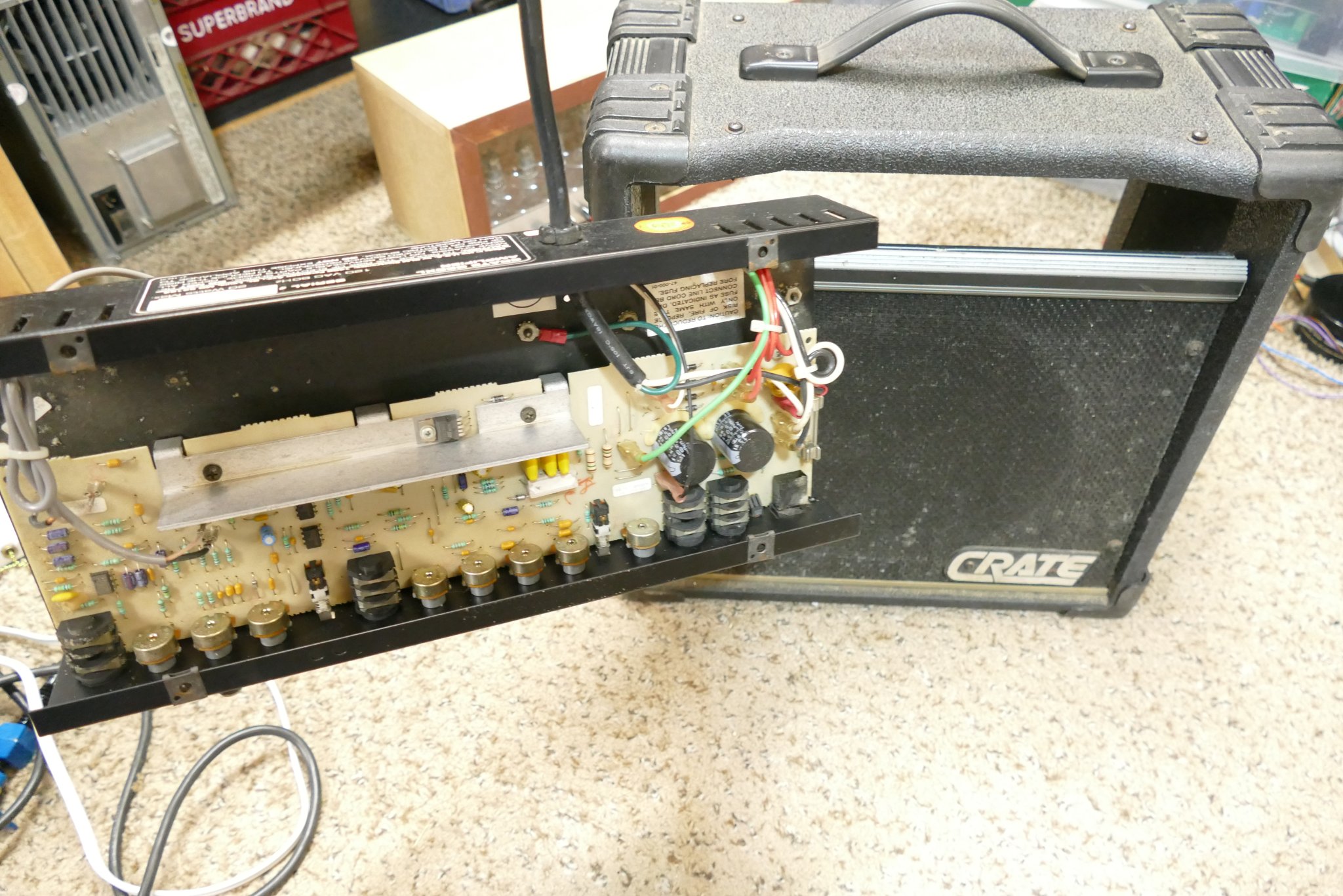

....Many years ago I had dragged a DIY solid state guitar amp I had made using a "Lil Tiger" 20 watt power amp and a DIY SS preamp copied from something I had reverse engineered into a classroom at adult education night class along with my guitar and proceeded to demonstrate my ability to crank out Magic Carpet Ride, or some other popular 60's or 70's tune when an older guy came up to me and said "gimme that thang." Without turning a knob, he cranked out some really neat country guitar pickin that I did not even think could come out of my guitar and amp. No two guitar players are even close to the same. Even when playing the same note in the same song in the same style, there will always be differences in dynamics.
