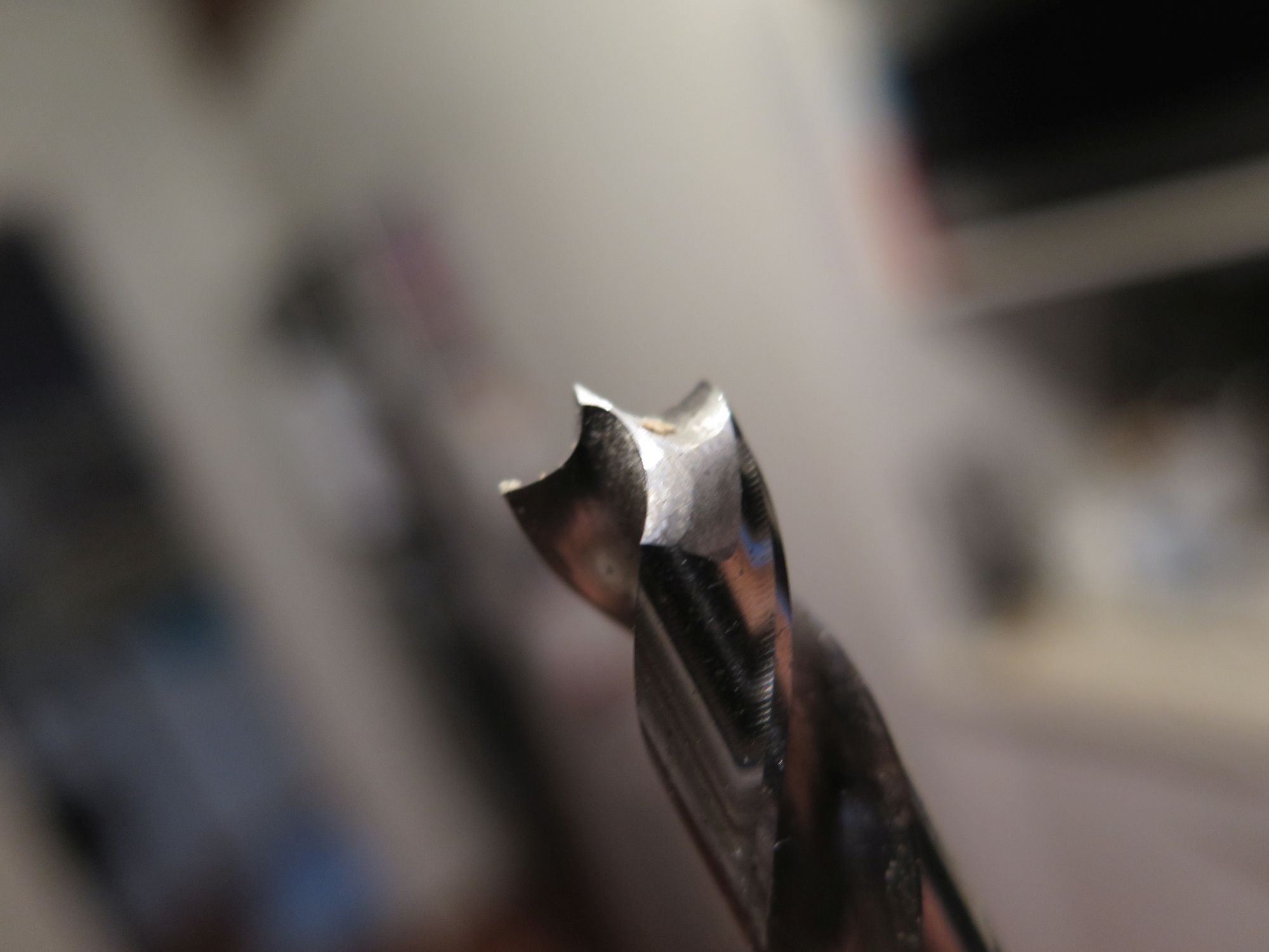

I think you did everything right except not firmly clamping the piece (ignoring speed and feed - nice and slow I reckon).
I hand sharpen my drills, so experimented with a different grind for drilling hand held holes in 2mm aluminium and it works quite well - as per photo. But clamped in a drill press is preferred to hand holding for sure. It's interesting reading up on the different grinds for different materials in technical instructions on drill sharpening (although my grind was made up by me based on a wood drill, the thinking being that the outside points would cut the outside of the hole round).
As per Mr Fahey, I'd read that kerosene is a good fluid for alum if you don't have the proper stuff (noting you do...). I've found WD40 is OK.
