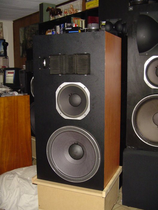

Saved about 2/3 of the cost of a used pair of JBL 4344's at the time. Was able to purchase cores and get them re-coned so my clones were using new drivers in comparison to a used system. Ended up a win win as I always wanted a pair of large format monitors and got to use essentially factory fresh drivers.
What use is a benchmark?
It's a comparison tool to compare your own builds against. I have a couple of stock systems I use for that.
4344 on the left Active 4 way on the right.
Rob 🙂

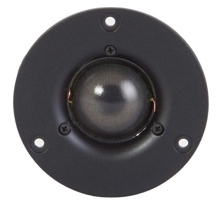

As for the tweeter, how about this one: https://www.scan-speak.dk/product/d3004-602200/ I've never tried it myself but it looks like it's basically a small flange / neo magnet version of the D3004/6600, which I've used in a couple of designs and like very much. It does require a Z-flattening LCR trap but takes a lot of abuse without showing any signs of distress even when cut as low as 1.5 kHz, which gives you a lot of flexibility in your crossover design.

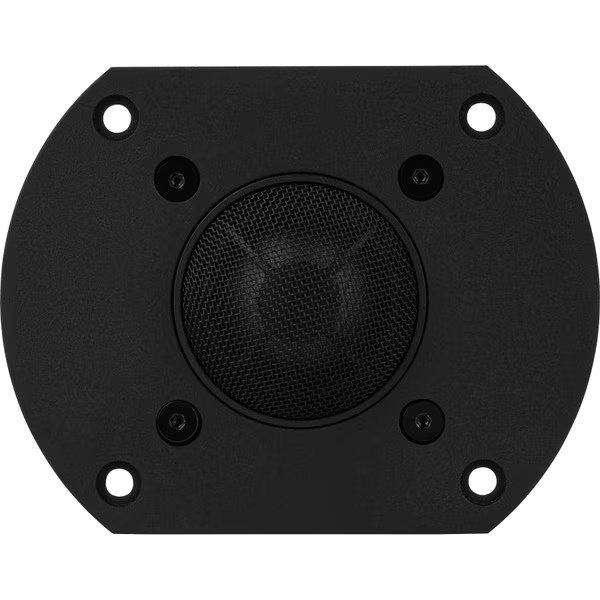

For close mounting 1" 1/8 tweeters
Dayton RST28 A or F ( aluminum or fabric)
With the truncated mounting plate for tight center to center mounting.
Or another option is Morel CAT 408

^ I second the Morel. Again it looks like a small flange / neo magnet version of the classic MDT 32/CAT 328 (very similar FR/Z curves), which I've used numerous times in its different incarnations and I love it to bits, smooth and "classy" but not at the expense of detail. Cost no object I'd give the Scan Speak a try, but the Morel would be a close second.

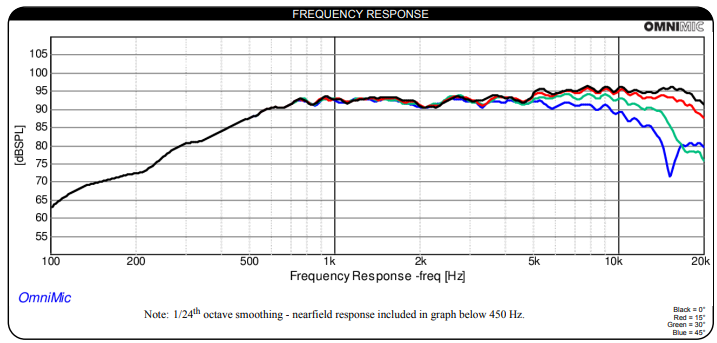

Considering the off axis response, my choice would be this
https://www.madisoundspeakerstore.c...-illuminator-d3004/6022-00-26mm-dome-tweeter/
…..nearly a flat line from 2k up to 15k at 30 degrees……enough tow out where the on axis response will provide the illusion of a larger presentation and the minor on axis bump centered at 6.5k to provide spatial cues from reflected energy from typical ceiling hights
