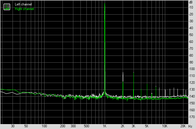

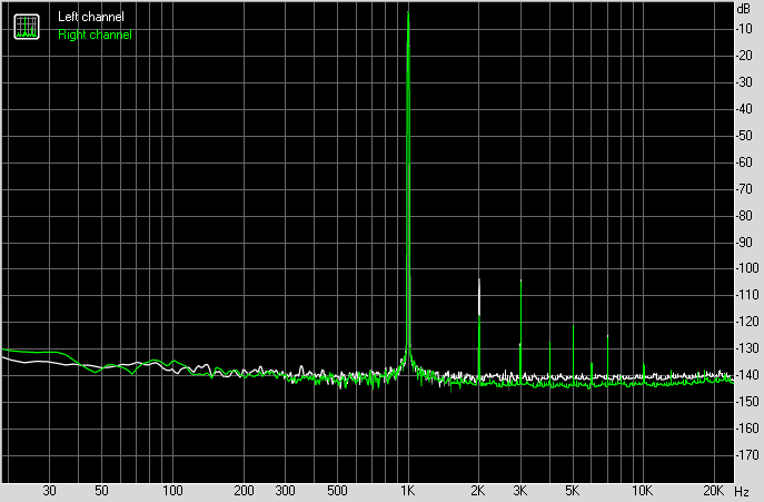

More or less it went fine, higher artifacts are gone. Only second harmonics seems to be much higher then for right channel. Wondering if it's worth to change those fixing wire for left channel to shielded. Probably it will not change anything. What do you think about it?
You are right. I don't even know where I got this idea from. But anyway even on other people measurements I see that left channel usually has worse 2nd harnomic than right. I'm just wondering what could be the reason for that. On mine it's more then 10dba difference.

Why do you think the wires used in the left channel mod have any influence on signal harmonic levels? The mod is about removing power supply noise artifacts - which are not related.
Harmonic distortion is equal at the two input channels in my second EMU-0404 (also at the first).
I have seen dist. increase issues being caused by connectors/plugs of the input wiring external to the card

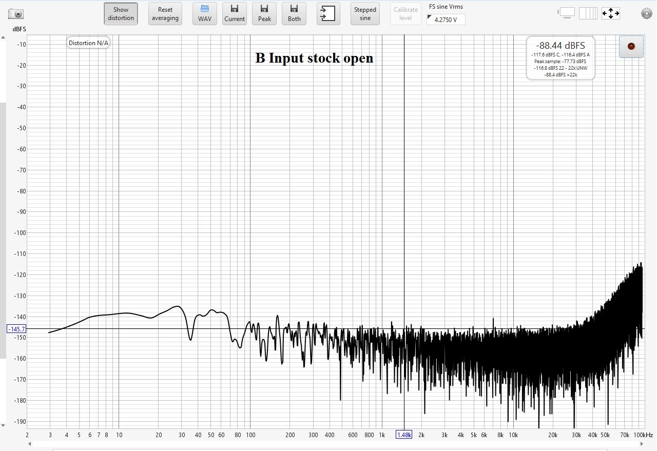

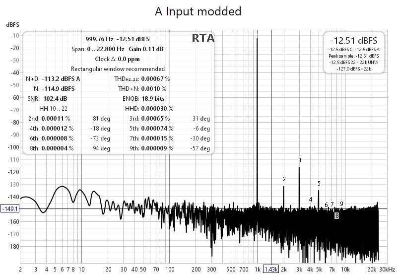

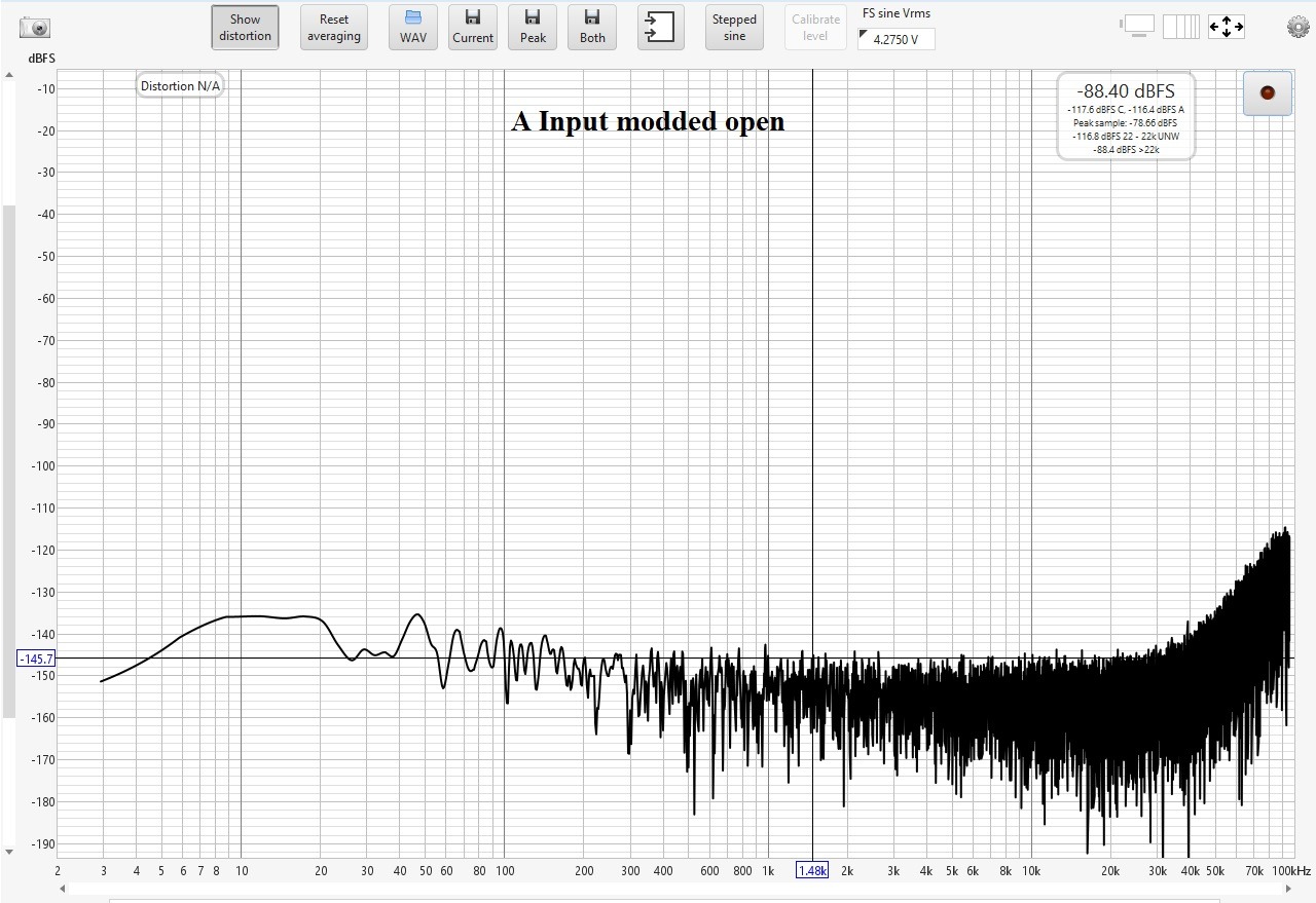

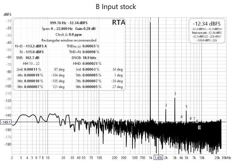

Reactions: 1 user
I have extremely shot wires, solid, TRS to XLR. Switching them between channels does not change THD at all.

Joined 2002

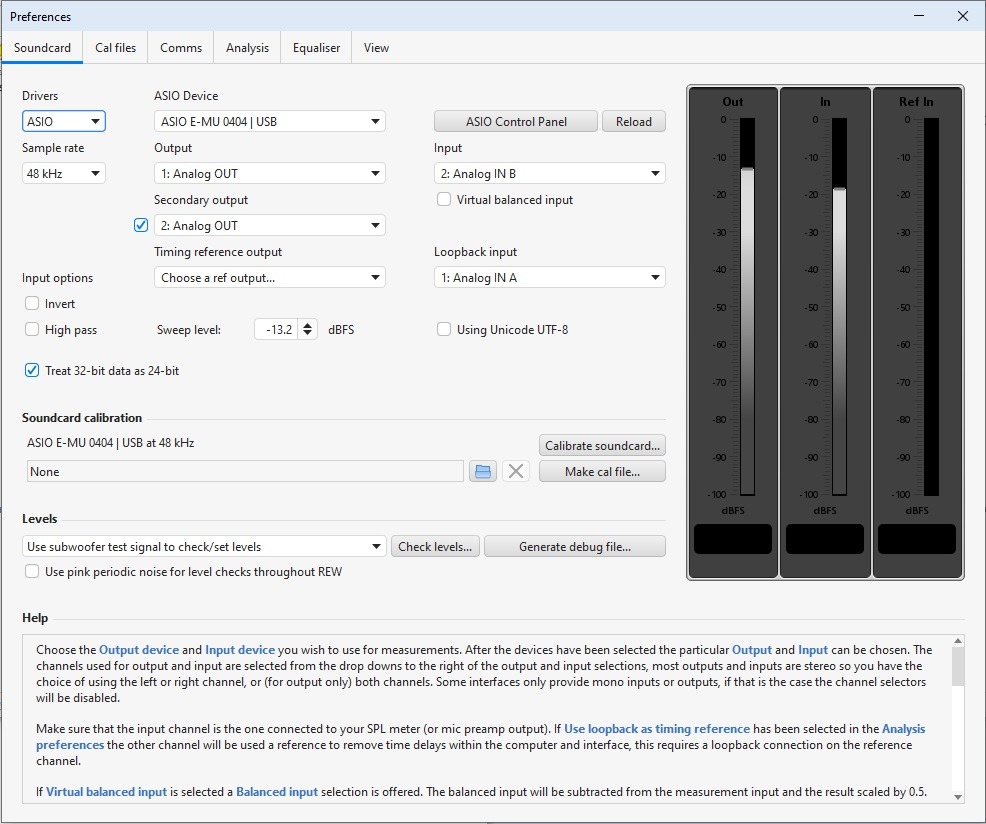

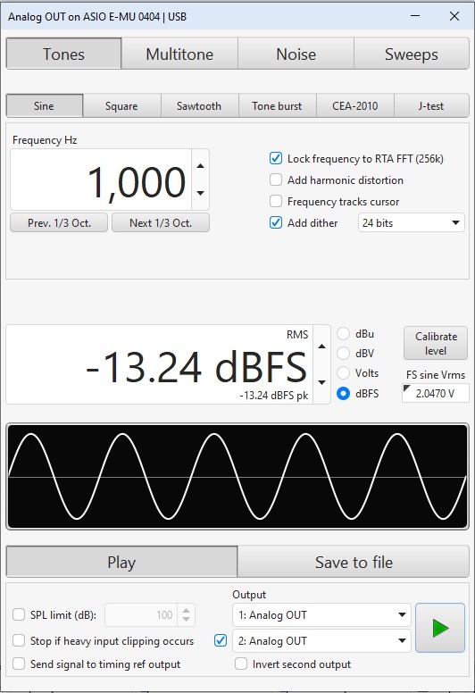

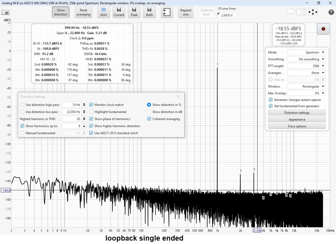

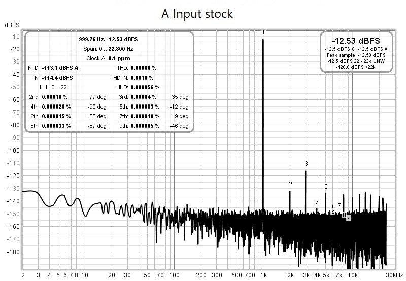

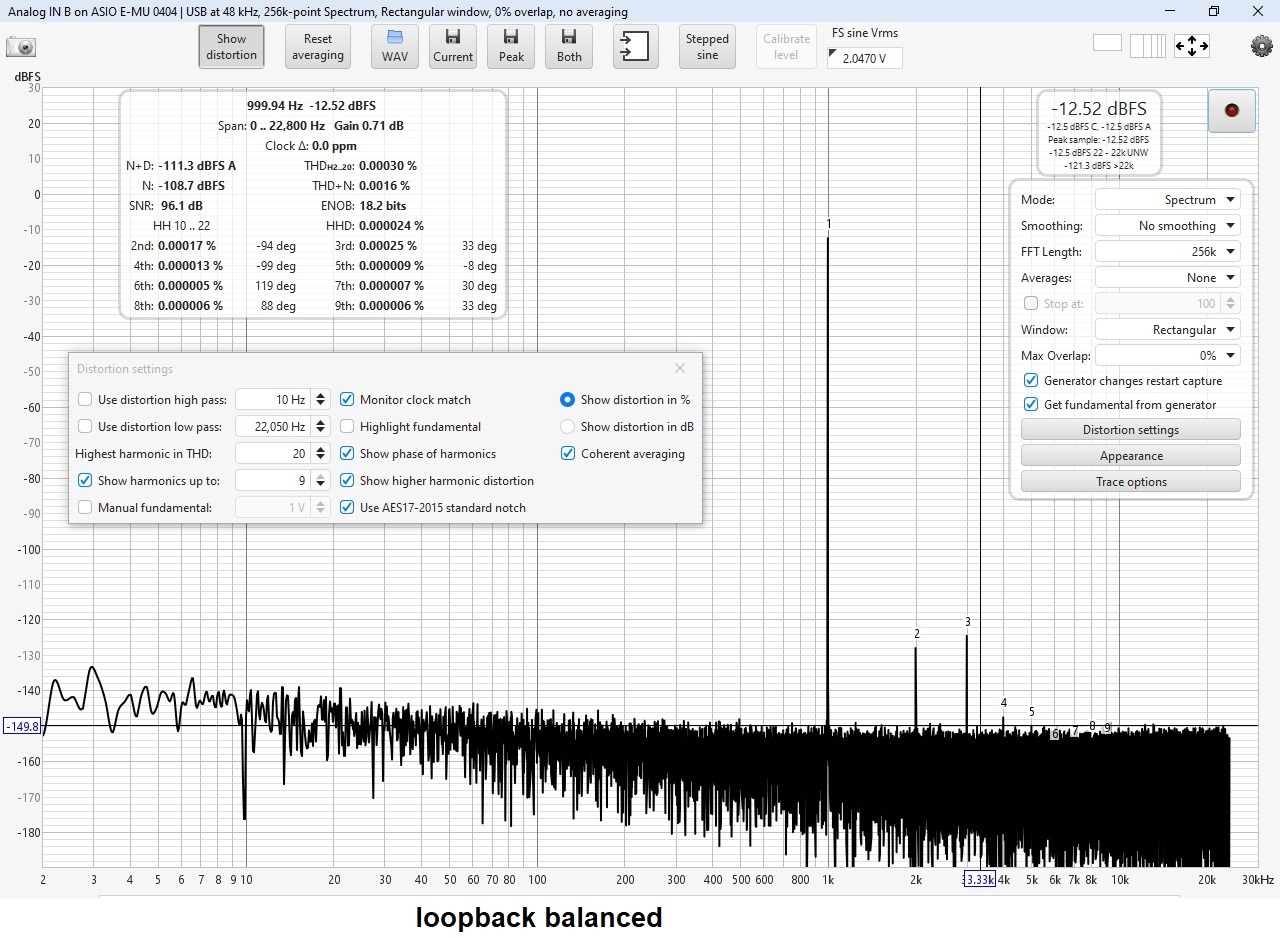

It was with generator at 0dBFS, 256k FFT length, Rectangular Window, no averaging. But there was Jan Didden's Autoranger set to -12dB btn soundcard Out and soundcard In. Connection was balanced TRS.
Now if you want to compare, I attach measurements without Autoranger. But for to achieve the same input level, I attenuate the Generator out.
George

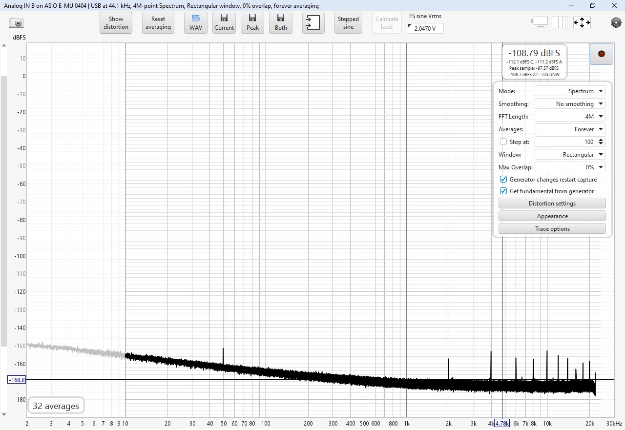

Here is idle (loopback, balanced TRS) with 4M FFT, x32 averaging, just to be able to watch for glitches below the apparent noise floor of the 256k FFT length. This measurement was with card set to 44k1 SR
