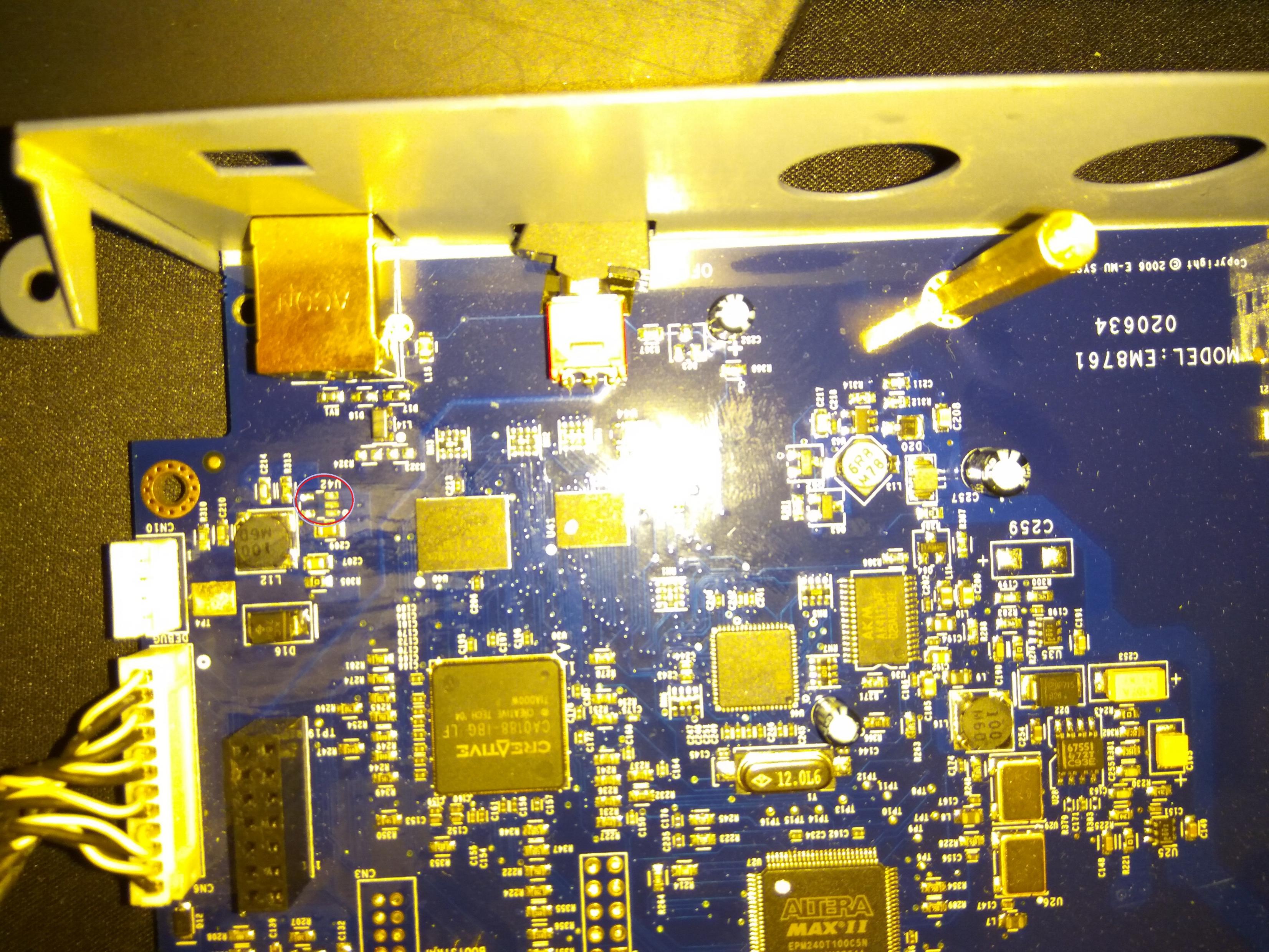

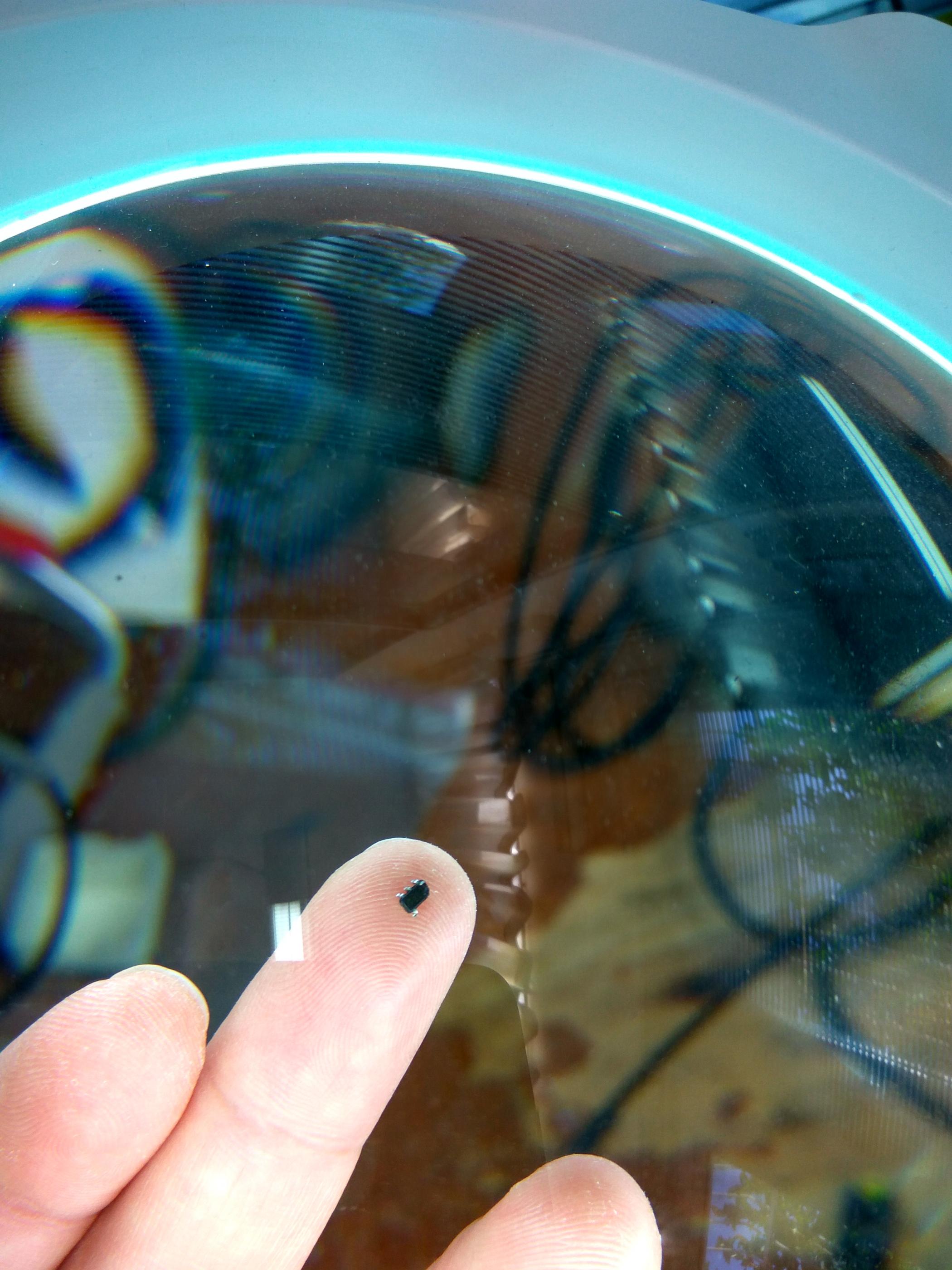

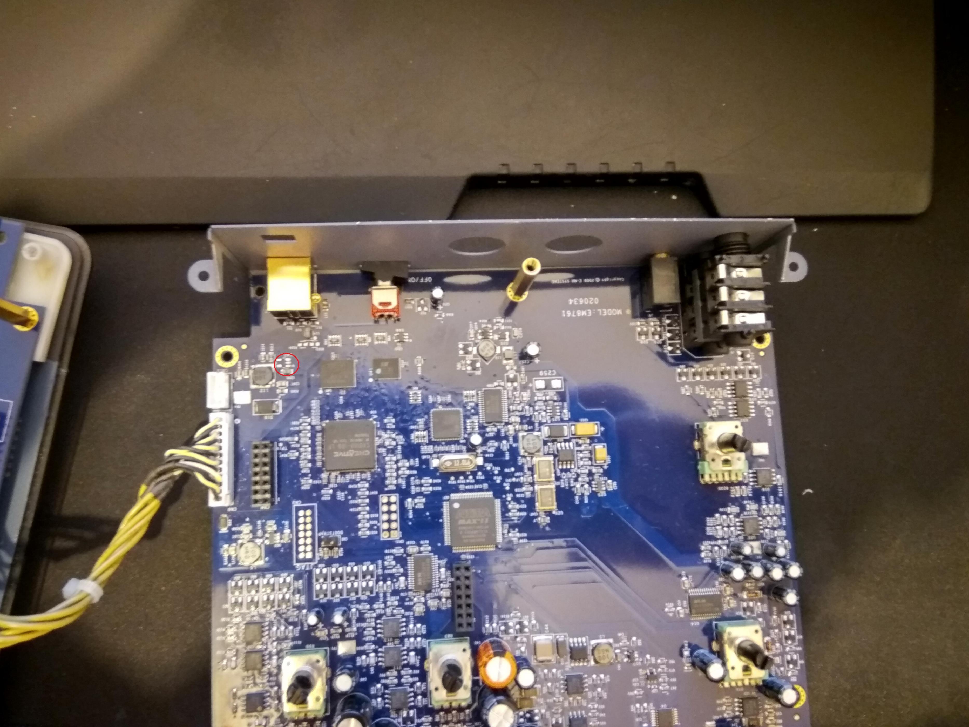

A problem from power supply
Dear all,
I put a 12V power supply (instead of 5 V DC) by mistake and since then it's not working.
I opened it and it died an internal U42 component which u can see in the picture at the position circled in RED.
i would be grateful if you could tell me what's this component so i can replace it, i guess it's a voltage distribute .
Thank you very much for your time,
George
