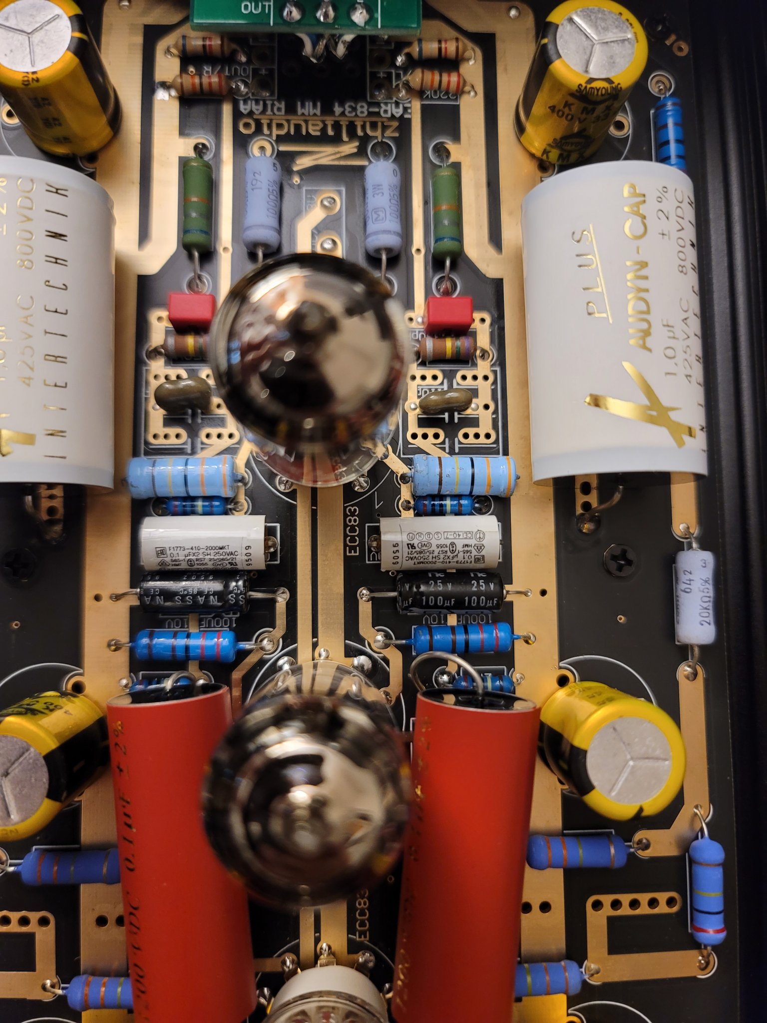

I have started a new Phono Stage project. After watching Stephe's series and reading a lot of the discussions I decided to get one of the built up Chinese clones and then upgrade the critical components. I settled on the two chassis version with a volume control. I think that I have a plan!

I auditioned it briefly as it came and it's not bad. There is plenty of gain and no noise or hum to speak of. The tonal balance seems pretty even and extended. The soundstage was not very wide or deep at all. Focus was okay on that miniature stage.

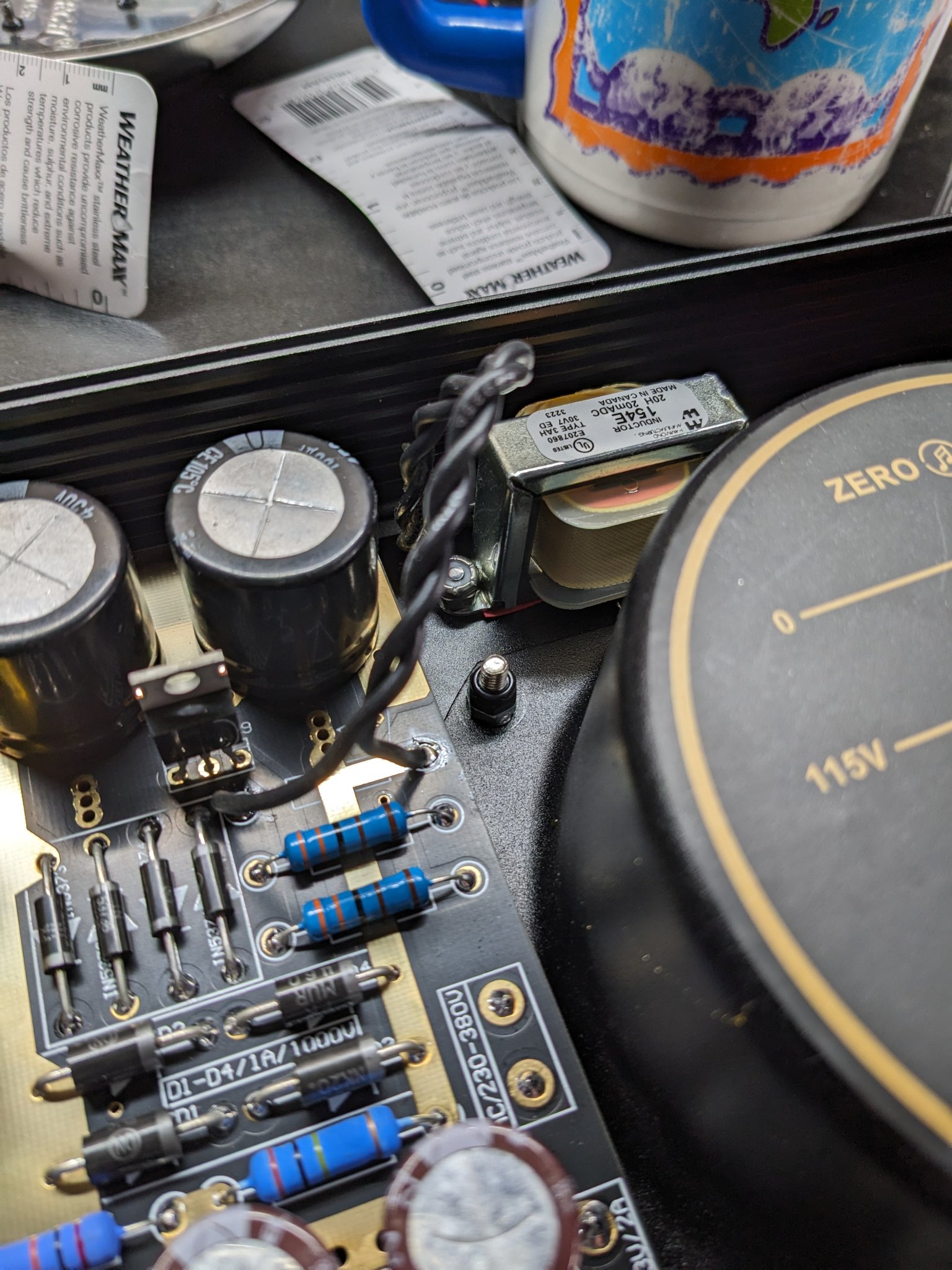

The first upgrade on my list is to add the choke to the power supply and I got that done this afternoon.

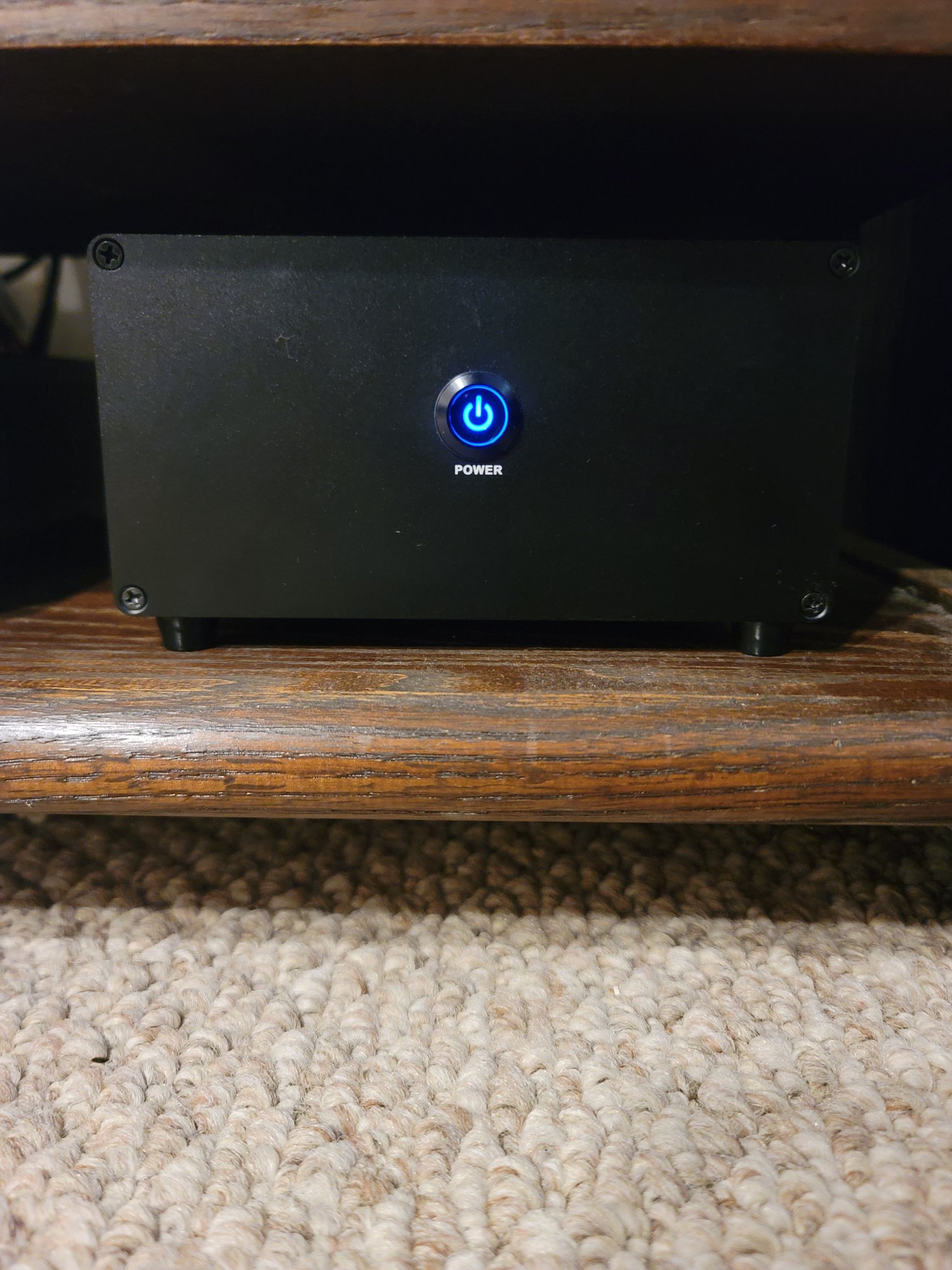

I also eliminated the power switch on the back of the power supply, and instead installed a locking push button power supply with built in led. I rewired the 6.3VDC led lin to power the led in the power switch. It looks much nicer, and is far easier to use.

I didn't measure before and after, unfortunately. I removed the resistor when I added the choke so I thought that it would be a wash.Did the choke raise the DC rail V+? I am interested in trying that mod.
There is a bit more hum afterwards, which I didn't expect! I didn't audition it between adding the choke and replacing the caps so I don't really know the cause. I did twist the leads to the choke.

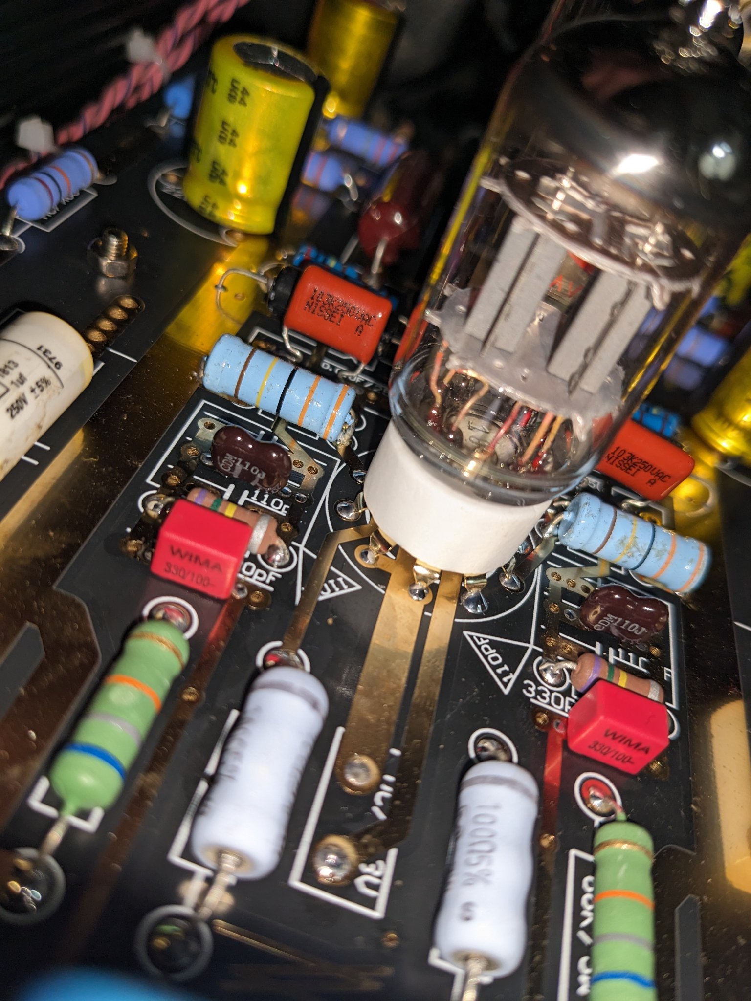

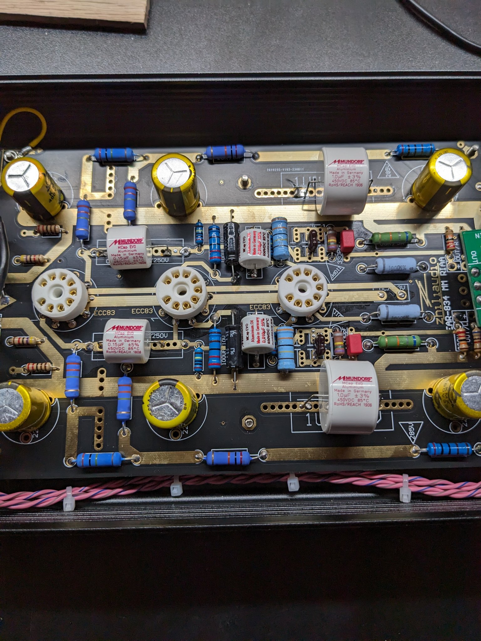

I received and installed the replacement coupling caps today.
Spoiler alert: this thing is transformed!
I found a source for all Mundorf Evo caps but only the 0.01mf one is the oil filled version.
I unsoldered the first cap to remove it but pretty quickly I started just clipping the leads with my flush cutters as I wasn't using any of the same holes.
I tried it out after upgrading one channel but quickly decided to do the other side.
After the upgrade the phono stage is transformed. The high frequencies are much cleaner -- cymbals are less splashy -- but the biggest changes are to the soundstage. The stage is much wider and deeper, larger than the room itself. The images on that stage are much rounder and more full-bodied.
As received this was basically a mid-fi level product. The frequency response was reasonably flat and extended and it was quiet. It sounded "nice". It didn't really create a soundstage, the musicians sounded like cardboard cutouts strung in a line between the speakers. Some of the cutouts were a bit smaller than others but not really behind them.
After the capacitor upgrades this is starting to sound like a high end product. The frequency response is more refined but the change in the imaging capabilities has taken it to a different league. The soundstage is MUCH bigger, not just wider than the speakers but wider than the room and there is now a convincing illusion of depth, extending well farther away than the wall. The images of the musicians are now rounded, full-bodied people with air around them.
This improved separation makes it much easier to follow the individuals making the music. I have been playing the same Jeremy Steig record over and over again, and this time those guys were doing all sorts of subtle **** that they weren't doing yesterday!
The caps in the RIAA section have brand names on them but I wonder if they are authentic. It seems possible that it is a counterfeit WIMA part. In any event, even if it's real it isn't the highest quality. The same goes for the other one. It might be a Mica cap but I think that it's a 5% part . The replacement precision Cornell Dubilier Mica caps and Holsworthy resistors should really clean up this critical area.
So, so far so good. I'm very happy with the progress up to this point and I look forward to seeing what the next round does.

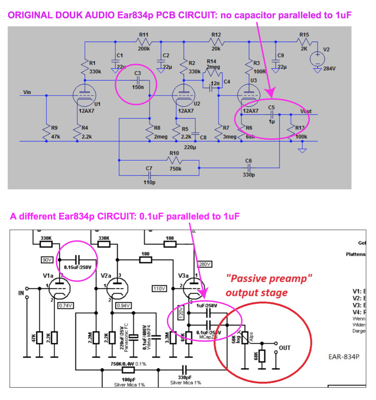

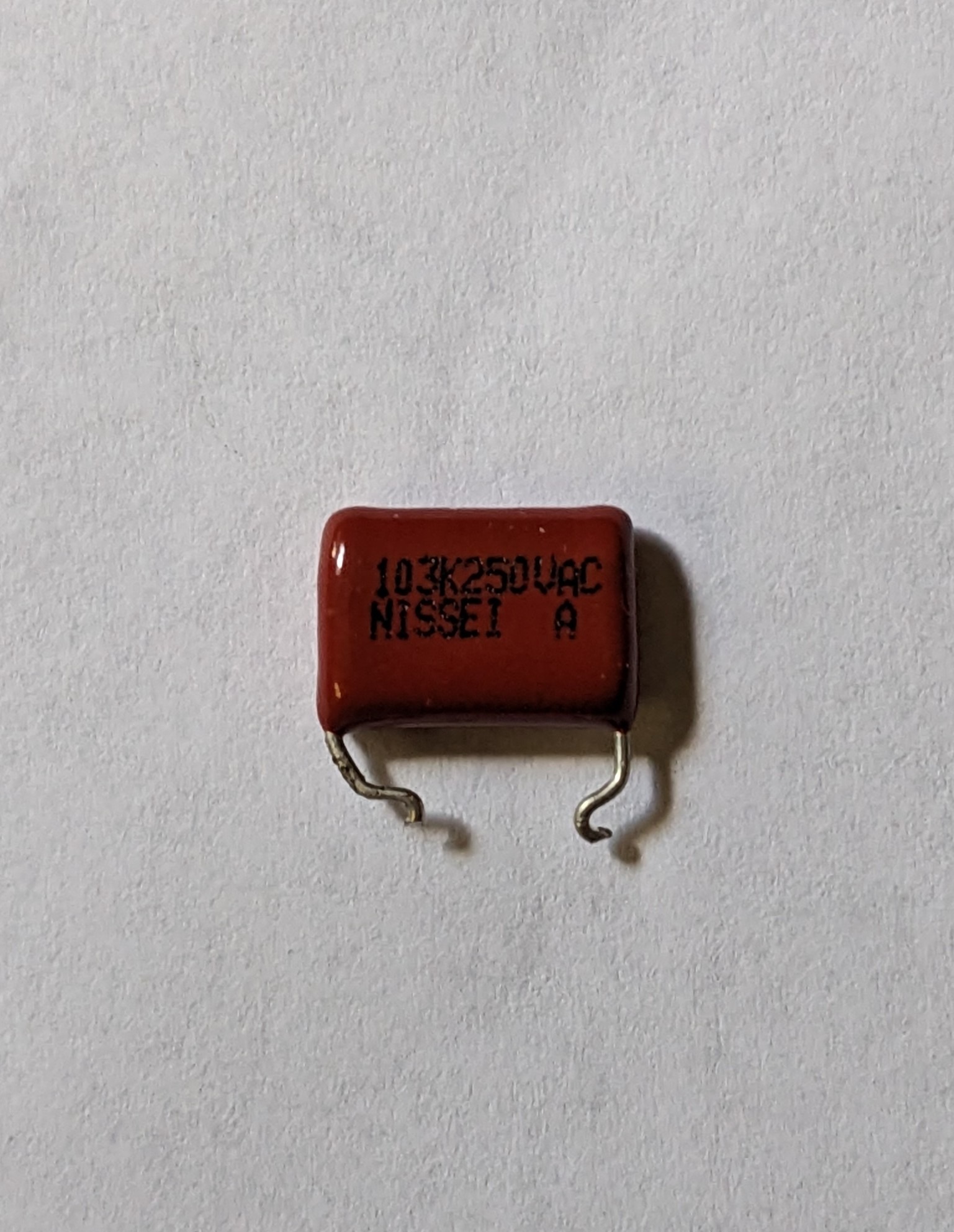

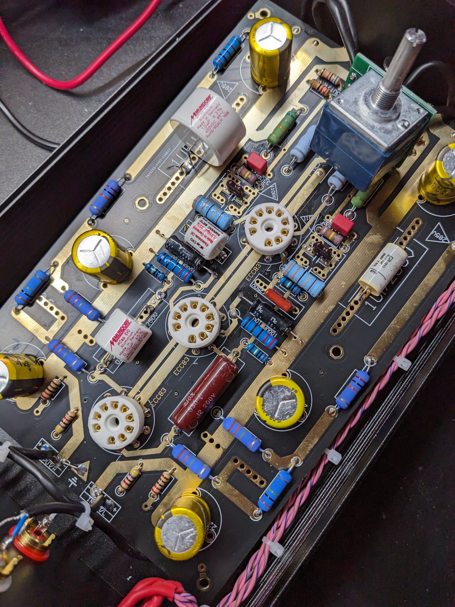

jayme -- Here is the cap that I removed from that location. 103k is 0.01uf where I come from, I wonder if they used the wrong value when building your unit.DNic - is that 0.01uF cap the right value? Mine came with a 0.1uf cap in that spot
The schematic that Stephe posted shows 0.01uf in this location but I have seen versions that show 0.1 uf here.
Pete
Huh. I will have to trace out my circuit. I see a couple different schematics. That cap couple be a couple different parts. Either a bypass cap per the bottom schematic, or in the signal path between tubes 2 and 3.
If it is just the 0.1uf bypass cap, I am not worried about it affecting the sound.

Humm, as I understand the circuit this is a high pass filter acting as a subsonic filter. I wonder if the reason Thorsten decided to remove it is that his amp had the higher value capacitor and the crossover point was too high.
The first schematic shows 0.012 uf in this location and the second one has the entire filter section removed and replaced with a 100 ohm resistor.

Makes sense it is a high pass filter. My 0.1uf would just be a DC blocker, at 0.8Hz. Your 0.01uf would be better at 8Hz.
At least the larger cap is decent on mine, it sounds good as is. I do get some subsonic woofer pumping on certain records tho, so I might consider adjusting it.
